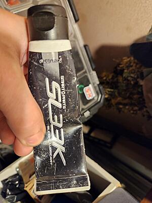

                If it's labelled as "sleek lube" and white/creamy looking then it's still a baby.... you need the old aluminum toothpaste tube of dow thats pink, now that tube can buy itself a drink.
