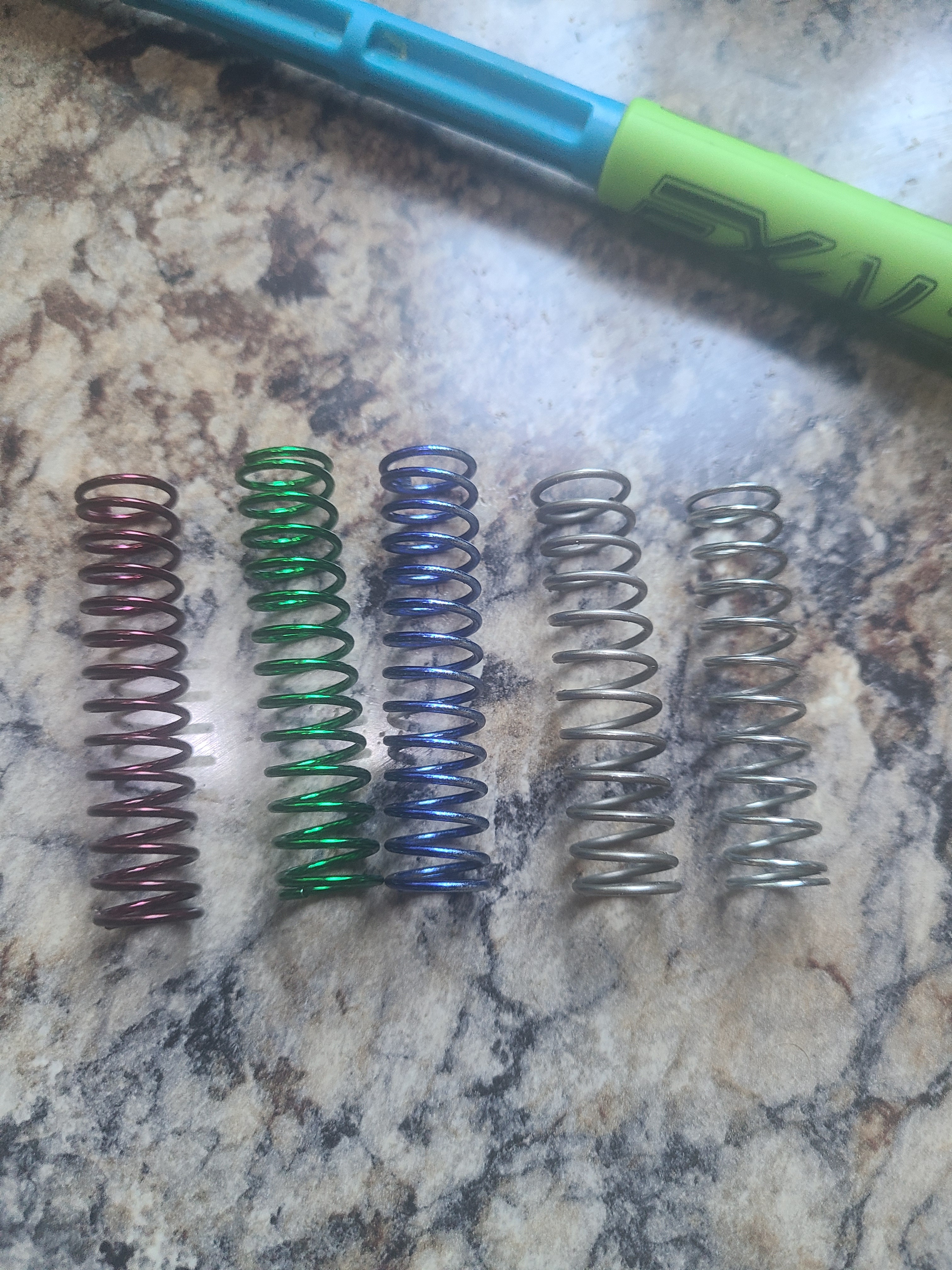

    Auto clunker sprongs
    What color means what?
    which on is soft which one is hard?
    I tried sqeezing them but I dunno guess I'm just dumb but I know some one on here isn't

        • Snowpuff
          Snowpuff commented
          Dude... so I just checked again they are all same od. Thickness and same amount of coils.... lmao tha means....and I must be wrong but... they are all the same..lmfao!!! Like man you gotta see these things they are all he same but the color I must be getting something wrong here.

      • Snowpuff
        Fox Hound
        • Nov 2023
        • 353
        Far right is ATS-85 spring
        second to the right is a stock tracer spring
        only the ats is smaller by0.03

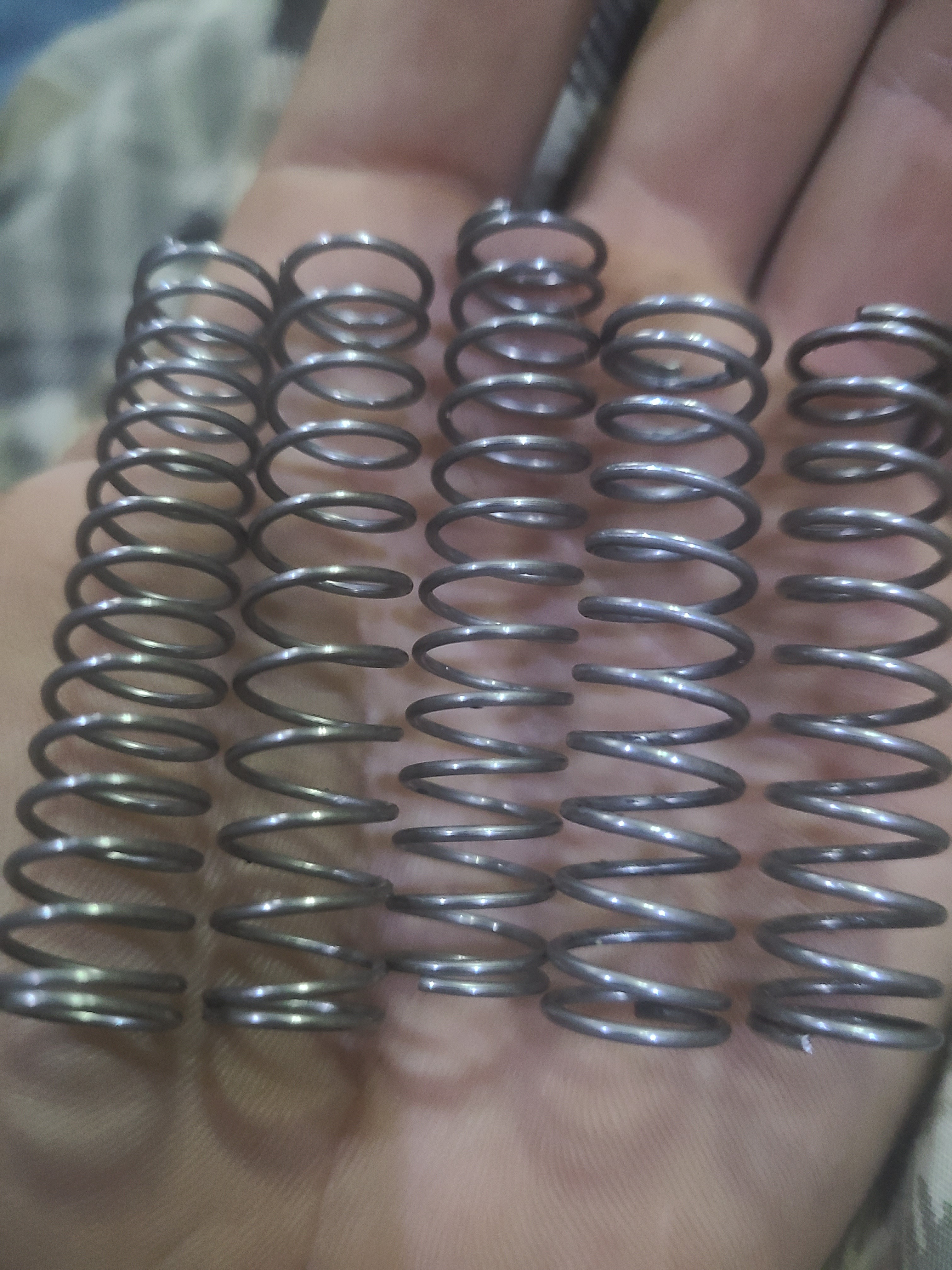

            • Snowpuff
              Fox Hound
              • Nov 2023
              • 353
              I did that test with these spring and with these ones I can tell the difference by looking by squishing them.
              Im pretty sure those coloredcolored are all the same lol just color differently...lmao
