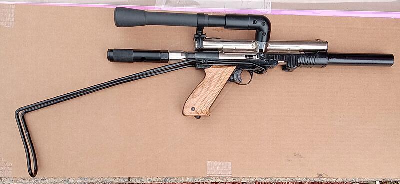

    The Nelspot 007 I’m trying to fix up.

      Moved! Welcome to MCB. This is the right place for anyone with a Nelspot.
      And that is a really cool Nelly. The wire stock in particular is rare--I think it's a Line SI product.
      My favorite part about the basic Nelson design is that it's pretty stupid simple to work with. Clean it, remove rust (if any), oil, put it back together. There's one standard size o-ring, and the cup seals aren't hard to find. Power tubes can break, but they're around, too.
      You already have a lot of nice upgrade parts. I'm guessing you don't have anti-kink internals, which you can swap out for Phantom parts if you want to smooth your pump stroke a bit, but otherwise, a good cleaning is probably all it needs.

        Awesome Nelly! Those grips are a nice touch.
        You may run into problems with the 12 gram piercer or the seal. If the piercer itself is bad, there's no easy replacement short of a new valve body. I've had limited success with these seals sitting well in my Nelspot type piercers:
        https://pgpjunkies.bigcartel.com/pro...ce-seal-5-pack
        If you want to go the modernization/upgrade route, LAPCO still has power tubes and rear ASA/1/8th input valve bodies:
        https://www.lapcopaintball.com/colle...age-collection
        I'd suggest a spring kit from Phantom while you're at it. FYI Phantom cup seals will work on the LAPCO power tubes.
        https://phantomonline.com/product/phantom-spring-kit/
        • Riverratroberto
          Riverratroberto commented
          Thanks for all the info. I’m pretty sure I’ll be needing a seal for the piercer. It pierced the first tube just fine but dumped all the gas out. Bummer
