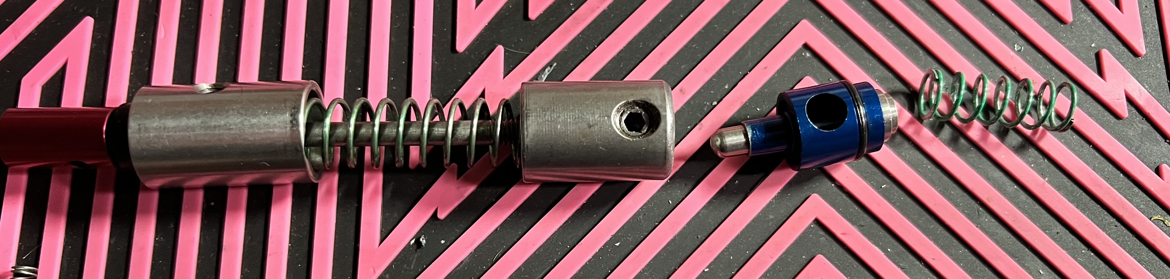

    Looks like there is more to my issue. The marker cycles but does not shoot. So no air is getting through the valve. HPR Reg is set for about 375.
    Pulled the valve, nothing wrong there short valve spring
    Might try and swap the valve?!

      Looks like a ST Rat valve. Should be an easy rebuild if you get the valve stem and valve face o-rings, but I doubt the valve is the issue. I assume you've confirmed the air passages from the VASA into the body are clear? Would make sense if you're getting pressure to the LPR already...
      Can you confirm the hammer is hitting the valve stem? Is it not letting ANY air flow, or is it a weak fart-y kinda thing? If you turn the LPR completely off and manually cycle it, will it fire then?
    • 4475
    Swapping the valve resulted in no change. Valve does not appear to open.
