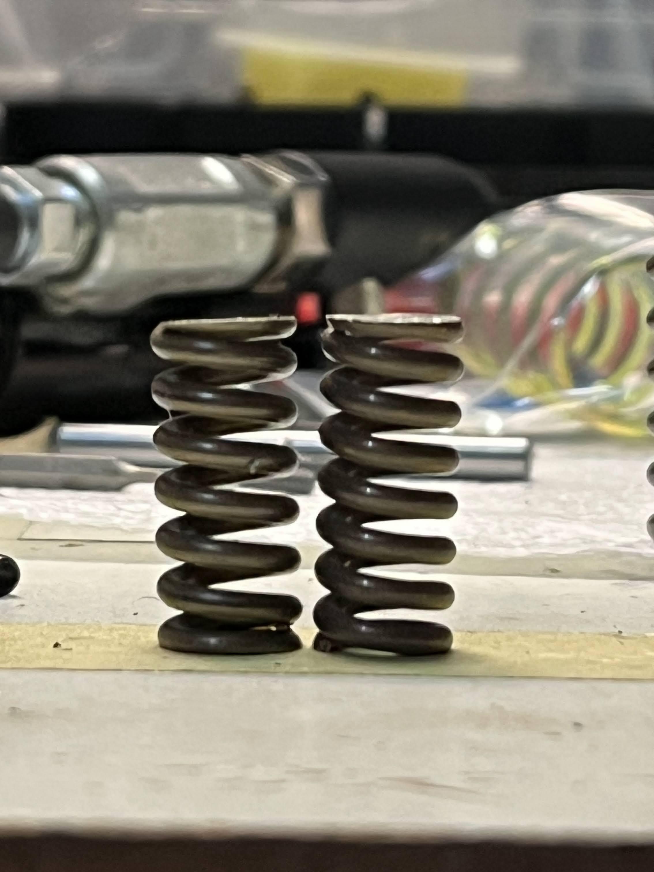

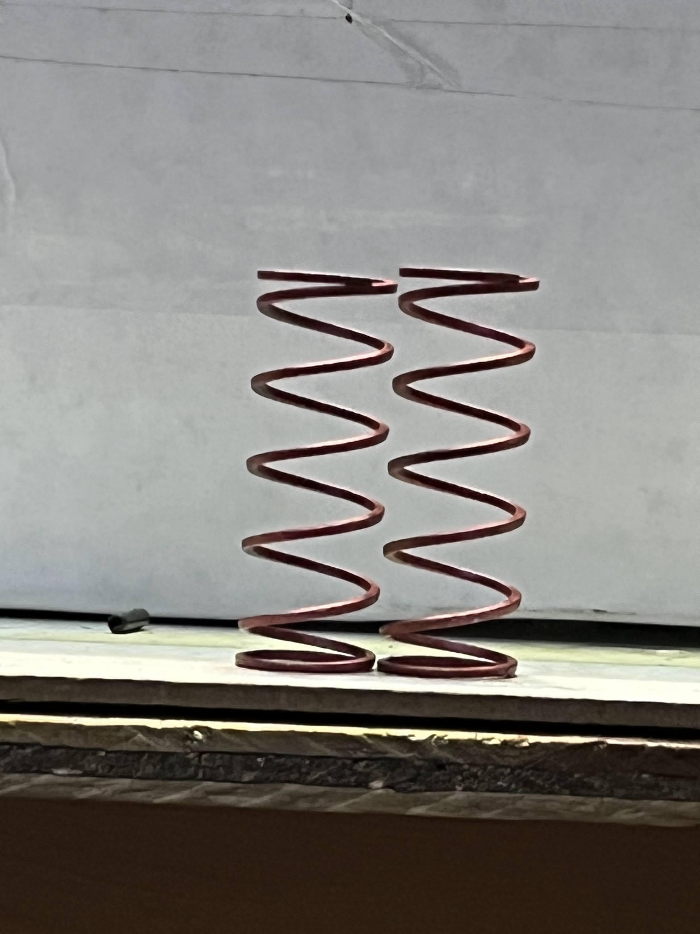

      I got my spare parts in yesterday. I'm replacing the red bolt spring and the inside regulator spring. (The outside spring doesn't really do anything, right? It just keeps the smaller spring in the center.) I did notice that the springs I'm replacing don't really seem that different. I included some pictures below, new springs on the right and old spring on the left. The new ones are definitely a little taller. Not sure if that makes a difference.
      The bigger thing I noticed is inside the back half of the valve. The threads for the velocity adjuster are kinda messed up. They're not stripped, not yet anyway, but the anodizing has been completely rubbed off. Is that normal?
      I'm going to do Walker's "mag reset" thing tomorrow if I have time. Just sharing this for now.

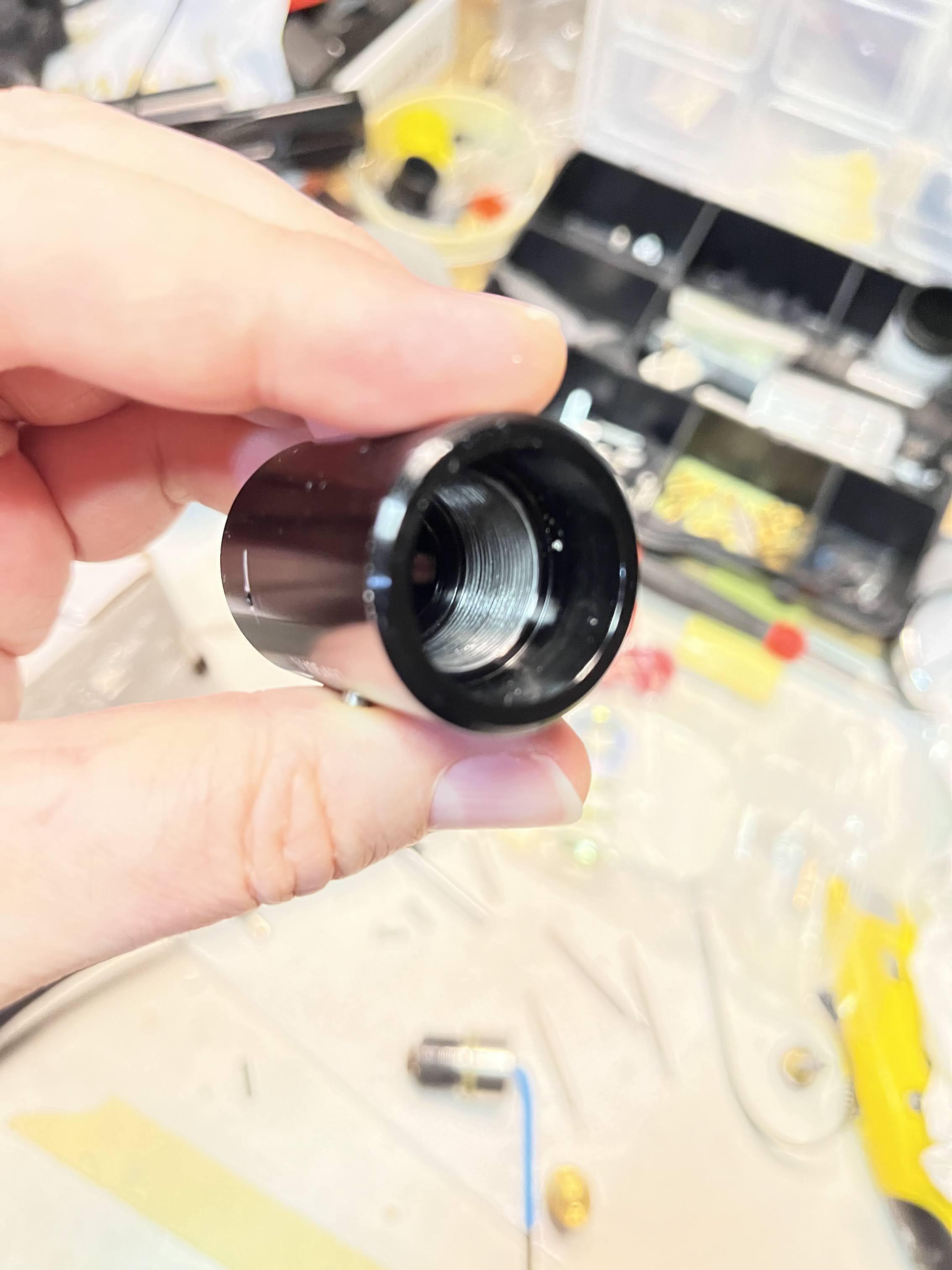

        Oh...one more thing I forgot. When I was putting in the barrel and tightening everything down, I noticed that the front of my Dye UL barrel could wiggle a little, even after I tried to tighten it down farther. I did some testing, and yeah....the two halves don't screw in straight. There's an offset about 1 mm from one end to the other, which is plenty enough for the paintball to bounce/roll off the inside of the tip as it comes out. No idea how long that's been like that, but I'm assuming it was bent last time I played when I was breaking multiple balls every single game, so maybe that's the culprit and I've been doing all this other worrying for nothing.
        I've got other barrels I can use to test out everything this weekend. Hopefully everything works fine with a different tube and sucks when I put the Ultralite back on there. Then I know I just need to replace the barrel, which is easy enough.

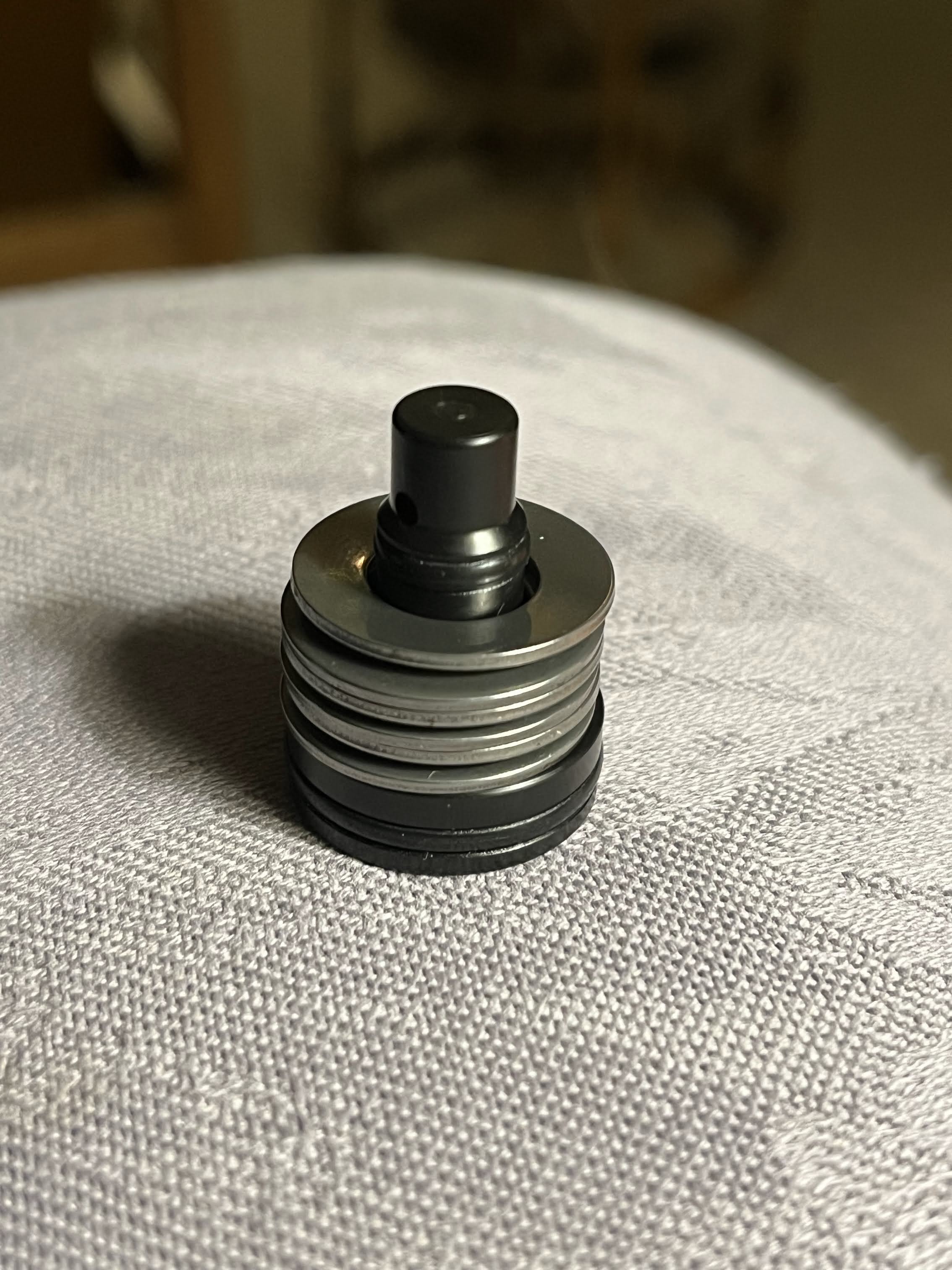

                  This is the MacDev regulator piston. There's no reg seat seal thing on the tip of the stem (unless it fell out and I didn't notice). There are only two o-rings: a big one at the bottom and a smaller one towards the top. There is a little round indentation on the tip of the stem, but it's still aluminum. No seal material.
                  So, I should be able to rebuild this by just changing the o-rings, right?

                      I couldn't see the offset looking down the barrel. I laid the barrel on two thin scrap pieces of wood, one under each end so it formed a bridge, and then measured the distance in the middle from the top of the table to the bottom of the barrel with a feeler gauge. Then I kept rotating the barrel and re-measuring. That's where I got the 1 mm offset.
                      And the barrel was not cross stripped. There's an o-ring inside the two halves that had worn out, and the fit wasn't quite perfect. The OD of the tip was a few thousandths smaller than the ID of the back. I replaced the o-ring and then wrapped the tip threads with some Teflon tape to fill in the gap. That worked really well. I can still measure a little bit of an offset, but it's like 0.05 mm. Close enough for me.
