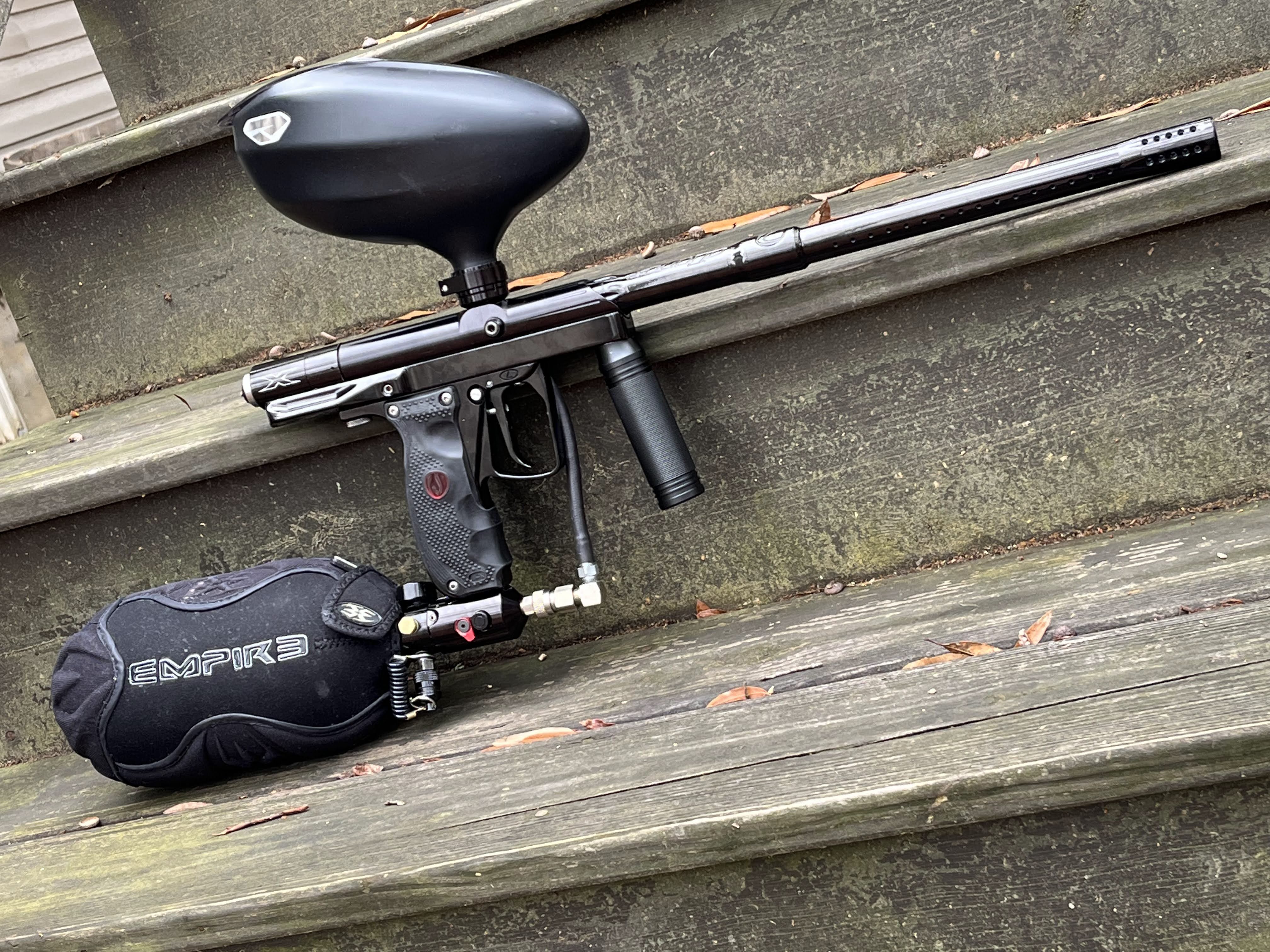

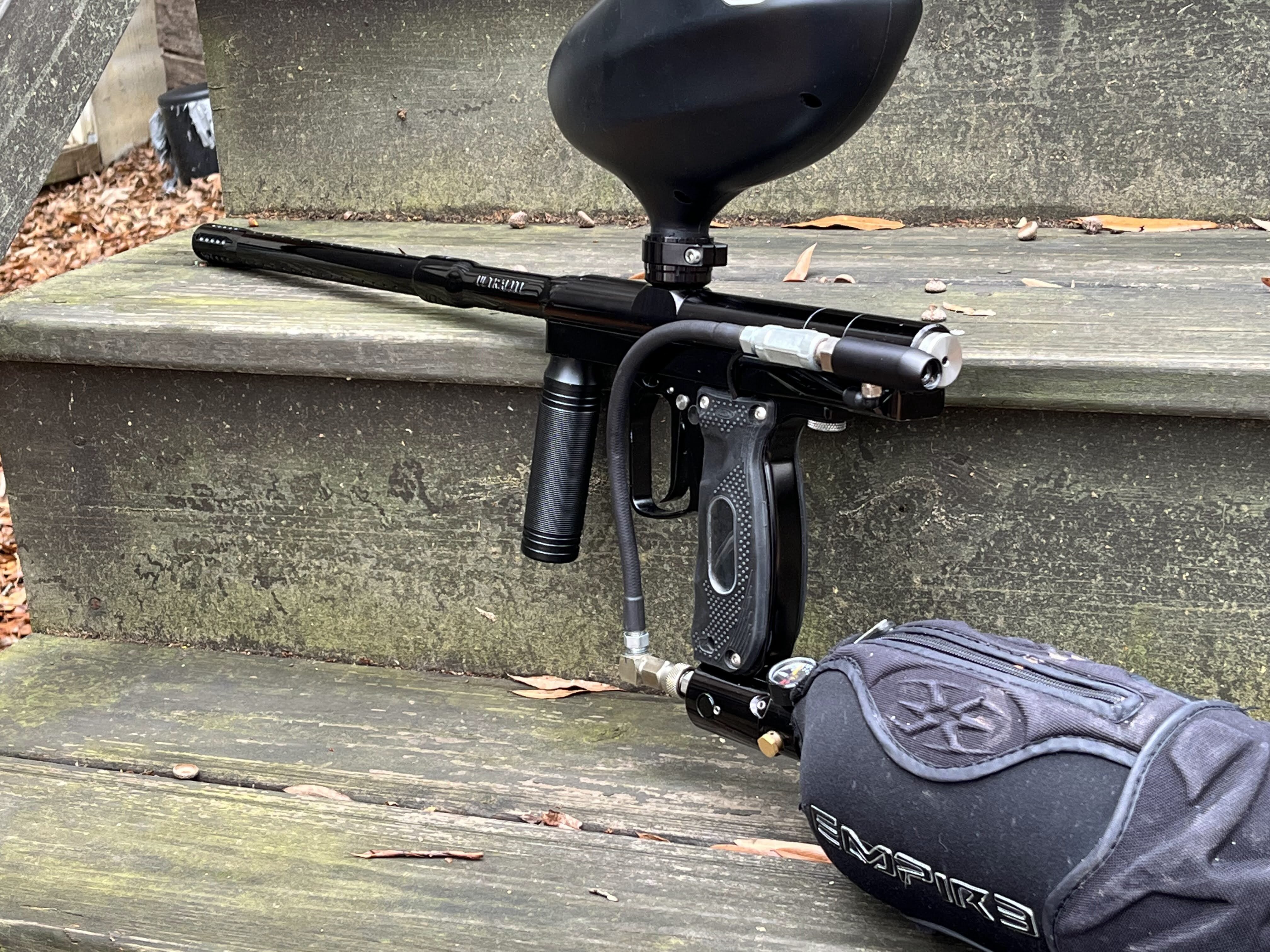

          Okay. Update time.
          "Unfixing" the Ultralite barrel made me break paint again, even in a different marker. So that was definitely part of the problem before.
          However, and I also double-checked my velocity the right way---shoot, hold the trigger, then release and quickly shoot again. Doing that, my fps was much higher. There were plenty of shots over 300. Then when tested my fps the "wrong" way by releasing the trigger and waiting a few seconds between each shot, my fps was much less consistent and much lower in the 260-280 range. That's like a 30 or 40 fps swing. In the past, I've tried to chrono this Automag at 275ish, but since I was doing it the wrong way, that means my actual fps could have been up to 315. Add in the crooked barrel, and that's not a good environment for paintballs.
          Now my Automag is chrono'd the right way at 290ish. That does mean that occasionally I'm getting a shot coming out at 250, but that's fine. I'm overboring and shooting mid-range paint, so I don't know if I can really expect much more. Besides, most of my shots are in the 270-280 range, so we'll just have to call it good enough.

            Yeah. I'm not sure what I'm going to do either. I've always told myself that this is my forever marker. I love the way it looks, the way it feels, the way it shoots. Well, the smoothness and crispness of the shot, anyway. But if the fps on the x-valve keeps oscillating between 250-300....honestly I don't know if I want to keep using it. I might start using my back-up Gmek as my primary and only keep the mag as a backup.
            The only reason I might keep using it is because of the "challenge" factor. I'm already handicapping myself with limited paint and 10-round tubes to keep things more interesting. Maybe if I think of this as just another kind of handicap, I can trick my brain into not getting pissed every time I get a slow shot.
            The tinkering inside of me also is also wondering what can be done to fix this. Expansion chamber? Low pressure mods? What is it about the classic valve that makes it more consistent than an x-valve, and can I mod the x-valve without ruining it? Hmmm....

                  Sigh....That would kind of ruin the aesthetics I've got going on. Half the reason I love this gun is because of how pretty it is. Plus I'd have to replace my custom foregrip with a reg. I don't wanna do that either.
                  Originally posted by Siress
                  The issue I remember is that the reg springs wear on the inside of the cap - so much so that I've seen them deep enough to feel without looking and without using your fingernail. That sort of issue can lead to wild swings in velocity. I'd cap it and put a more reliable regulator on there.
                  Interesting. This I can work with. I'm pretty sure there's enough room between the springs and the inside of the cap for a Delrin or brass bushing. That would be easy to make on my lathe. I could try that out and see if that helps with the rubbing.
                  Or....OR....what about replacing the coil springs with a Belleville washer spring pack? That's what the classic valve uses, and Belleville washers are more reliable and consistent than springs.

                      Next chapter to this story is kinda poetic.
                      I got to play yesterday. It was really cold. Like, 34 degrees when we started, and it only got up to 45 by the time we were done.
                      I brought a whole bunch of different guns. My Emeks. A Gtek. Two Minis. A new-to-me M170R that I just bought to perhaps replace the Automag. And the Automag, of course, though I didn't plan to use it.
                      We were playing with Valken 'Merica. It did NOT like the cold. You could throw the balls at a tree and get them to break.
                      We started playing anyway. The M170R broke paint in the barrel within the first ten shots. Most of my loaner Emeks broke paint. The Mini broke paint. Another friend brought an Autococker, and he broke paint.
                      Oddly, the only other guy there with an Automag didn't break paint that first game. And I was so busy helping other people clean their guns that I didn't have time to clean the M170R before starting again, so I grabbed my Automag.
                      And it worked. Sweet baby Jesus, it worked all day. I spent all my free time between games helping other guys clean out Emeks and Minis and Autocockers and the M170R. But the Automags just kept on working.
                      I did eventually get a bad break right at the end of the very last game. I didn't have a paintball gun after that. It was a blunderbuss. And the guy with the one other Automag had one break during the day. But overall they faired better than anything else out there yesterday.
                      Maybe I'll keep the Automag after all. I did spend all that time straightening the barrel and rebuilding the tank regulator, and I just replaced the foregrip. Can't sell it too soon, I guess.
