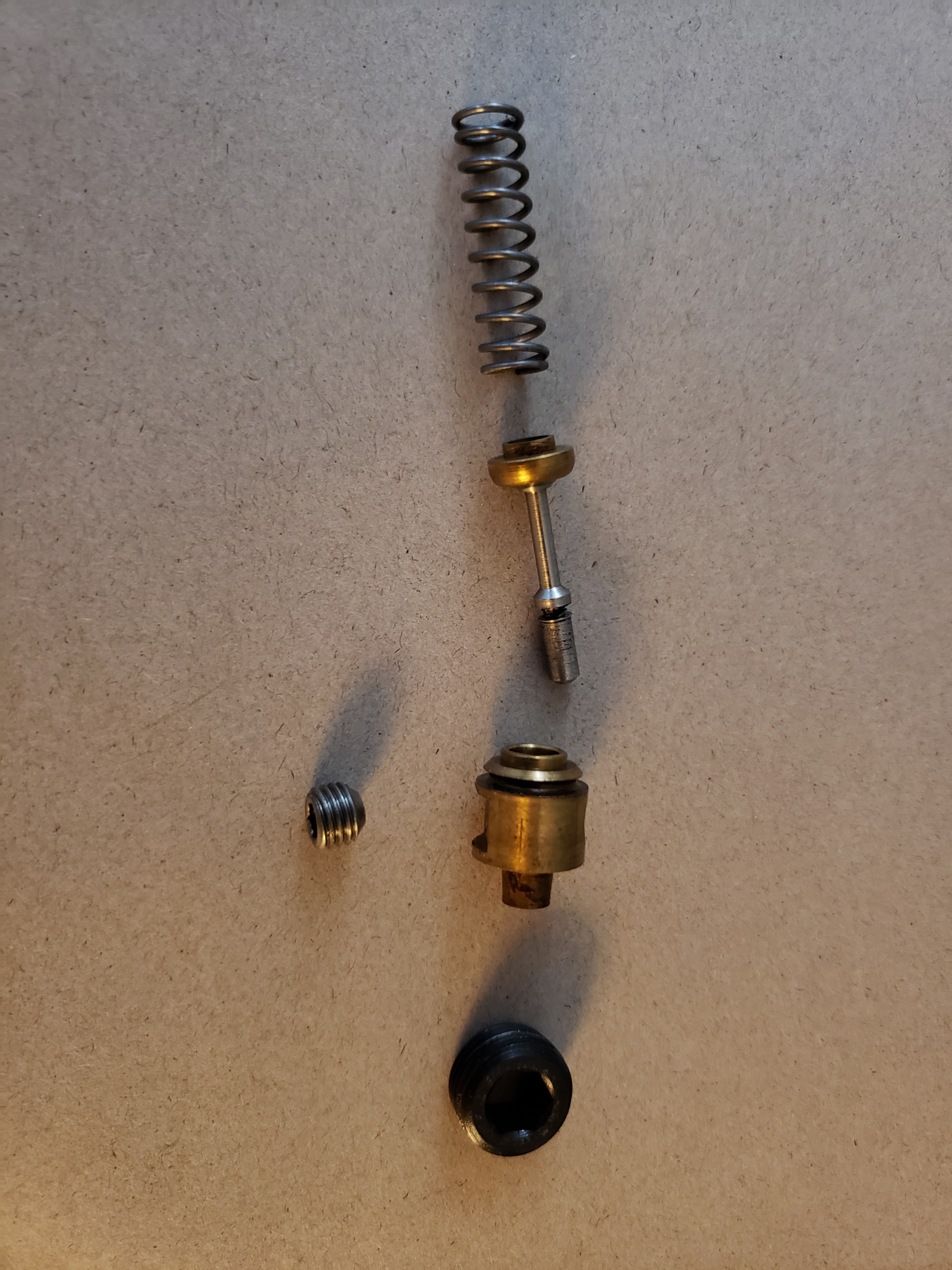

    Got my guts out today. Brass valve, no markings, but the flat for the set screw would indicate an old RAT Valve per latches109
    Got my o-ring kit in from Autococker parts dot com.
    Now to do a full detail cleaning on all the parts, and finish collecting items for re-build.
    Only thing left that im waiting on is a trigger plate and new roller sear.
    Have a could other little mods ill be doing too once the parts come in.
    At this point, I dont really have more questions. I'll probably do a new thread with the complete parts list and rebuild pics.

      Looks like I'm missing the little clear-white sealing "washer" as well. I'll have to pick one up.
      • latches109
        latches109 commented
        no sealing washer - cup seal should be embedded to the back of the brass cap.
      • BlindFaith429
        BlindFaith429 commented
        The sealing washer im talking about is the one between the valve and the valve nut. The newer RAT valves show a clear-white "washer" there.
        Do the older brass valves not use a seal there?

      I'm not a fan of the original Rat valves... they were a big improvement back in the day but 2k+ spec WGP valves outperform them in most areas in my opinion.
      If you really want to stay all original, keep it, but I think you'd be better served with a different valve.
      • BlindFaith429
        How do the old ones compare to the new RAT Valve? Worth the $40? I'd like to keep a ST valve in it.
        Jordan commented
        IMO, there's no comparison, really... old Rats were an improvement on the old Sheridan based valves, the new Rat valves are purpose built for improved flow characteristics and lowered operating pressures.
        Having used both a Rat and Rat 3:16, I'd take the 3:16 any day... and the newest version seems even better.

        yep those old rat valves are terrible, you should mail it to me... I'll be sure to dispose of it properly..

      Thanks for the comments. I'm going to run the old valve for now. I've already spent a ton in parts (sear, trigger plate, ASA parts, o-rings, phat hammer, detent, springs).
