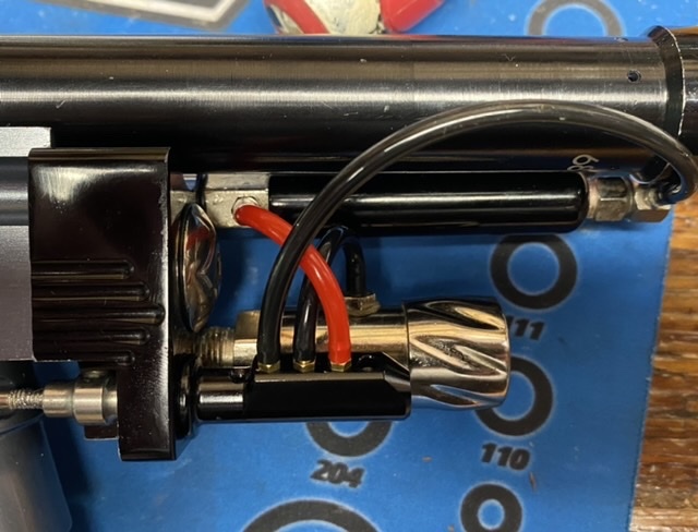

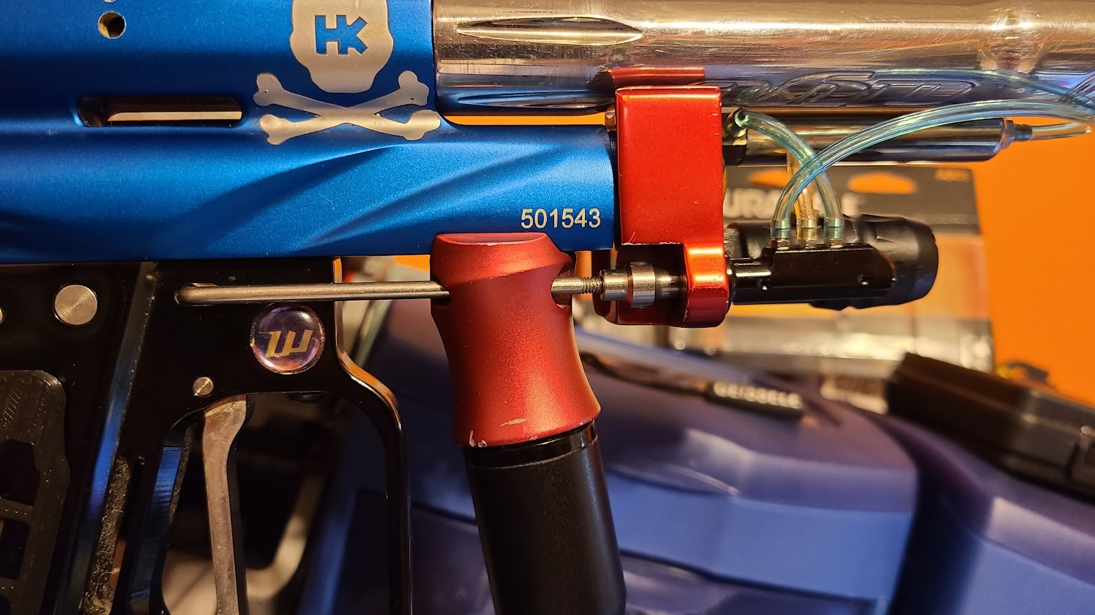

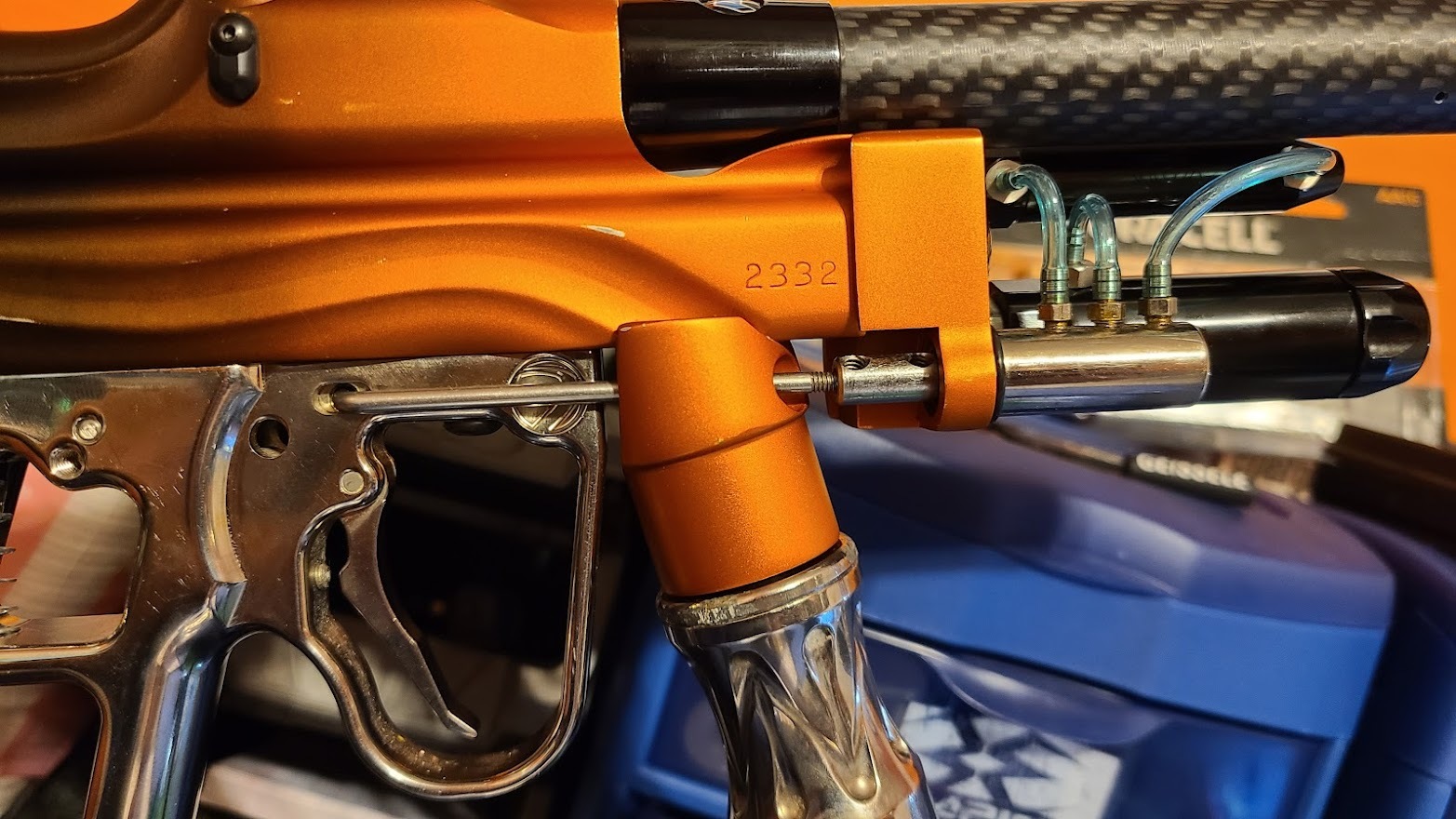

                  Right? Cause I agree it's not the 3-way. Here are a couple pics. Maybe I'm missing something. But if I take the Dye hinge off the Orracle and put it on the blue superstock it will leak like crazy. As they sit in the pics they both work perfectly.
                    • 4472
                    Are you changing the hose positions on the 3-way when changing the frames?
                    • Paradigm 117
                      Paradigm 117 commented
                      The inception 3way works in that hose orientation for a hinge. It's like reversed.
