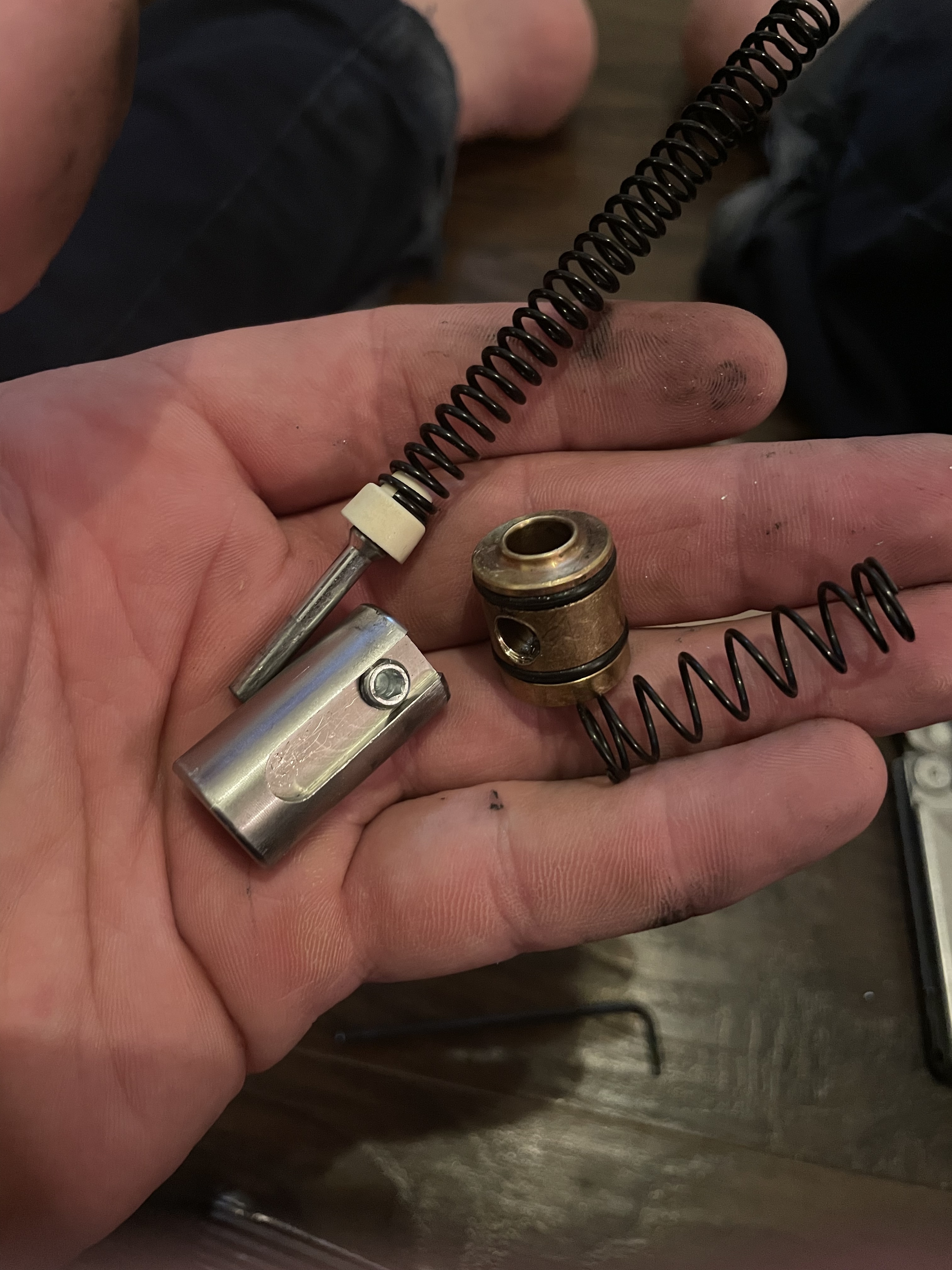

    Did it just go from shooting to instantly dead ? What were the step by step things that went down from working to not.
    • NONOBLITUS
      💀Ragnastock President 💀
      • 1981
      This was the last one I pulled apart , not sure what you got there. E911659E-FB5A-4DE7-B14B-14FA0C283225.png

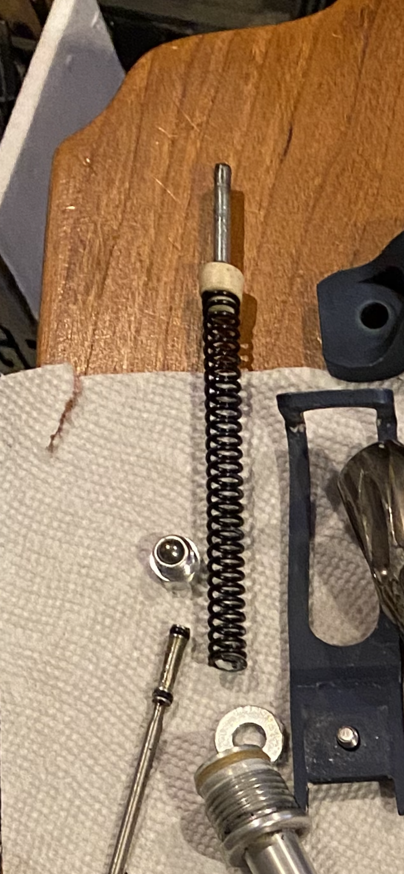

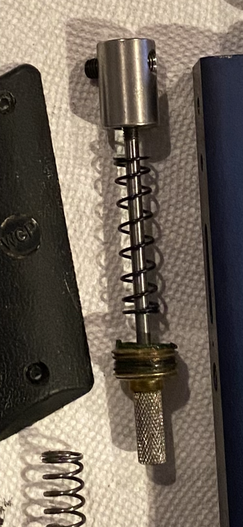

        Far from an expert on a Trilogy but that valve spring in Dauntless image looks awfully long, way longer then would be on a traditional 2K Autococker. If too long it could have way too much preload on the valve preventing the Hammer from opening the valve enough to function. Again I have no real experience with a Trilogy never had one apart on my bench so unsure what correct springs look like.
          Trilogies have massive valve chambers. I believe they use Spyder mainsprings in the valve.
          • Grendel
            Grendel commented
            Roger, I'll go back into my cave and let those who have experience with Trilogy markers continue. Thanks for the clarification.

          Did you change springs? I would suspect a dwell issue.....
          Also, make sure your outlet hole in the valve, aligns with the transfer hole in the body.

              I think my valve is from a pro , not a sport
              which would mean I need a weaker valve spring , I think. Anyone have a sport valve I can swap it for ?

                    Your springs probably died. Trilogy springs are notorious for weakening very quickly.
