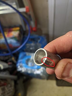

    -The bolt has wear on it, particularly where I THINK it rubs on the detent (see picture). Is this a "problem?"

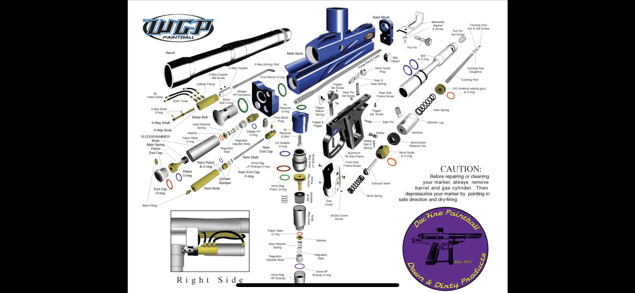

            Man I've been digging on this a bunch. I can't find like, a definitive o-ring list. I ordered this a few days ago thinking it would work:
            https://www.amazon.com/gp/product/B0...?ie=UTF8&psc=1
            I don't have an Empire Res. cocker but any idea if this should be compatible? They don't list out all the o-rings in the kit so I've been trying to find a list of the Empire o-rings vs. WGP 2k.
            • autococker04
              • 1878
              • Pittsburgh
              https://autocockerparts.com/cart.php...2-4e8f74fdd6ed These are the oring kits I usually use, I’d guess there’s a lot of compatibility between empire specs and 2k wgp, but they’re probably not perfect. Also you’ll probably want to at least flip your reg seats over to get a second life out of them if they’re not mushy. This site has everything.

                Watch allot of paintballtek on YouTube. He’s got videos on how to rebuild your reg. Also, learning the terminology for all of the components first, find a diagram, it’s a pain, but once you know it all it’s allot easier to diagnose and troubleshoot problems. On autocockers everything is connected to everything. That’s why timing is such a big deal. I managed to get a stock 2k2 similar to your and haven’t and won’t touch the timing. It shoots like a champ now. Sure I could lighten the pull, shorten the stroke and lower the pressure to sweet spot it but why? It doesn’t break paint, anyone can use it, and it works, which is rare for cockers.

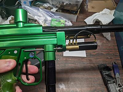

                        All right my o-rings came a lot quicker than I thought. I'm putting everything back together on the front end block. I'm running into two weird things I can't get the four-way barbs to line up. The threads bottom out and they are facing down. I've tried re-catching the threads a few times and I can't seem to get it to clock correctly. The second problem or I guess question is when I put the low pressure regulator back on it seems to bottom out very quickly like there's a good six or seven threads left. I don't want to torque it down and strip anything but it just seems weird. Any advice is welcome and thanks again for all the advice so far.
                        • superman
                          superman commented
                          put a 010 oring on the base of the threads of the 3 way.
                          check out the threads in the front block and make sure the plug in the bottom of the front block is not sticking up to where it would hit the lpr threads when it is threaded in.

                        The plug wasn't even in it so that really wasn't the problem. I don't want to risk stripping anything so I'm just going to hand tighten it with some blue thread locker and call it a day. It looks like there's threads cut into the channel like all the way through and I could screw it in deeper on top of the plug but that's where it starts to bind up is when it starts to enter that hole where the plug is so I can screw it in flush and that's about it. If that makes any sense?
                        The o-ring trick worked perfectly thank you.
