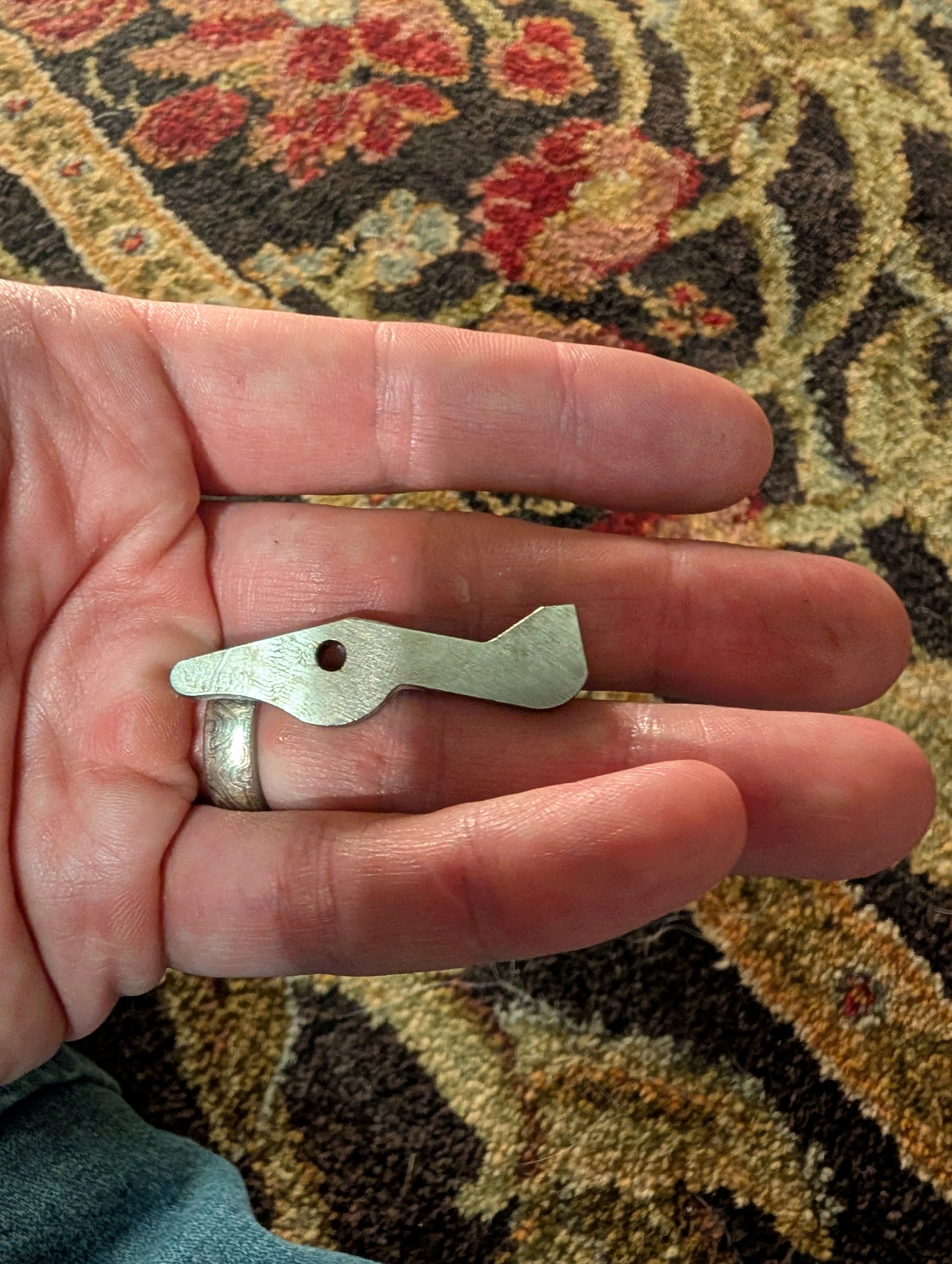

                              So I literally had this same thing happen to me with an pre 2k ans slider. I changed out the sear to a wgp roller and works fine now. It would catch but as soon as you'd cycle it wouldn't. Here is the picture of the sear I pulled out. Works like a charm now
