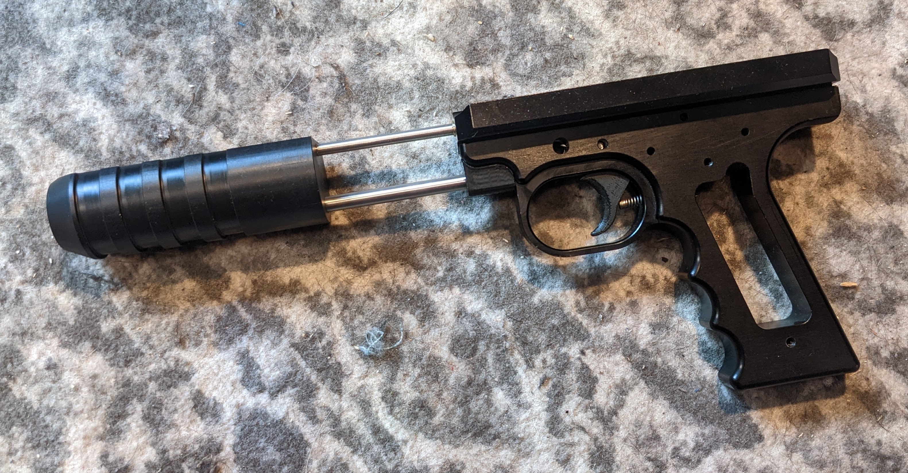

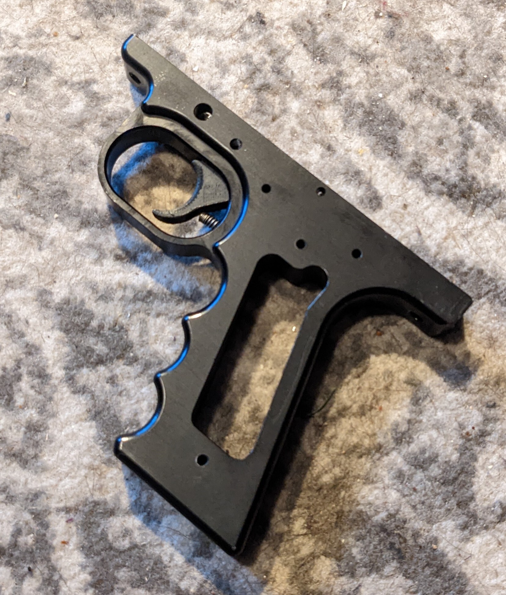

    1) The frame:
    I could go the easy route and use a CCI trigger group and a fancy grip, but where's the fun in that? Here is the frame I want to use.
    I have made it work for phantom already, just need to clean up a few things and it's gonna be good to go πŸ‘

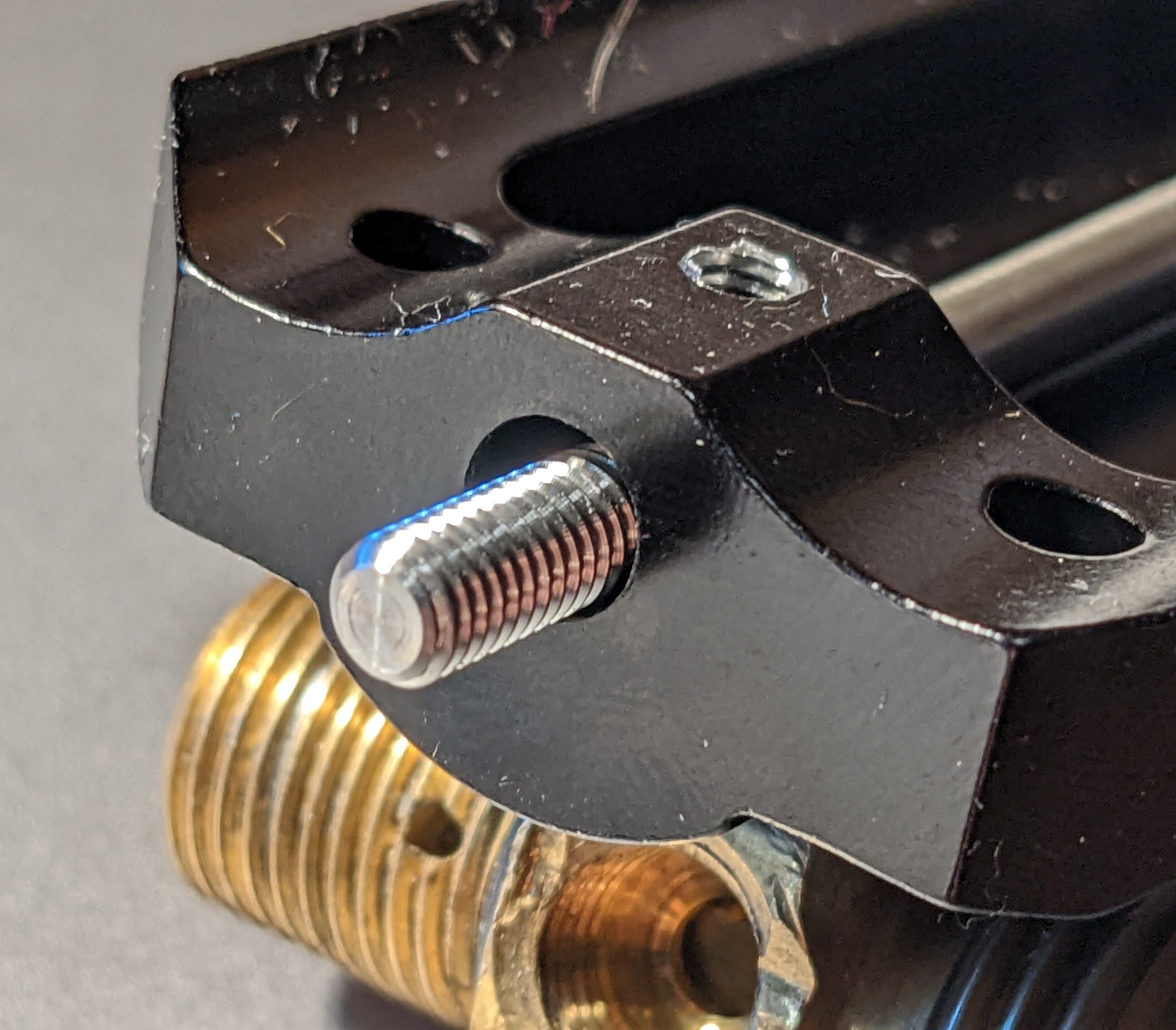

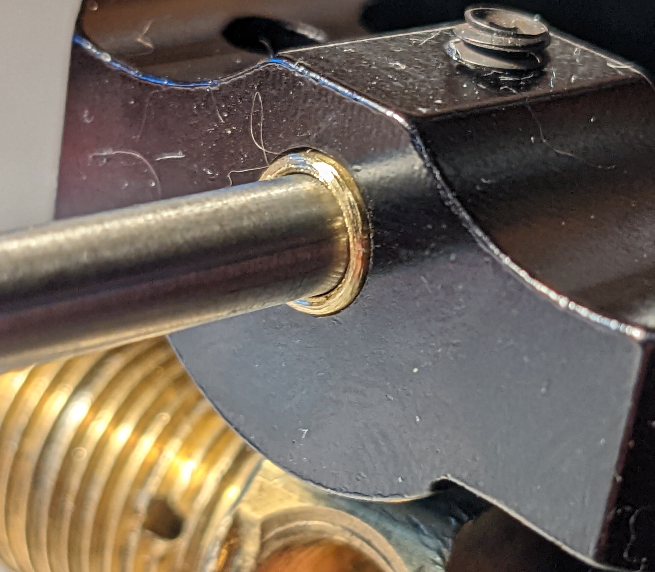

    Next i noticed a large gap on the Phoenix kit where the cocking rod rides, it has to be that way to be able to be assembled, but a bushing takes all that slop away πŸ˜…
    Before:
    After:

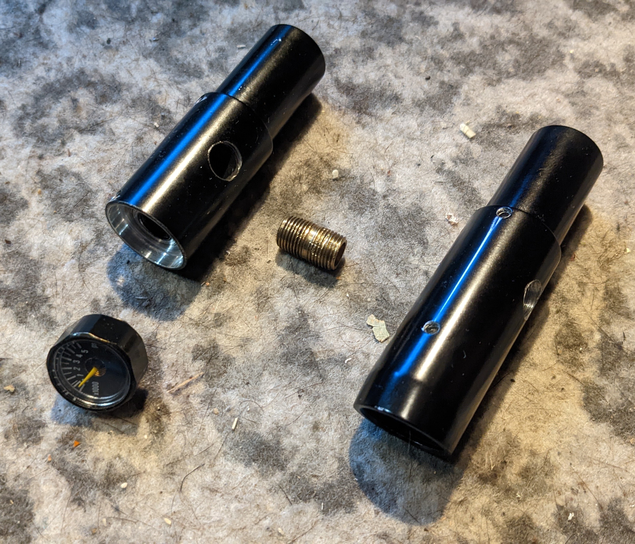

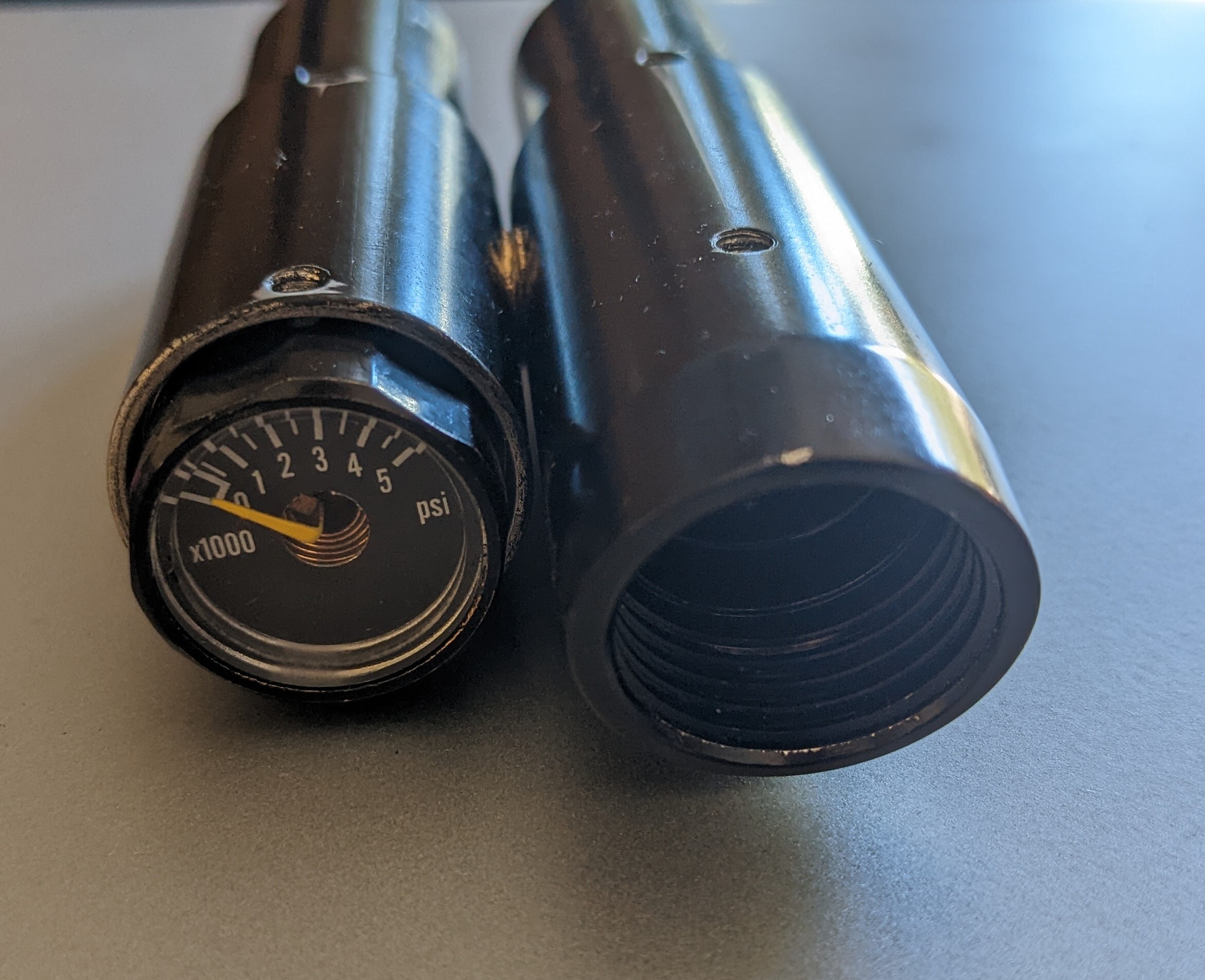

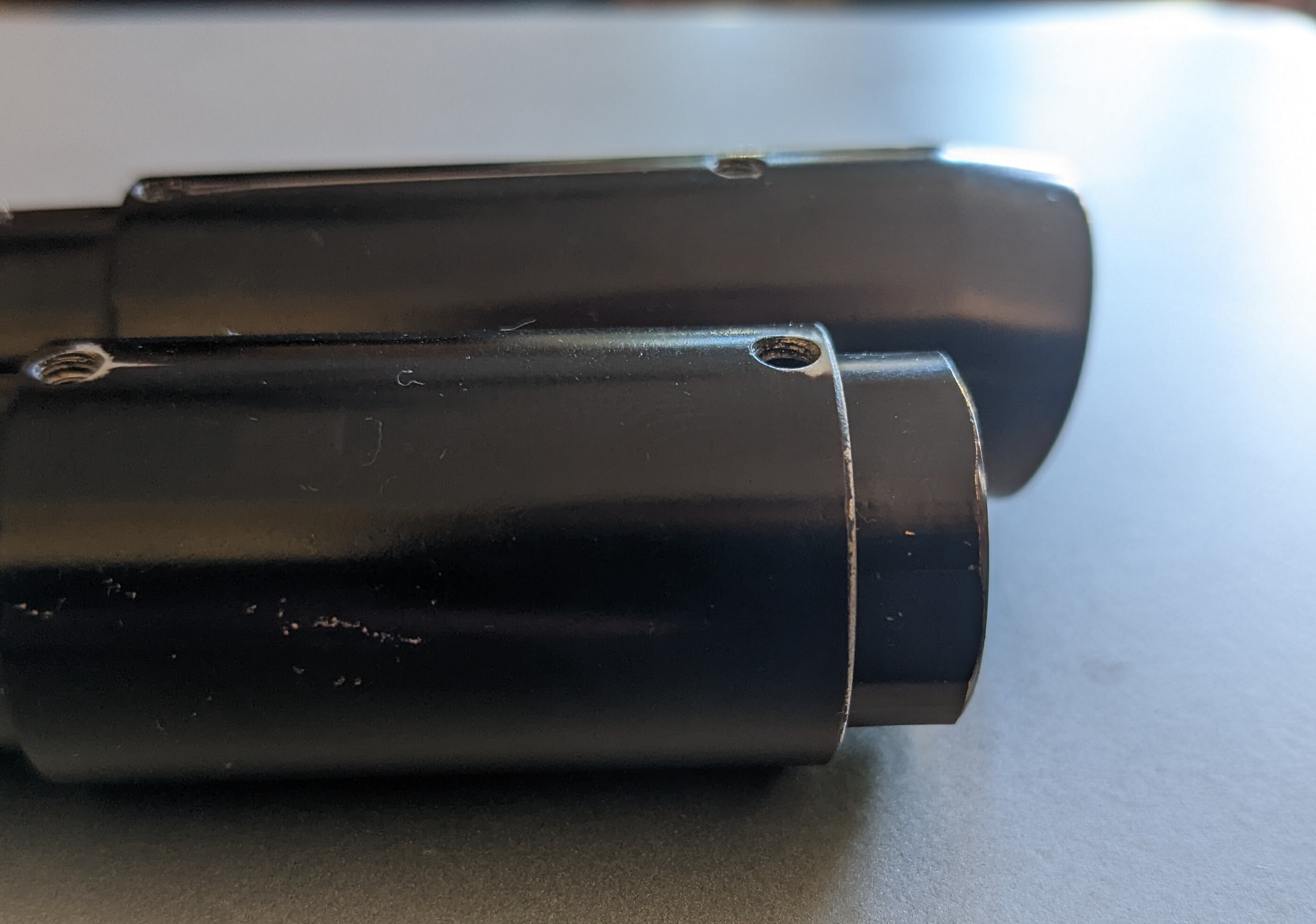

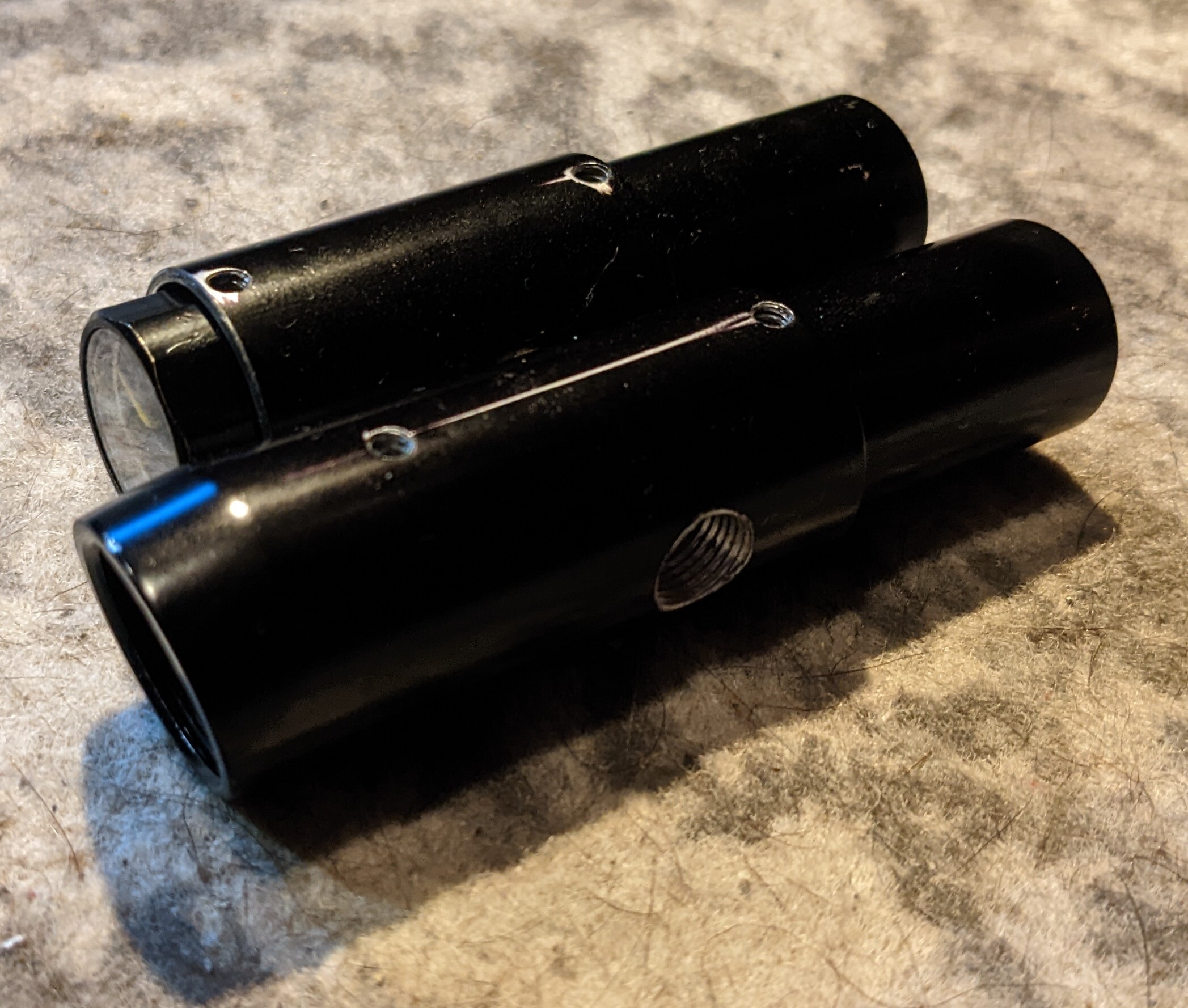

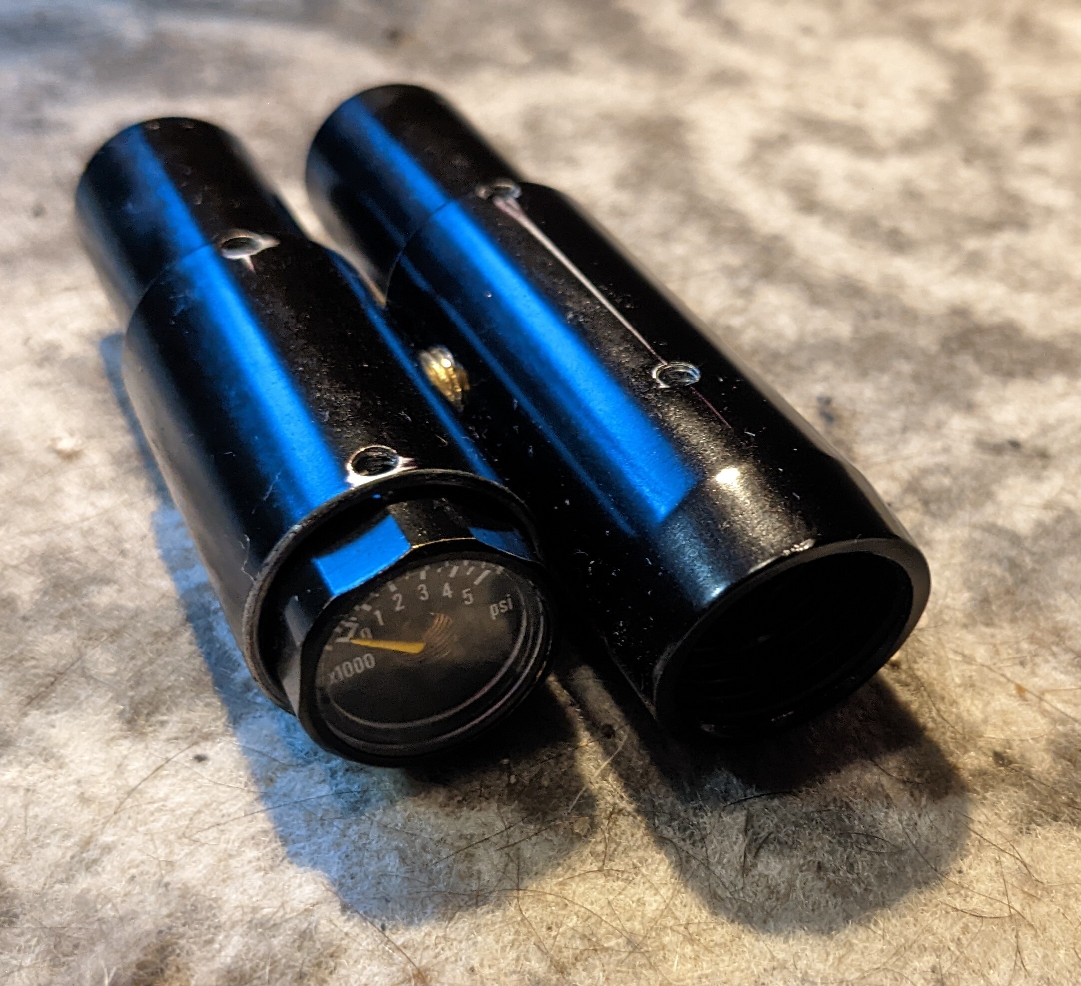

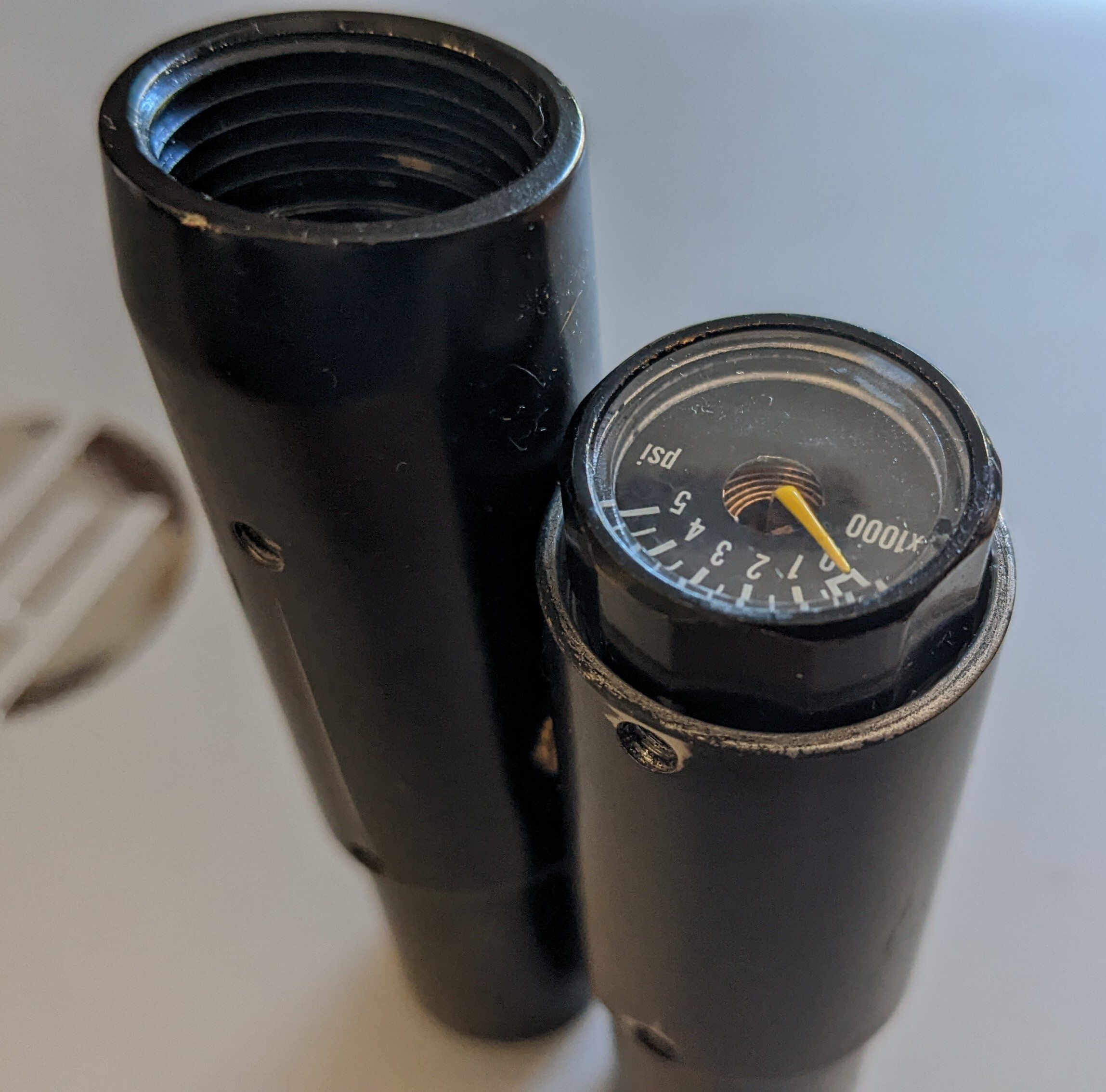

    2) the valve:
    I like BBA, but I also want to be able to put a vasa or bottom line asa ... And I don't want double macro lines ...
    So I started with 2 BBA valve bodies, side taped the right one on both sides and popped the back of the left one for a gauge.
    Click image for larger version  Name:	PXL_20220827_001258958.jpg Views:	142 Size:	1.43 MB ID:	310248
    Click image for larger version  Name:	PXL_20220827_001330924.jpg Views:	136 Size:	749.8 KB ID:	310249
    Click image for larger version  Name:	PXL_20220827_001334527.jpg Views:	136 Size:	613.5 KB ID:	310250

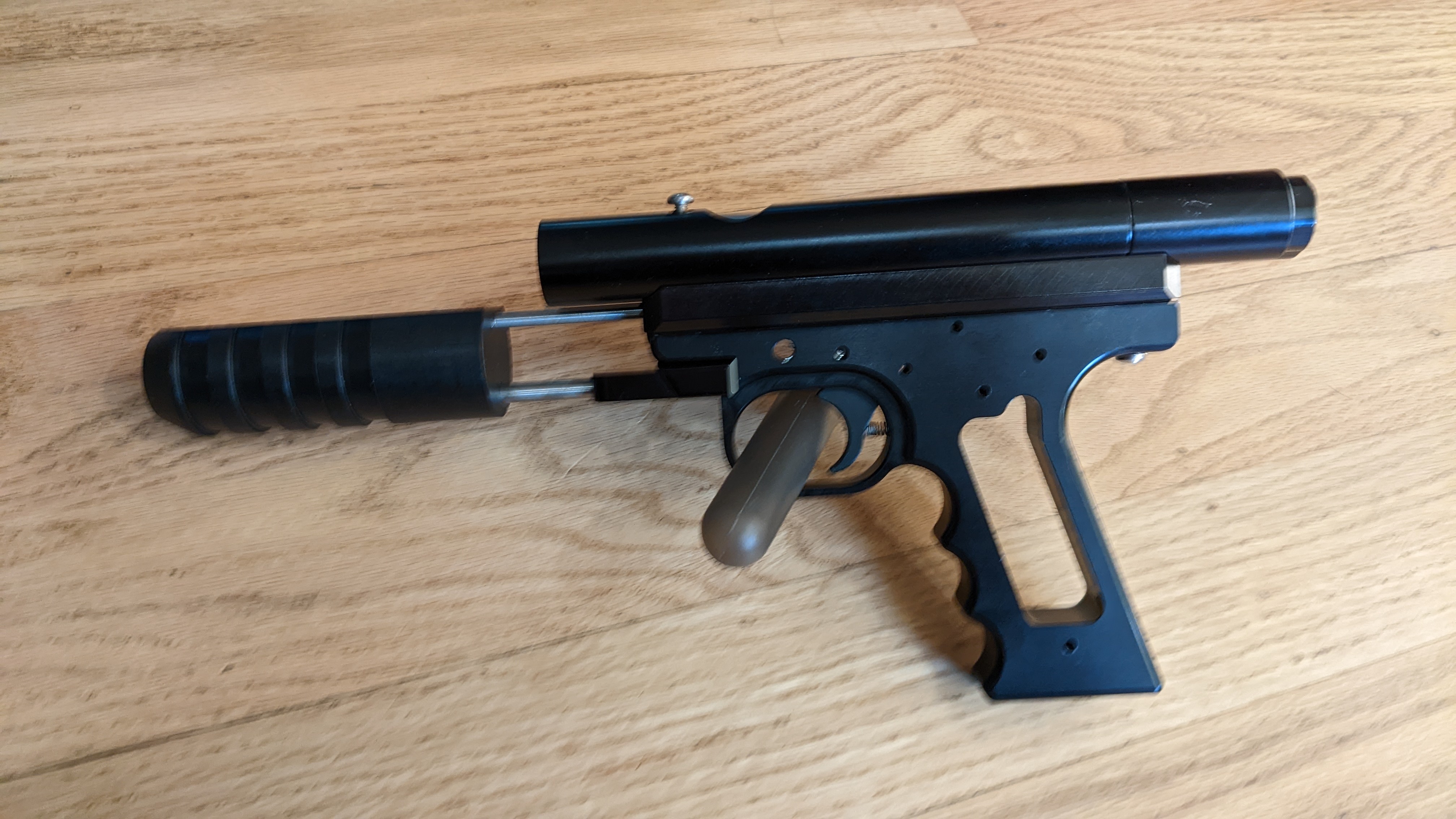

    3) The pump guide.
    this is a prototype/moch up, but that's the idea.
    I need to tighten up the block design and machine a rod the proper OD (this is just a 1/4" tube I had laying around)
    Click image for larger version  Name:	PXL_20220827_001853496.jpg Views:	139 Size:	1.65 MB ID:	310251
    ​​​​​Looks just like the mockup, but with a solid pump rod and finished block i now have a functioning pump kit.
    I may tweak a few things to try to make it slightly smoother toward the end of the stroke, will see how it umps when fully assembled.

            • 1960
            Yessssssss , I’ve been waiting for this build. Looking forward to it and I need one of those bushings for your Phoenix sibling that lives with me.
              XEMON commented
              I made 2 spare 😁
              PM me your address and I'll send one to you πŸ‘

              Originally posted by Spec
              Love the joint valves. So clean!
              I stepped the body so the threads would be hidden.

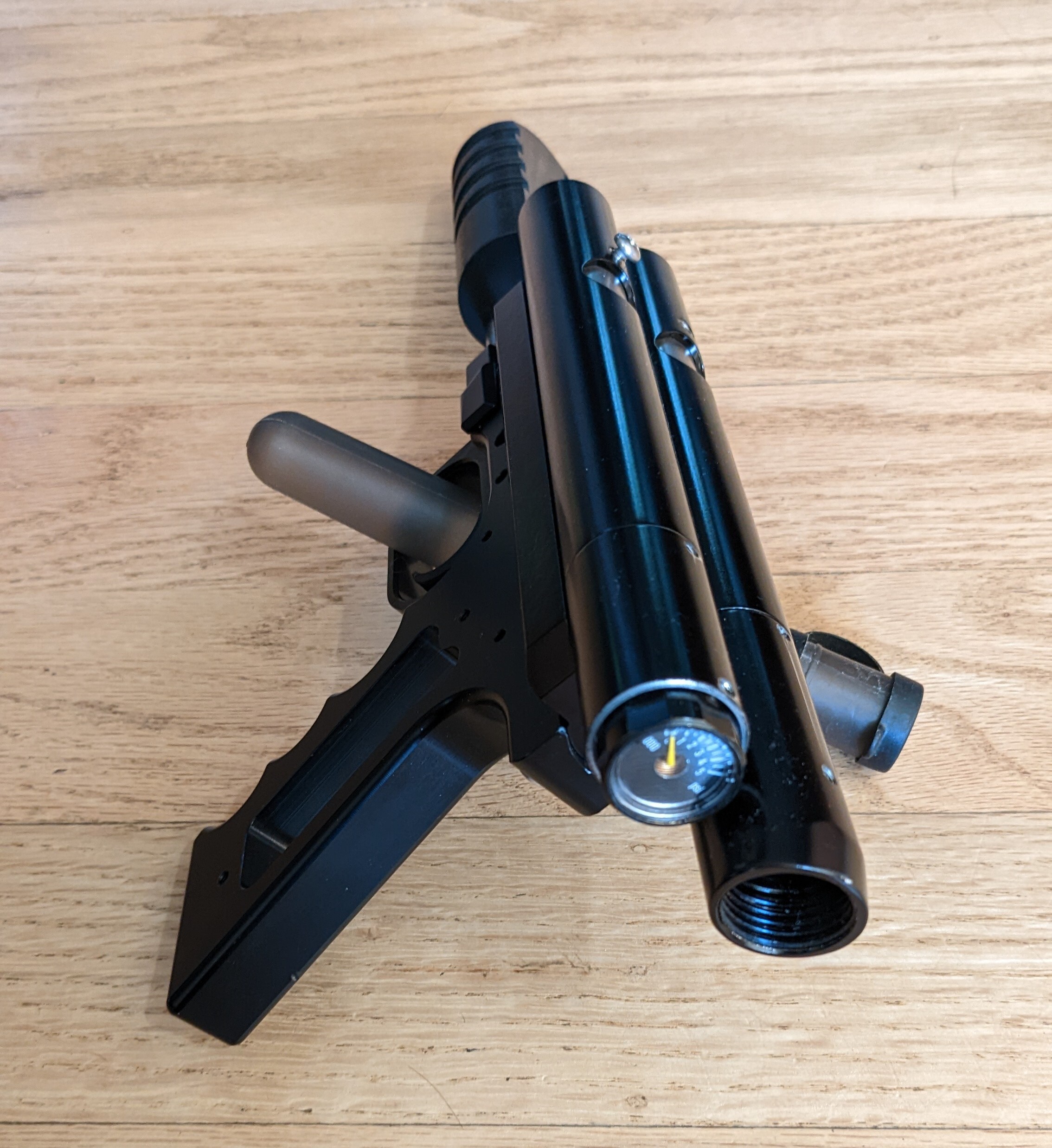

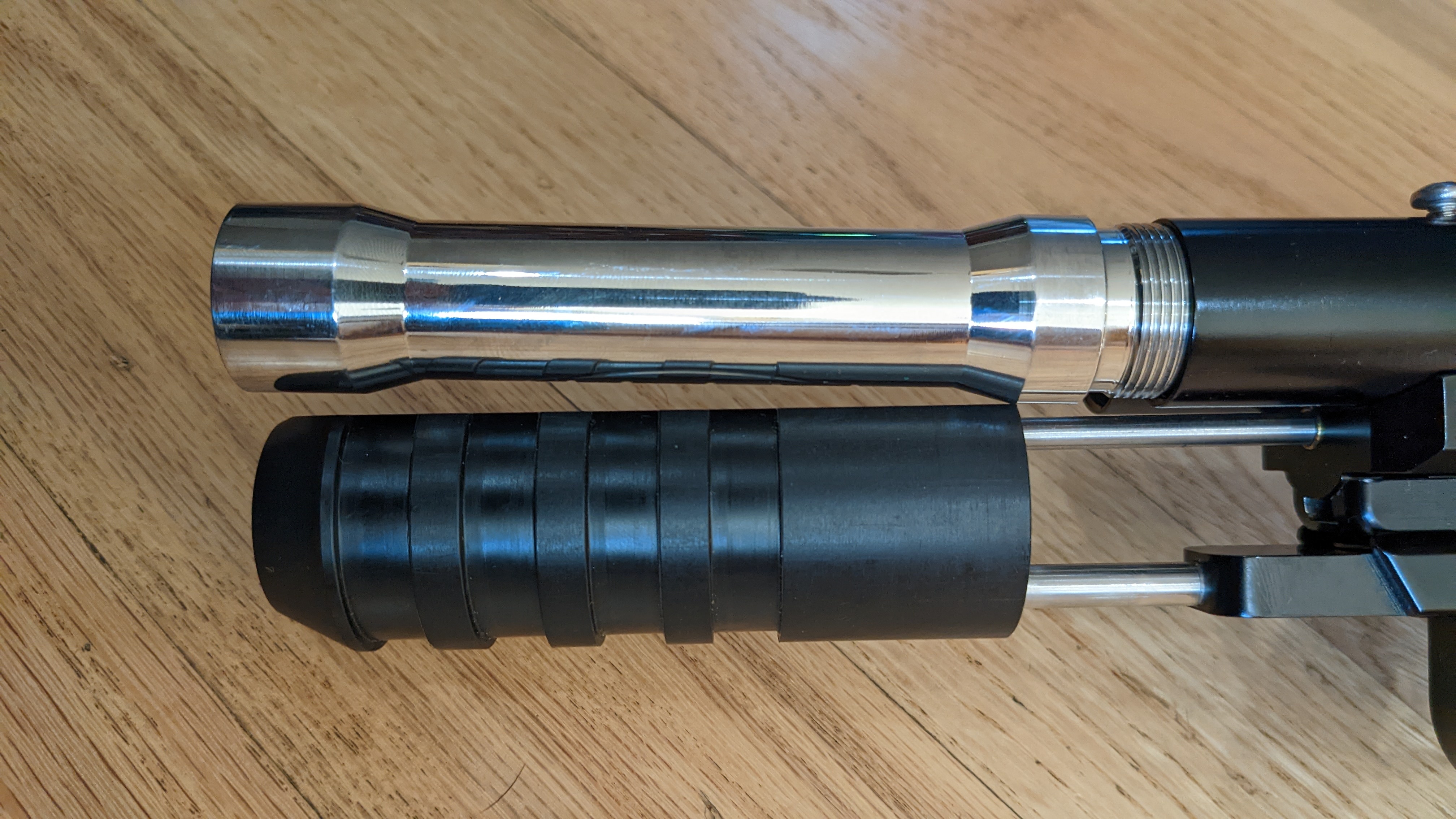

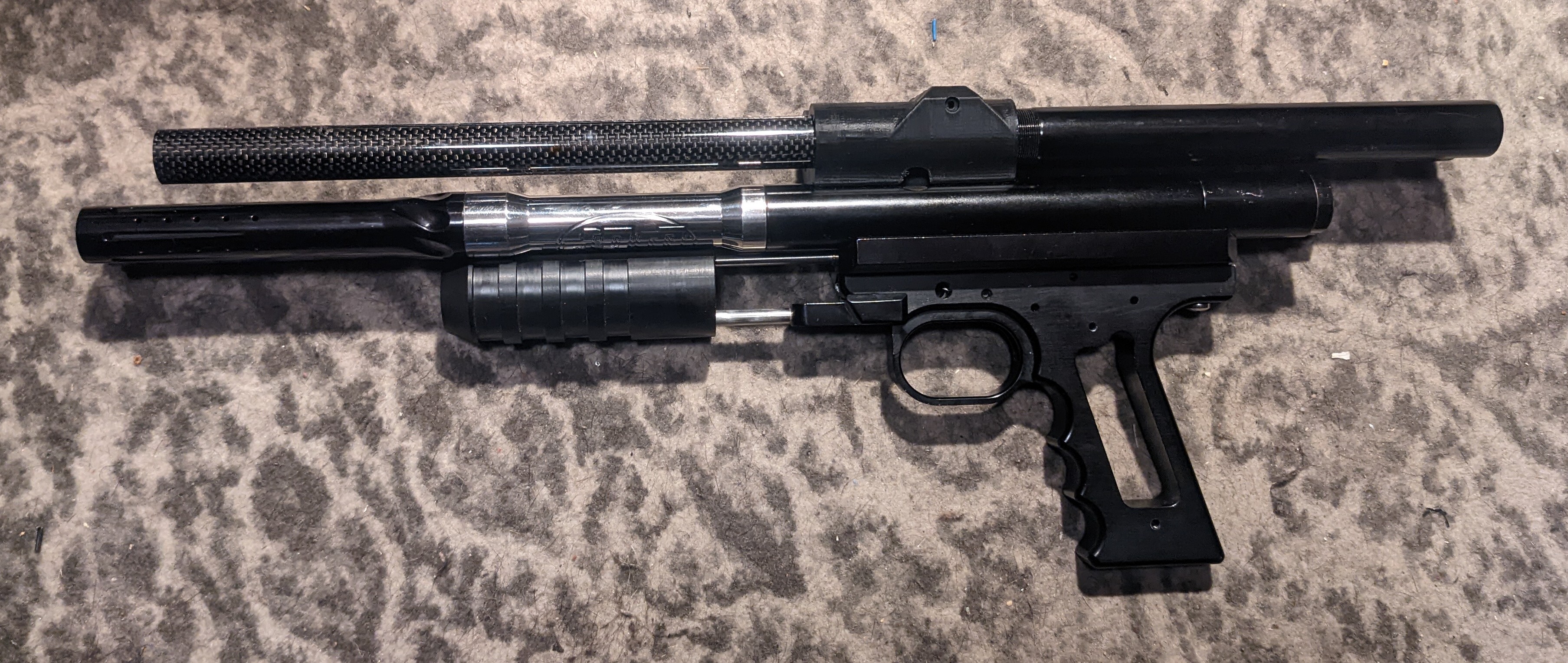

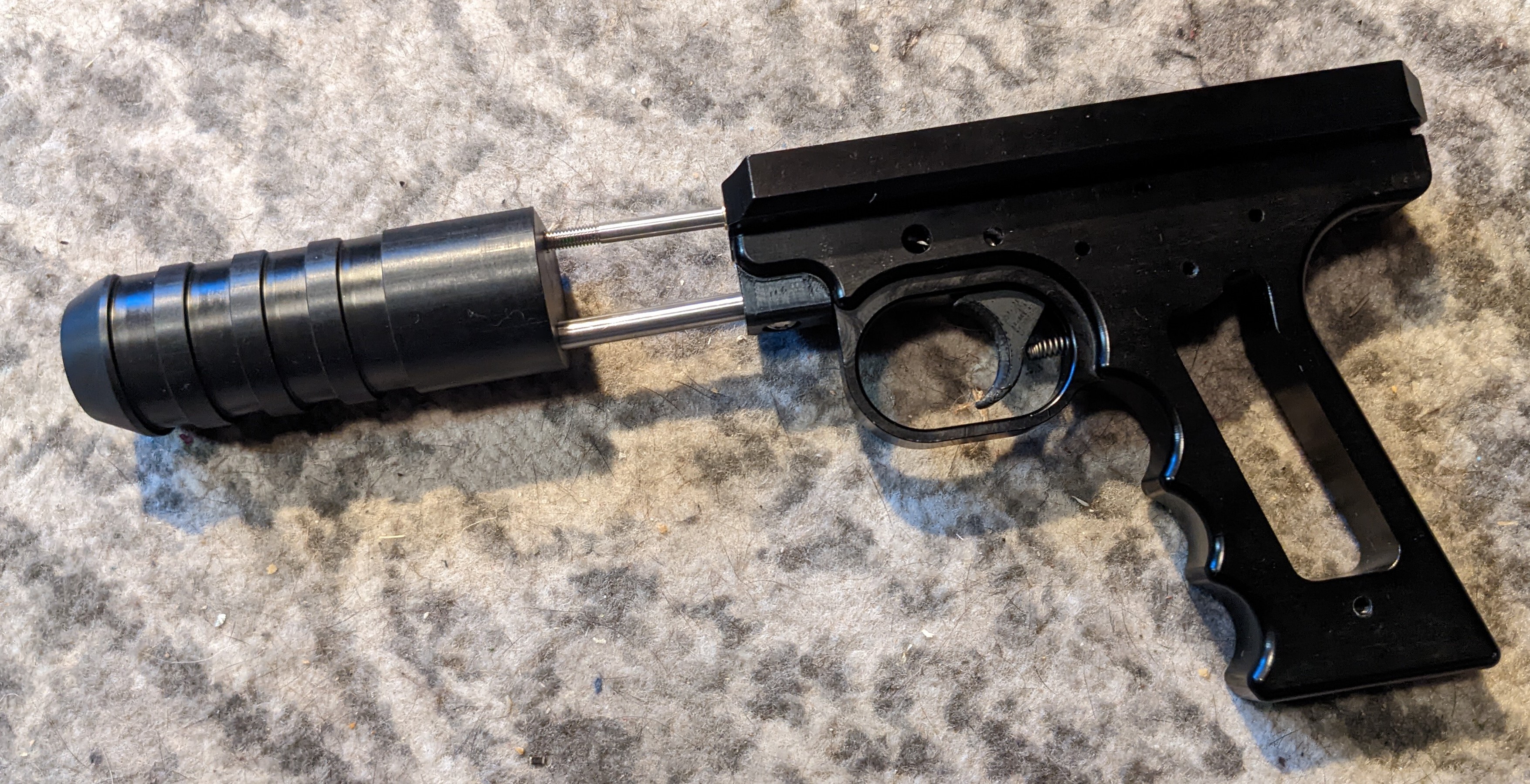

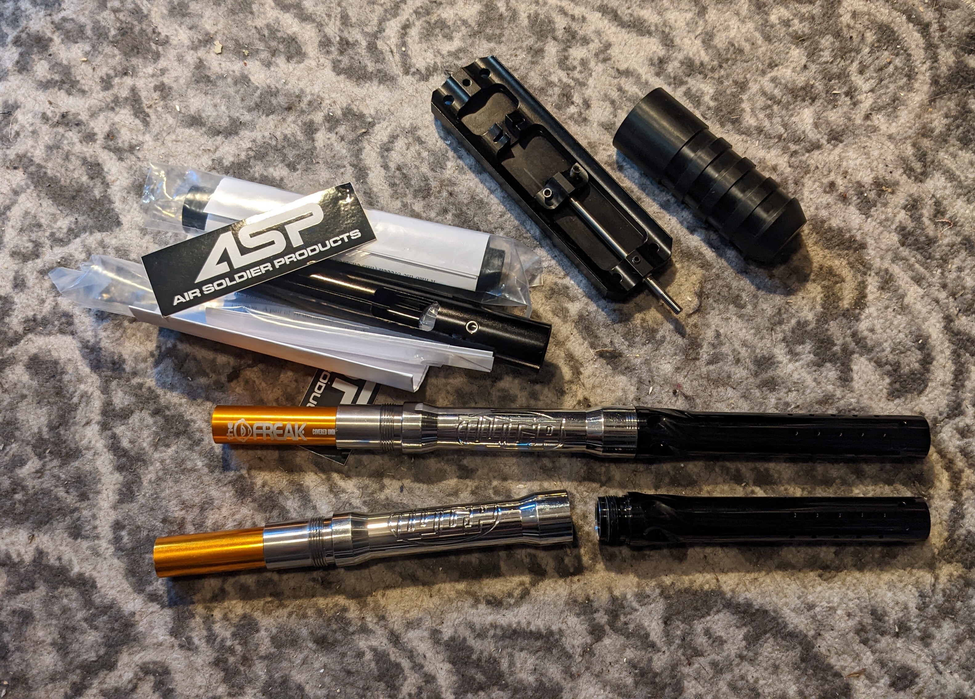

                  Thanks to NONOBLITUS for the hardware and Nish for the pump guide.
                  Here is first moch up:
                  But the barrel doesn't fit with the original pump handle ... So I'll have to machine it a bit to fit the cocker barrels.
                  Now I need to finish the custom trigger and the feed ...
                  • NONOBLITUS
                    NONOBLITUS commented
                    My handle rubs just a hair on stock Phantom barrels. I want to see about having a new handle made
                    XEMON commented
                    Once I do mine, I can do your's if you want ...
                    Might eventually make a new one, but no idea if/when ...
                  • NONOBLITUS
                    That would be awesome !
