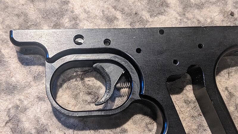

    Got the trigger figured out πŸ˜…
    3D printed with a titanium skid plate ...
    Still need to fine-tune the spring, but it's usable as-is πŸ‘

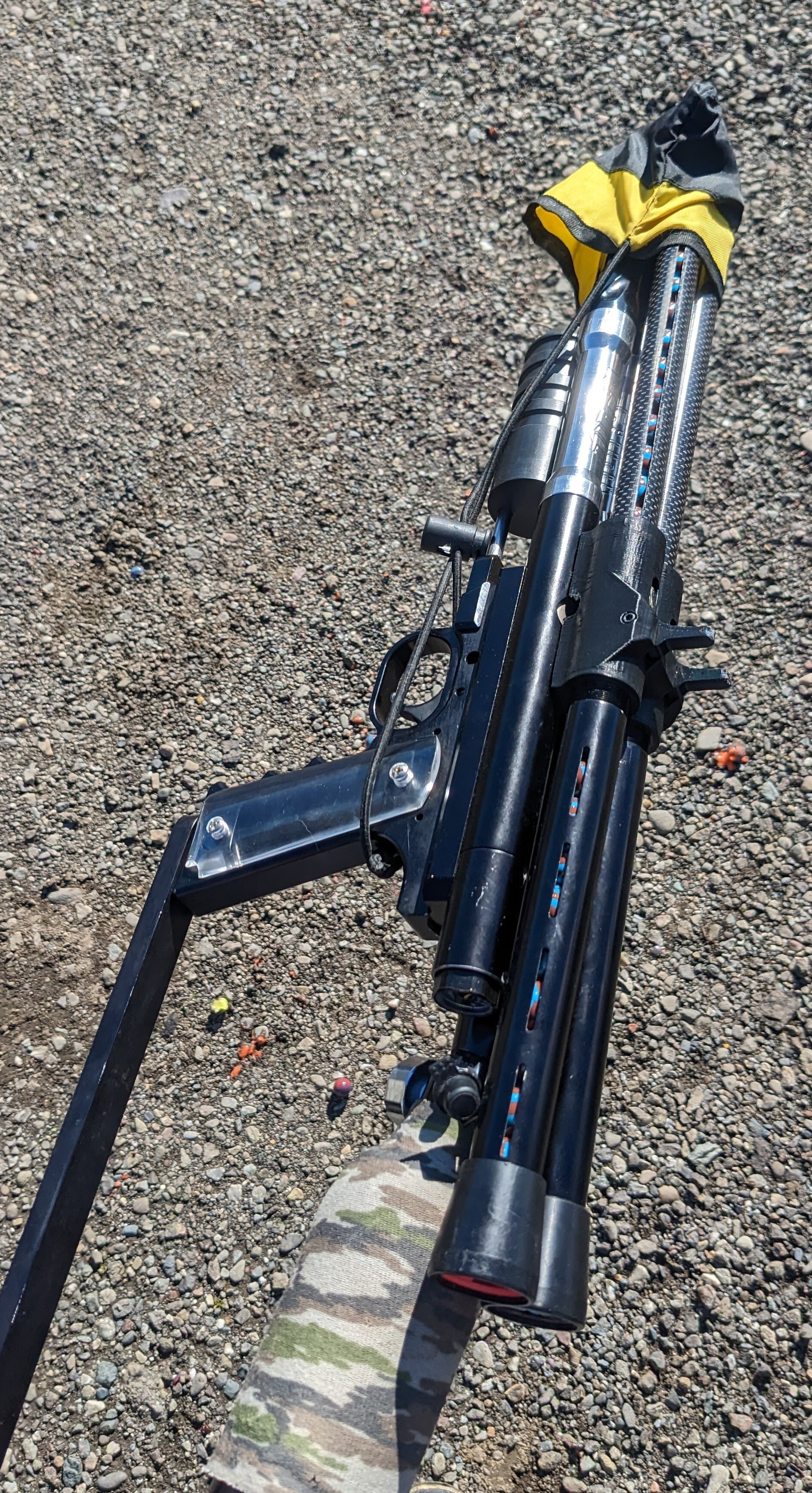

        Last minute trip to the field yesterday, so rushed assembled to have it functional!
        The spring feed gave me more trouble than on a single barrel phantom ... So I removed the spring and rocked back 🀘
        The stock got in the way, the 9ci on the back is perfection!

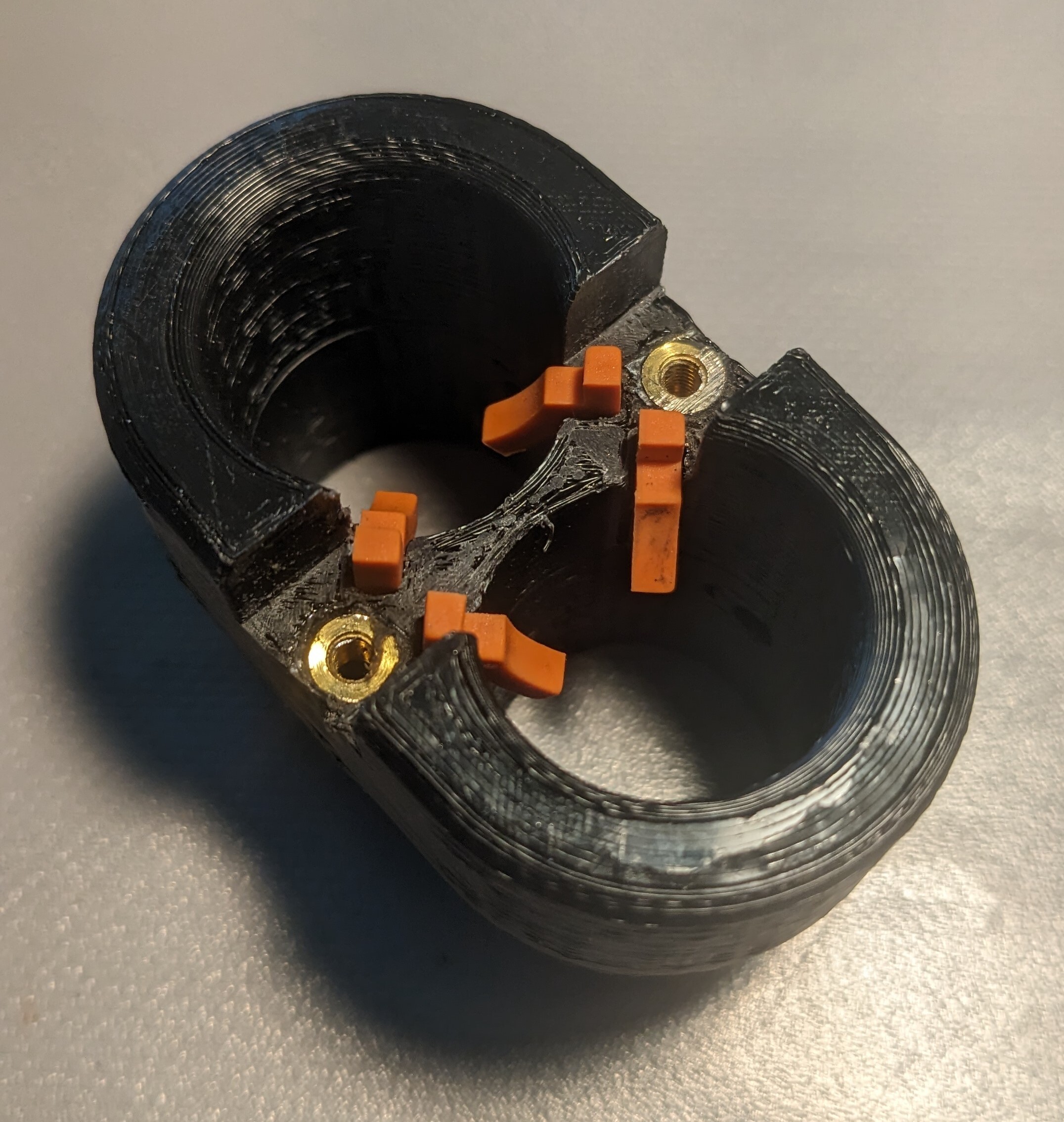

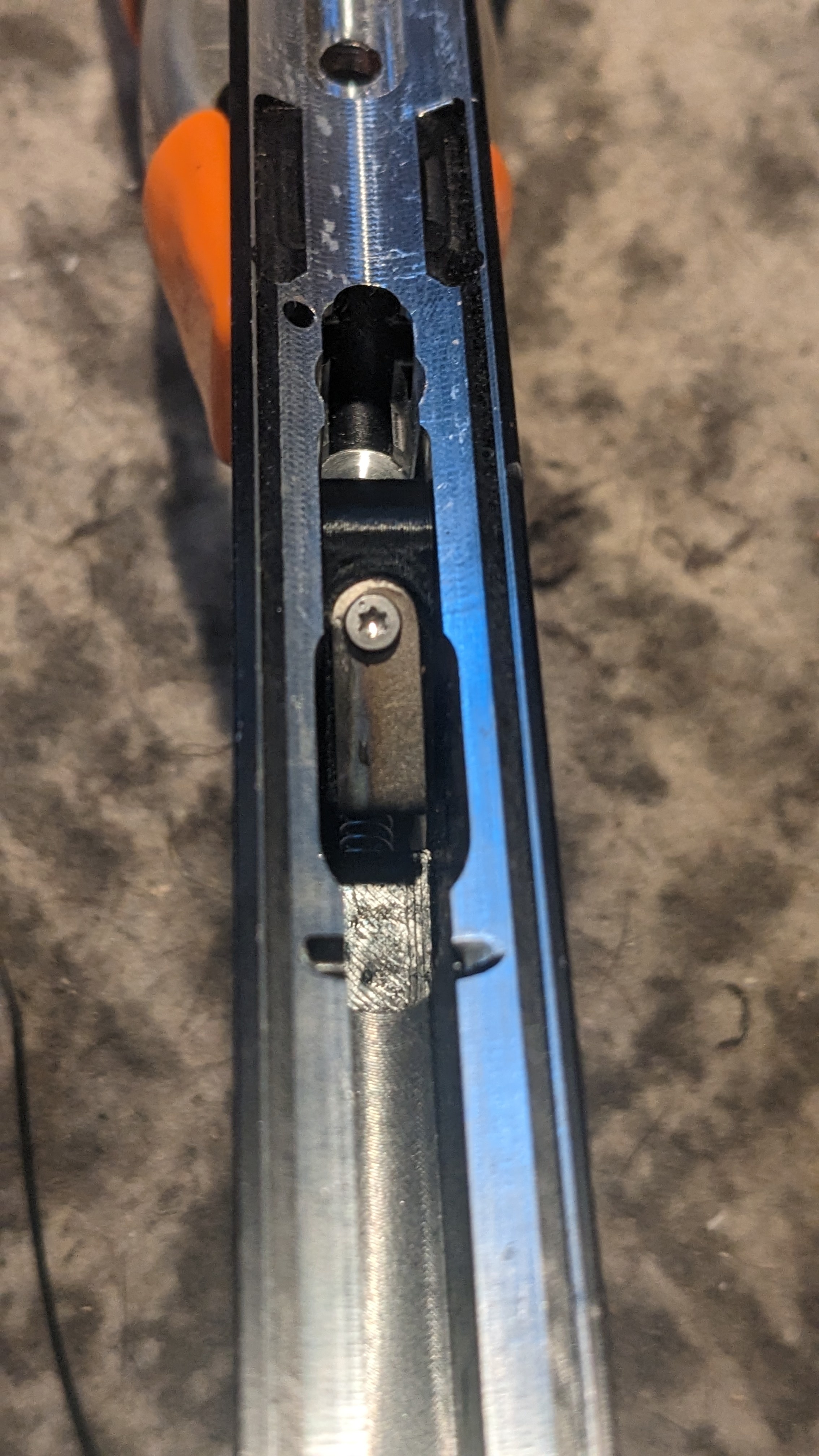

          my issues were 2 fold:
          1) more double feed than usual: I forgo the orings n the roundhead, put the oring on and no more double feed! (I feel kinda dump for that one πŸ˜…)
          2) the second ball drop too low and has issue returning into the feed (alway going to be an issue on breach drop), got some tweek to teh geometry, will see how they work πŸ‘
          The good news is that i will also implement all those tweaks into the next batch of feeds

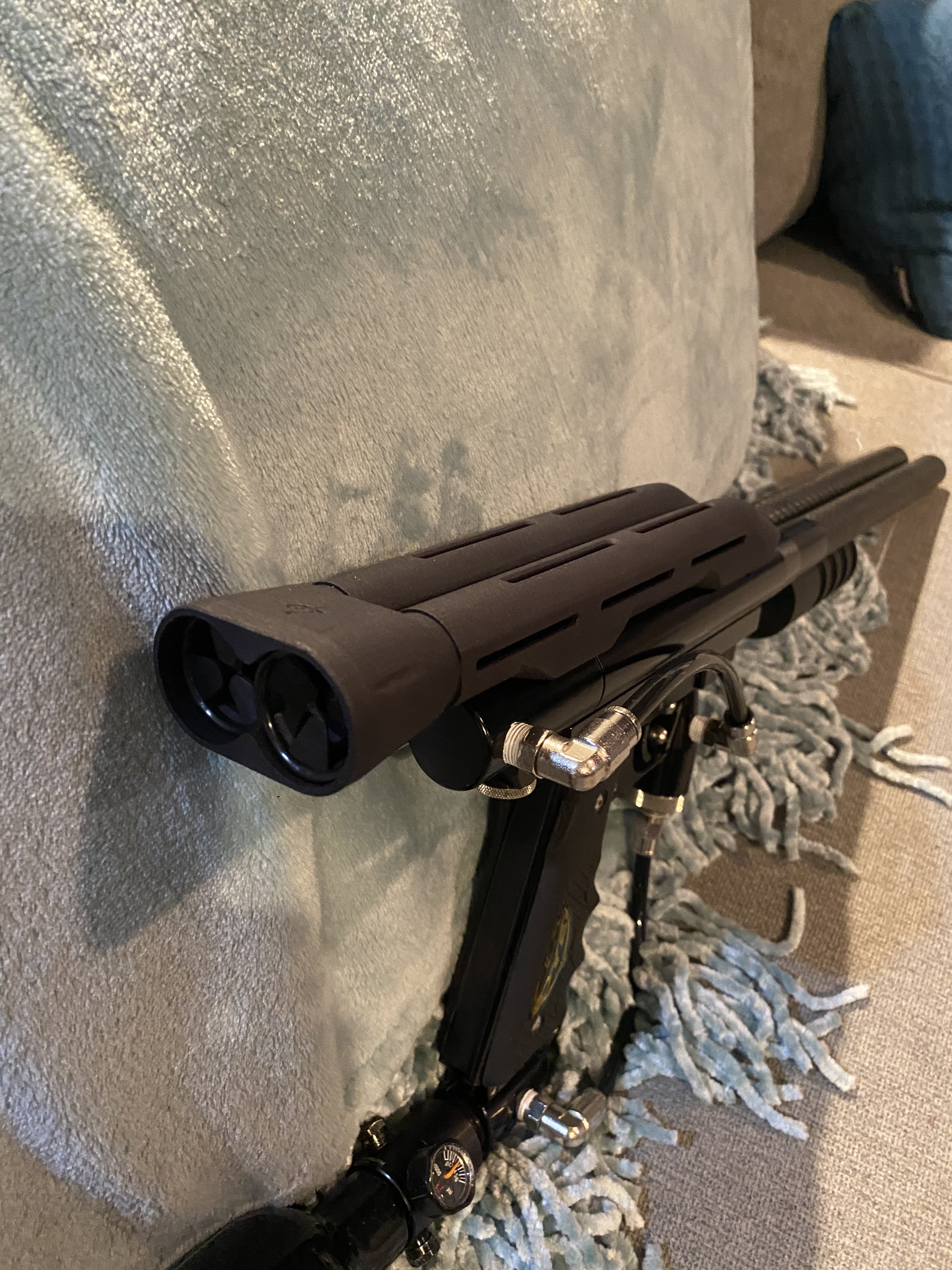

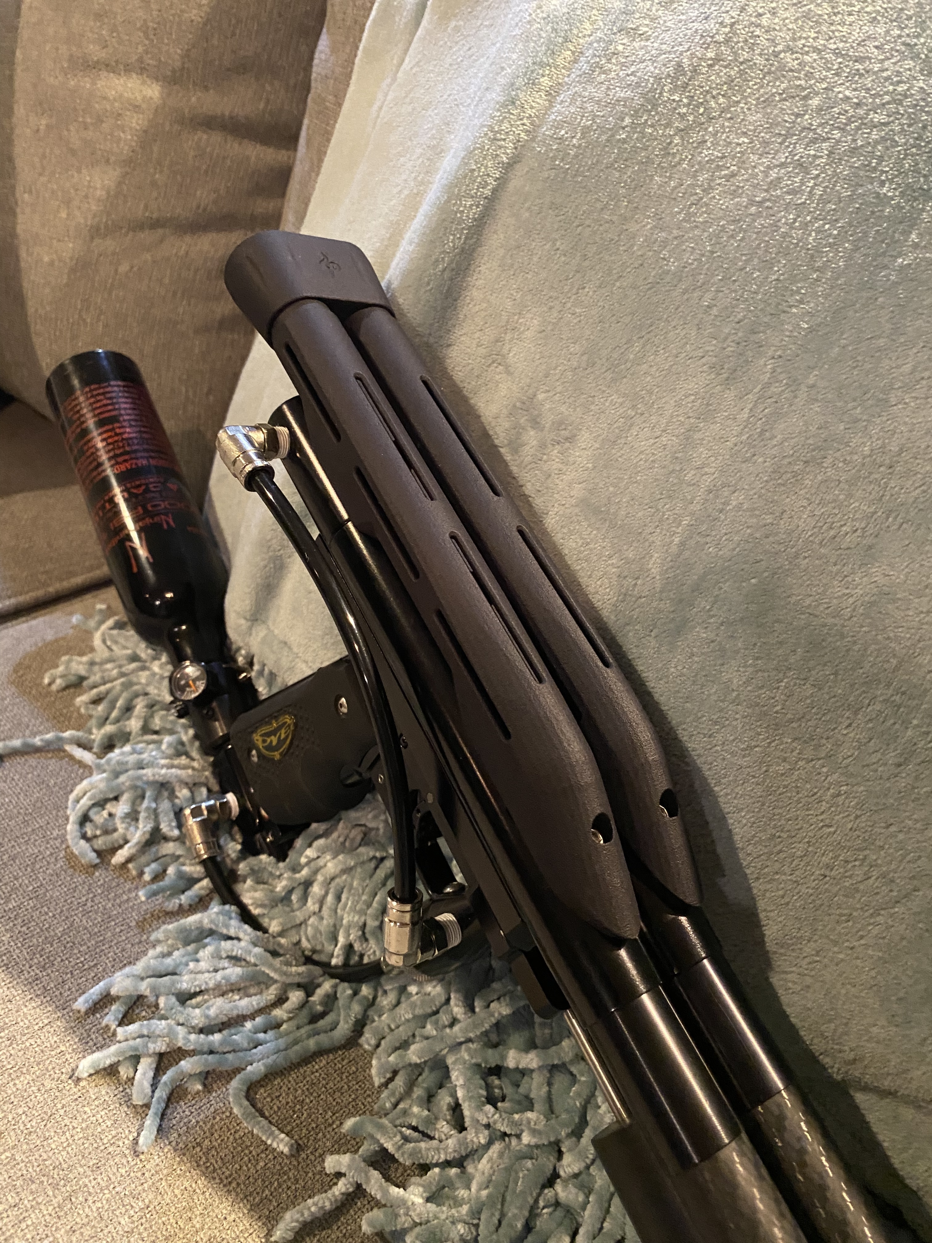

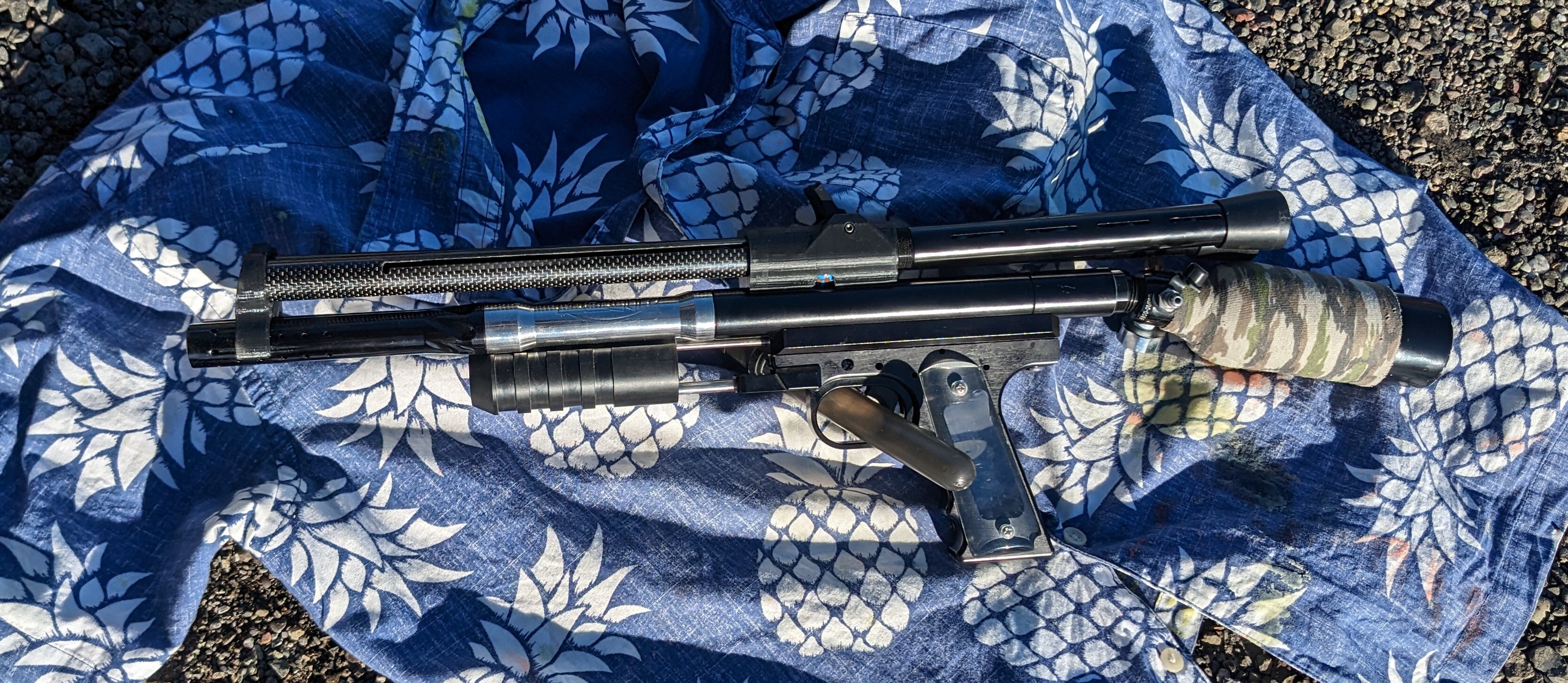

            For some flare added this weekend.
            still need to do the rear gate, the stock CCI are to wild to fit both tubes.
            Next is the VASA ... Frame milling time!

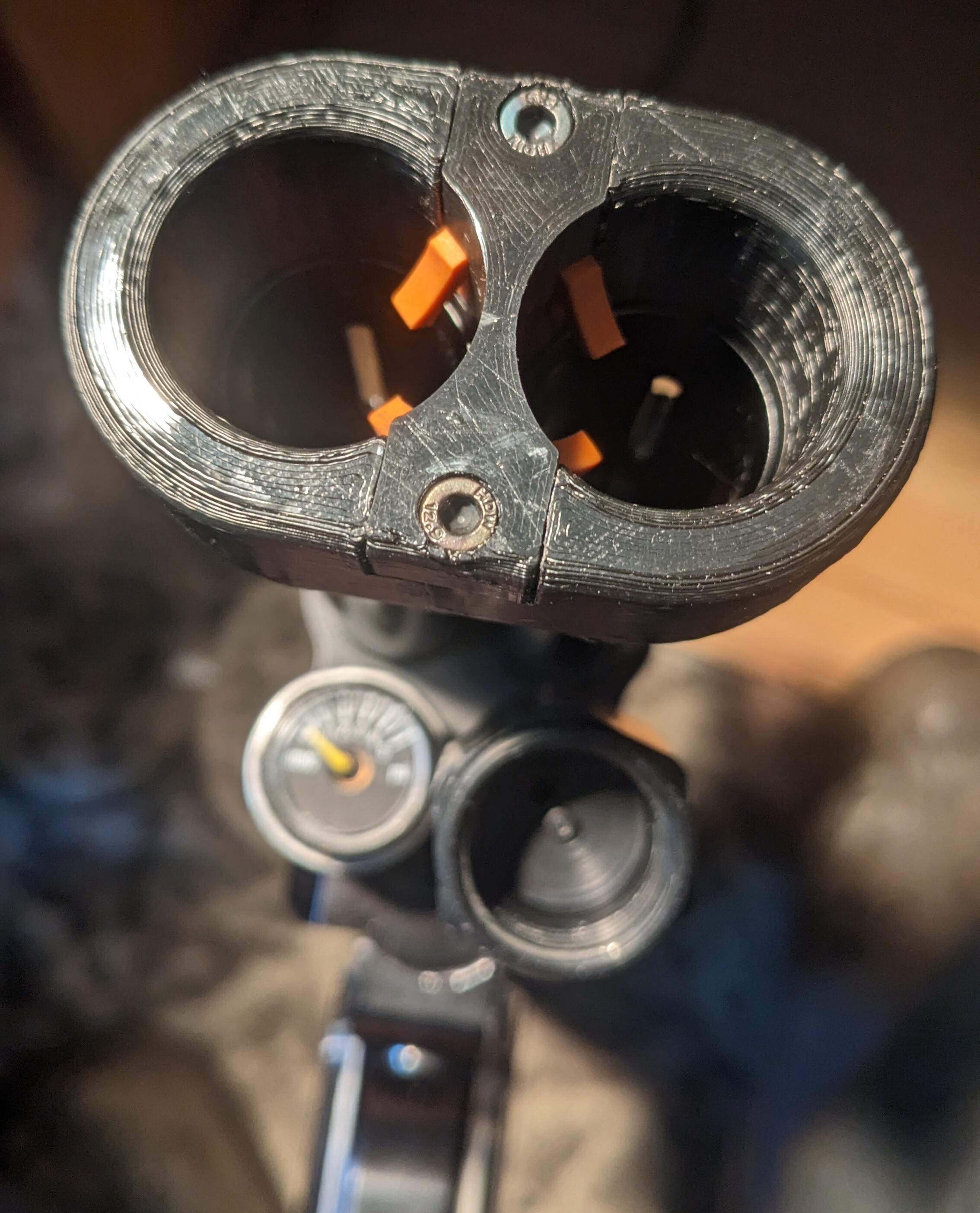

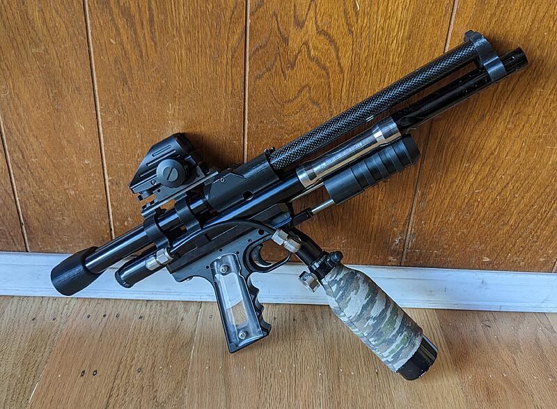

              And here is the final version:
              Click image for larger version  Name:	PXL_20230131_222127189.jpg Views:	0 Size:	751.1 KB ID:	365345​
              And installed:
              Click image for larger version  Name:	PXL_20230131_222430928.jpg Views:	0 Size:	979.8 KB ID:	365346​
              Needs a bit more testing.
              The gate needs a few more tweaks ... The last ball tend to jam preventing the rear to load ...

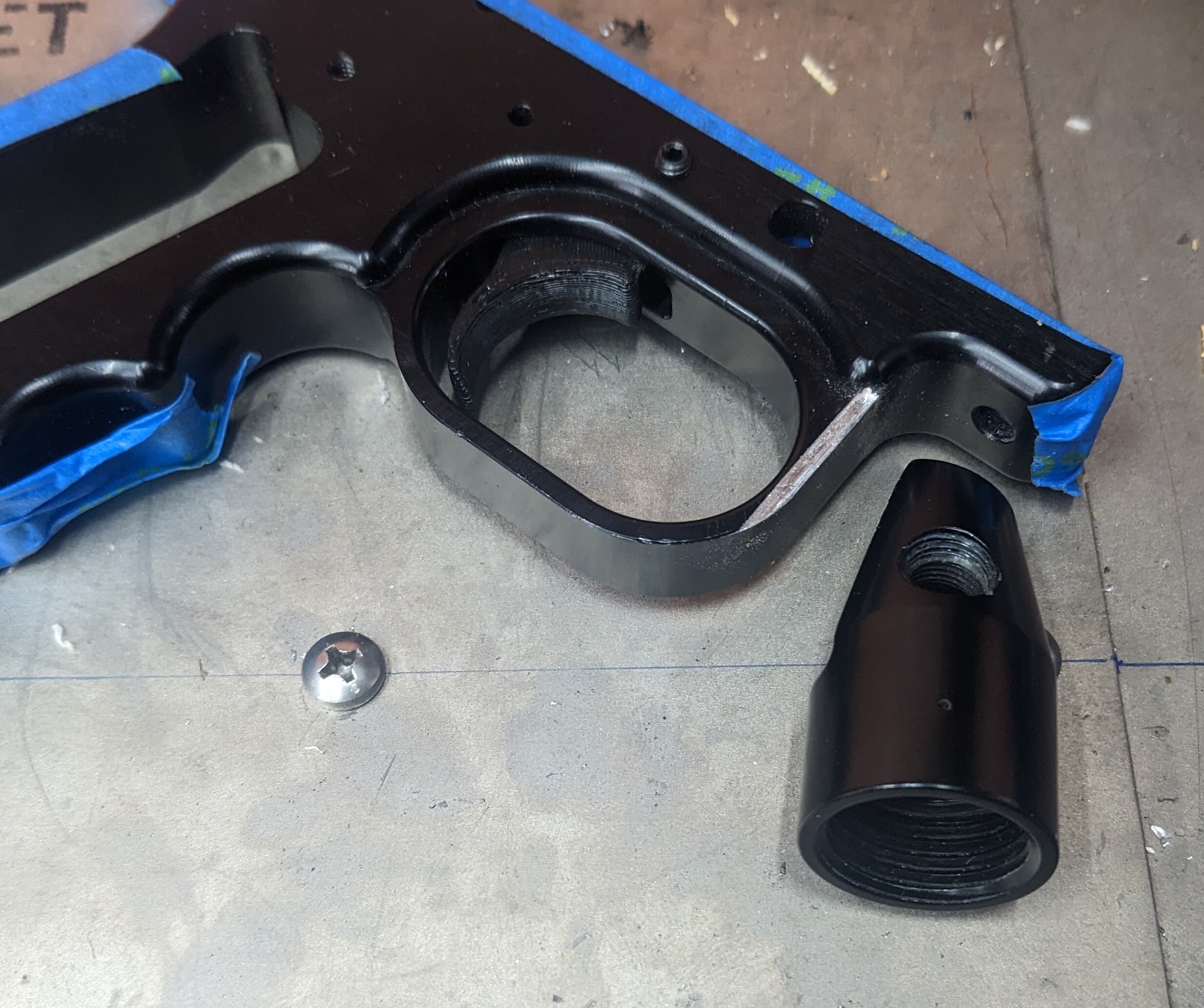

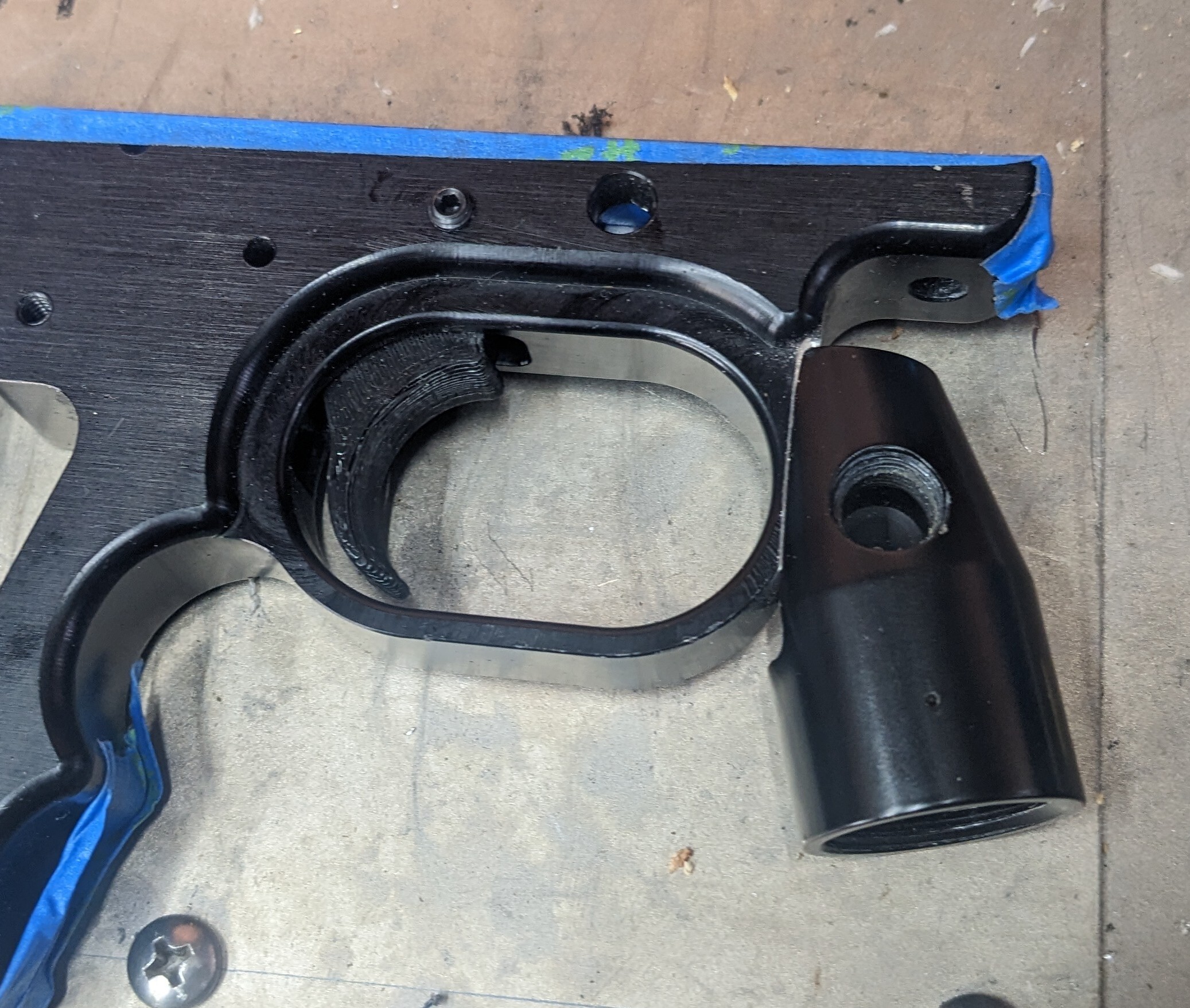

                Ok, started to work on the VASA.
                Milled the frame to fit the VASA:
                And a test fit:
                Now I need to put the hole at the right place πŸ˜…

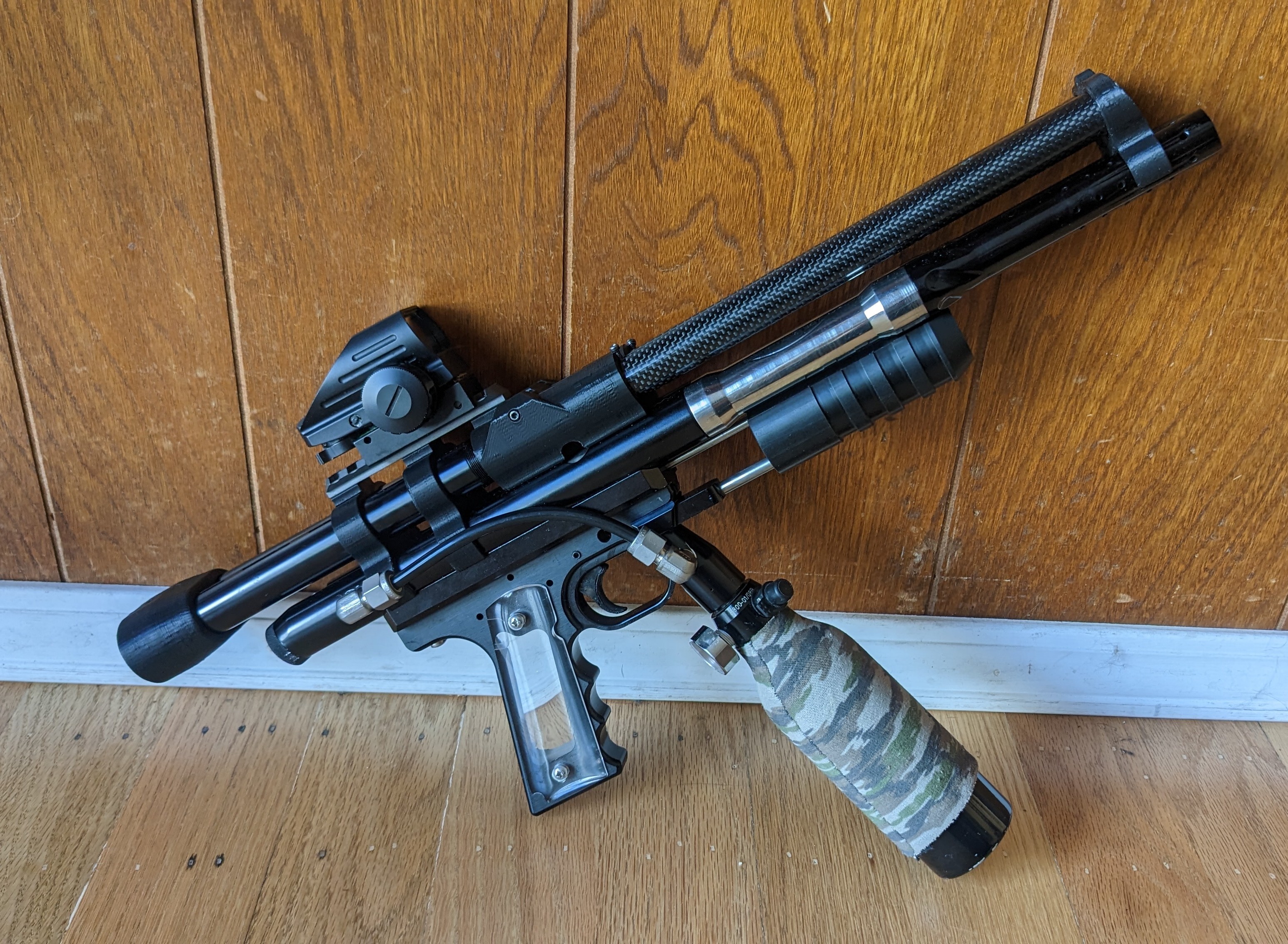

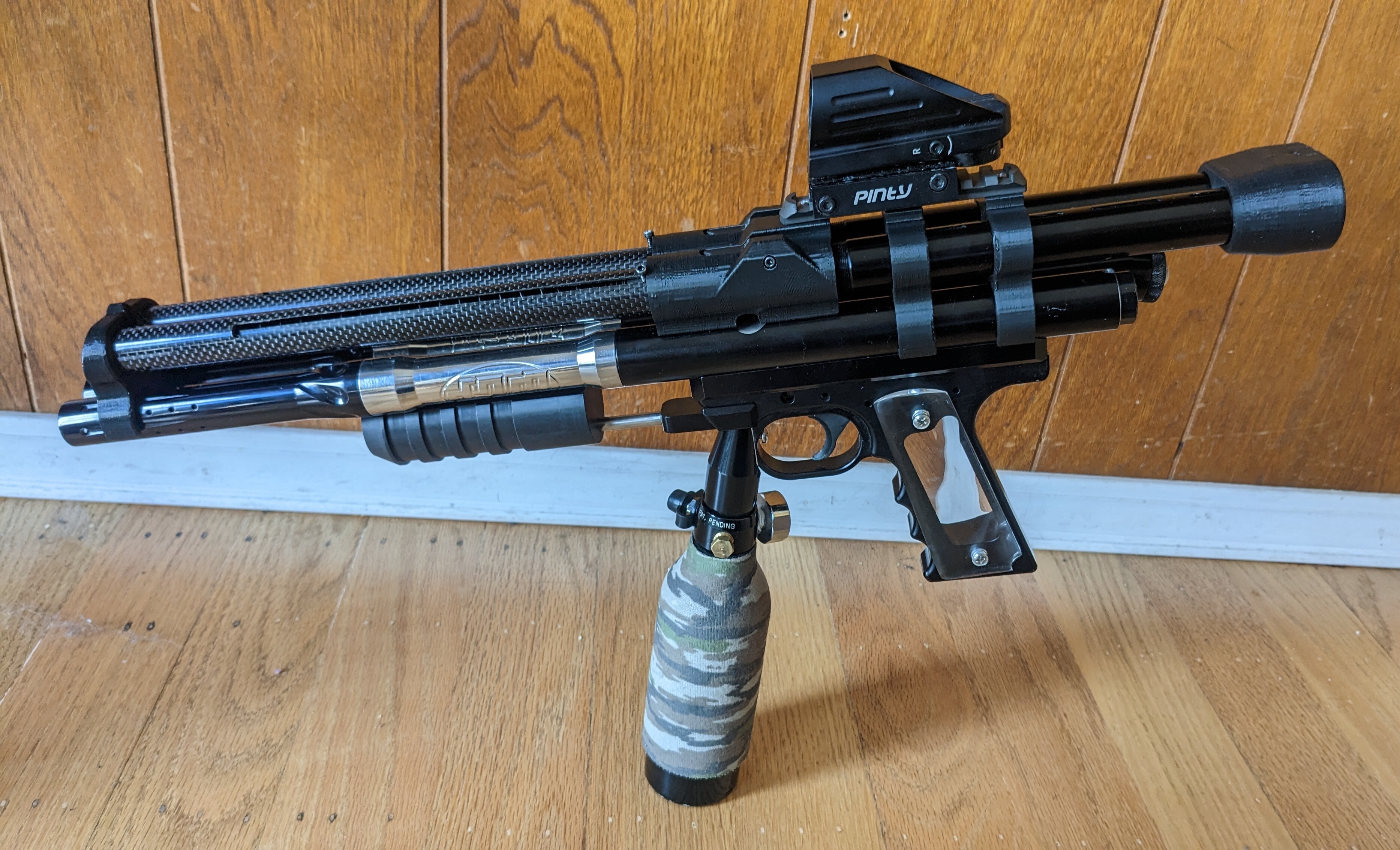

                  Got the VASA installed and plumbed.
                  I think it's pretty much done!
                  But guess what?
                  I like the BBA much better than the VASA πŸ˜…
                  So I'll get an other frame and I'll have 2 for this little guy 😎
                  ​​​​​​​Also found a solution for the feed tube in the way of the tank gauge, I made a tool to remove/install the tubes easily.

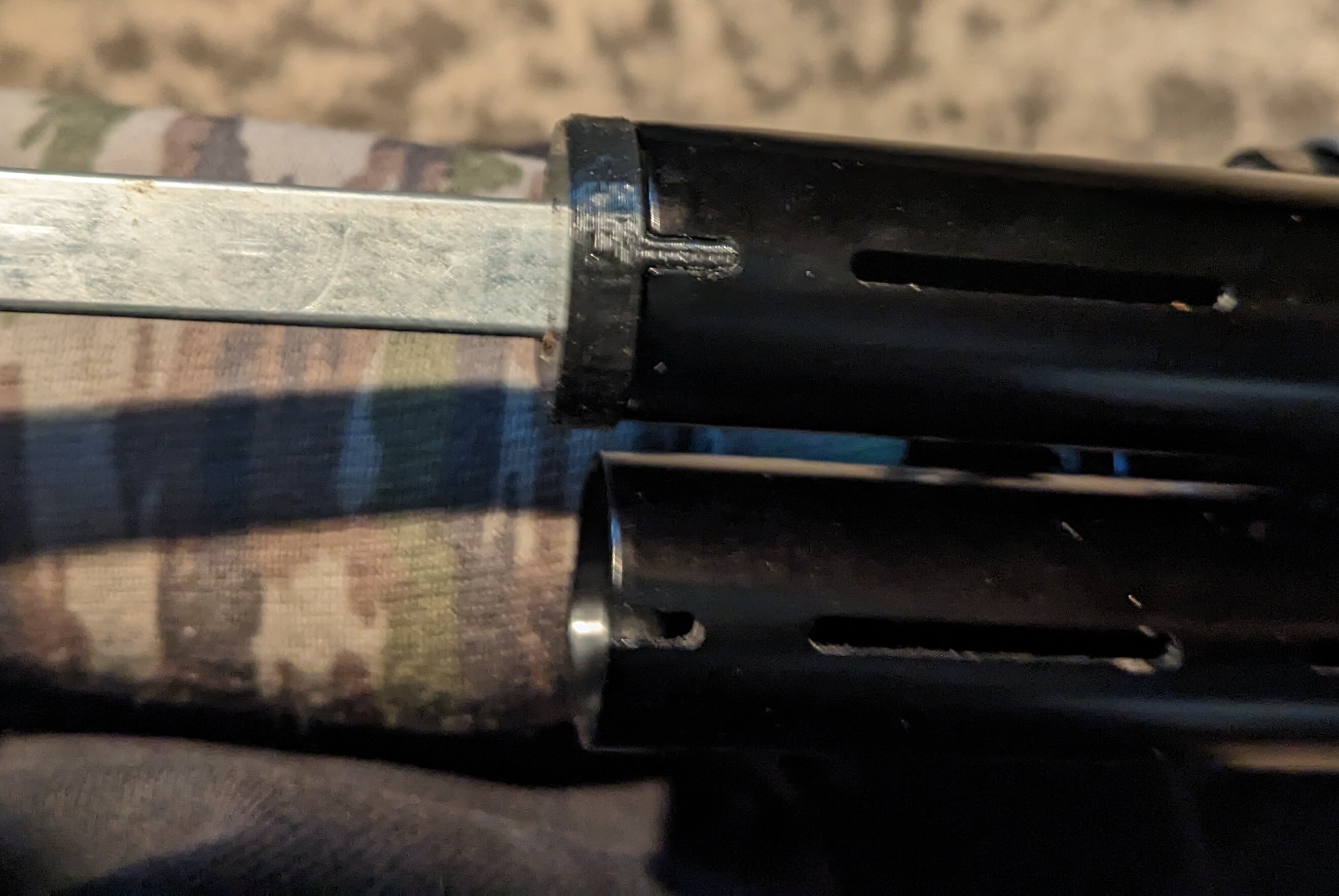

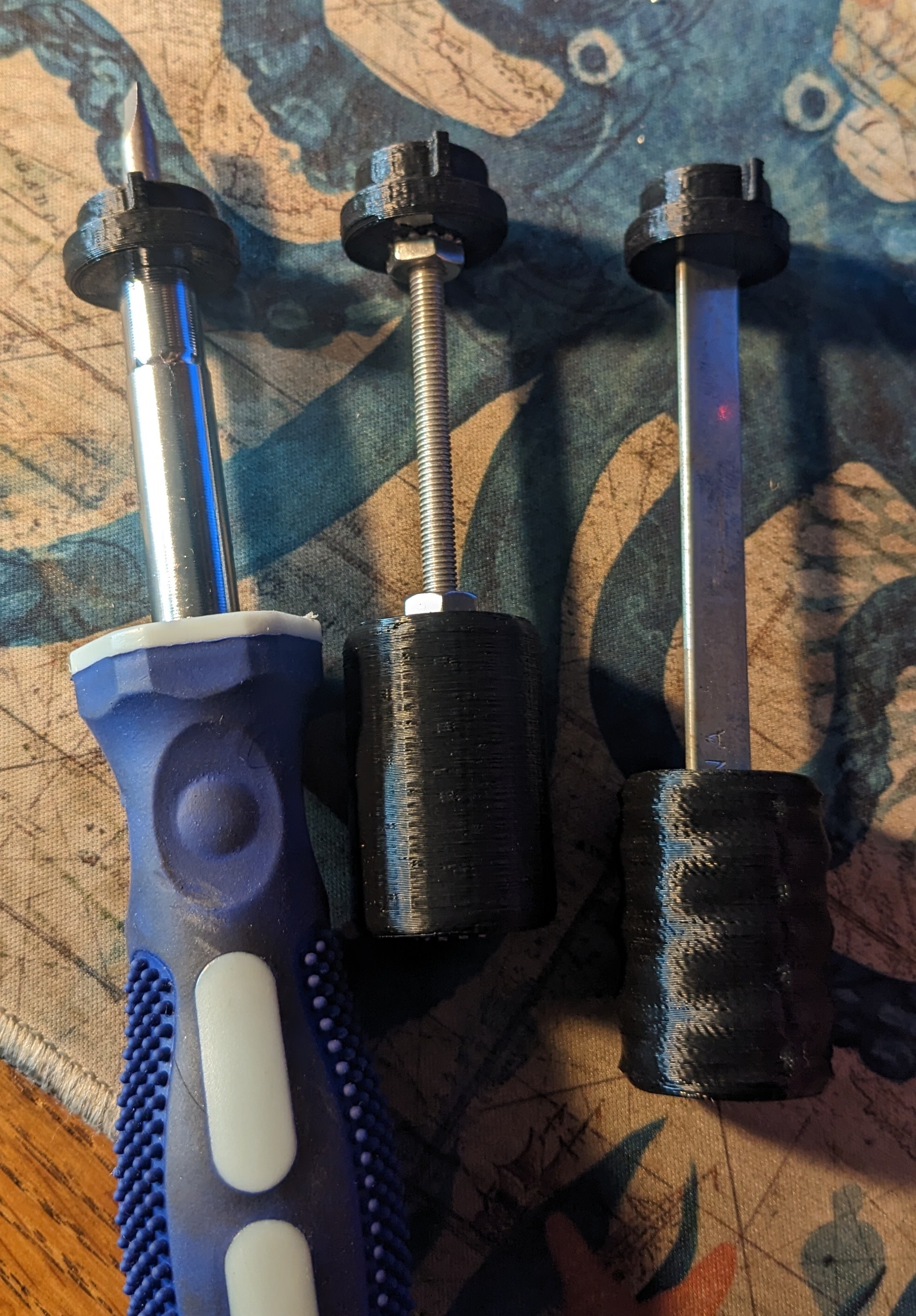

                  evolution of a simple tool (from left to right):
