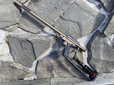

    About a year or so I took this on trade from a teammate Arctic who picked it up here from another member it’s been passed around a bit. ih8cornuts did the body mods and mounted the rail and had a custom rifled barrel made to fit the Phantom body. And for that I Thank Him.

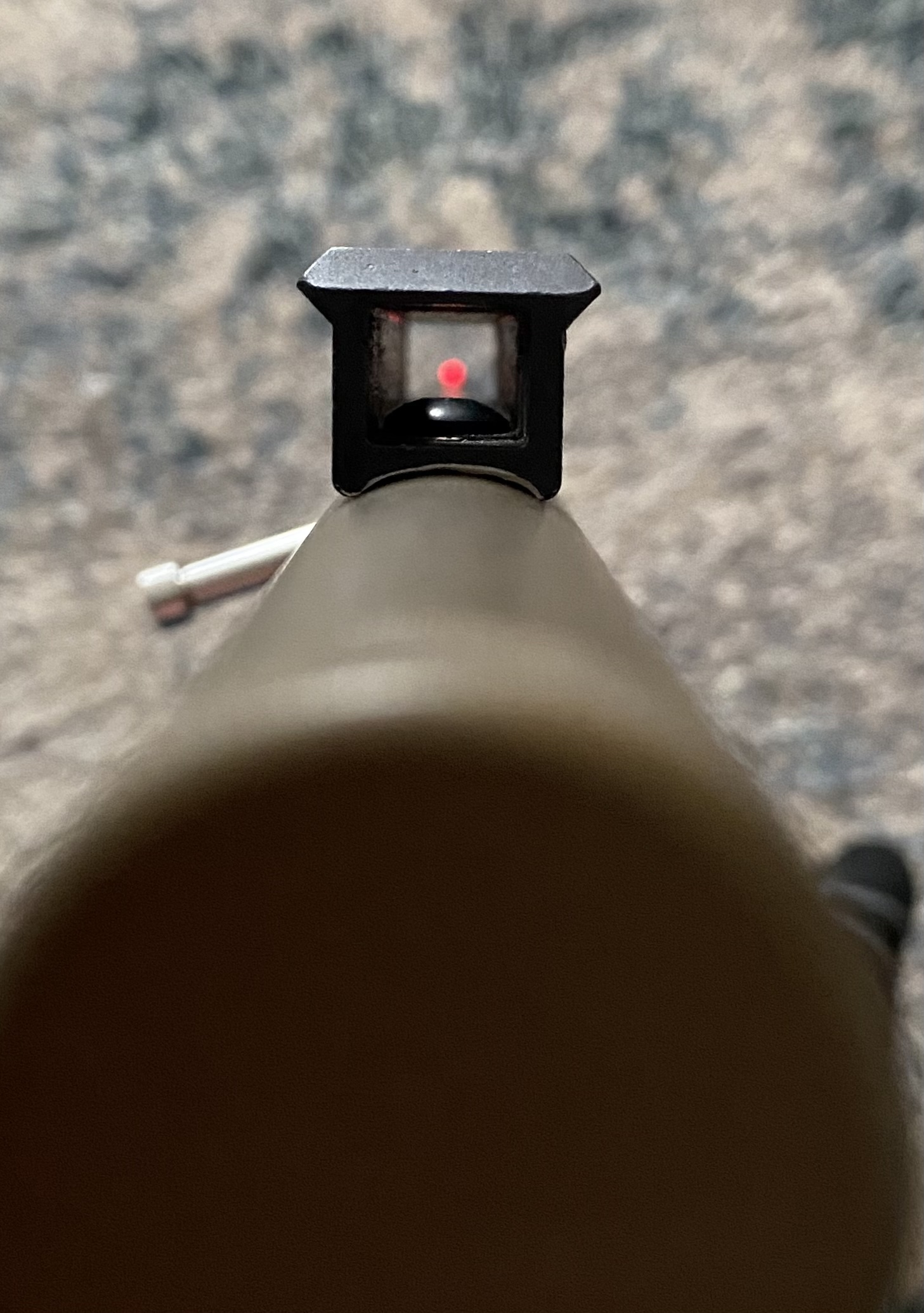

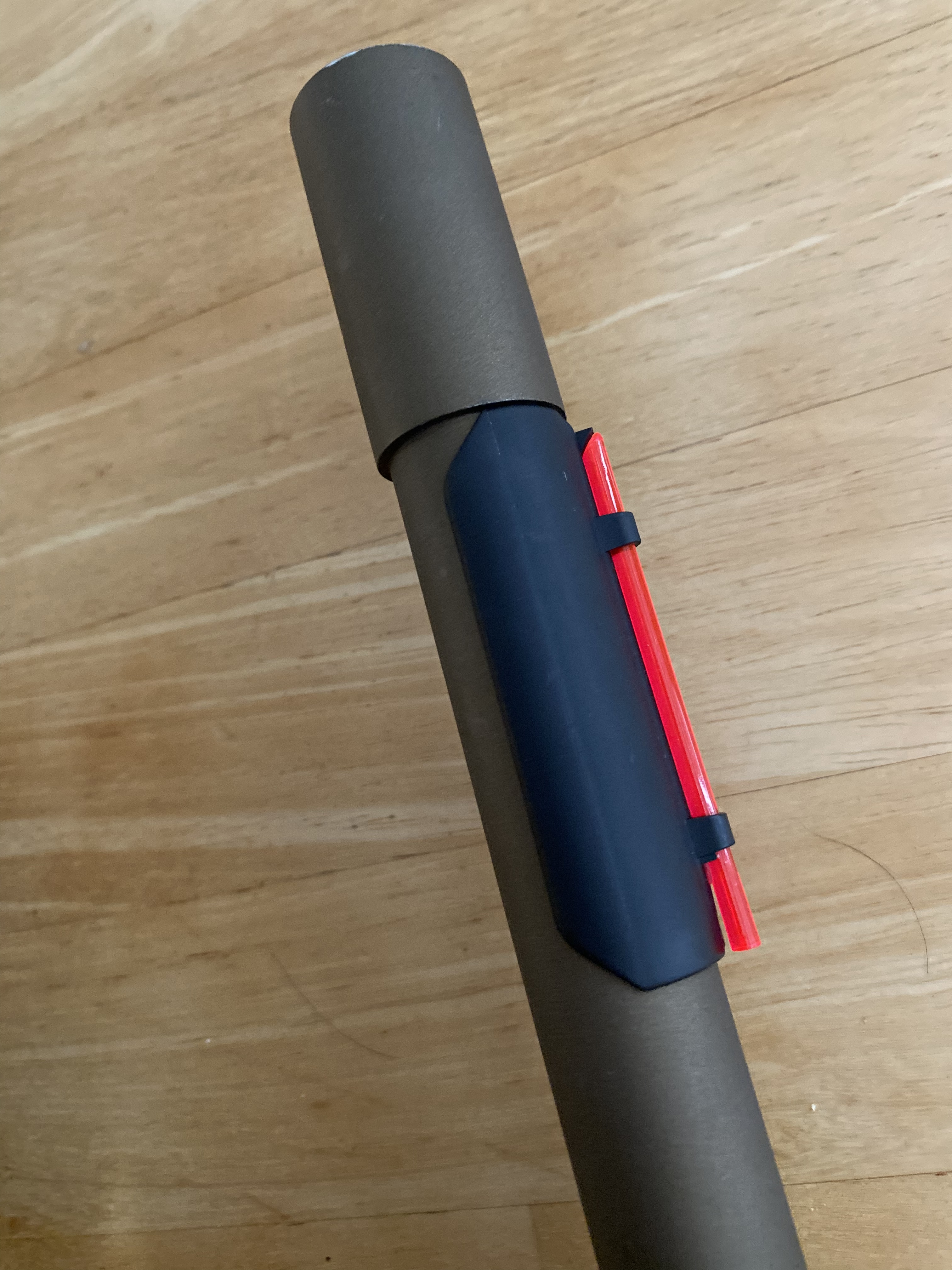

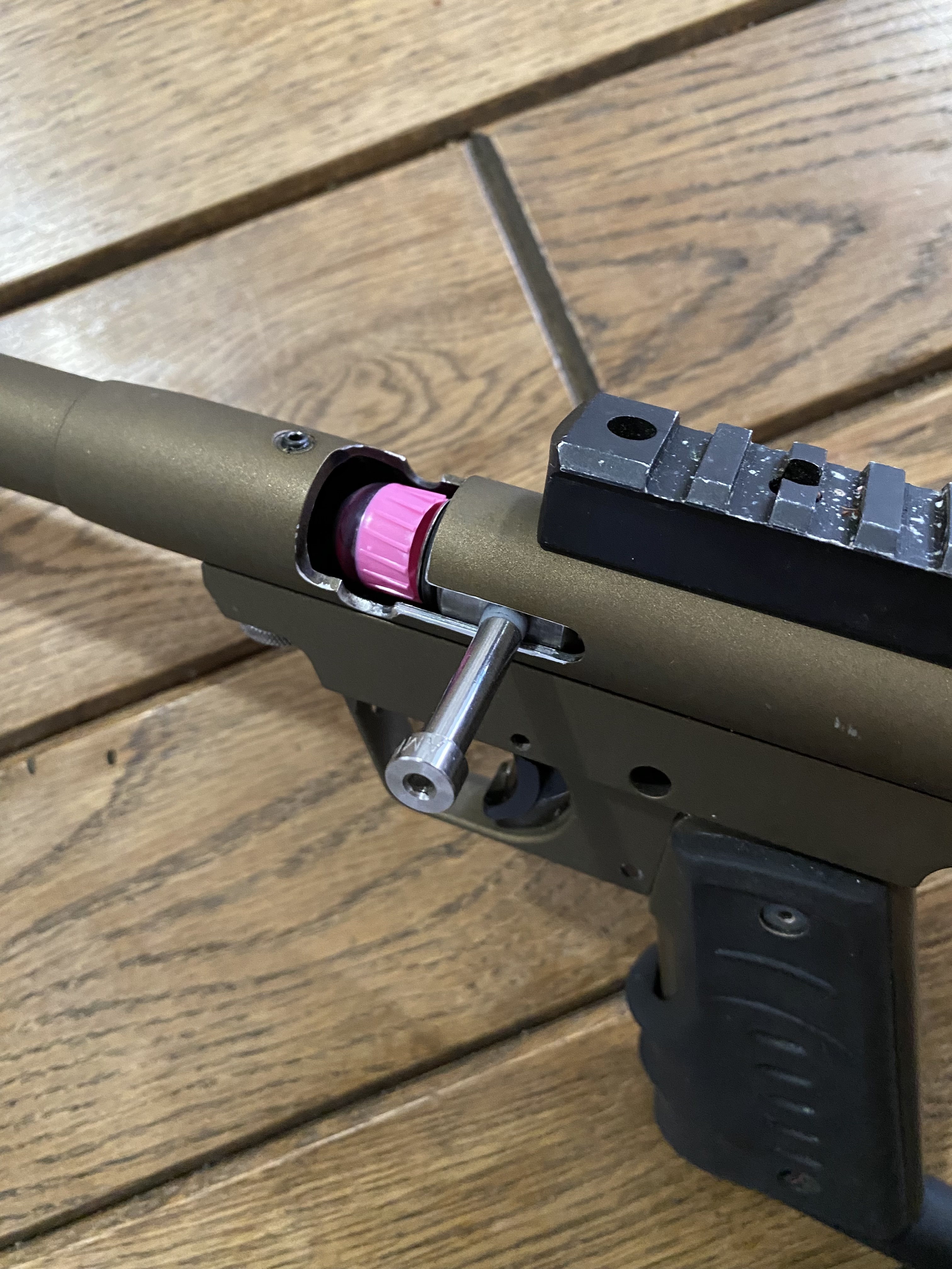

    After putting it threw it’s paces I noticed it could use a lil love to make it that much better. It was an awesome concept all the right parts it just need a lil love. I plugged the feedneck hole that gave me 40 fps boost this should do wonders for efficiency. I noticed there was no valve spring when the cup seal backed off the power tube in the cold. I was surprised it worked so well without one for so long only gave me an issue in 28* weather. The 12g must give it enough pressure to hold the valve closed when warm. But I want that valve closing quick for more efficiency because it’s a 12g only marker for now. I had some binding and grinding on the body cut with use so I added a Teflon washer to the handle that really smoothed out the action and eliminated the body wear with a replaceable sleeve. I’m on the hunt for a ball bearing i found some in the RC car industry that may work. It’s so much smoother now so this will definitely work. I then added a shotgun Hi VIZ shooting systems front sight I got off Amazon for $20. I’m using the windowed custom rail ih8cornuts made for the rear sight. And Hotdog we got a Winner! It’s effective, very effective with a killer sight picture and a fantastic field of view. I also added a stock to aid in accuracy.
    She’s a Tac driver, and my new favorite thing in paintball.
    Time to Club some Gravy Seals.

        Glad you’re making tweaks and loving it man! It’s such a crazy light setup compared to the standard fsr delivery systems you see out there. That hi viz looks amazing with the window rail! And just so credit goes where it’s due, I bought that from blackrain, but the original milling and build was done by ih8cornuts.

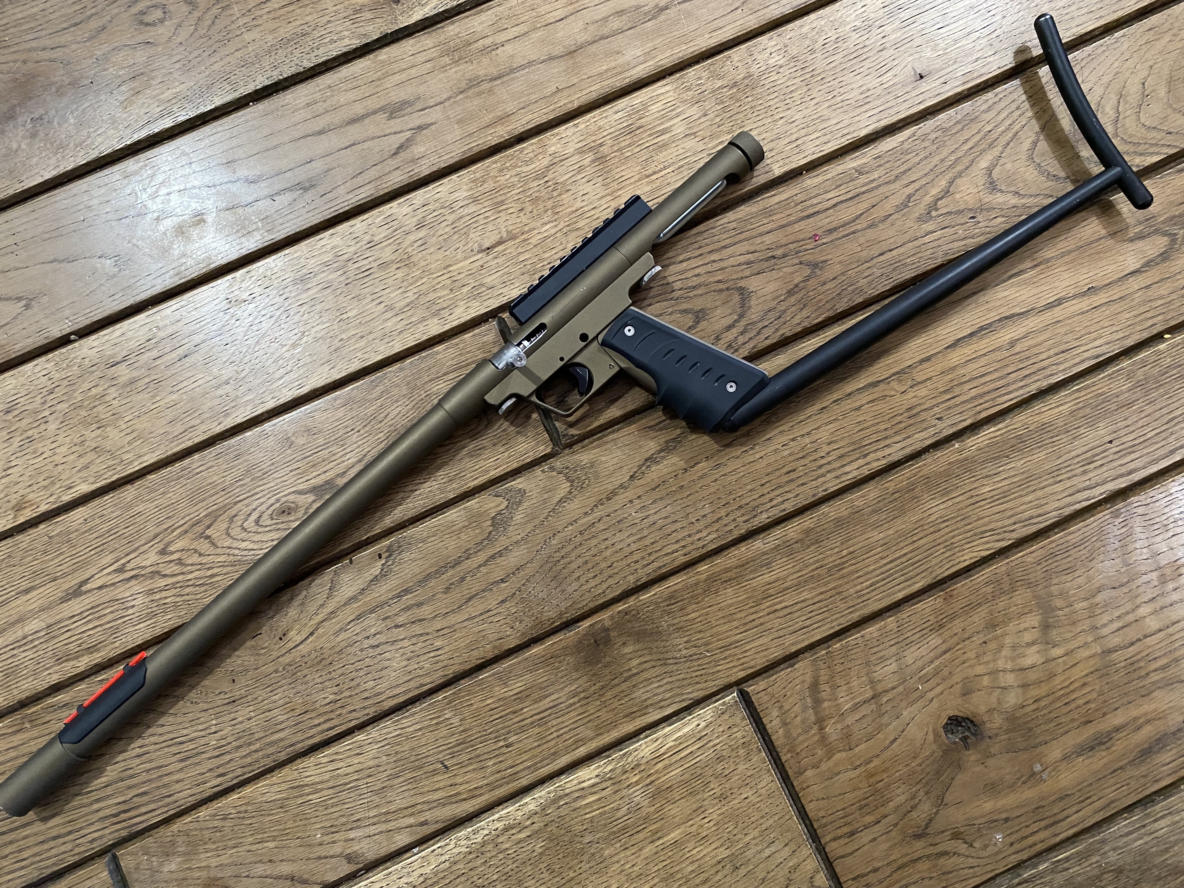

                  Added a 10ci on a custom buttstock I made up to attach on the CCI L stock shaft. Got a dummy 12g in the drop out to some braided line I had that’s a lil to long may try for a hard line setup eventually. But one screw I can take the buttstock off and switch back to 12g. Everything is all tucked up out of the way nicely should work good if i happen to need it in the cold and don’t want to burn threw 12g.
