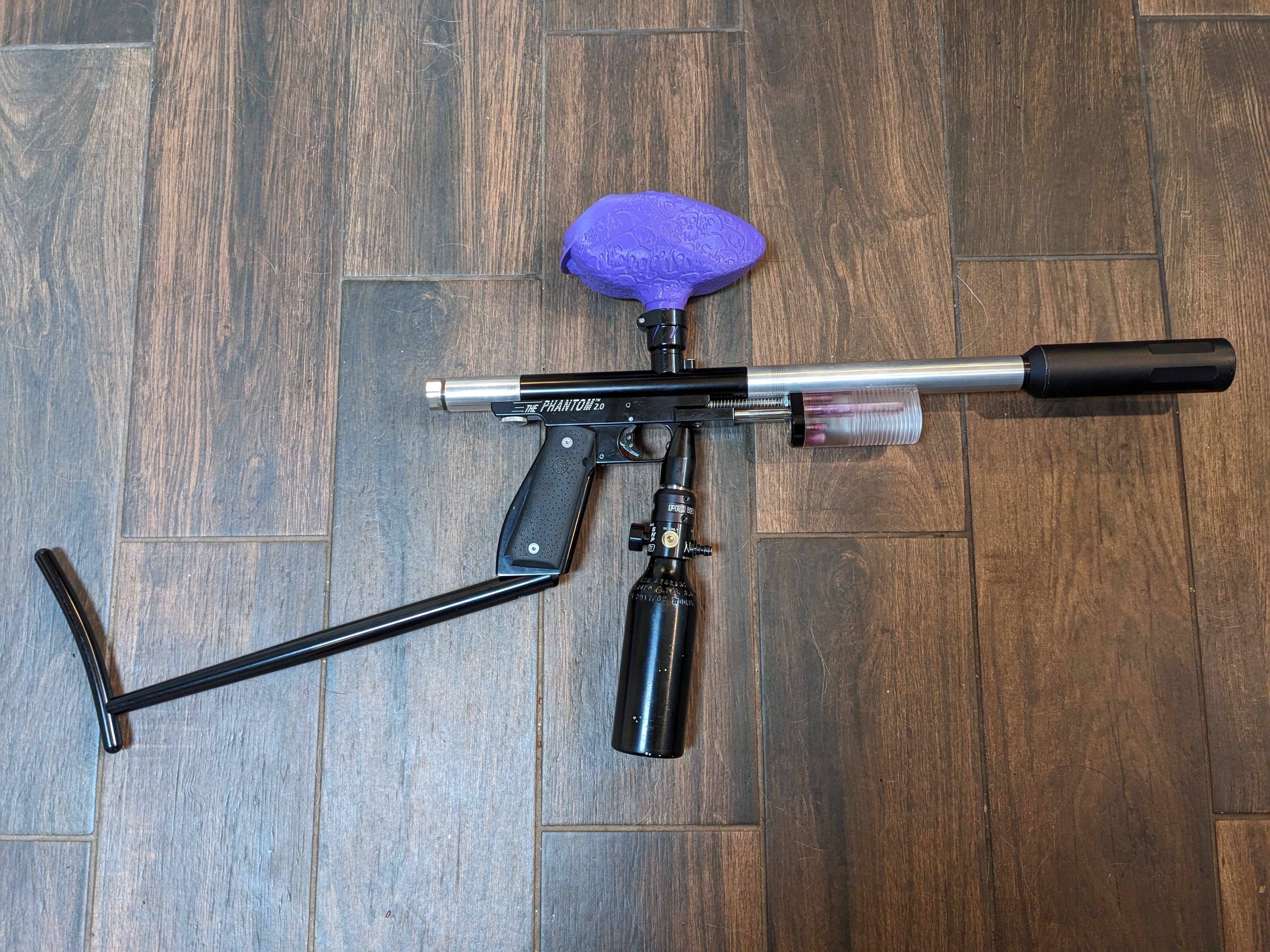

            Got to do some more testing today.
            Volume estimate for the OEM 2.0 valve is .295 cu inches
            Volume estimate for bored out 2.0 valve tapped for a rear gauge is .59 cu inches
            ​​​Tested set up:
            Modified valve body
            red main spring
            green valve spring
            a good underbore with freak XL inserts
            900psi input
            I was chronoing around 293-297 with one spike up to 310. Had a change in my days plans that pulled me away from anything "scientific" but I think that combination seems to be the key.
            • plunderin
              Oregon Ikonik / SSC
              • 74
              • Portland Oregon
              • plunderin
                Oregon Ikonik / SSC
                • 74
                • Portland Oregon
                There's the setup with the prototype modified valve. It should be able able to be done on the OEM valves as well.
