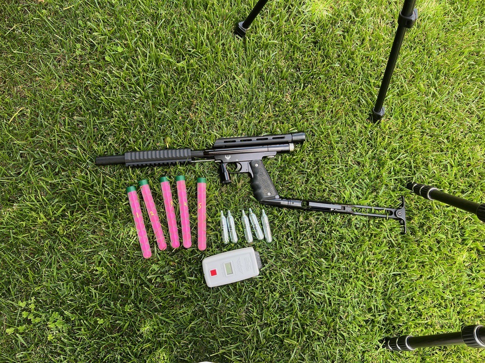

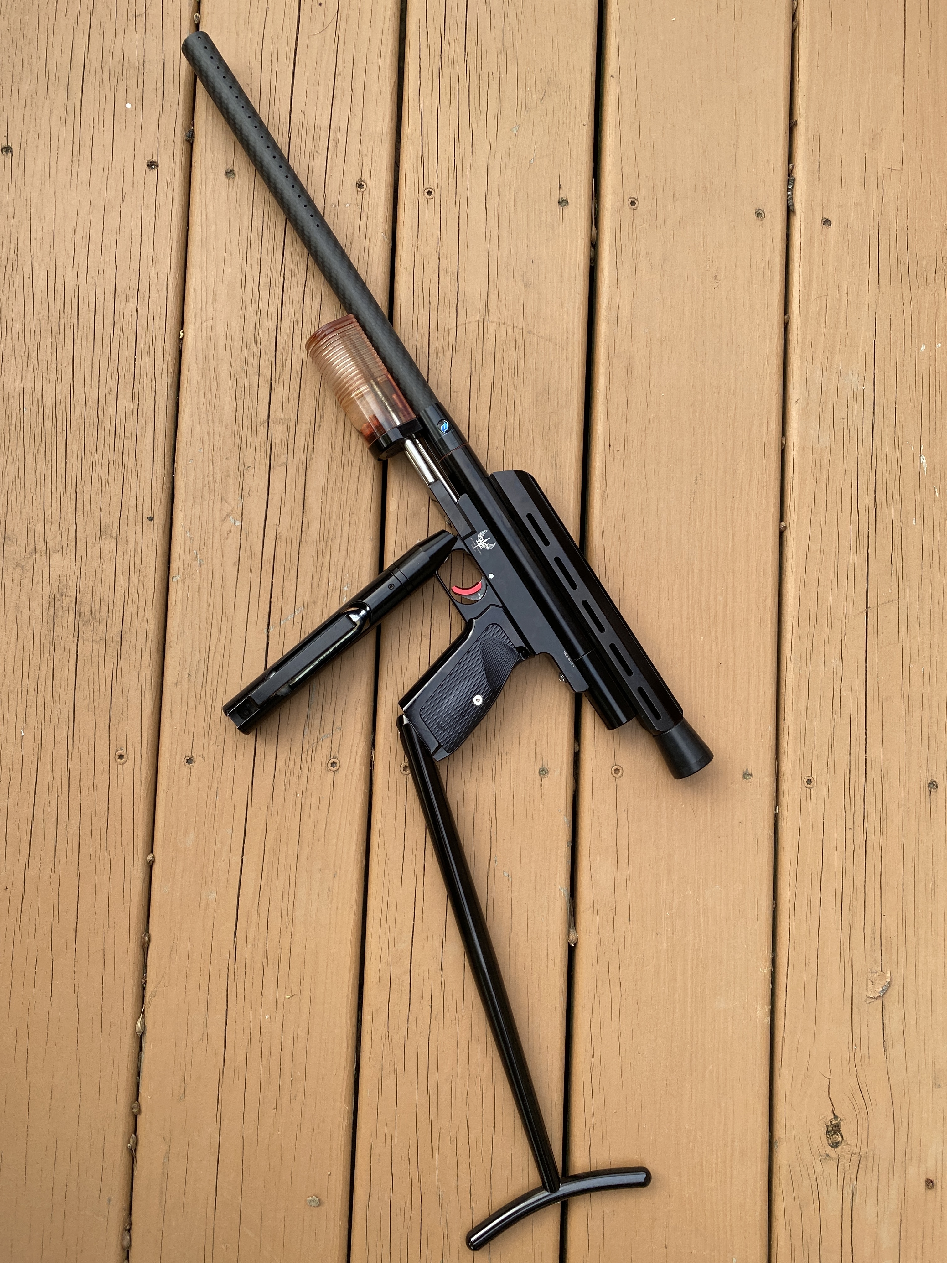

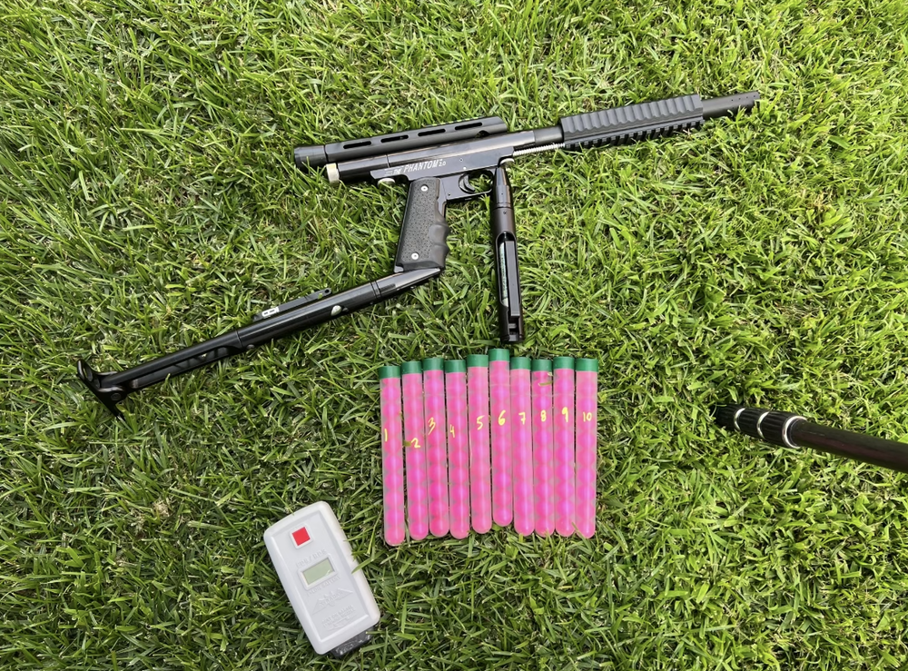

              I am back with results.
              • Projectile: reball
              • Air source: 12g CO2 ( 43g )
              • Barrel: CCI Freak XL .675 insert
              • Radar: X-wing & Clock 66 (clock is precisely 2FPS slower)
              • Modifications: Valve chamber was drilled from the rear straight and threaded 1/8" NPT
              • Tests: 12g/43g bottom line using ICD lever changer (x2), 12g/43g Vertical with ICD lever changer, Dual 12g/41g with two ICD lever changers.
              • Spring: brand new from a phantom spring kit - softest one - bule/purple?
              • Velocity: 280-300FPS
              Results 35 full velocity shots, 3-5 additional 250 fps shots and dropping to 200psi where is stopped counting. The dual 12g yeilded 88 shots, 75 full velocity and the rest were dripping until I stopped at 200FPS. I feel like you can still get close and tag someone at 200FPS. I did two test one shooting rapidly, and one shooting slowly. The rapid shooting was 35 shots, and the slow was 42, I was able to squeeze a few more shots with patience.
              The 12g orientation had zero effect on shot count. My only weirdness was the dual 12g shot at 270 for the first 15 shots then went to the ~290fps for the rest.
              Thoughts: I was very happy with the results, this was a significant improvement and an easy modification. I never had velocity issues with mine, but it was not shooting this many full velocity shots, I got 28 iirc before he mod - need to rewatch the video.
              Video and FPS records to come when I have time to go through it.
              PSI when the velocity started to drop
              Dual 12g test set up.

                yes for sure adding more volume helped. I didn't choke on the 300+ rounds I put through it. Temps were warm 75* I will test with silvers for you.
                I thought about that but wanted to see the results incrementally.

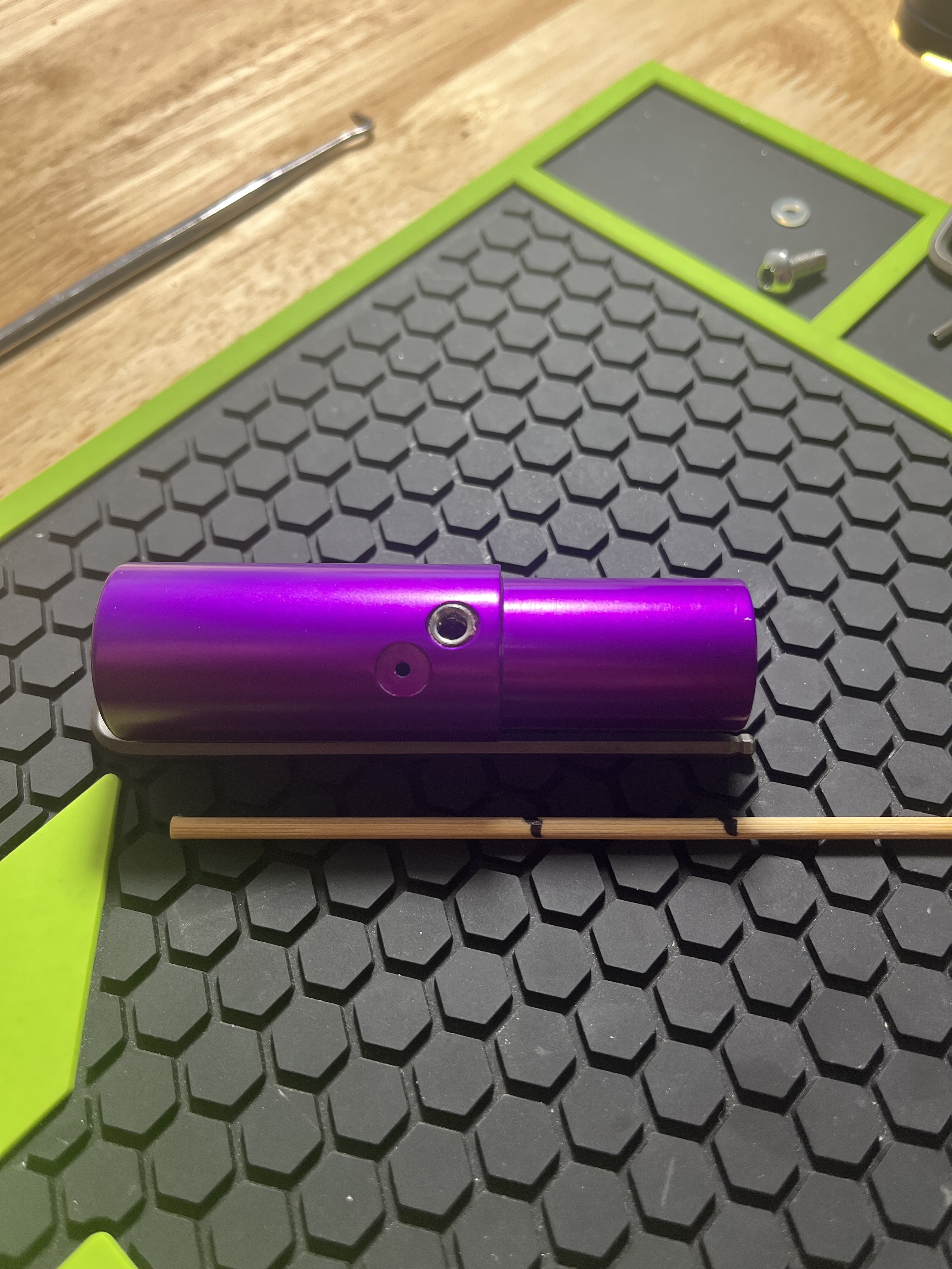

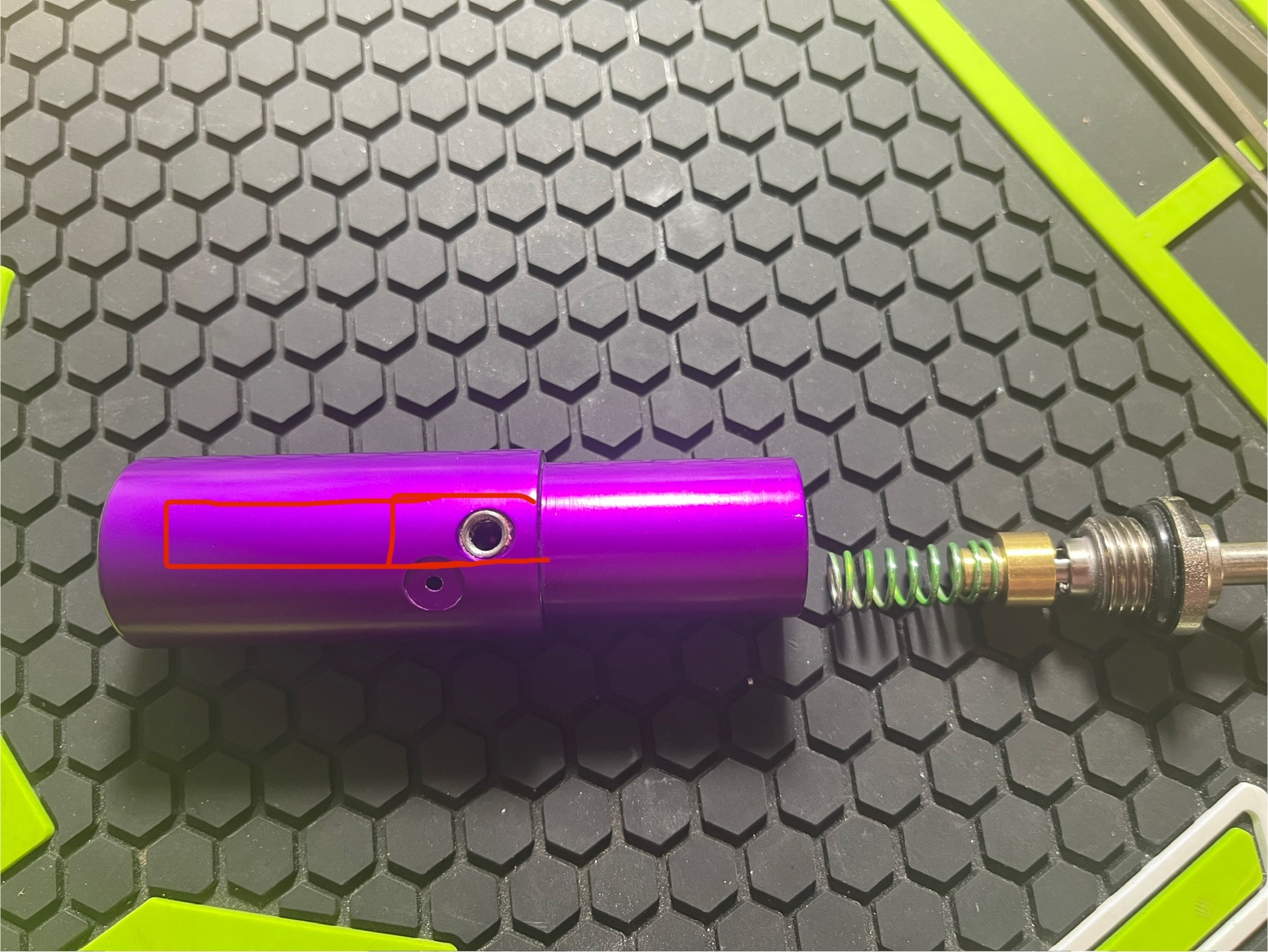

              #26
              Chuck E Ducky latches109

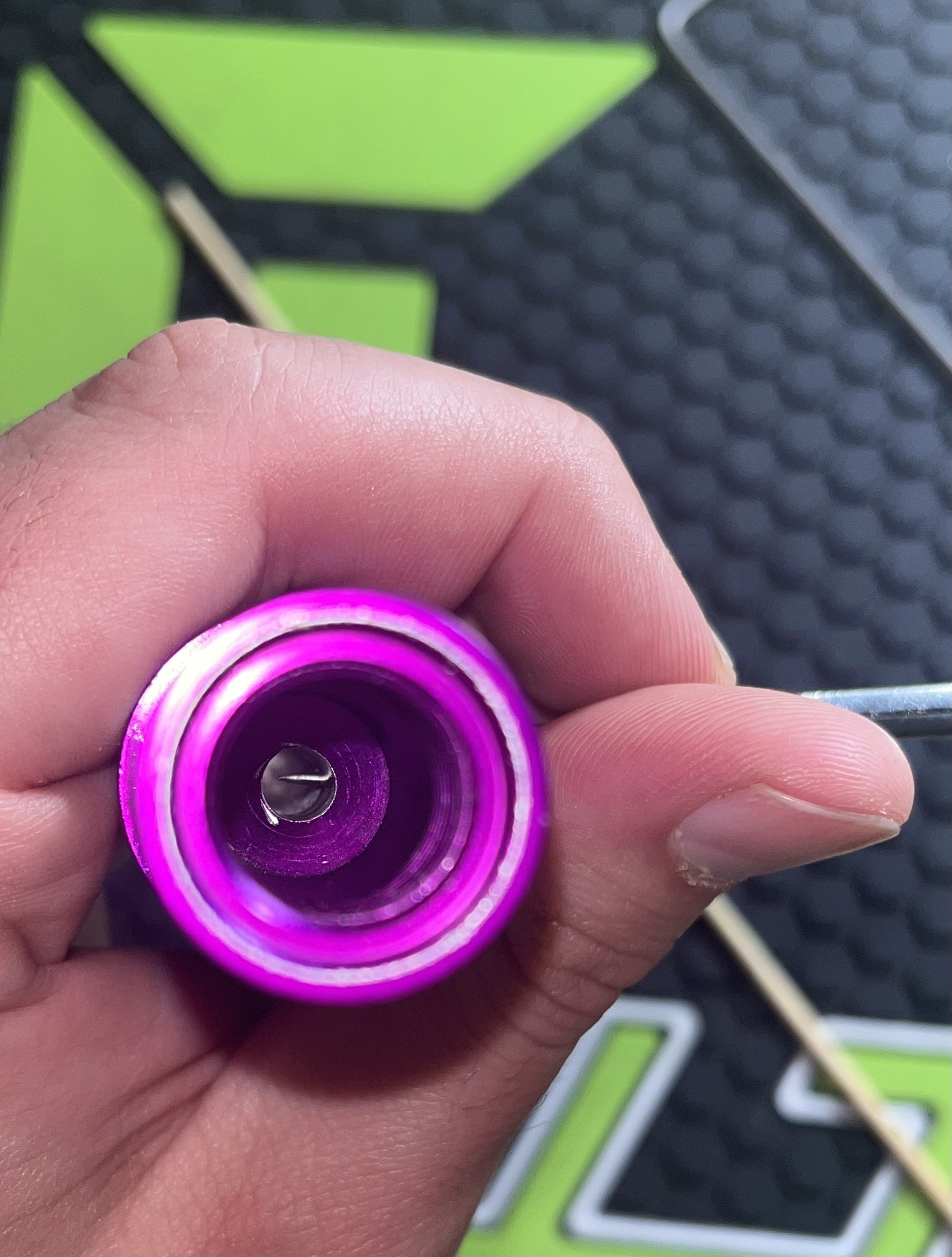

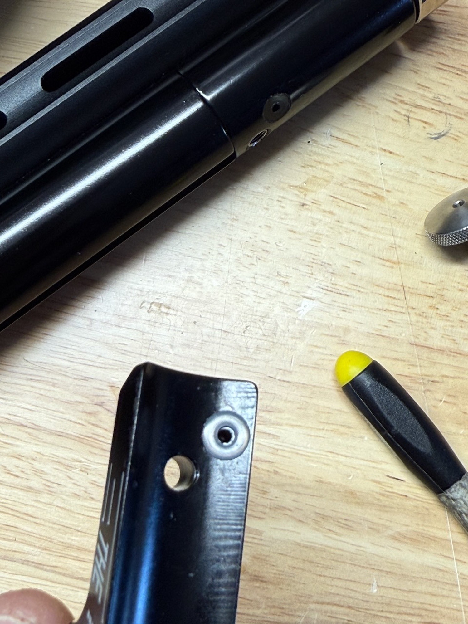

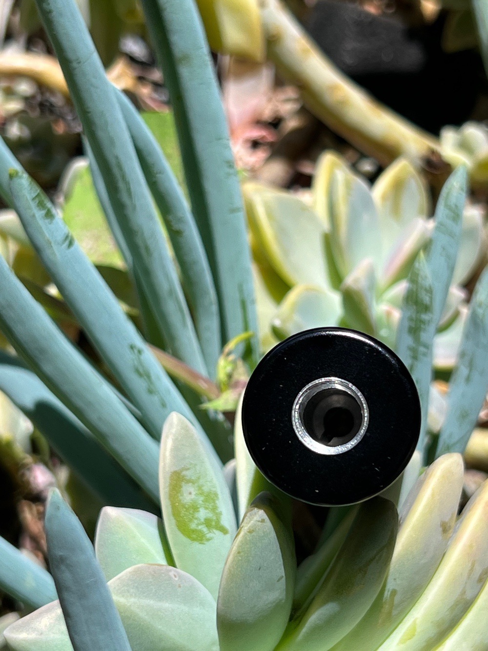

              Here's a few pictures as well showing the previous depth vs the new depth after drilling.
              I marked a wooden dowel before and after drilling to get an idea of how much deeper it really got. Looks like the depth of that hole increased by 1 1/16".
              Tried to get a decent picture looking into the valve. Stuck an o-ring pick through the feed line to show where it is in relation to the hole depth.
                Nice well done. That’s what I was thinking drilling it from that side to hide it all.
                I’m thinking about opening that air passage port a lil larger on the valve somewhere between that and the 12g something is slowing recharge rate.
              • Booska
                Booska commented
                Definitely let me know how it goes. I wasn't subscribed to this thread before, so I'm just catching up on what I missed. Haven't played with my phantom since I finished building my 2 snipers.

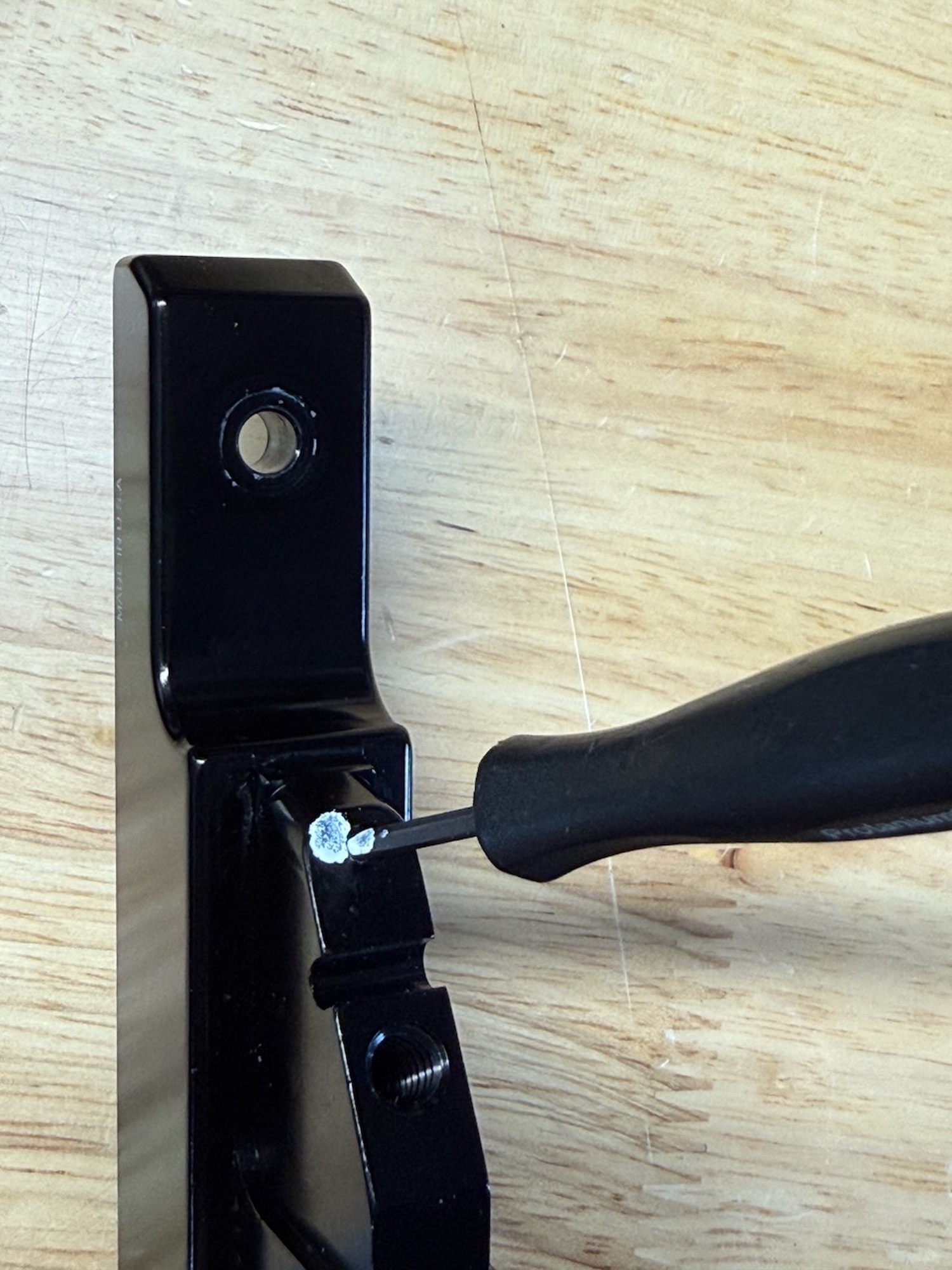

              • 6349
              #27
              Oh yeah 3/16 drill bit worked perfectly. Extend the inner bore leaving appox 1/4-3/8 of material before it poked through. I didn’t want to add a gage. It looks really clean and it’s getting decent numbers. Not as good as it did with the hard line kit. But I wasn’t exactly taking much time between shots and it’s about 65* out. But 32 shots @280 isn’t bad on stock silver springs. This was larger overbore and crap leftover paint.
              Need to field test it but drilling the valve out seems to be the answer.
              So some things to mention I plugged the grip frame hole. So I lowered the volume even more I wanted to use a different grip for my build. I can get field speed with much lower spring pressure. Still need to test it on a warm sunny day. Last time I had it out it choked in the mid 70* weather. It’s definitely operating much more efficient now.

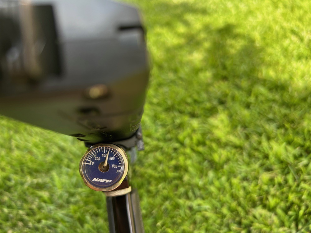

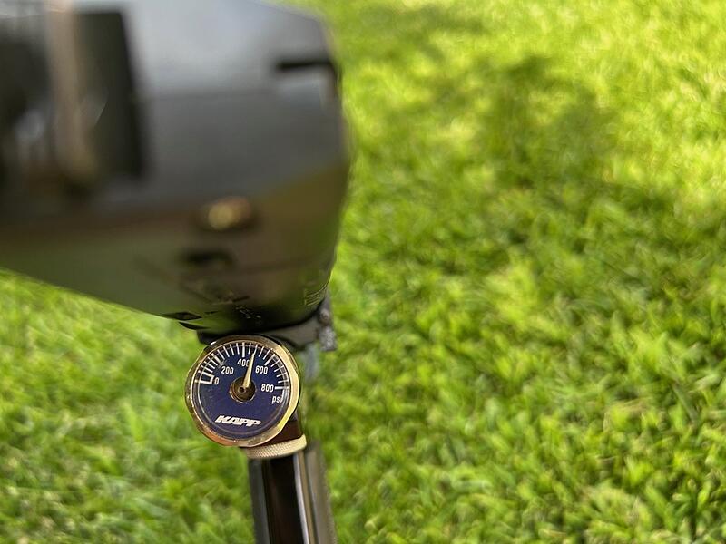

              So I got a fulls days play on the modified 2.0 valve I may try going a lil deeper with the drill. Im approx 1/4” from poking through. I may take that down to 1/8”. I don’t think it’s a volume issue now. I think it’s a flow / recharge issue.
              Some things I noticed. It recharges slower, you can hear the valve recharge there is definitely some flow restrictions. I’m not 100% sure if it’s volume related “now”. I think it may be air passages itself. Possibly the multiple right angles they make to enter the valve. The drilled ports are large enough I think judging by the hard line internal diameter. It could be the internal lines are off a bit restricting flow at the points they intersect. Or perhaps they don’t clear the hole enough. So flow is being restricted at the intersection points. I did notice the hole into the valve is smaller than the passage way port. I may try increasing the valve entry port size. So my next step is increasing volume a tiny bit more and making the valve entry port larger. I’m also going to pull the plugs on the air passages and insure they are clear of debris or burrs that could restrict flow causing the slow recharge. Last step will be drilling the passages larger re tapping them with larger plugs.
              The symptom I would like to tune out is the delay in recharge.
              To get full velocity shots it takes an extra “2 seconds” (ruff estimate) for the co2 to expand to full chrono speed. It will still get pretty good numbers and operates on stock silver springs but it’s still not perfect. Marker operates like a typical well tuned phantom just slower. Real world SC play it works fine. But the occasional quick follow up shot takes a few seconds longer to get that full velocity shot. So we are getting closer but it’s not perfect yet.
              Those that drilled all the way through and add a gage are you noticing a delay in pressure recovery time between follow up shots on 12g?
              Someone mentioned hogging it out and dropping in something similar to how RTR dose there valve with an additional piece to hold the spring seat. Or getting in the valve with an L shaped cutter leaving the stock spring seat position while adding more volume behind the valve. However I don’t think it’s a volume issue now. Something is slowing / restricting the flow.
              *Important to mention I’m not using the 2.0 45 grip frame my frame is plugged under the trigger frame* mine is setup to run off the front passage only. This could possibly be effecting my results as well. However I don’t think it’s effecting recharge times.

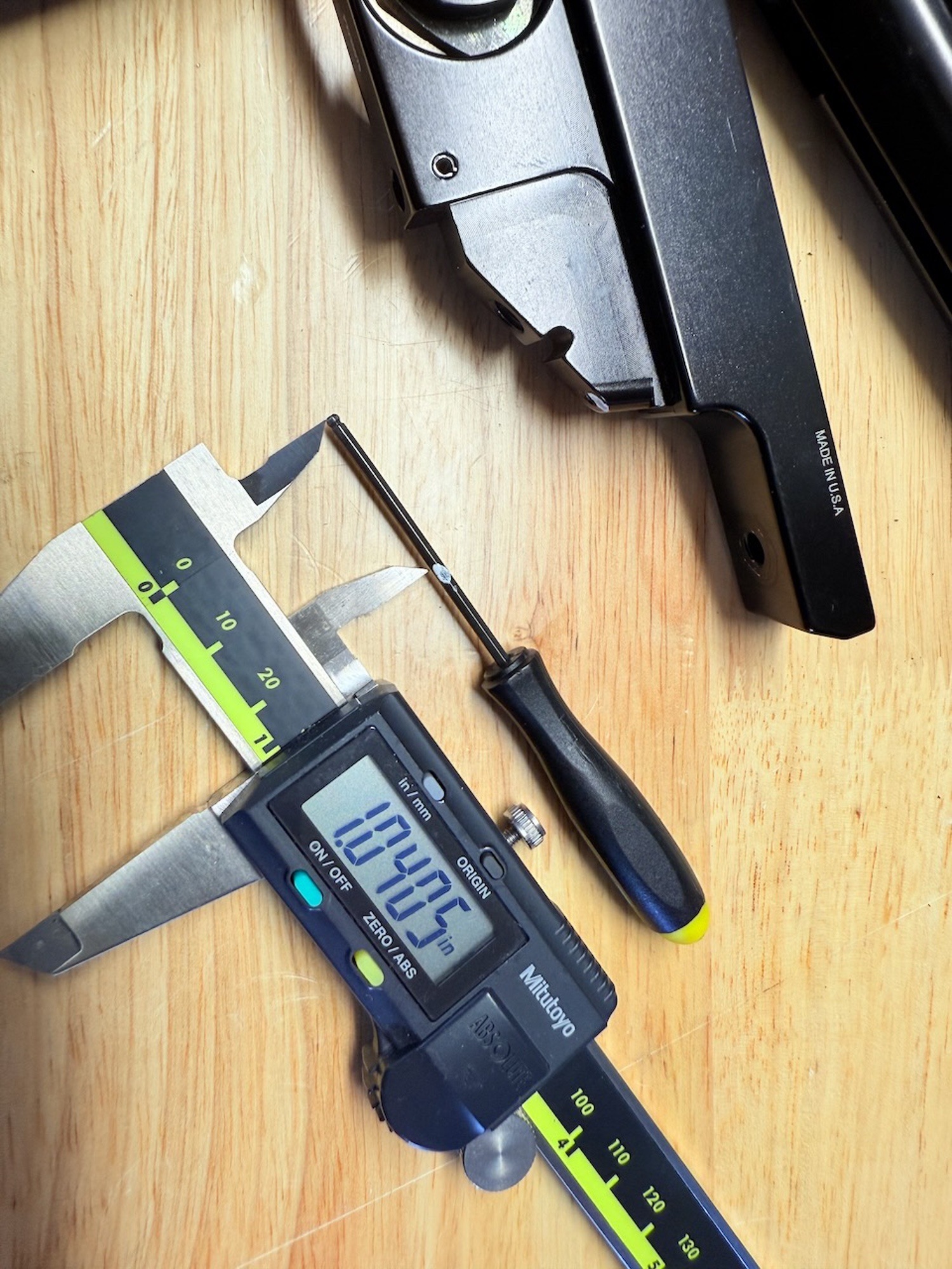

              Chuck E Ducky I just measured my frame and the rear frame port is 1", I doubt the set screw is restricting air flow. Also posted my air port to see if yours looks different.
                Yeah I don’t think that is the issue. Is the hole in your valve body the same size as the one in your frame you just posted. I feel like the valve hole on mine is smaller I wonder
                if that is the point of restriction. Maybe I should try opening the valve body hole a lil bit. See if that helps recharge rate. I feel like it’s got to be something simple choking it since the internal passages are similar diameter to the hard line. I’m not so sure just changing the flows direction would create that drastic of a change.

                latches109 commented
                Did you check if they are concentric? Maybe they are misaligned
