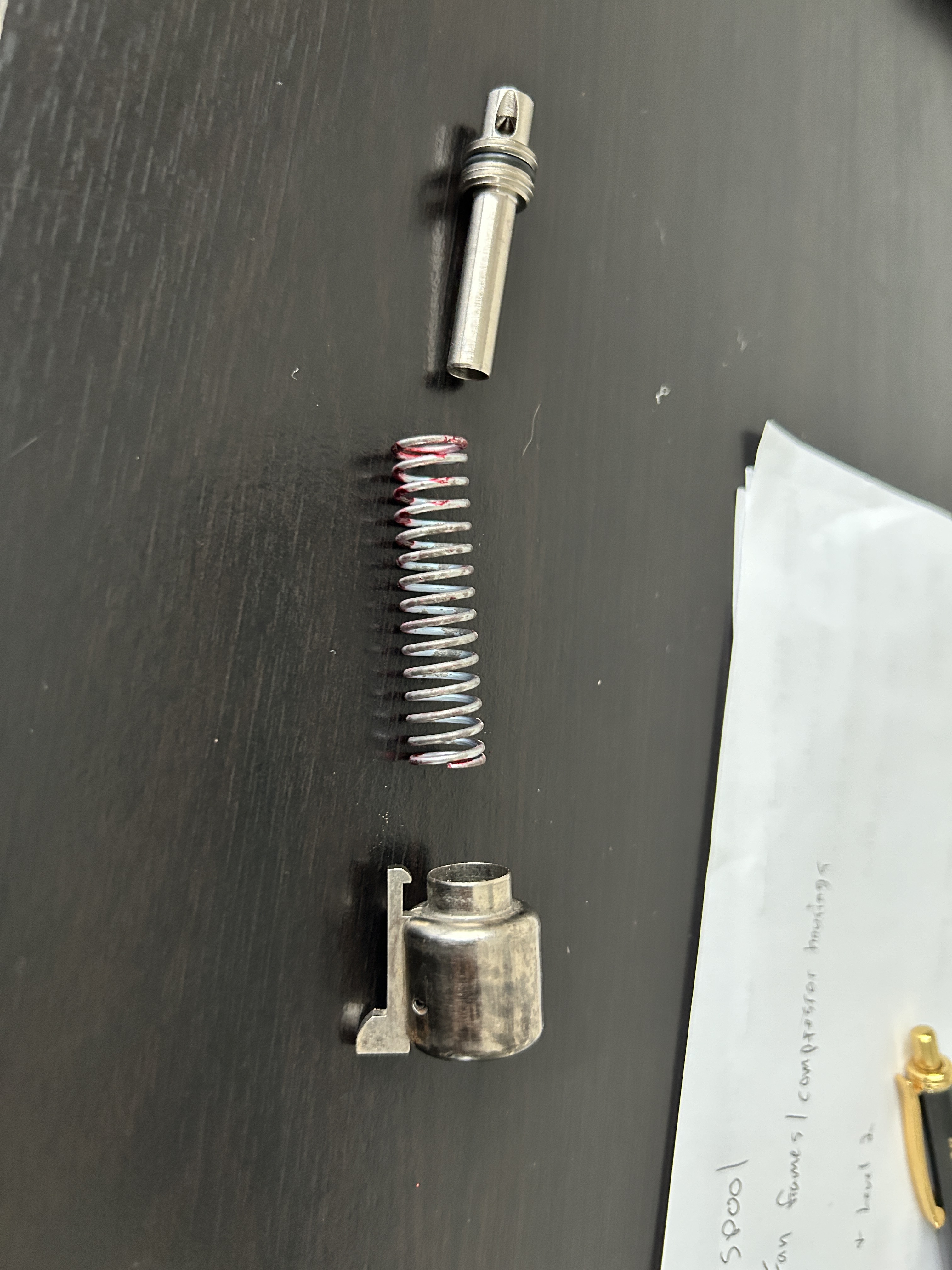

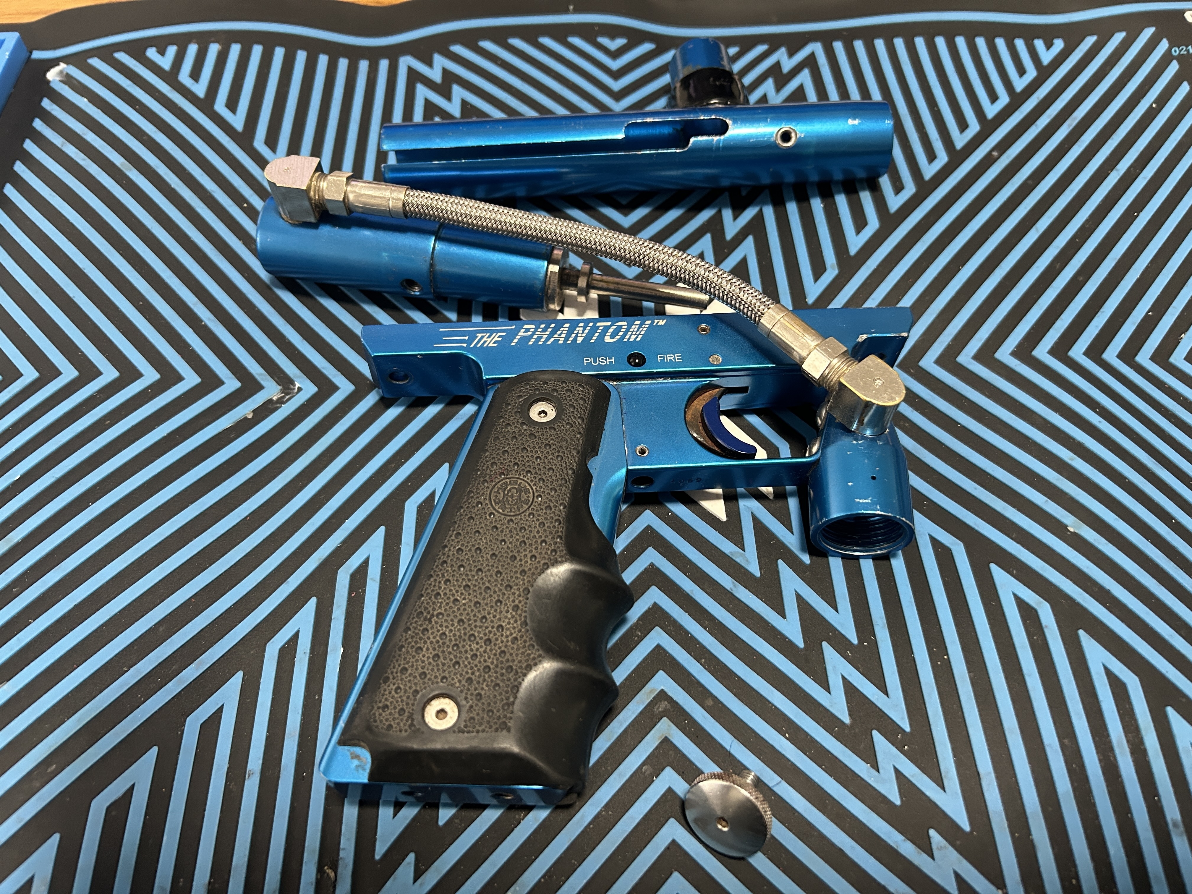

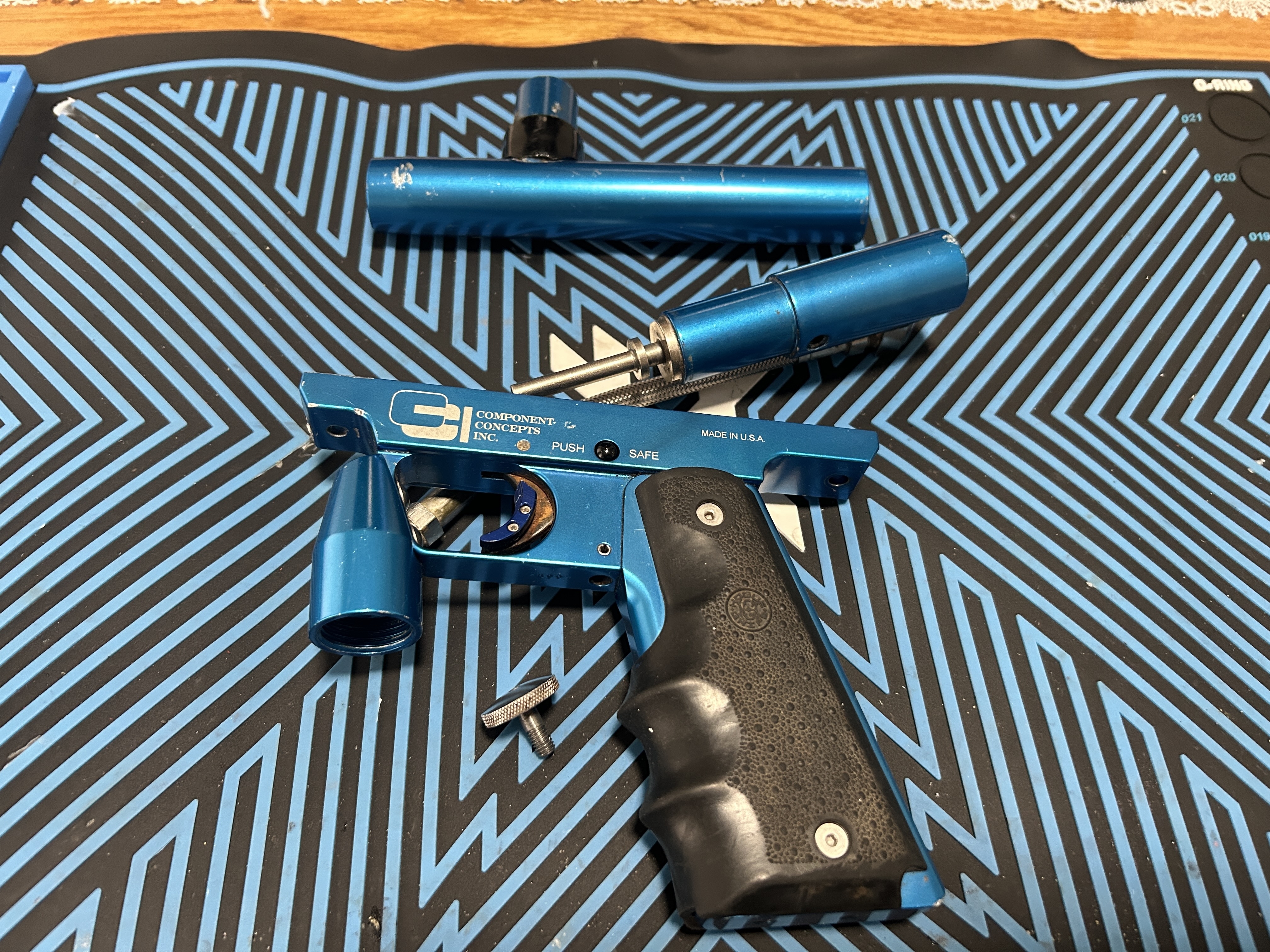

    Hello all. My first phantom came in the mail today and as you can see from the pics that it’s a bit of a mess. Missing the internals and pump arm.
  • What2007
    • Aug 2023
    • 213
    I went to my local shop (Hogans Alley) and Nick had some old parts squirreled away and I was able to pick up a pump handle, arm, hammer, spring, and compensator.
    I am on the search for a bolt, but I am understanding that they’re are two different types of bolts (length?).
    Can anyone confirm what I got and what style bolt I need?

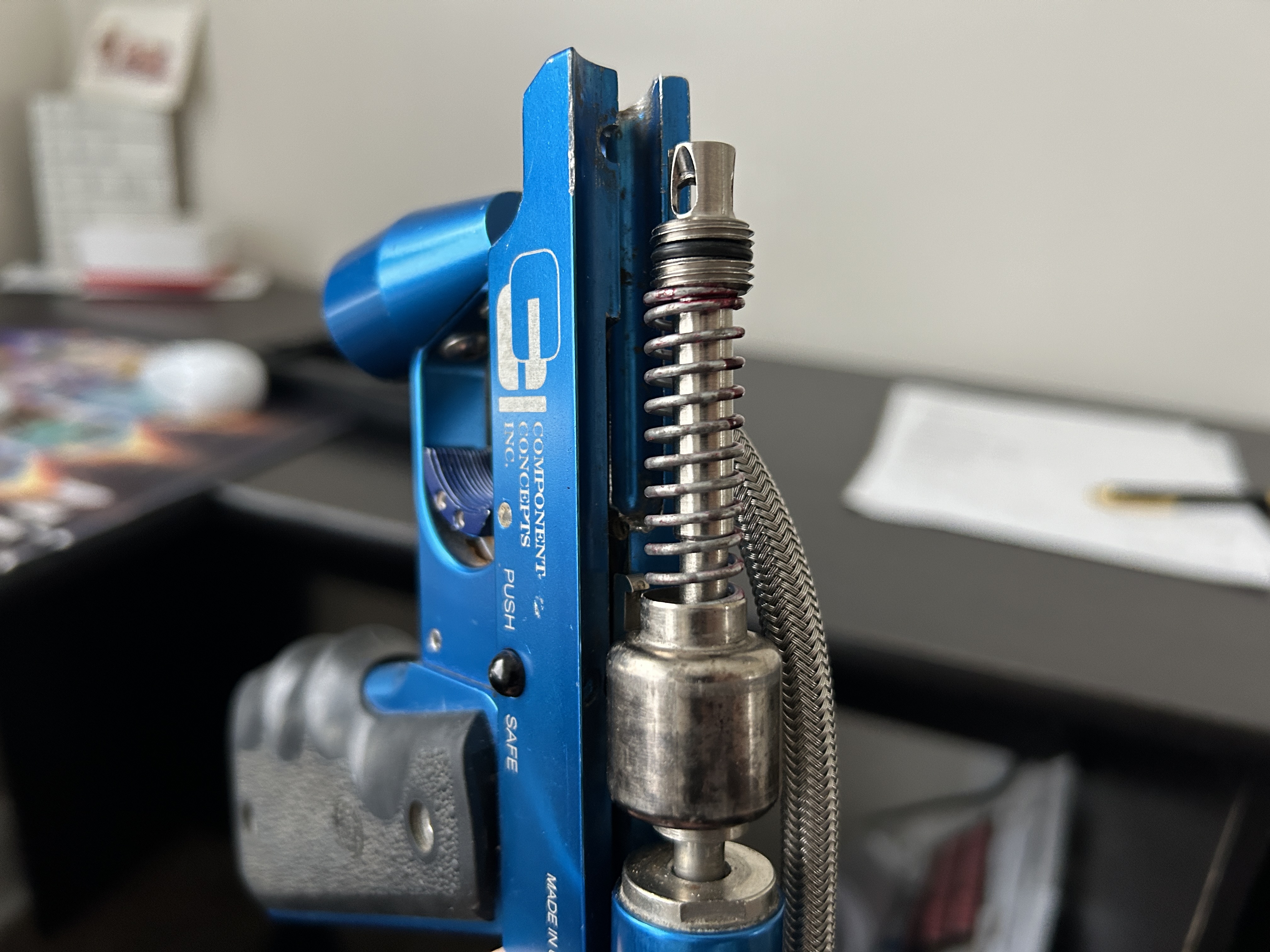

      I think you need to refer to the exploded parts diagram on the Phantom website. That stack is out of order in that one pic.
      EDIT: I’m not sure what I’m looking at either…
      EDIT EDIT: Ah….thats the center of the bolt. I’ve never seen one removed before since there’s no reason to ever do it. That must be what a compensator is. Please disregard my confusion.

        What you still need:
        bolt- any cci bolt from the last 30 years will be fine.
        Front frame screw
        Full pump handle/arm assembly (handle, arm, nut, washer, return spring)
        Barrel
        As SignofZeta said, wouldn't hurt to take a look at the parts diagram just so you know what the parts look like and how it all goes together.
