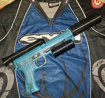

          JT ER2:
          metal Tigershark powertube,
          brand new Tracer brass cup seal and O-ring,
          stock ER2 valve spring,
          red CCI mainspring,
          3D printed stock feed/gate,
          3D printed big-boy pump handle/pins,
          3D printed Freak insert adapter barrel system,
          3D printed Freak XL insert fake suppressor,
          3D printed detents,
          painted the interior of the clamshells infantry blue...
          IGY6; 503.995.0257
          • MrKittyCatMeowFace
            MrKittyCatMeowFace commented
            Like the blue a lot. Did the Tigershark powertube fit no problem? And is i better for it?
          • DavidBoren
            DavidBoren commented
            The Tigershark powertube is a larger diameter than the bore in the valve nut... it took me 30-45 minutes pacing around the apartment rolling the powertube in some sandpaper, smoking bowls, listening to music... fits perfect, now. Lol.
            The Tigershark powertube is also slightly shorter, allowing air to expand in the bolt a little before hitting the ball. For better or worse. Still remains in the bolt throughout the pump stroke, so it being shorter is nothing to worry about.
            I sleep better at night knowing it's metal... other than that it's just something cool to do for the sake for having something cool to say you did.

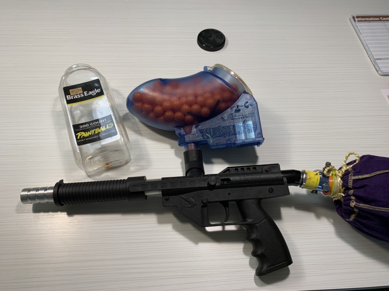

          My Trracer's stock class setup. I used this last weekend and other than the crappy Crosman 12 grams, was very happy with it. I played the second half of the day open class after getting 15 rounds from one 12ie a couple times.
          BigRed's feedback
          • 2378
          #26
          • BigRed
            BigRed commented
            Love it, now that's open class! Crown Royal bag is the icing on the cake. I used to use the same bag when I was a kid collecting payments for my paper route.
          • Ironnerd
            Ironnerd commented
            Yeah, Baby!
            I love those strange little aquatic beasts!

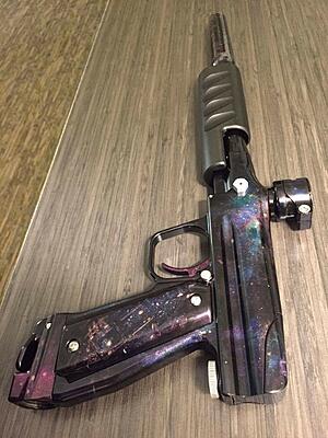

          I have finally remembered to take a halfway decent photo of my Bobtail.
          ChuckLove on YouTube
          • IndustrialHalo
            IndustrialHalo commented
            Wish I still had one of these bodies, so classy. I have all the other Kryptonite designs but the mini fighter and this.
          • 6368
          #28
          • ChuckLove
            ChuckLove commented
            It's so beautiful...
            Thank You. Its one of my favorite builds took a long time to find all the pieces. Wasn’t even sure it feeds would work the way I wanted.
