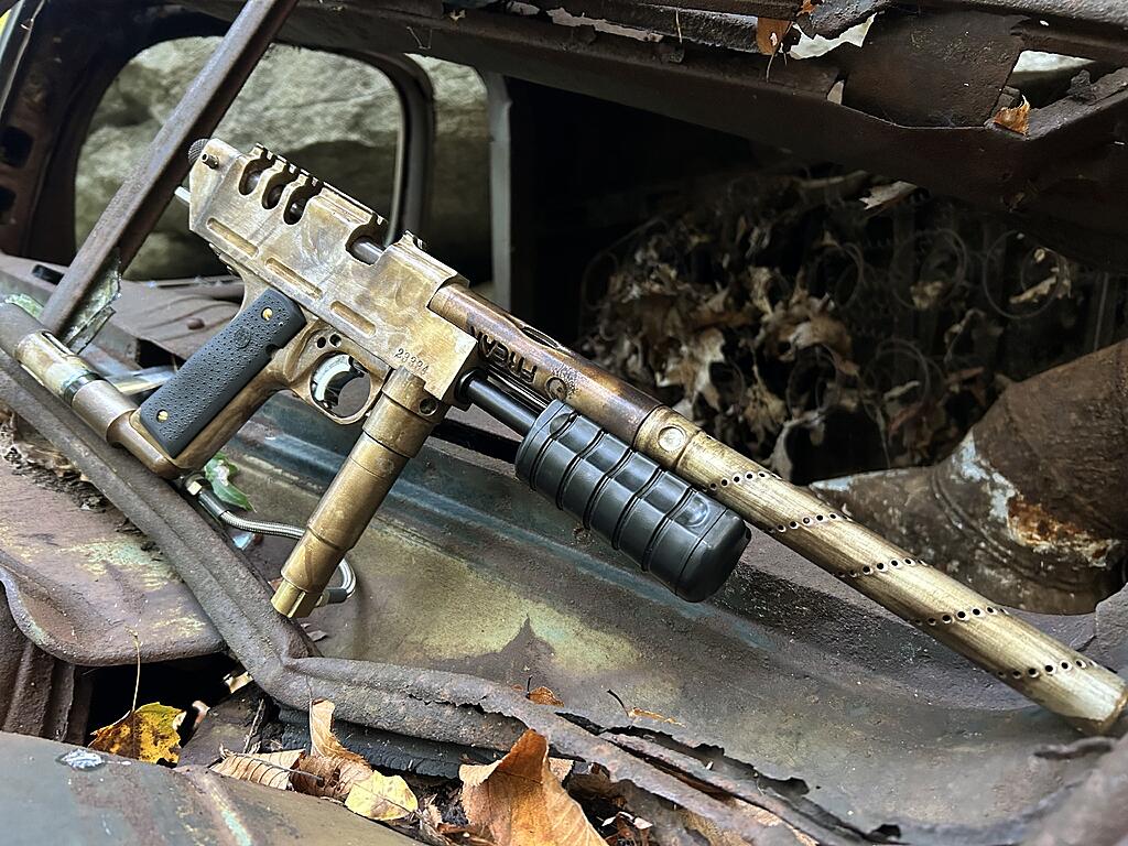

    Did some experiment with a force brass patina and acid on my hand load Sniper. Came out pretty cool as I hoped. Kind of a rusty looking finish.
    • Cal440
      Cal440 commented
      Looks great,its got apocalyptic end of days look
    • Impactfour
      Impactfour commented
      Sheeeeesh that's purty!
    • Psycho91
      Psycho91 commented
      Damn I really like this, might have to get one of my builds done like this if you offered this as a service

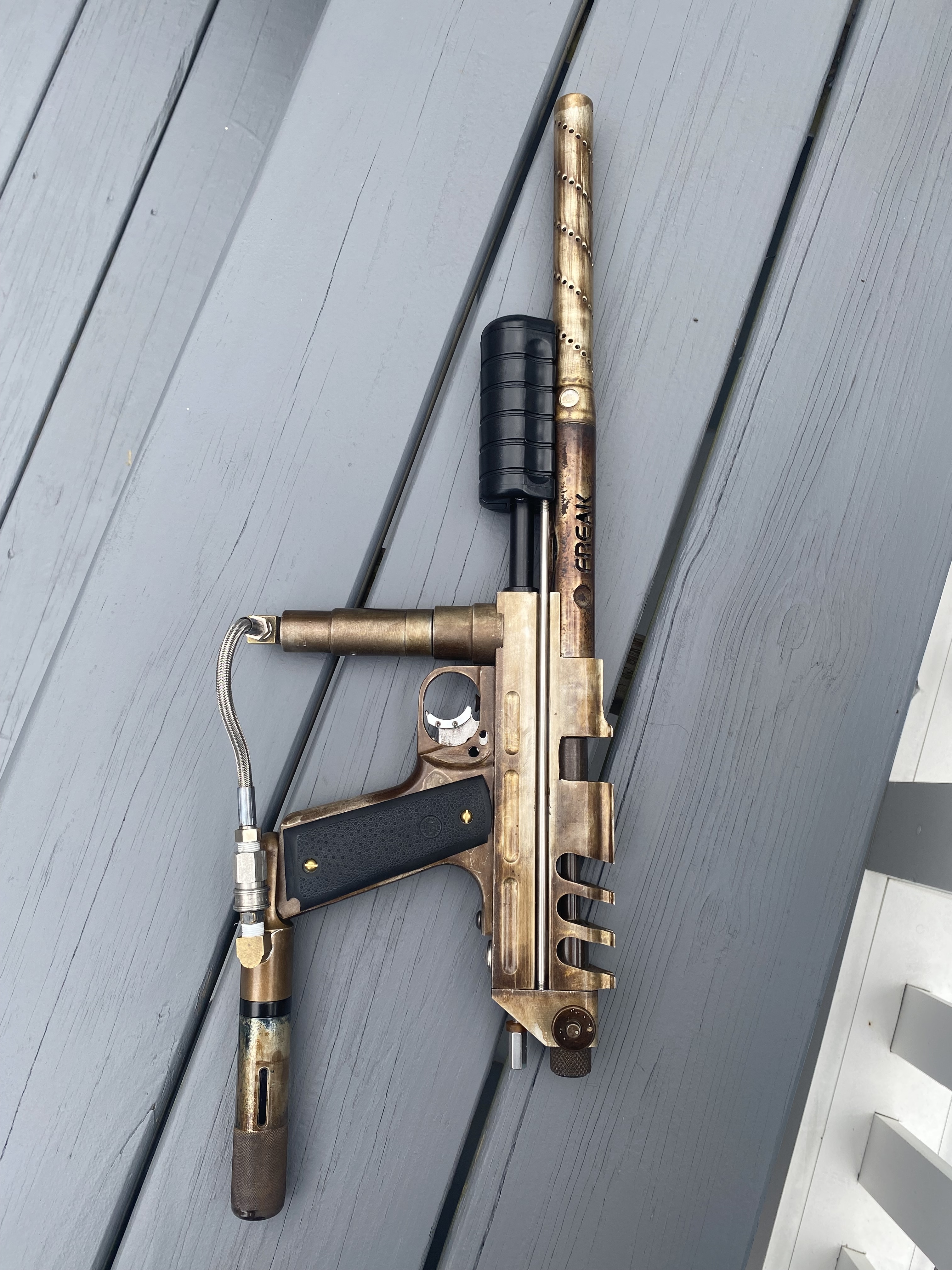

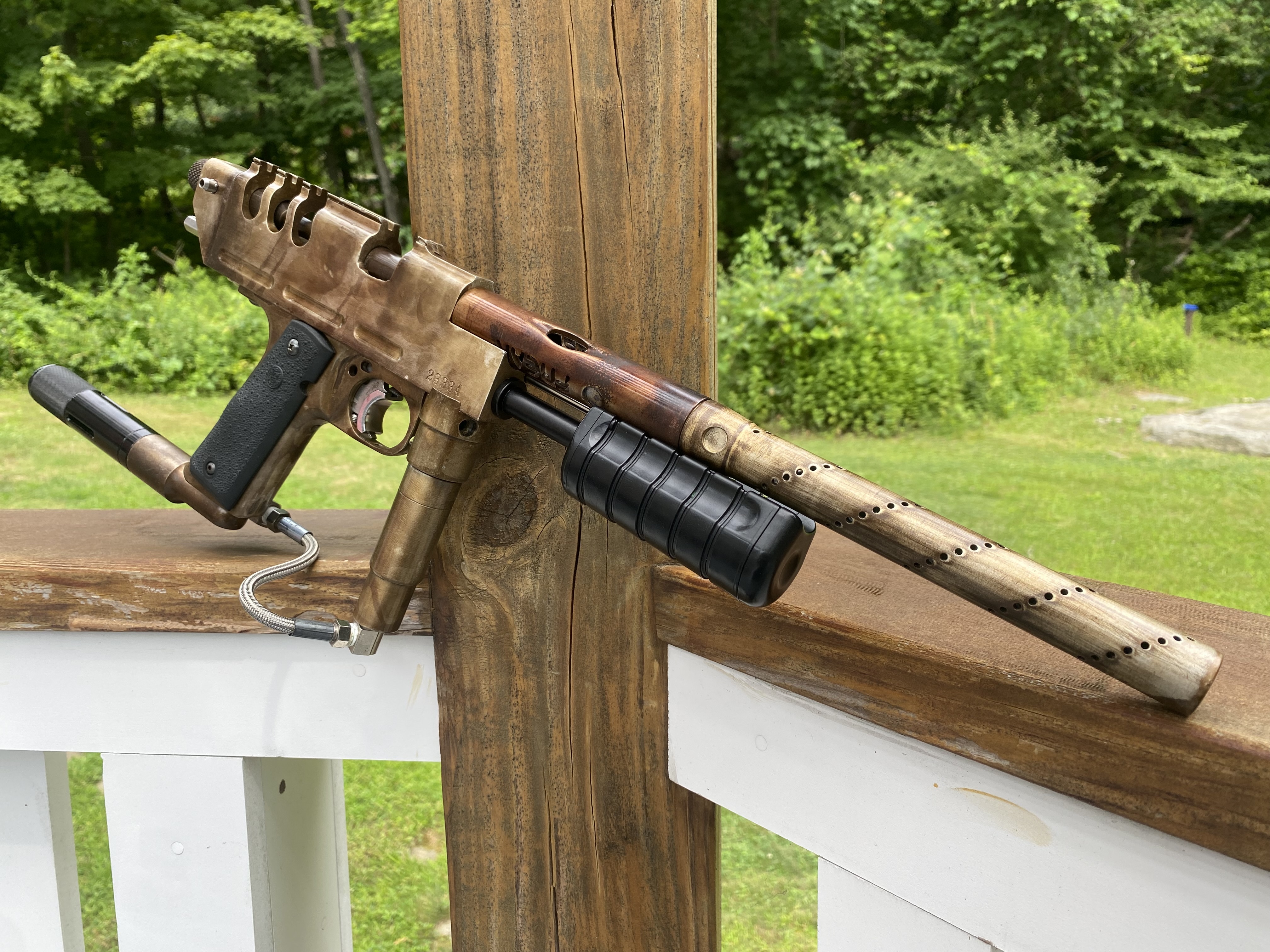

    Second update on the “apocalyptic” thanks Cal440 for the perfect description of this shooter. Decided on doing the bucket changer , bolt pin and threw on some brass fittings. Now it’s done.
    • Psycho91
      Psycho91 commented
      Damn I love that finish
    • Cal440
      Cal440 commented
      Wow,looks even better now.👍 Could you describe just a quick how to on your technique?
    • NONOBLITUS
      NONOBLITUS commented
      Yea it was kind of some hours put into it. First I took all the parts down to bare aluminum then gave them a good scuff down and found on the later pieces that if I left some faint black it made the parts look older with some faint black showing through. I bought a chemical you mix one part patina and one part acid.
      Pieces all were coated with this solution and works pretty fast the longer the darker.
      Rinsed all pieces clean with water and applied a clear lacquer over all the parts. Just time consuming but worth it to me.

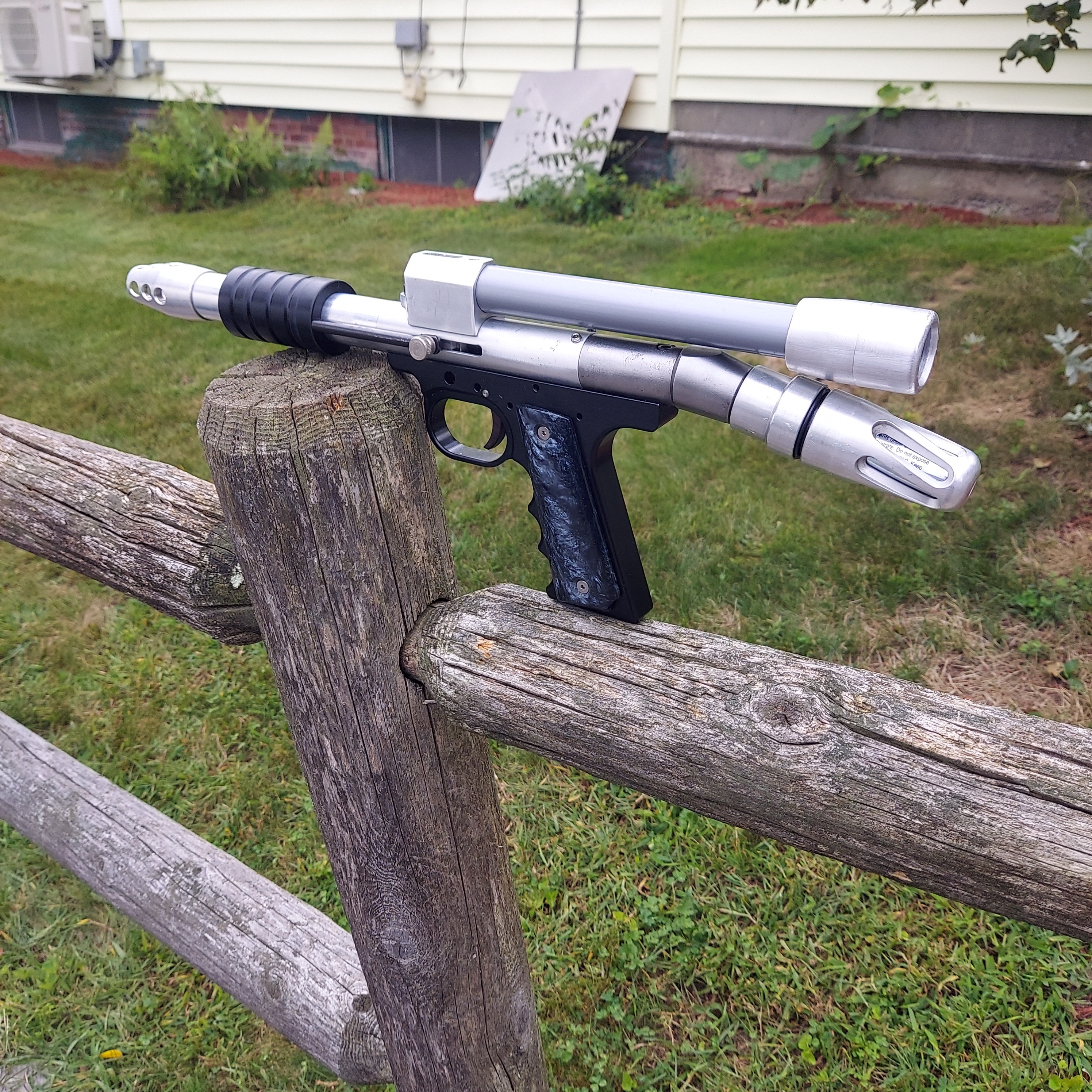

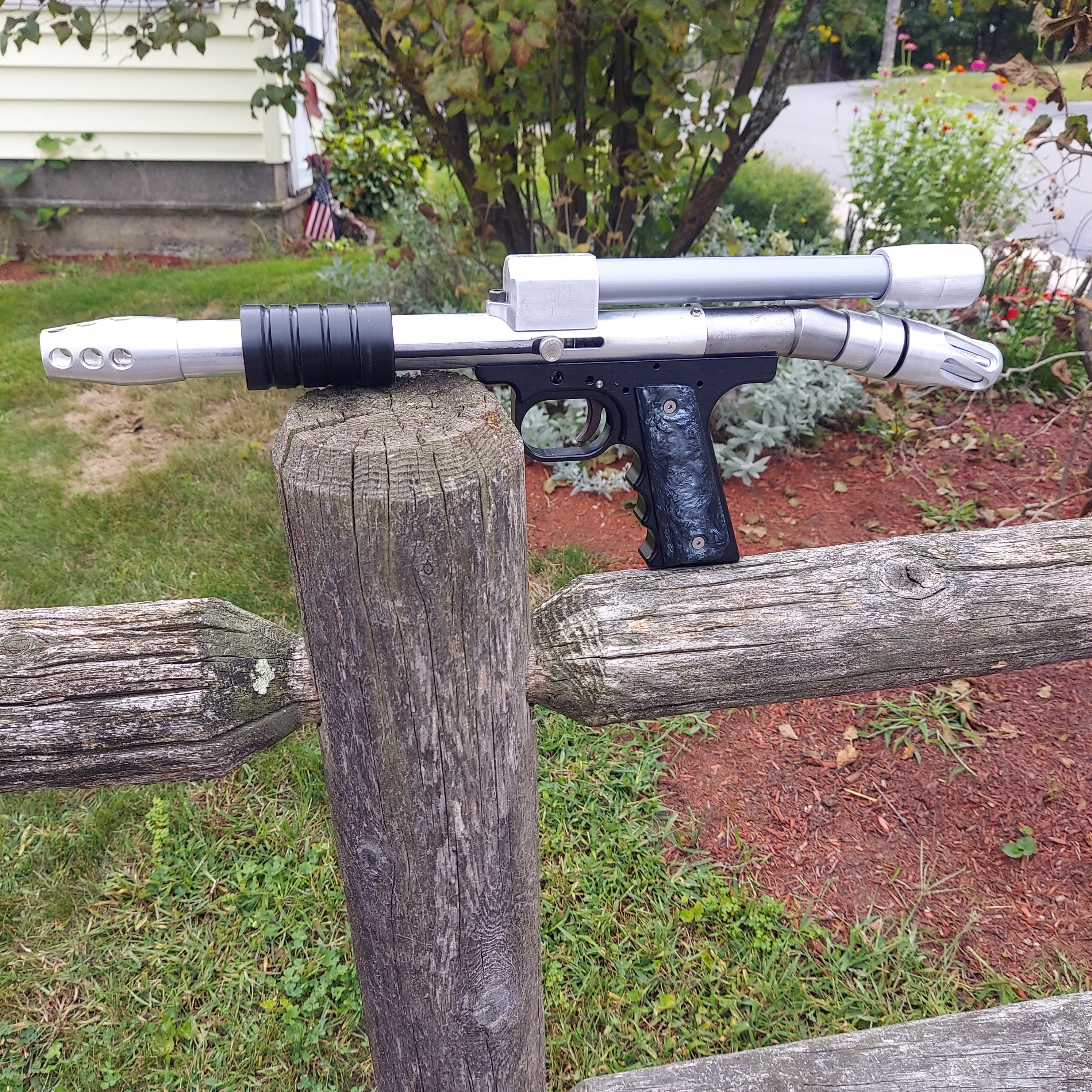

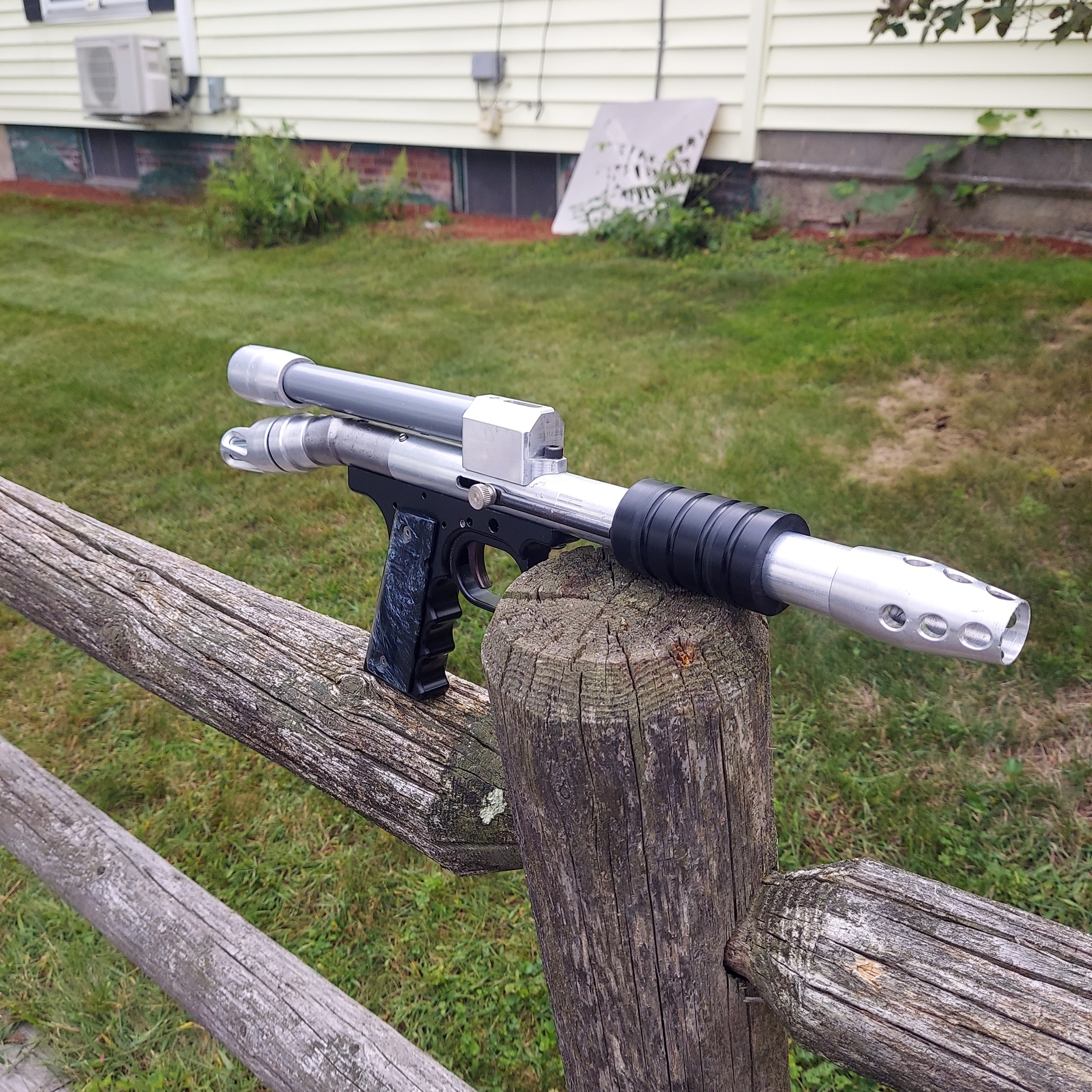

    I guess this is how it starts, one day you pick up a Cocker...
    Oddly enough, this is my first one.

      Hey he finally got an open class sniper!

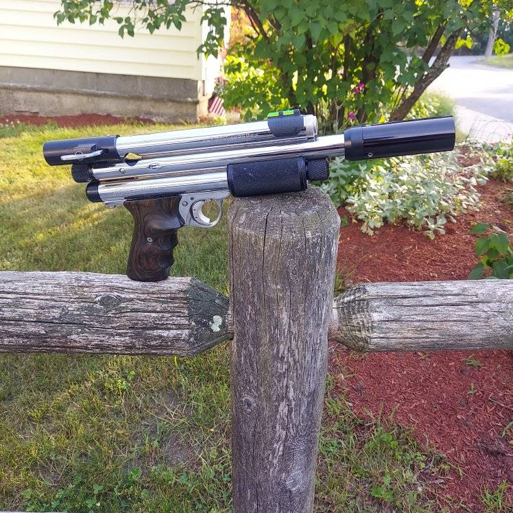

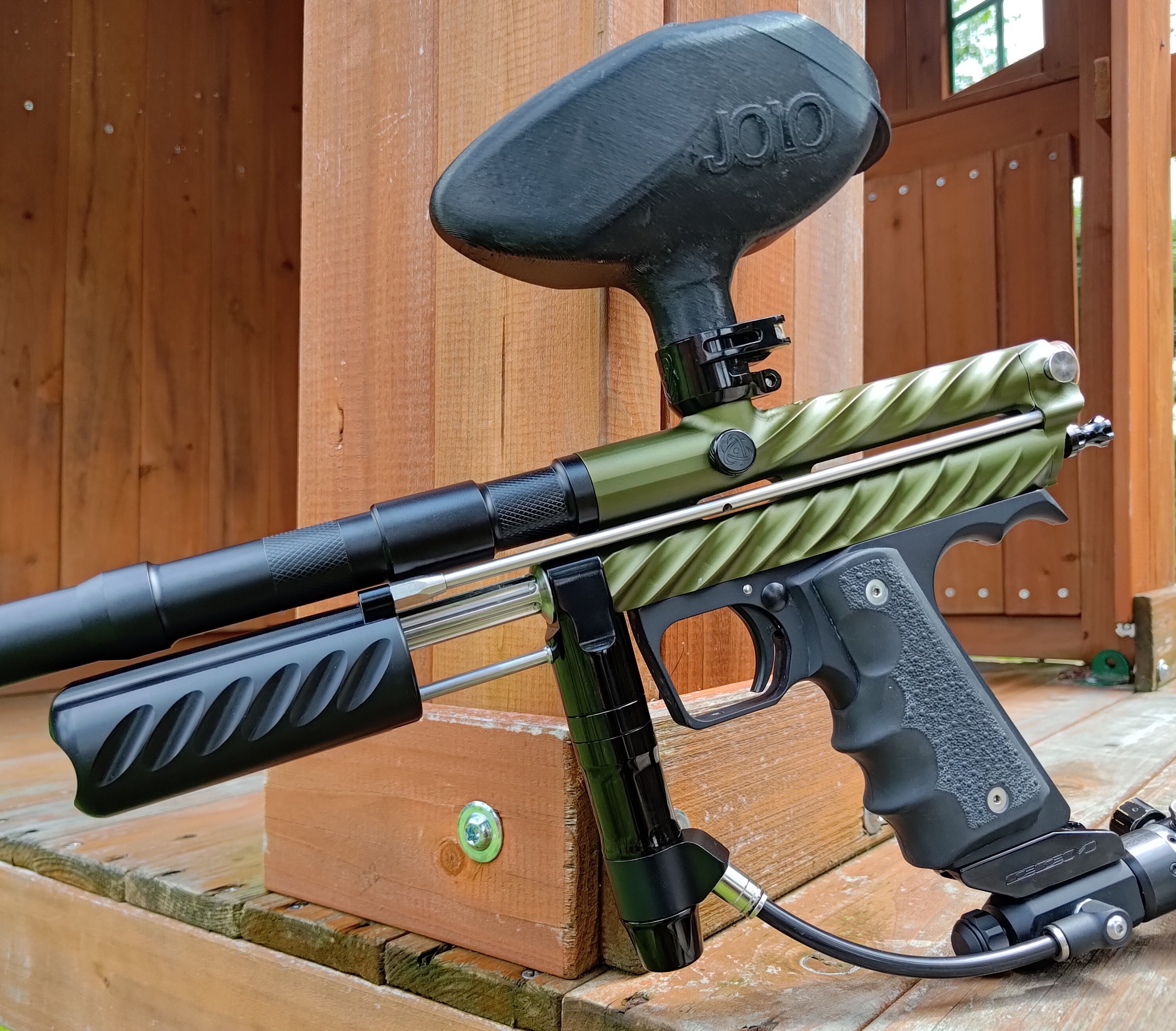

    Inception Mini Ripper Sniper. I've probably posted this previously in a different configuration. This one being my favorite and therefore worthy of sharing.
    ChuckLove on YouTube
    • JeeperCreeper
      JeeperCreeper commented
      I'm really loving that green on the Ripper body.
    • ChuckLove
      ChuckLove commented
      JeeperCreeper Olive Green & Black are my colors. This one was done by Ruckus anodizing.

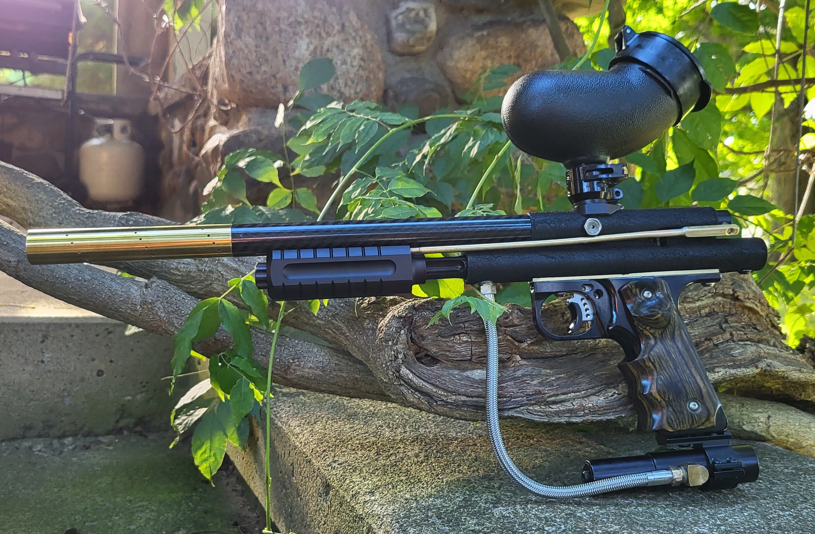

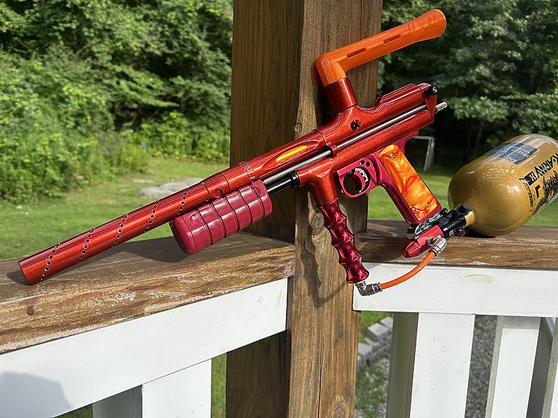

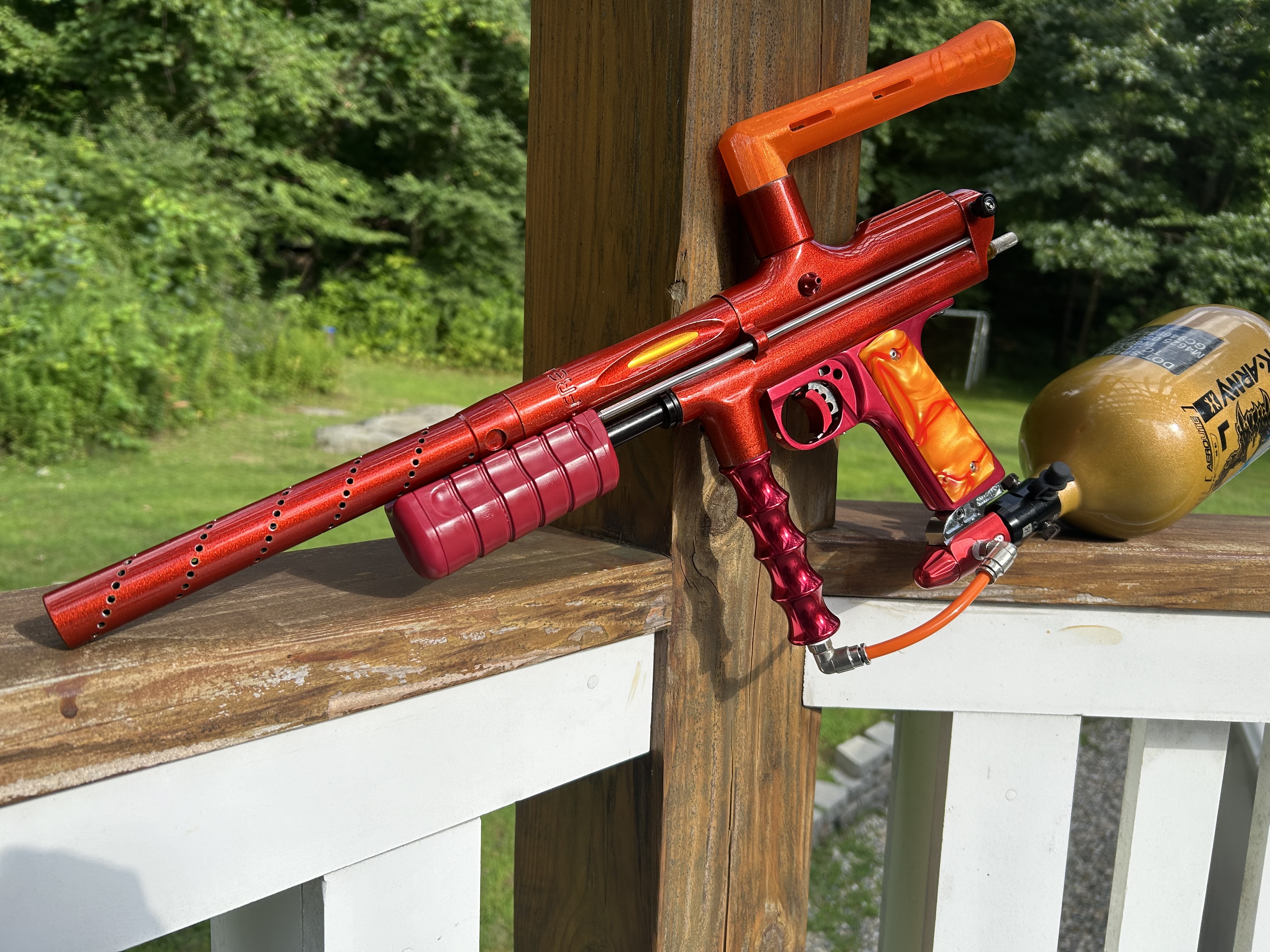

      Updated Trippy Trilogy with a red slider I acquired form latches109 , finally all came together
        That’s sexy AF man
      • NONOBLITUS
        Thanks man

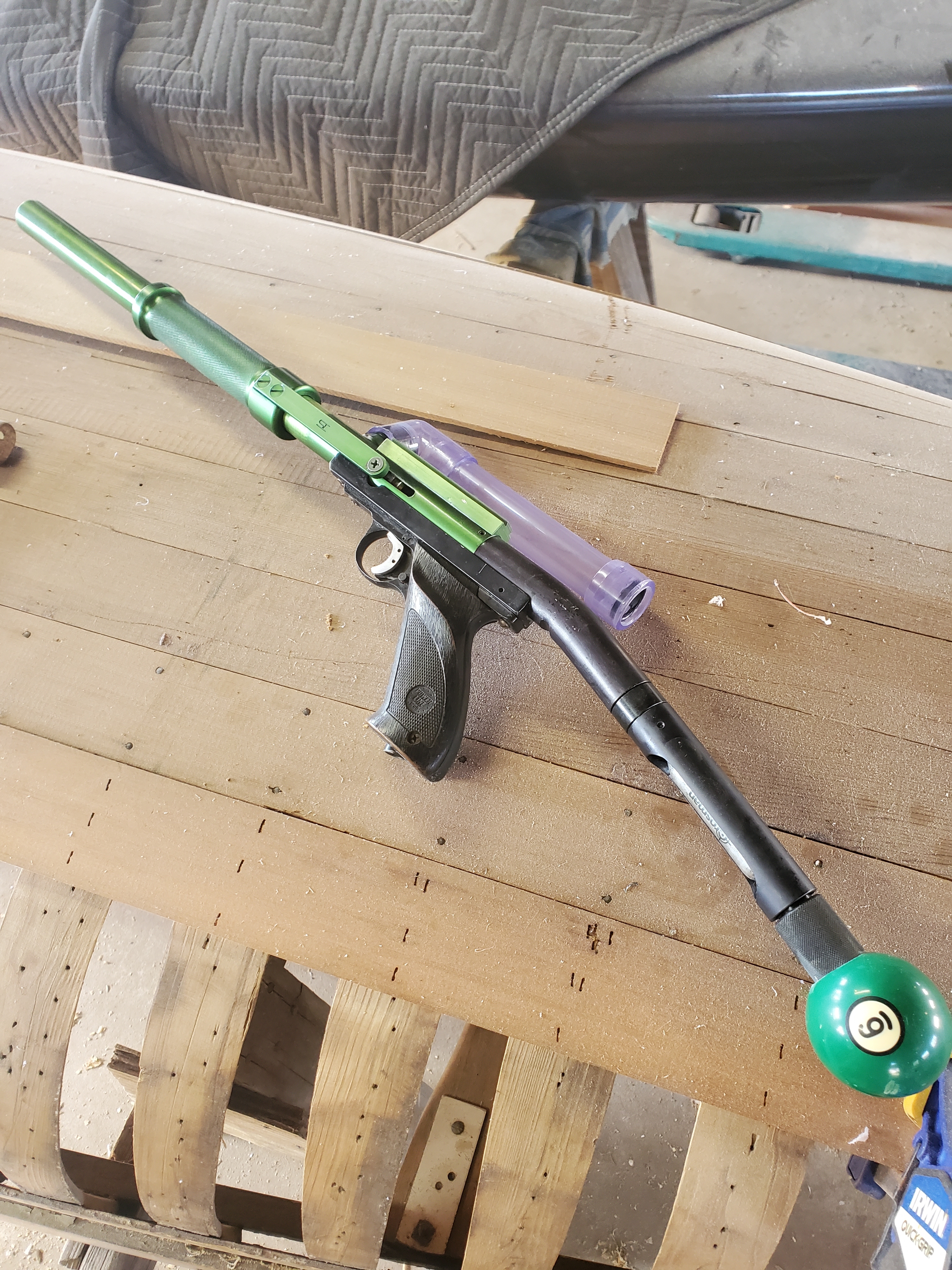

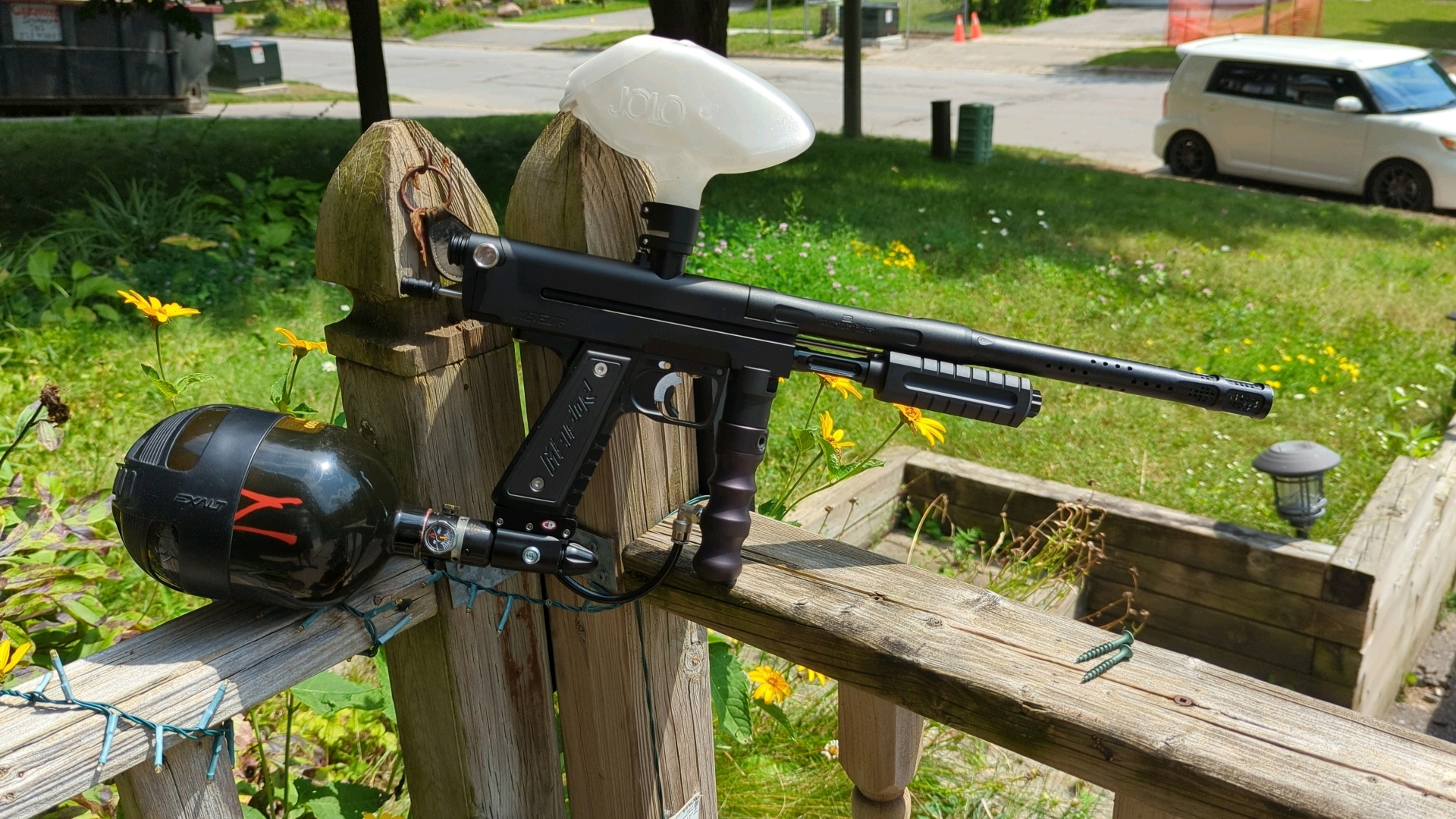

        No idea who made the body or the feed but it's currently a stock Nelspot under the hood. The feed tube itself was made by me out of a broom handle and the feed cap was made by Punisher's Customs
        • flyweightnate
          flyweightnate commented
          Nice... mine wasn't lining up, and just wanted to make sure others also had to do some work on it. With the mutts, I'm always wary off which piece is the odd one out.
        • russc
          russc commented
          Did you make that 12g changer?
        • Chaos
          Chaos commented
          That 12g changer is from War Machine

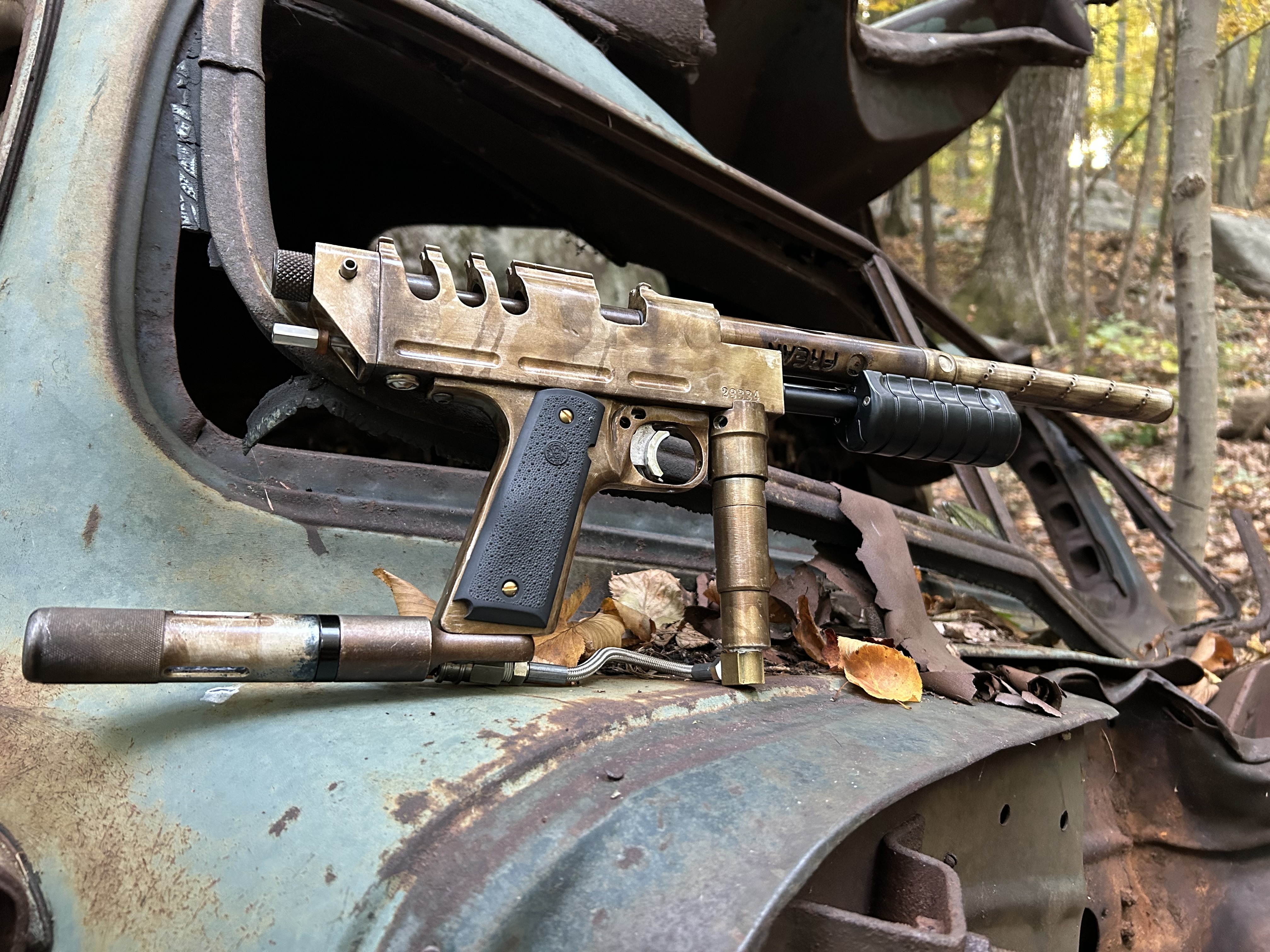

ID:	599043 Couldn’t resist posting this shooter up again. Did some rusty pictures with it for fun. Apocalyptic Sniper.

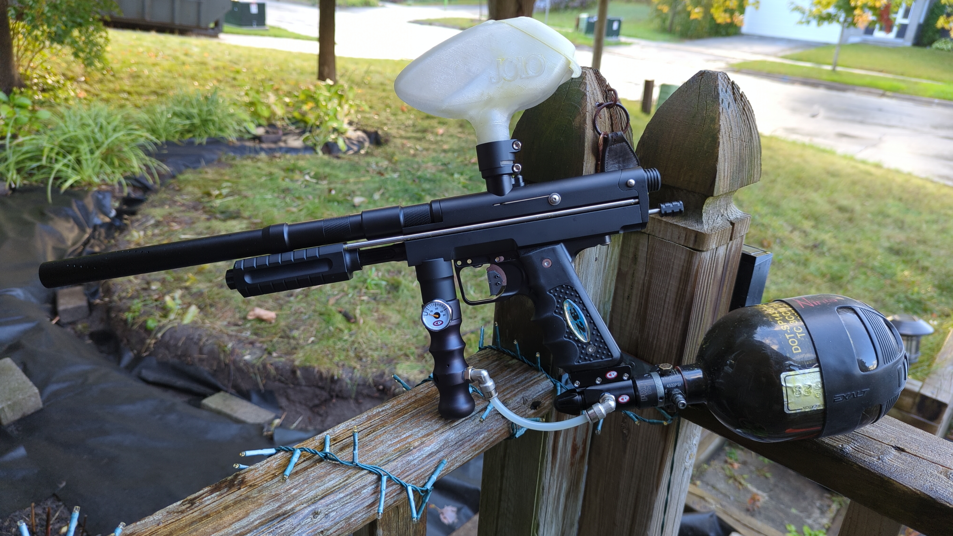

            Click image for larger version  Name:	2024-10-08-08-20-10-008.jpg Views:	14 Size:	5.18 MB ID:	601561
            Not much else to change. Played with it this weekend and was very happy with it.
            LAZ valve
            AKA Lightning bolt
            3D printed hammer, 9 grams
            Sconi Epsilon barrel
            CP on/off + rail
            WGP Ergo reg from VF tac
            32 degrees grips
            Flat 3D printed trigger shoe
