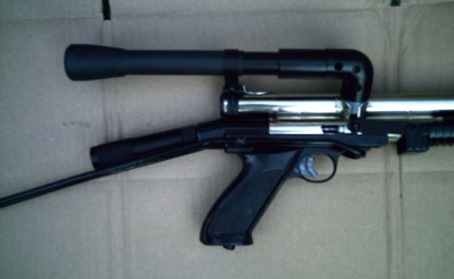

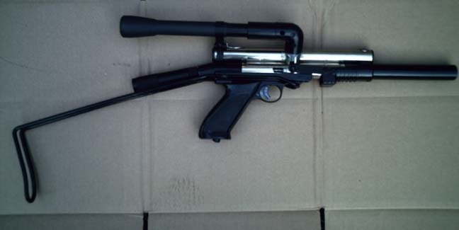

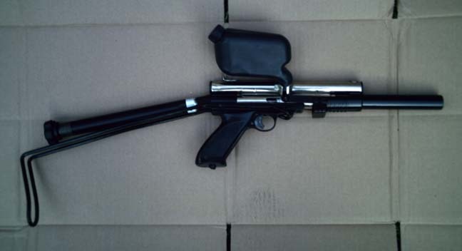

  • acrewofone
    Crosman 3357 AGA62 Expert
    • 438
    • Hagerstown Maryland
    #106

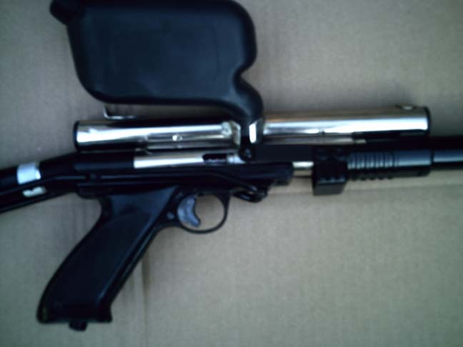

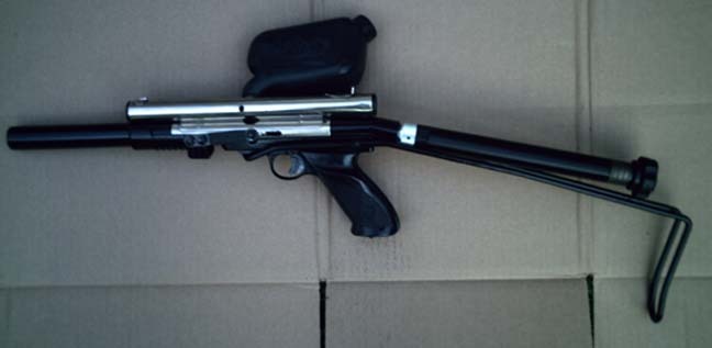

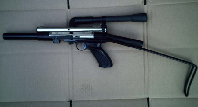

    Nelspot 007
    polished body
    quick strip slot
    slotted right side
    double tapped bolt
    dual armed pump handle made from broken Nelspot pump handle
    CCI Paintball red main spring
    Lapco #6 powertube
    Lapco valve retaining screw
    Black Magic valve cup seal
    WGP trigger shoe
    Nelspot wire stock
    7.5” extended barrel
    back bottle adapter
    12 gram bucket changer
    Airsource dual 12gram changer
    JT Paintball airgun to paintball asa adapter
    welded in hopper adapter
    Zap pocket hopper
    20 round horizontal feed adapter​
    Setup for Stock Class Play

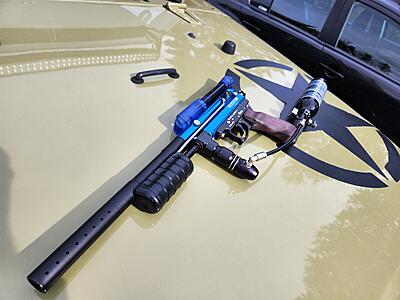

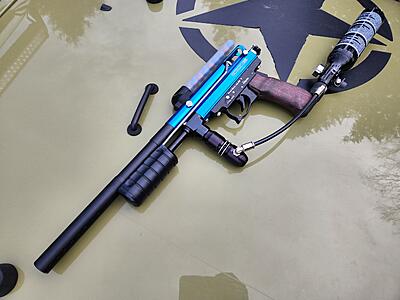

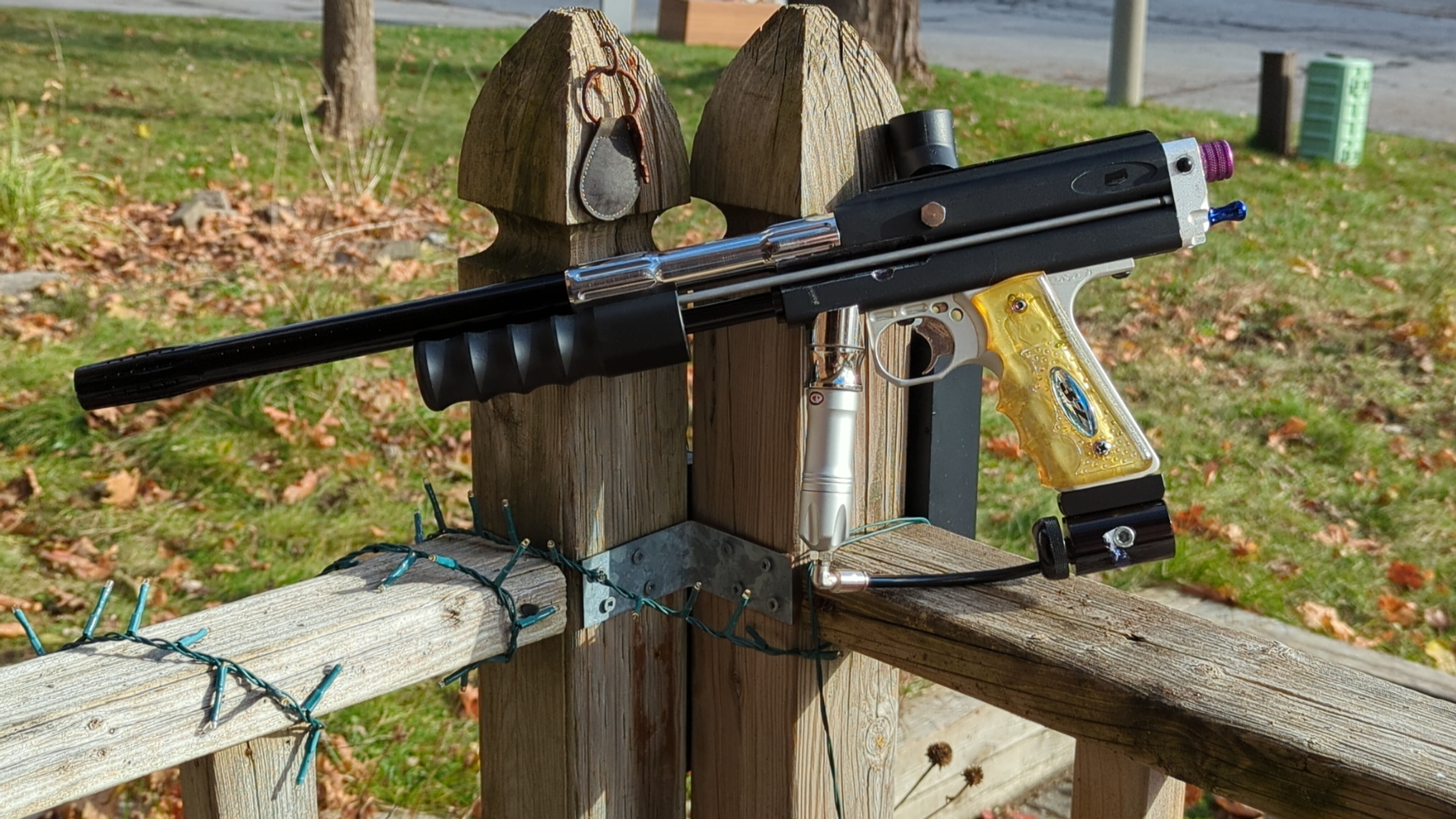

    Revamped the Syder pump. New pump rod, new bolt pin, redid the valve mod, and threw it all back in the 32 Degrees body, which uses a cocker detent, and I have a cocker finger detent in the barrel. I may add a CCI feed to it still, but I'm happy with how clean it looks.
    Edit* CCI feed fits perfectly

      So basically I turned a Spyder into a Sheridan pump 😆. I even hid a piece of brass inside

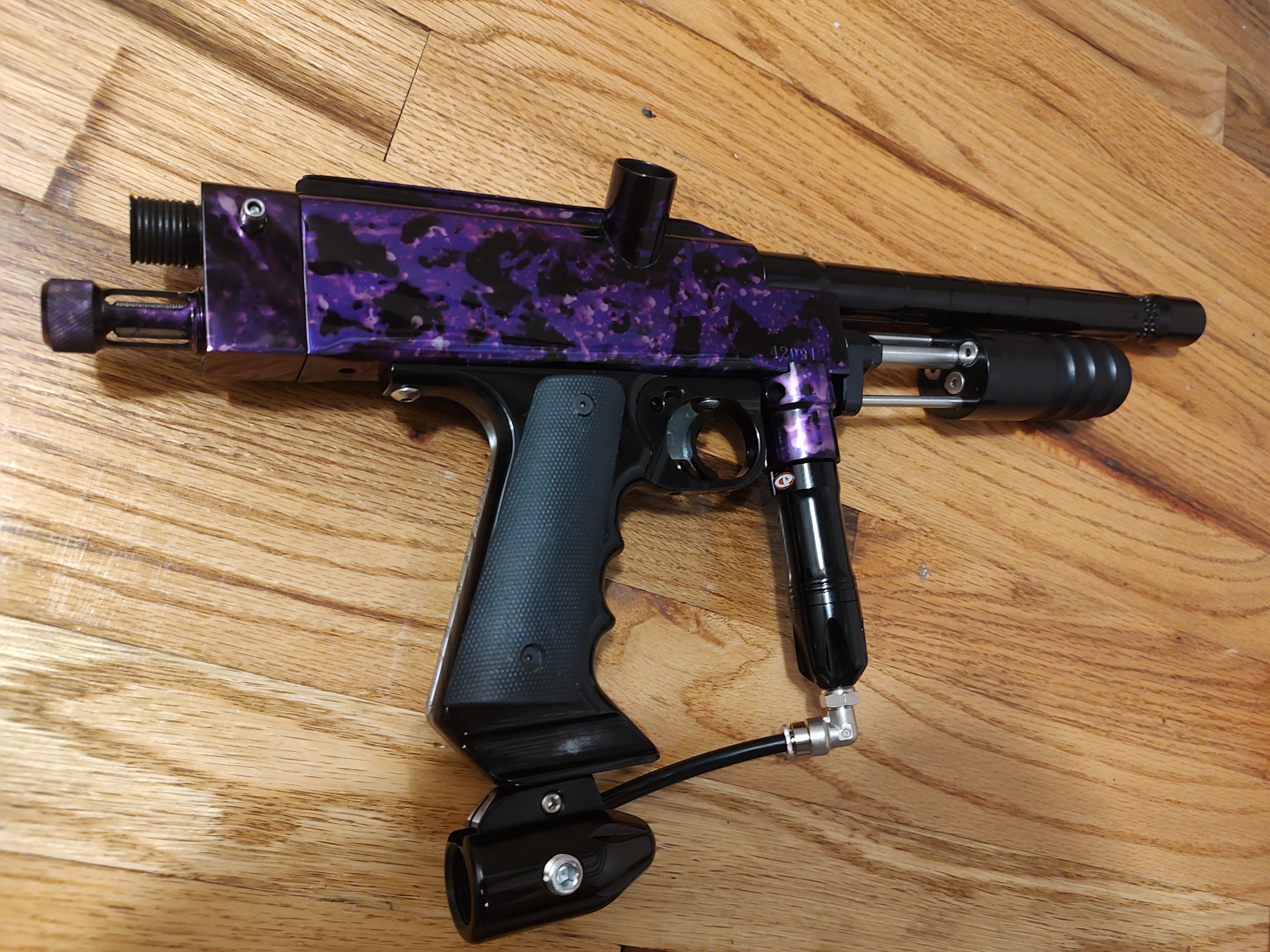

    #109
    Got all the parts for now, I'm not crazy about the frame and might replace it with a mozak but I'm pretty happy for now. Just gotta get the barrel bored, tune it and she's ready to go. I'll have my wife take better pics later. Click image for larger version

    • Impactfour
      Impactfour commented
      Chuck E Ducky, naw it's an anno done by arc with what seems like a knockoff or unbranded frame that's similar to the ones from the bob long signature series. I honestly can't tell you too much about it, sure is pretty and purple though!
      Definitely looks like a fun shooter.
    • Impactfour
      I'm gonna throw a stick feed and the smallest HPA tank I can find on it, probably gonna snag a jolo hopper for the wife while I'm ordering from paintball DNA, this is "her" gun after all.

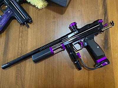

    Added some color to my go to open class pump.
    • NONOBLITUS
      NONOBLITUS commented
      That is top shelf
    • Impactfour
      Speaking of pretty and purple! Sheeeeesh!

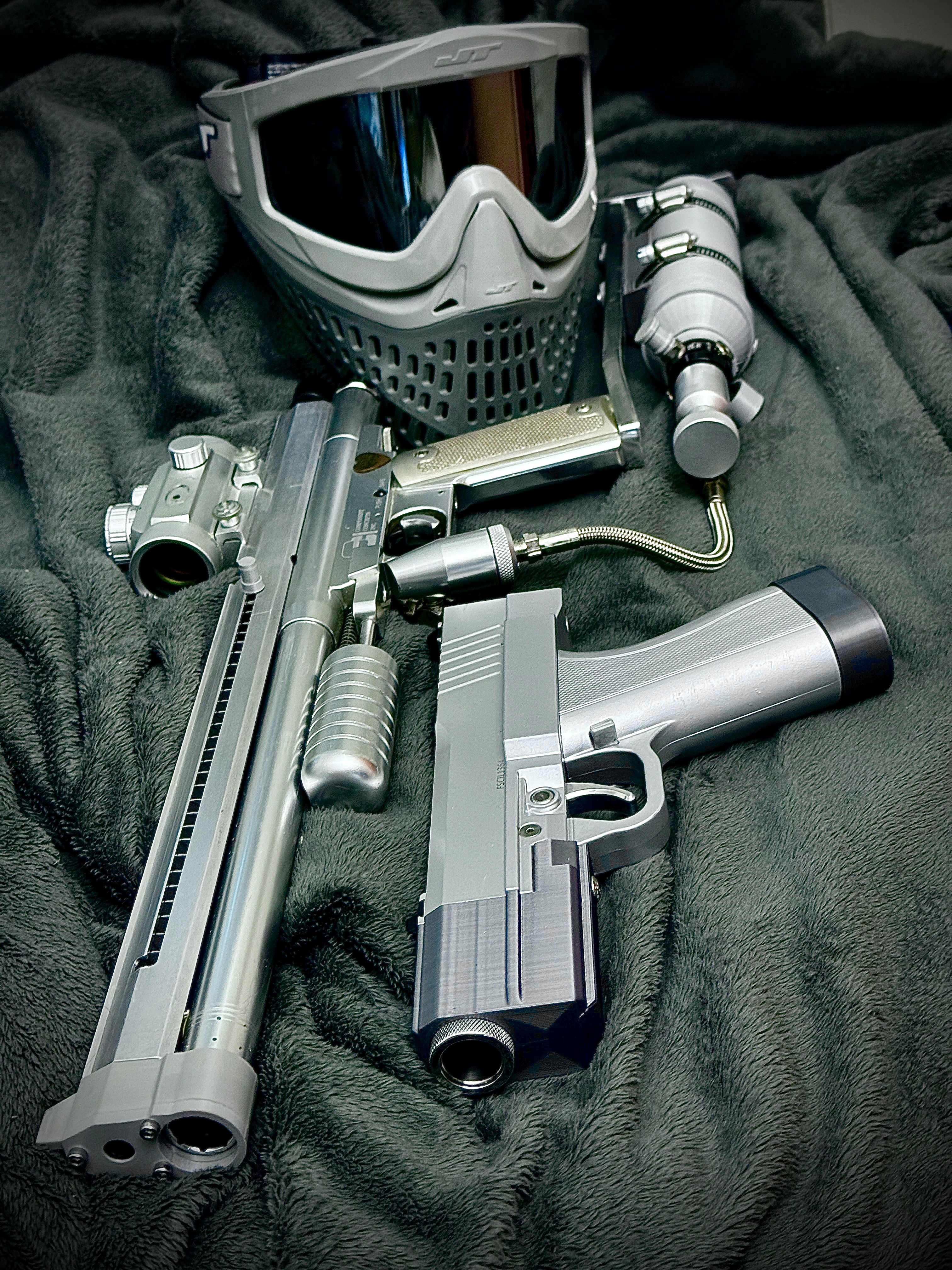

  • wthomas333
    • 577
    • AL
    #111
    Pair of TASO Typhoons
      Ended up getting that package nice they look In great condition.

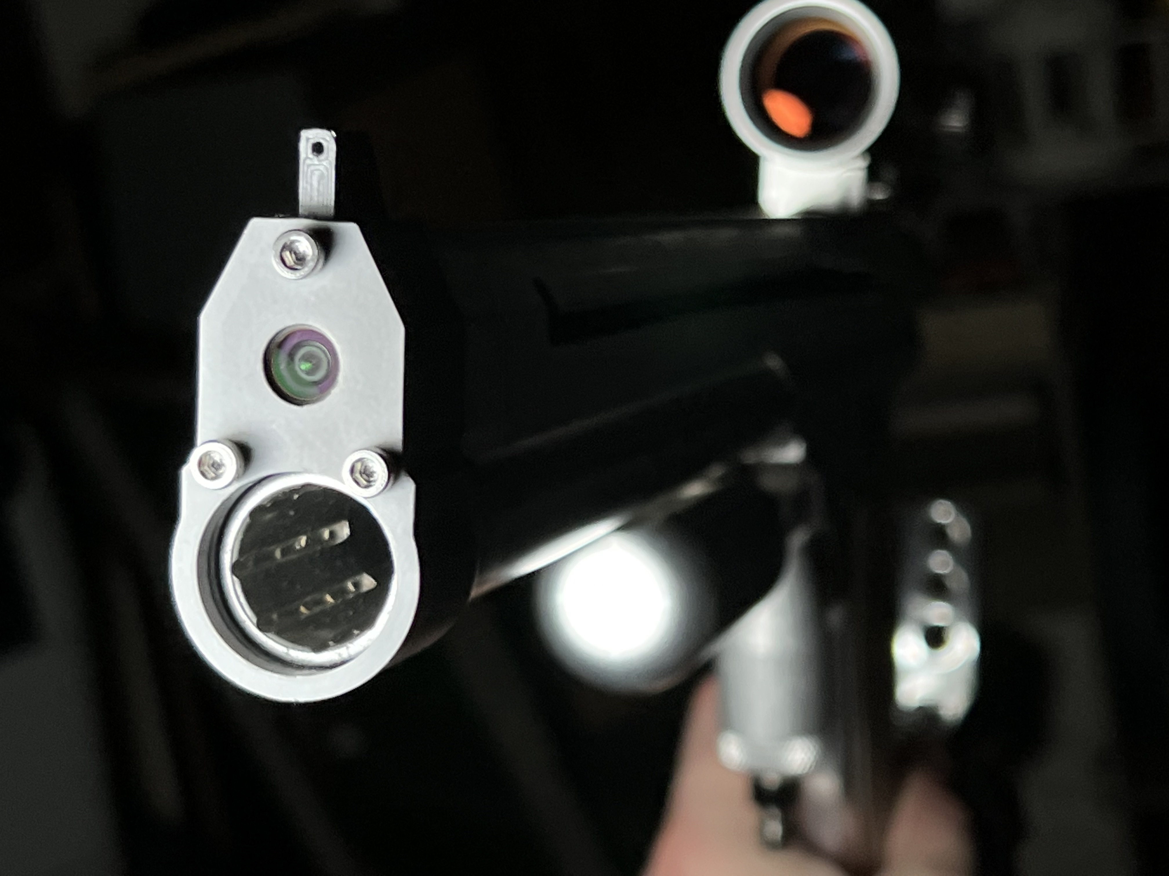

    Silver spring feed Phantom with stabilizer, freak bored barrel, and integrated barrel camera.
ID:	497629 Click image for larger version
    • CUBE
      CUBE commented
      Thanks. Yeah, I'm going on the paint thing based on what I've read in some Reddit discussions about it. I've gotta do some filing and rounding-out, too, apparently.
      I mean, at the end of the day, it should work pretty well even with "bad" paint. It just doesn't. Is this an EV product or something Mike cooked up?
      Stick feed works a lot better so that's what I'm using. I feel like I'll need a whole day of just filing edges down and making little changes to get the spring feed functional, and that's a big maybe even. It's kind of a project piece now.
      iamthelazerviking commented
      It's an EV concoction, and I've never heard anything good about them
      XEMON commented
      For making one from scratch, I can tell you the distance between the feed and body is absolutely critical on breach drop guns. And phantom has a large breach, making it even more sensitive ...

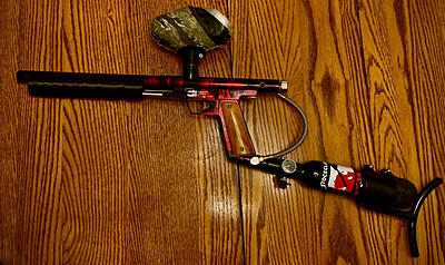

    • 1367
    • Taylorsville, MD
    #114
    stock made from aluminum
    WELTHOUSE x Timberghosts
    my feedback

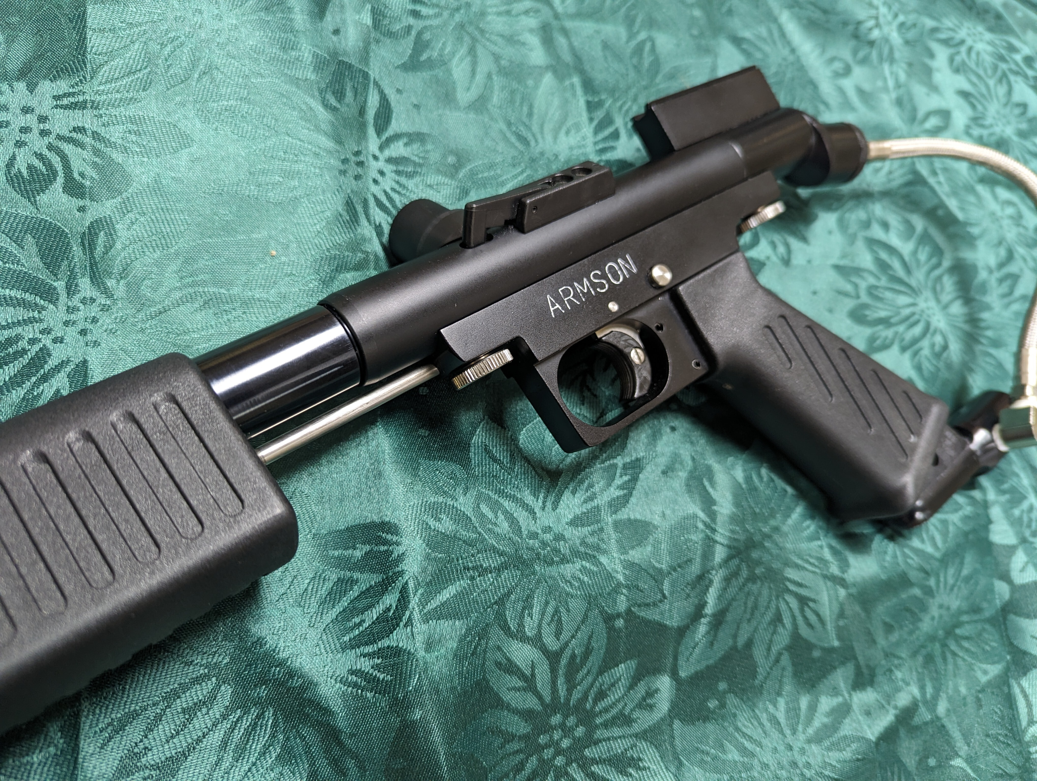

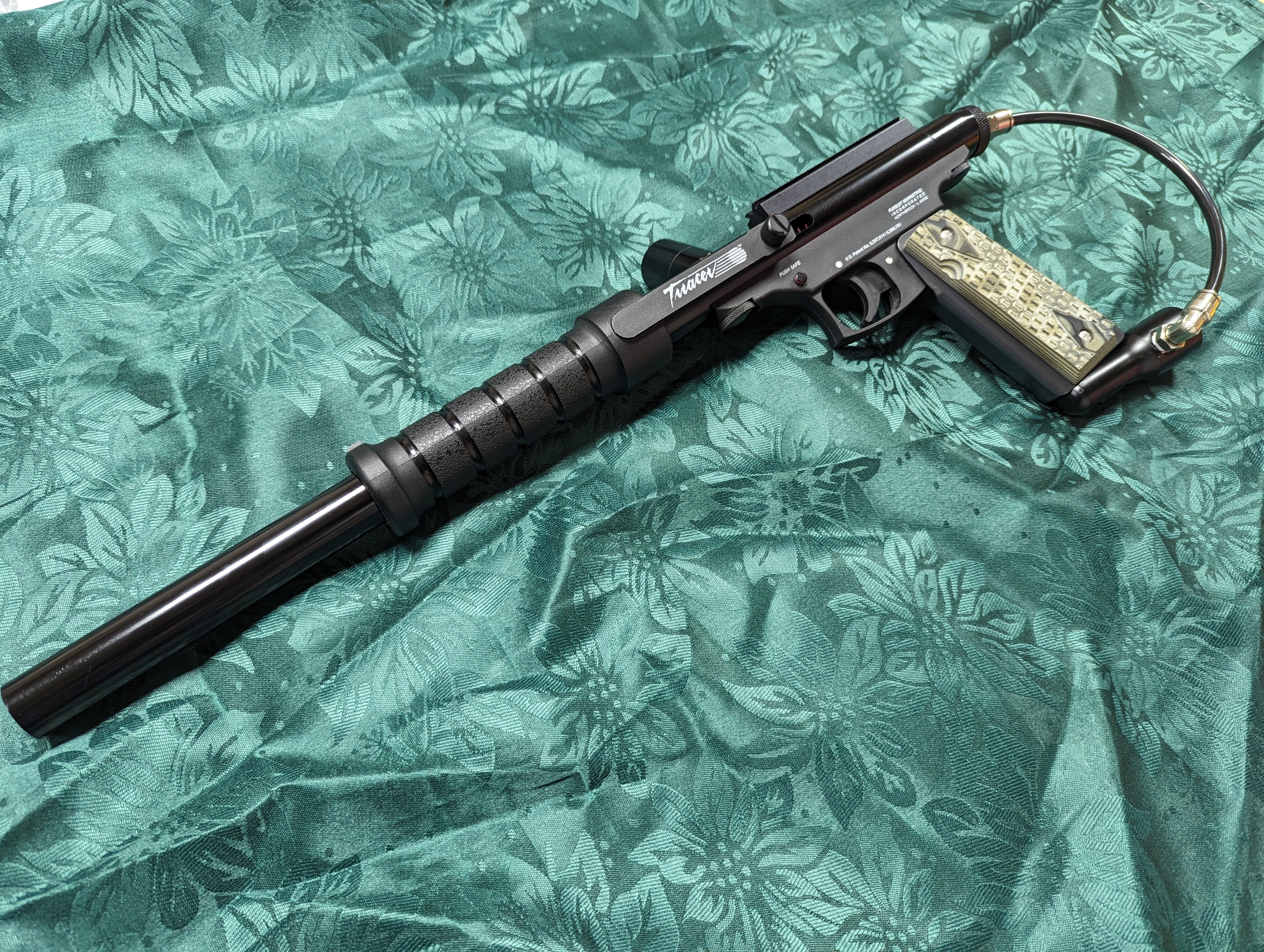

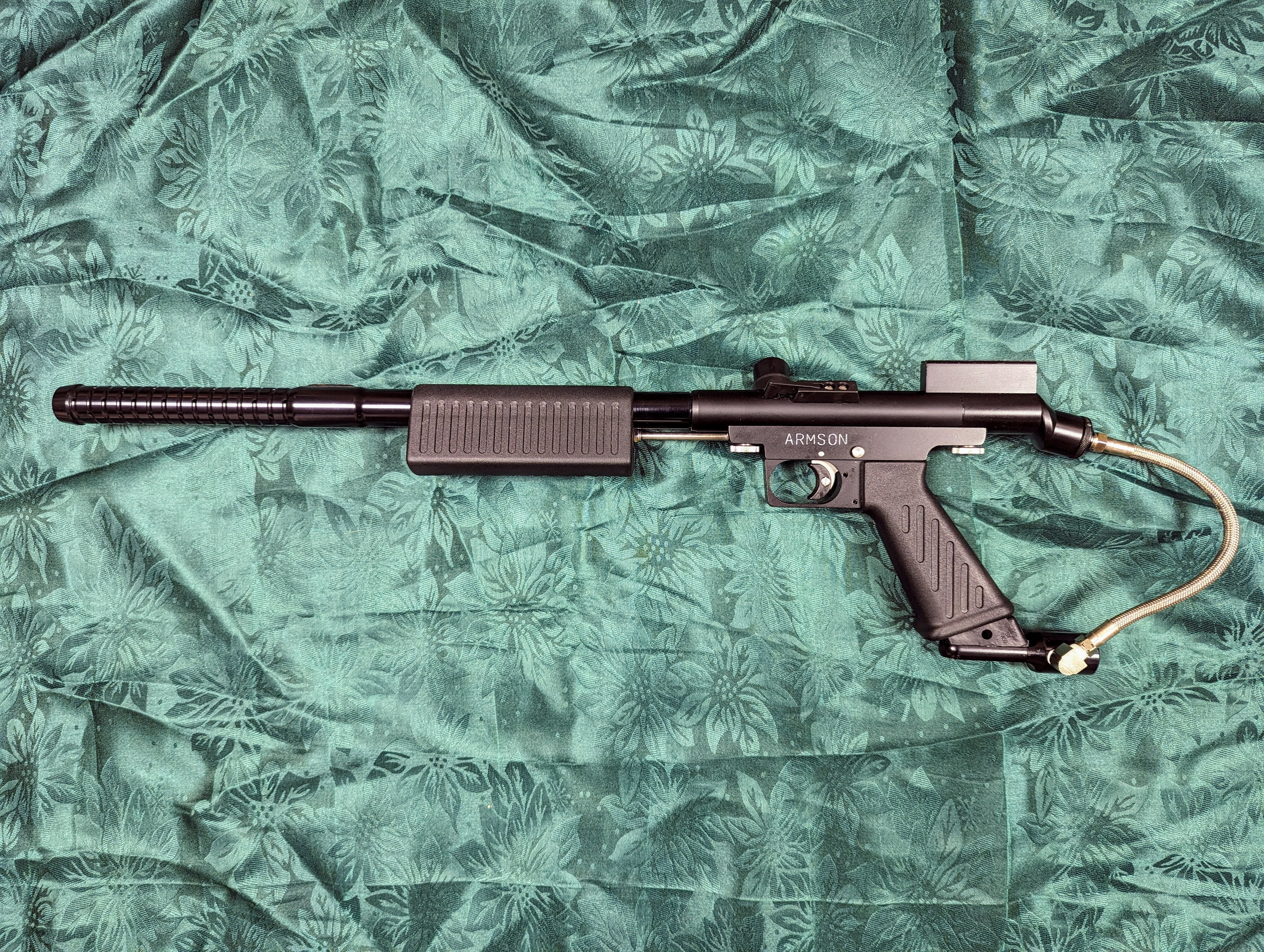

      #117
      Trracer
      Click image for larger version  Name:	PXL_20240406_033342413.jpg Views:	0 Size:	6.75 MB ID:	530160 Click image for larger version  Name:	PXL_20240406_033420973.jpg Views:	0 Size:	4.94 MB ID:	530161

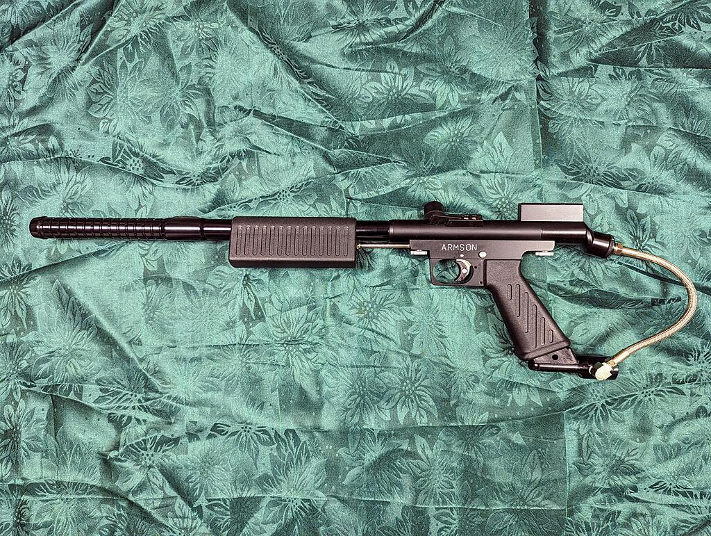

      Armson
      Click image for larger version  Name:	PXL_20240316_030318163~3.jpg Views:	0 Size:	6.44 MB ID:	523272 Click image for larger version  Name:	PXL_20240316_025809618~2.jpg Views:	0 Size:	3.49 MB ID:	523273 Click image for larger version  Name:	PXL_20240316_025845540~2.jpg Views:	0 Size:	3.95 MB ID:	523275

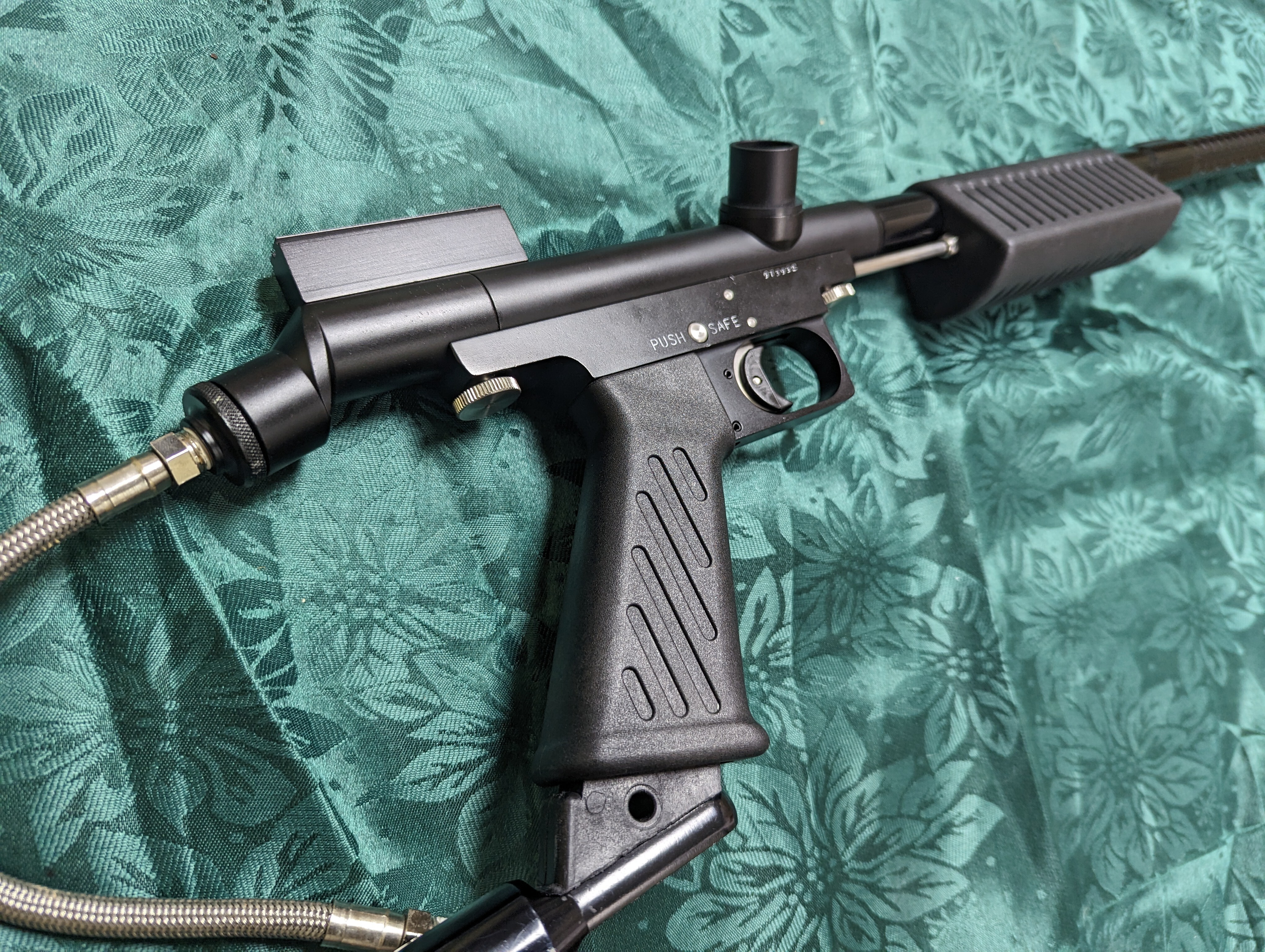

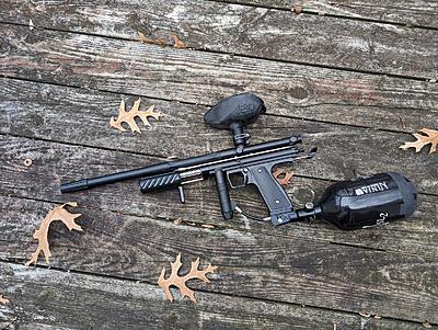

        #118
        I used this all weekend for stock class play. Worked flawlessly on 12 grams.
        Red One
        • peter2
          peter2 commented
          any details about the setup? Standard valve? Reg - how much psi? Thx!
        • ChuckLove
          ChuckLove commented
          I meant to ask you about this thing. It looks awesome 👍
        • BLachance75
          BLachance75 commented
          ChuckLove I’ll have it at Stockstice if you’re going. You can try it out if you want

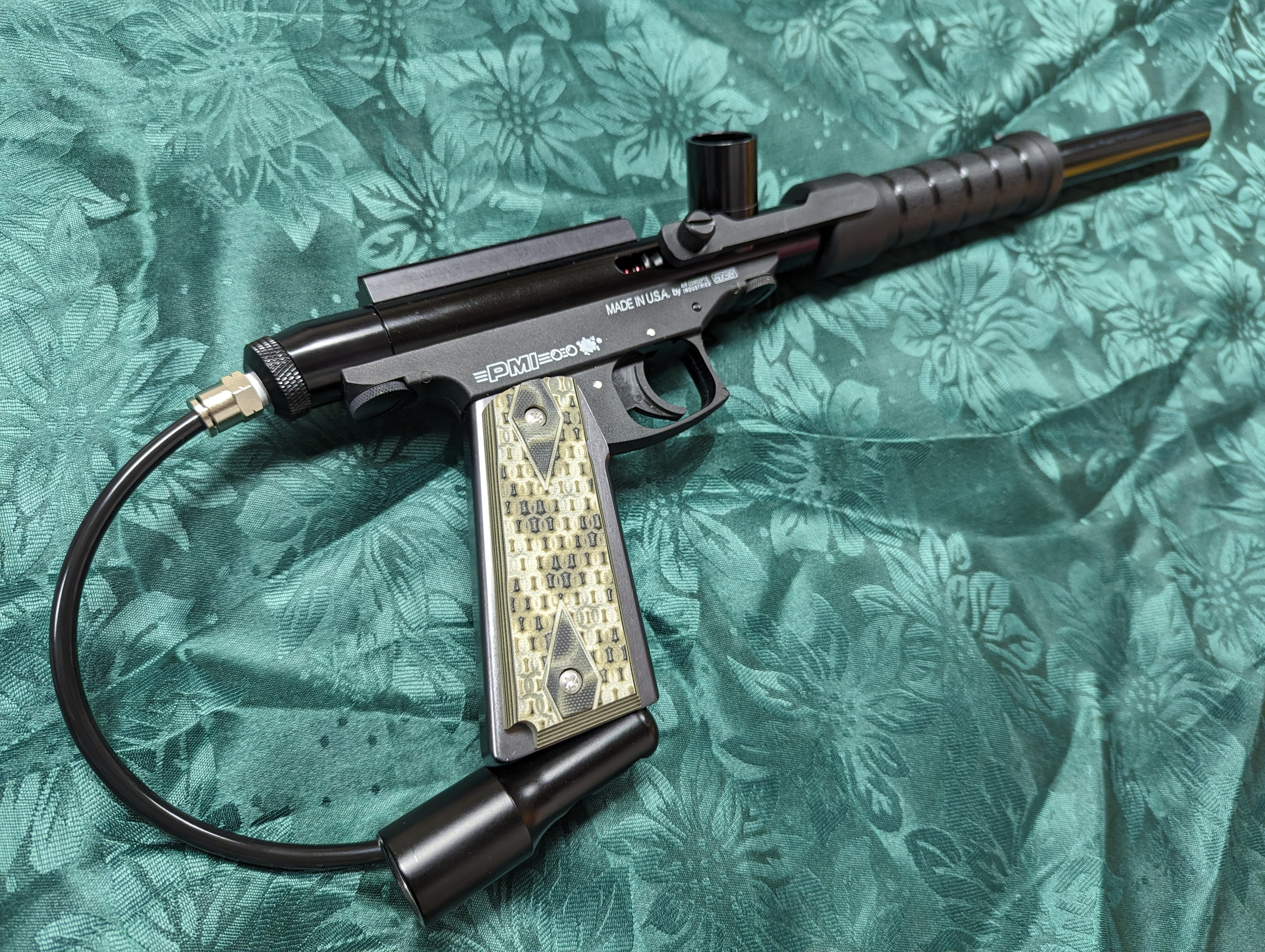

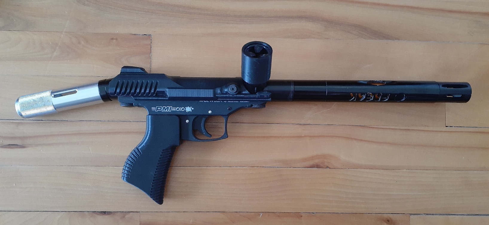

        #120

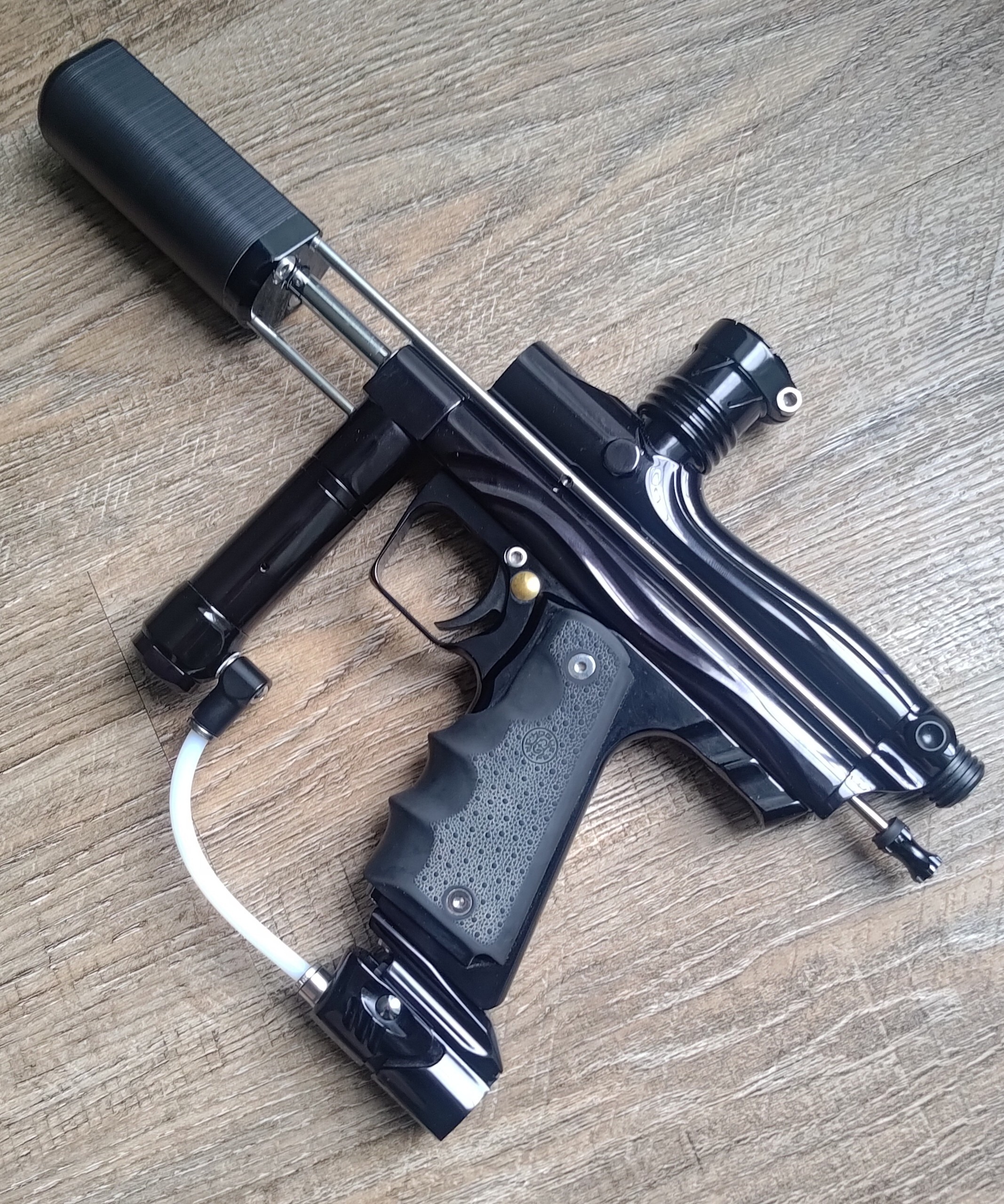

        PMI Trracer
        SSC sizer 675 Trracer to cocker thread (I highly recommend this adaptor, make this usable with modern paint, but require a new pump handle with 1"ID)
        Freak back
        Doc shorty tip
        Backslide pump handle by ReconSWS
        Feedgate adaptor for the feedtube 3d printed by me (2 ball in the feedtube and 1 in the barrel)
        Used it at Slim last May and had a lot of fun with it. Super lightweight and fun to use the backslide.
        Might make a front grip that would slip over the barrel eventually.
        Click image for larger version  Name:	20240628_154901.jpg Views:	0 Size:	306.8 KB ID:	560893

          Psycho91 commented
          I need one of those backslide handles
          That’s an awesome setup
