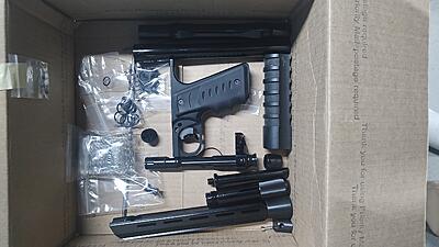

    Well most of you know how it goes, my secret Santa sent me pre-2k pump kit this year, and I certainly wasn't going to let that excuse slip by. Since then the build has been super easy, and I'm positive I'll regret saying that as soon as it's time to tune this thing.
    I'm currently sick with the flu, some I'm going to save the first comment for photos and upload them when I get the chance, but things have been coming together really nicely.

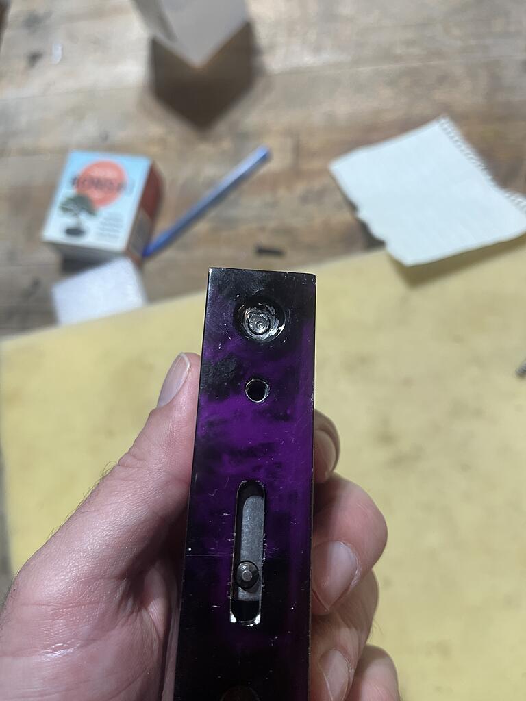

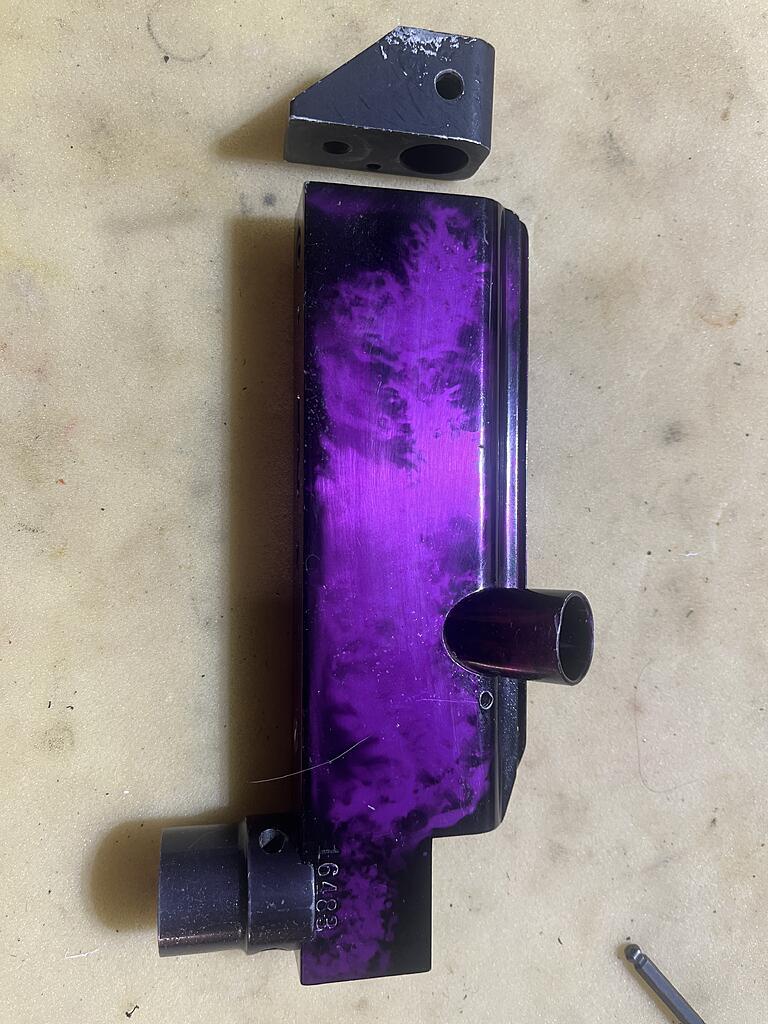

    I managed to snag an awesome purple and black acid wash body that I believe is a 94-95 for a good deal as it has some damage. The damage wasn't all bad though, as part of it was that the body was already tapped for a phantom feed, but has gotten the feedneck repressed too deep into the body? Shockingly I was able to pry the feedneck right off, and sure enough one of my spare phantom feeds fit nicely.
    Otherwise the body also came with internals because the old-school IVG screw had been stripped. I sent the body off to BMC, and he's gonna extract the screw and thread the body for the modern IVG.

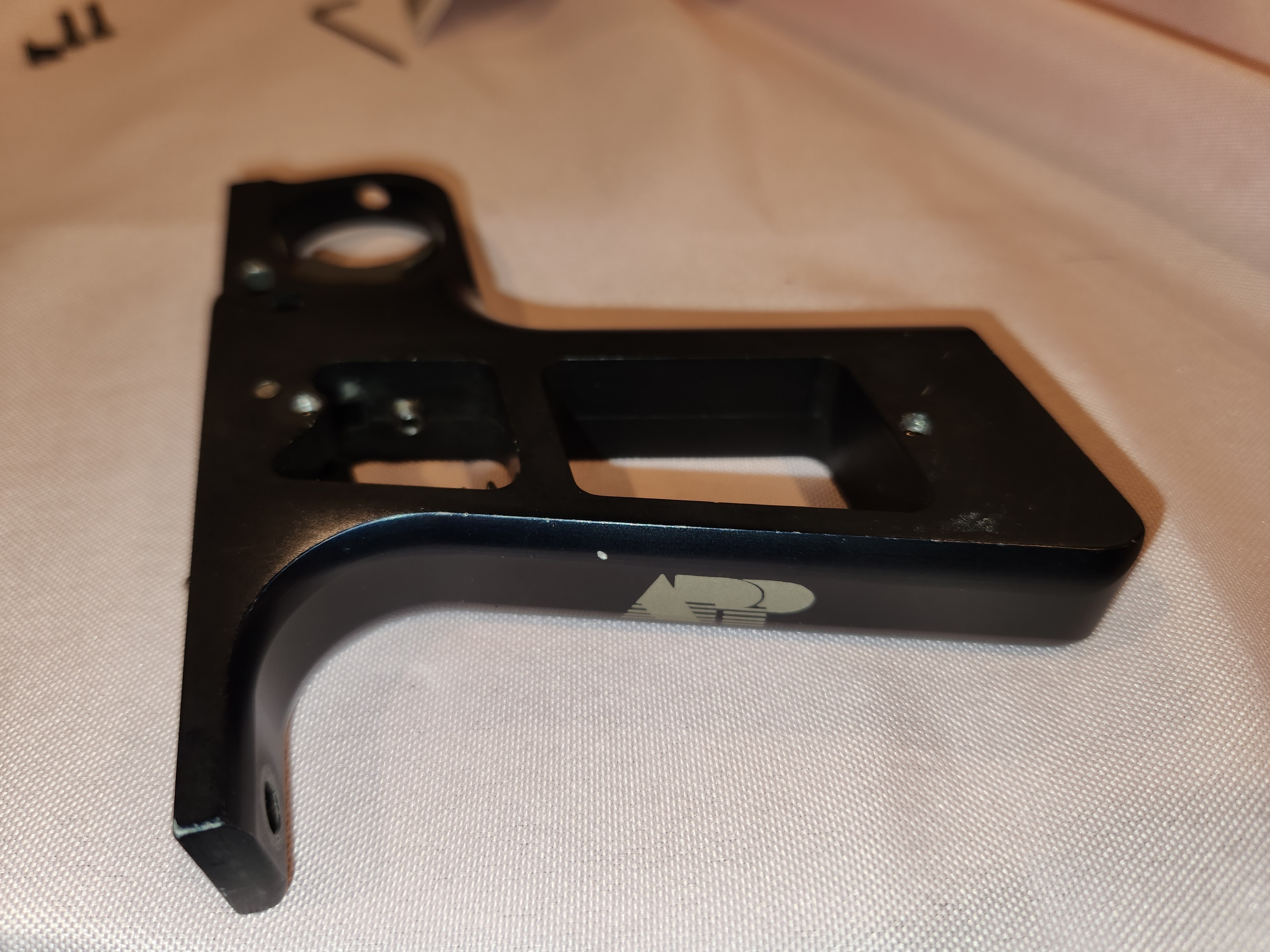

    Additionally I snagged an APP slider, phantom feed and bucket changer, blackout screw kit, grips and the trigger shoe and a back block that I really hope will have enough clearance for the feed not to get scratched.
    Once I get the body back I'm gonna place an order to inception for the bolt, cocking rod, and a stella freak barrel. Everything is a nice gloss black.
    The challenge is probably going to be getting it to run nicely without a reg. I've read up on the topic a ton, and have seen arguments for both regged and unregged SC snipers, but I really wanna try and run this one unregulated.

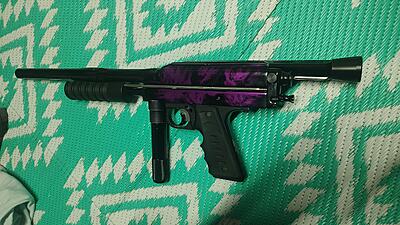

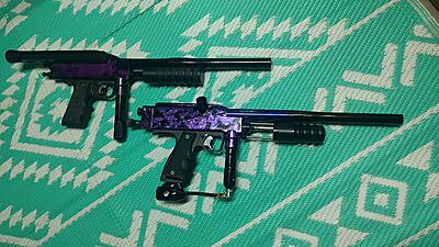

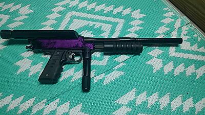

          I haven't got a chance to test it out and probably wont until August or so when all this snow melts. Still everything fits together just about how I hoped it would and it looks nice next to my other sniper which I'm real tempted to steal to frame from

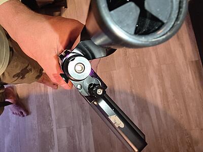

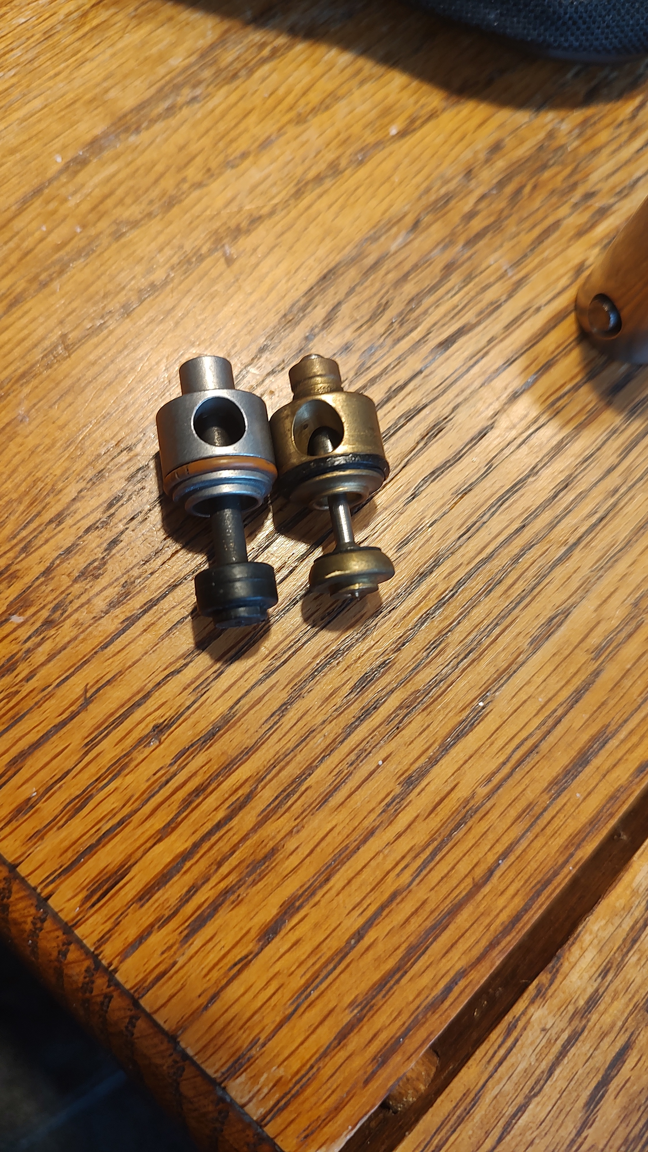

            I was gonna be lazy but then my valve tool arrived so I was able to open this sucker up finally. I pulled out what I believe is a Palmer's lt valve (right side);and replaced it with I think is a stock wgp valve (left side)
            Either way, it airs up without leaking now, and sounds kinda right when I dry fire it under a pillow to avoid scaring my elderly downstairs neighbor.

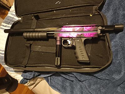

              Well, I'm pretty sure it's finally ready. Works been insane and I haven't really been on land where I can test it, but it shot 241 with the ivf flush today.
              The valve continued to give me trouble, so I just swapped it for a new WGP valve and am using a phantom main spring. The bolt block was oddly off a few degrees even with the feed off, so I swapped it for a tech t back block and that has really nice clearance.
              Otherwise I just had to trim down the inception pull pin. I did a rush job so I can use the marker on Saturday, and it's edges aren't rounded enough so I have to back out the ball bearing in the inception bolt to reinstall the pin. I'll probably order another and do it right if it proves too be too much of a PITA to deal with.
              Hopefully it's done, although I may throw a stock on it if it feels off.
