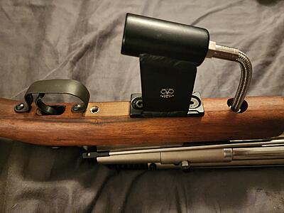

            I'm looking for one to place on my painter.
            But I'm not sure how to distinguish. Is it just in the length of the front mount?
              • 3402
              Yeah. Essentially a scratch built palmers is likely palmers length. If the stock frame is mounted on the tab in front of the trigger guard its palmers length.
              If the front screw is mounted inside of the trigger guard its sheridan length.
                Does your Painter have a front frame mount threadsert?

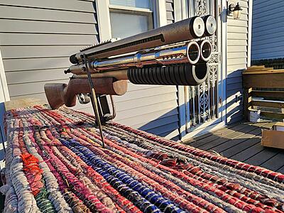

                  Will this identify what sort of grip id be looking for from Sergison?
                  A question.
                  In regards to the removal of the stock.
                  I couldn't get the cap head screw to come out, it turns but it doesn't back out. The flush head did come out though, am I missing something? And should I have two flush mount screws or is it this correct to have a cap and a flush mount?
                  Nasty painter with spring feed.
                    • 3402
                    Ohhh. Its a rifle.. it may not actually have a front frame hole. It may have a pringle screw for mounting a stock.
                    The stock should come off with the removal of the front flat head screw on the mount. . I bet the cap head screw is just into the wood.
                      BrickHaus commented
                      Ultimately the spacing will me the front flat head screws location for your front frame screw.. if thats a threaded hole.

                      The flush mount does come out, the cap can turn but does not seem to back out. The SS set screw look to just be a plug in the wood however it may make contact with the sear for tuning purposes.
                      I did have a KP2 long ago but sadly sadly to leave my collection. I did pickup K frame from Chef Dave that fit correctly, however I believe I understand that this is lower tube is not laid out the same.
                      Anyway.
                      I am looking to do a few things with this and the K-frame is a big aspect.
                      I'm hoping I can carry forward but if I can't I am still going to be happy with this sweet piece.
                        BrickHaus commented
                        Man thats a beauty.
                        The flat head screw just spins? Im pretty sure the flat head should be whats holding the shooter to the stock. Weird it just spins.. you sure it didnt back out and is just captured by the wood? The braided line may be holding it all together enough too.
                        BrickHaus commented
                        The issue as far as I understand with the layout out will be that the front hole on this is likely a through hole in the lower tube of the body. Then there is a pringle screw running from inside to create a male stud. Then a female standoff is threaded to said stud. Your stock is likely threaded into the stand off.
                        You get this all apart and spacing is all fine and dandy, but the k frame wants to mount to a female thread.. The thread cert (or cart valve in some cases) you are going to likely have to find a way adapt the frame there.
