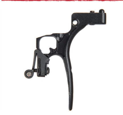

        Seems that if I hold in the board just to the right of the top grip screw then it works. I assume that is the area of the board where it interfaces with the selector switch? I'll have to get a new magnet and see if that does it. I really prefer physical contacts over this HE crap.
          #19
          Most likely, that tells me the trigger position is not correct. There is a screw to adjust the magnet position on the trigger. Small turns do a lot and you don't want to weaken the metal (?) with too much adjustment. On my Phenom this is metal and very small adjustments make big changes to the sensor position.
          I'd try turning the screw clockwise 5' degrees, barely anything, and see if that improves the response. Since you are very close to the trigger working correctly I doubt you need to change it much.
          If that makes it worse, back the screw out a quarter turn from the adjusted position and try again.

            The trigger is fine, it's just turning off sporadically.
              #21
              hmm I can't think of anything to do other than try a different magnet or check that everything is tight and installed correctly. On my phenom the only time I had issues like this is when the board just stopped working.
