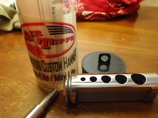

    I picked up this thing like 20 years ago Slightly lighter but I couldn't tell any difference in performance with factory setup but I'll bet your configuration would benefit AirTippsHammer.jpg ​I don't mean to tease btw ha ha. I think it's just some mild steel chamfered out for lack of better description, and polished. I have an extra Hammer I could send you if you want it to play with and customize - lemme know

      C26G I can’t see the picture. Is it a lightened hammer??

    Yessir, holes drilled out of it. From a company called Air Tipps I think. I'll try to resize the image again

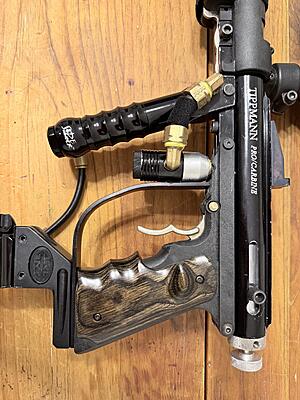

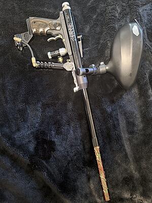

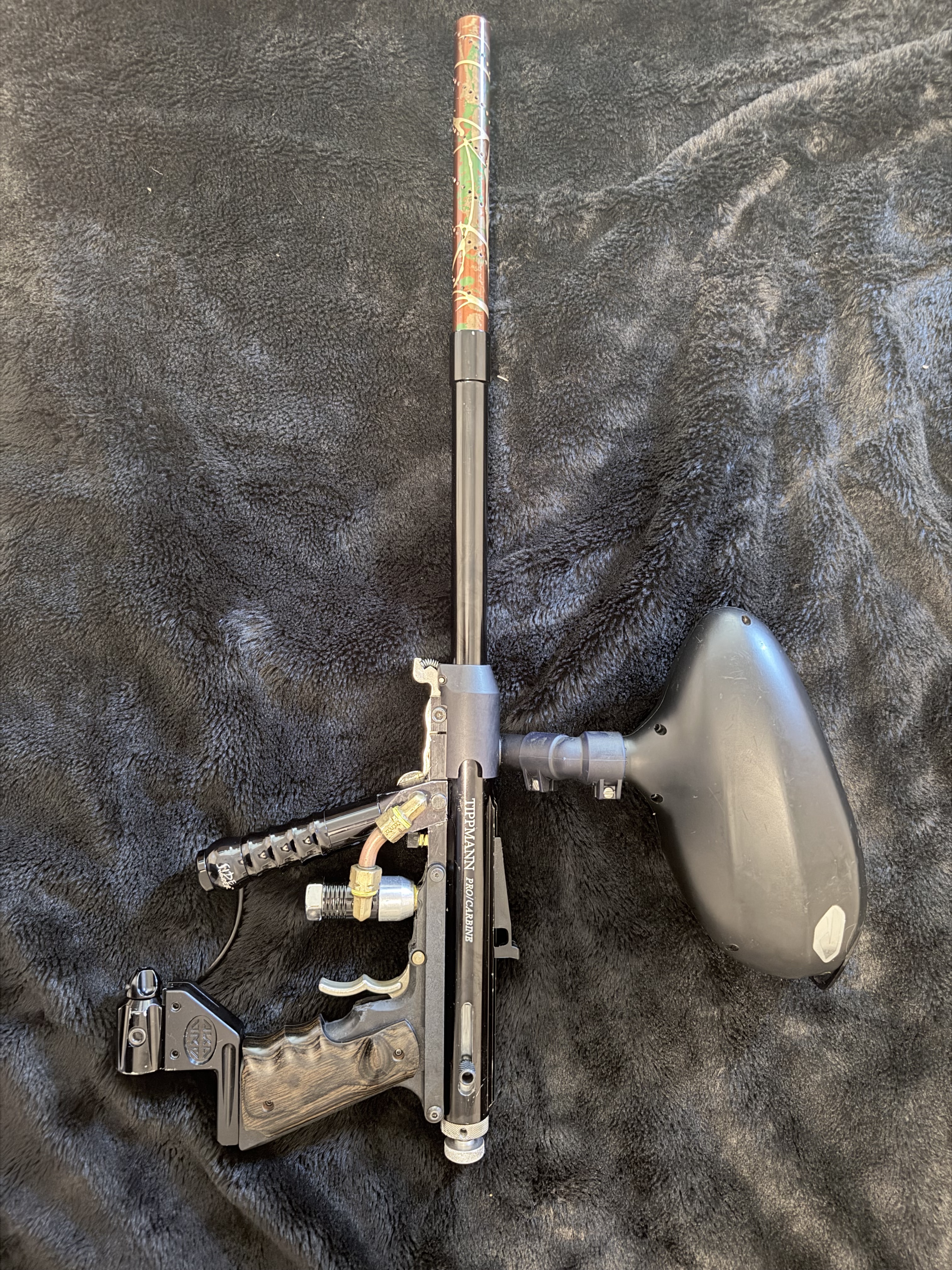

    Alright, so pics of it since it’s done. This thing went through many many iterations. Only thing I’d still do is put in a lightened hammer and an aftermarket front bolt that would be a smidge longer if either popped up. Maybe an APP trigger frame but my guys at the pro shop said they’d be cool with no trigger guard.
    Heres a list of everything I did starting from ASA going up and then ending at the barrel.
    NDZ on/off ASA
    AKA mini drop with rail
    Smart Parts natural wood grips
    Modified trigger frame to be able to use APP double trigger
    APP double trigger
    Model 98 trigger and sear spring
    Everbuilt size 4 brass washers on trigger and sear pin
    Polished sear
    TechT size 1 (?) trigger pin
    Modified safety to work with APP trigger
    Taso RVA
    TechT green main spring
    Polished hammer
    SA200 Valve
    TA10052 valve stem, cup seal, and stem guide
    TechT lightened valve spring
    SA200 valve reduction fitting
    Volumizer (Shocktech mini cocker ASA, CP gauge adapter, chrome tank threads to 1/8 npt adapter)
    Port and polished powertube
    SA200 front bolt
    Ported vertical adapter with OG brass line
    AKA Sidewinder reg with finger grooves
    Pro-Lite Commando (?) powerfeed
    Armson feed elbow
    DYE Primo gravity hopper
    DYE pressure gauge
    Smart Parts All American Camo Splash barrel

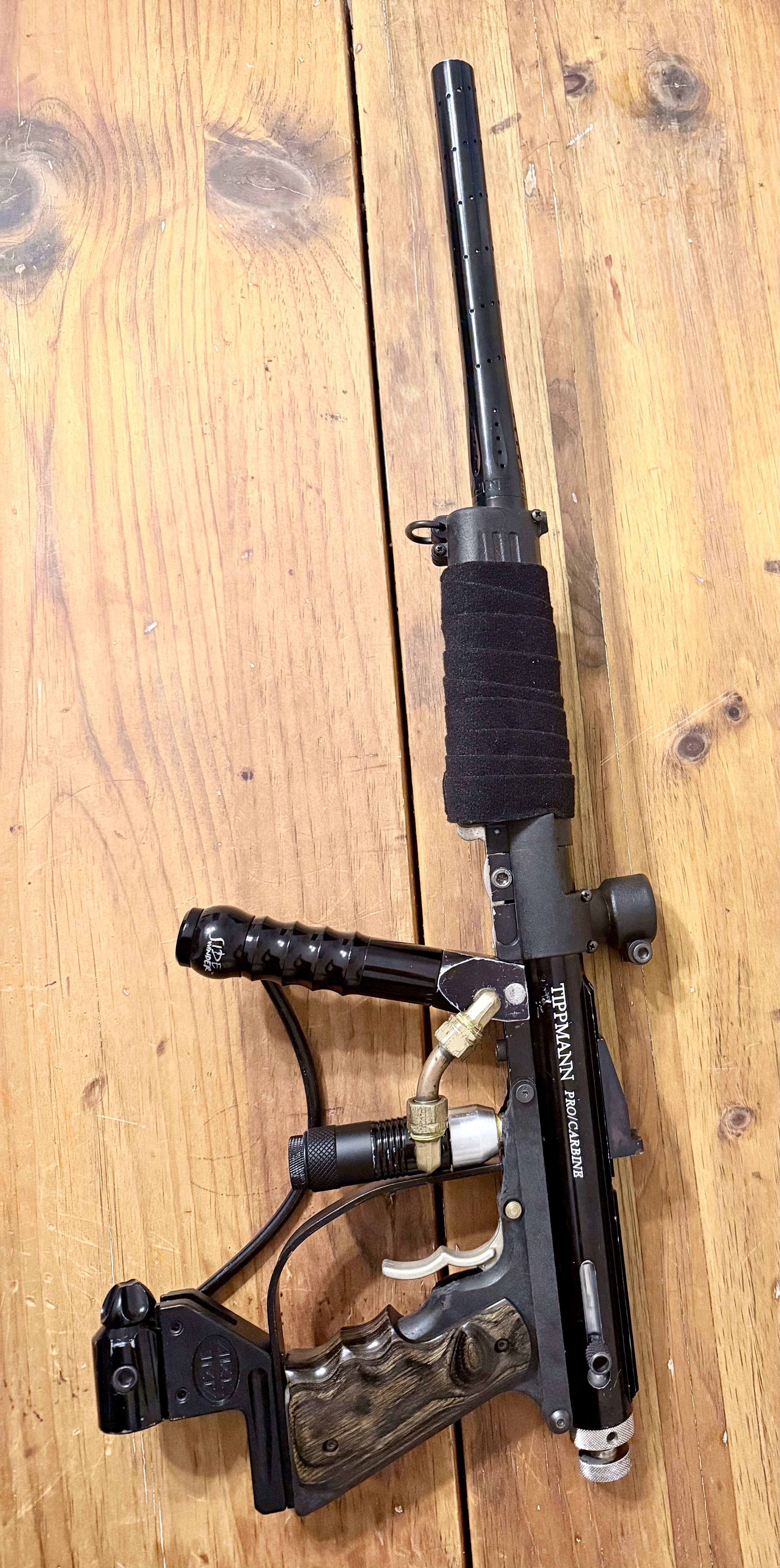

      Changed up a couple things. I put a Model 98 Psycho Ballistics double trigger guard on it. I had to bend it a little and some gentle taps with a rubber mallet to get it to where it wasn’t pressing up against the volumizer. Found a cool cap on MCSUS.com to seal the bottom of the volumizer which will add more volume than what I had on there before.
      I ended up going back to the stock bored out barrel shroud and put the commando feed back on the Pro-Lite. The 68 floating valve project is a failure at this point. It’ll stay sealed up for a while but eventually it’ll start leaking and it’s a pain to disassemble to slather it up with Dow 111 when that happens. I guess those rope wax rings are important to keeping it sealed.
      Went back to a Freak barrel and I’m going to sell the camo barrel and other stuff soon. I gained around 80-90fps by adding a u cup seal to the back of the front bolt and switching back to the Freak. I had it shooting 270-280fps in-between 350psi-400psi (375psi?) but efficiency sucked and it already wasn’t that good. Dropped in a lighter main spring and upped the pressure to a smidge under 450psi and it’s shooting great.

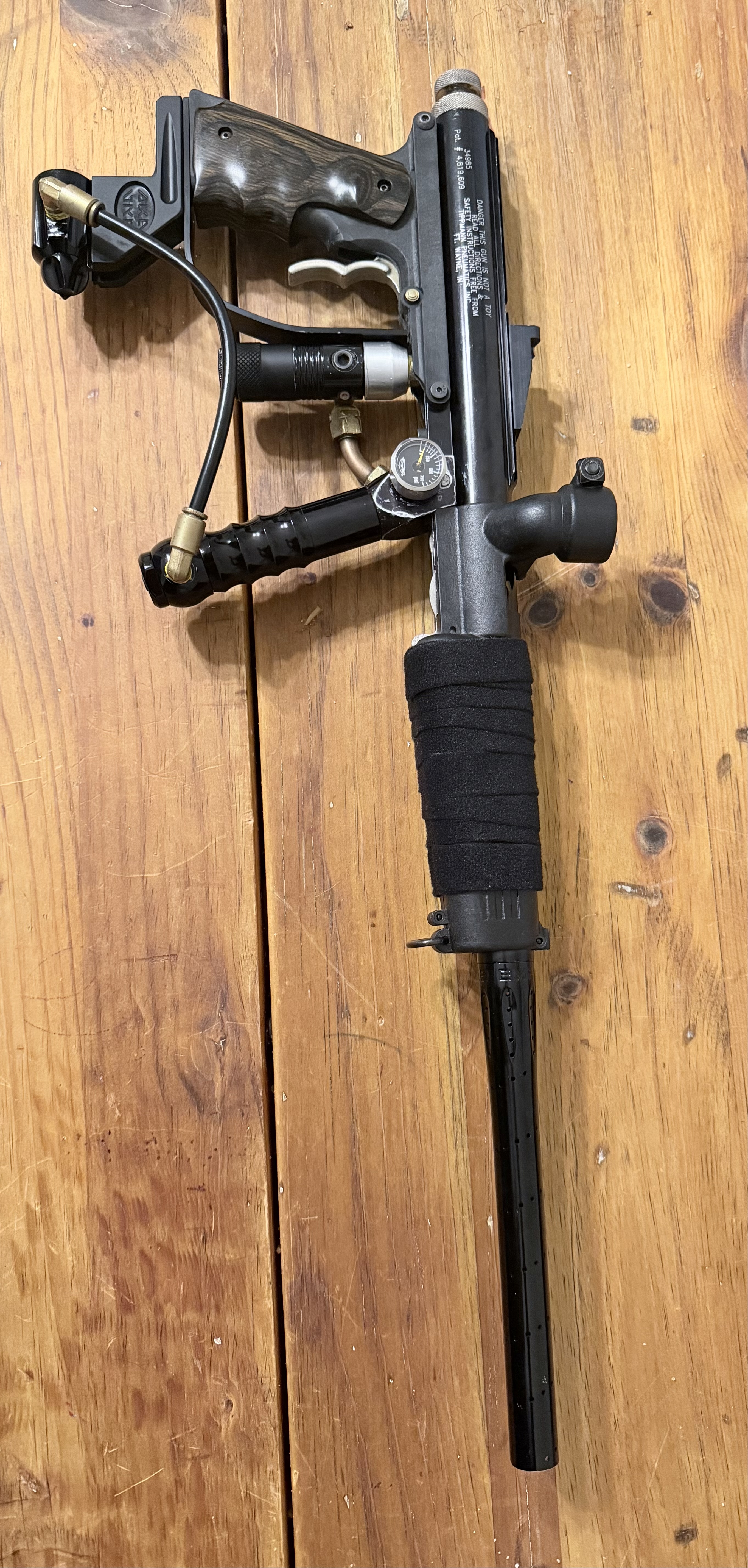

          Swapped the VASA backwards so I had much more room to extend the volumizer. I had to file part of the shroud so it would work. A little corner that was pressing against the VASA on the right side.
          I bought a MCSUS tuning chamber for this project a while back but wasn’t able to use it because of space constraints. Got it in today and FPS jumped up by 20-25 so I dropped in an even lighter main spring. I could’ve lowered the pressure but I want to keep the operating pressure around 450psi. Shoots even more smooth now.
