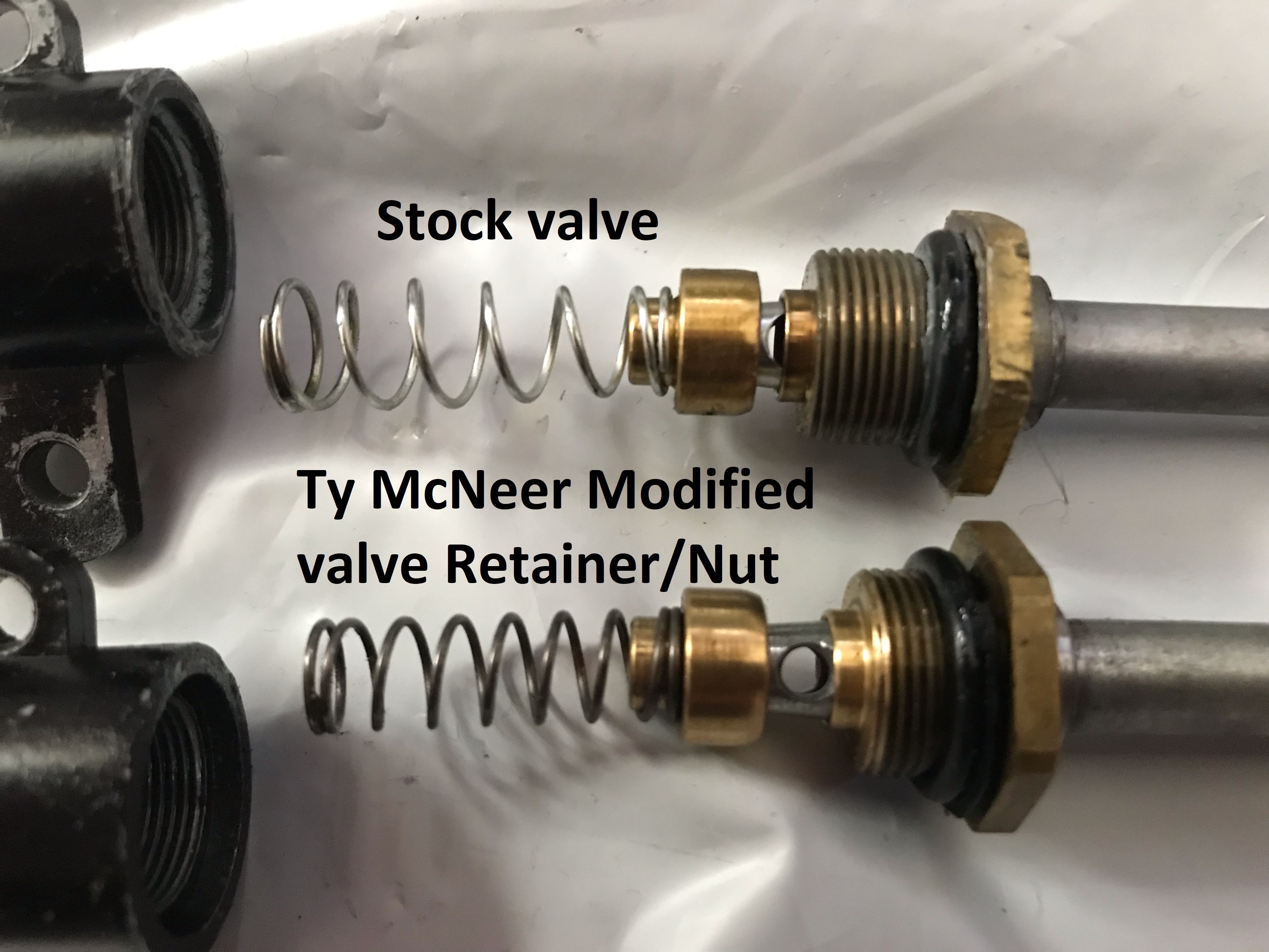

                  - TigerShark valve seat/nut velocity upgrade to expose internal ports. Ty McNeer did mine, but he's not doing paintball stuff anymore.
                  Click image for larger version  Name:	TigerShark Stock Valve Up Mod Valve Down2.jpg Views:	0 Size:	1.09 MB ID:	345420

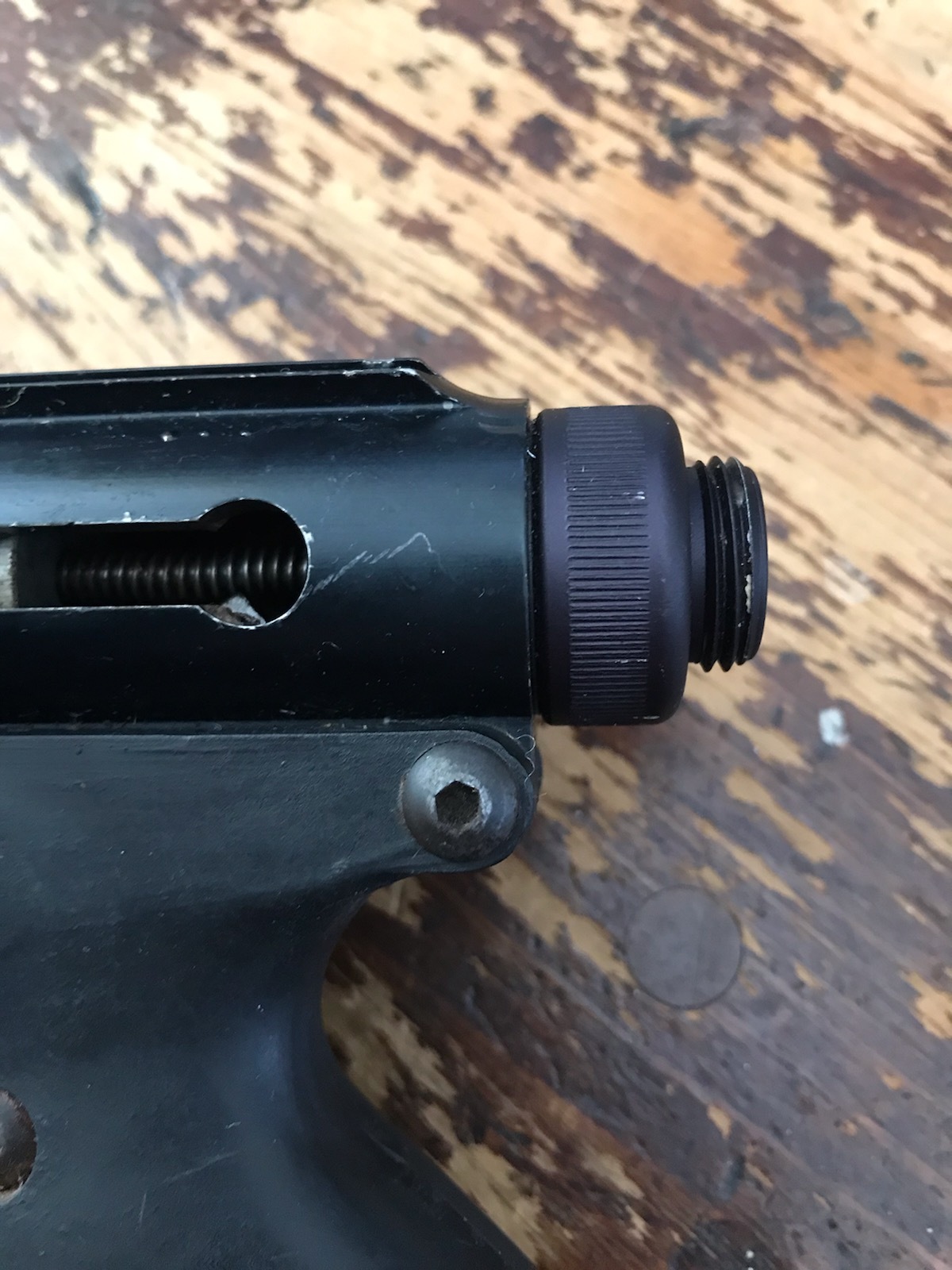

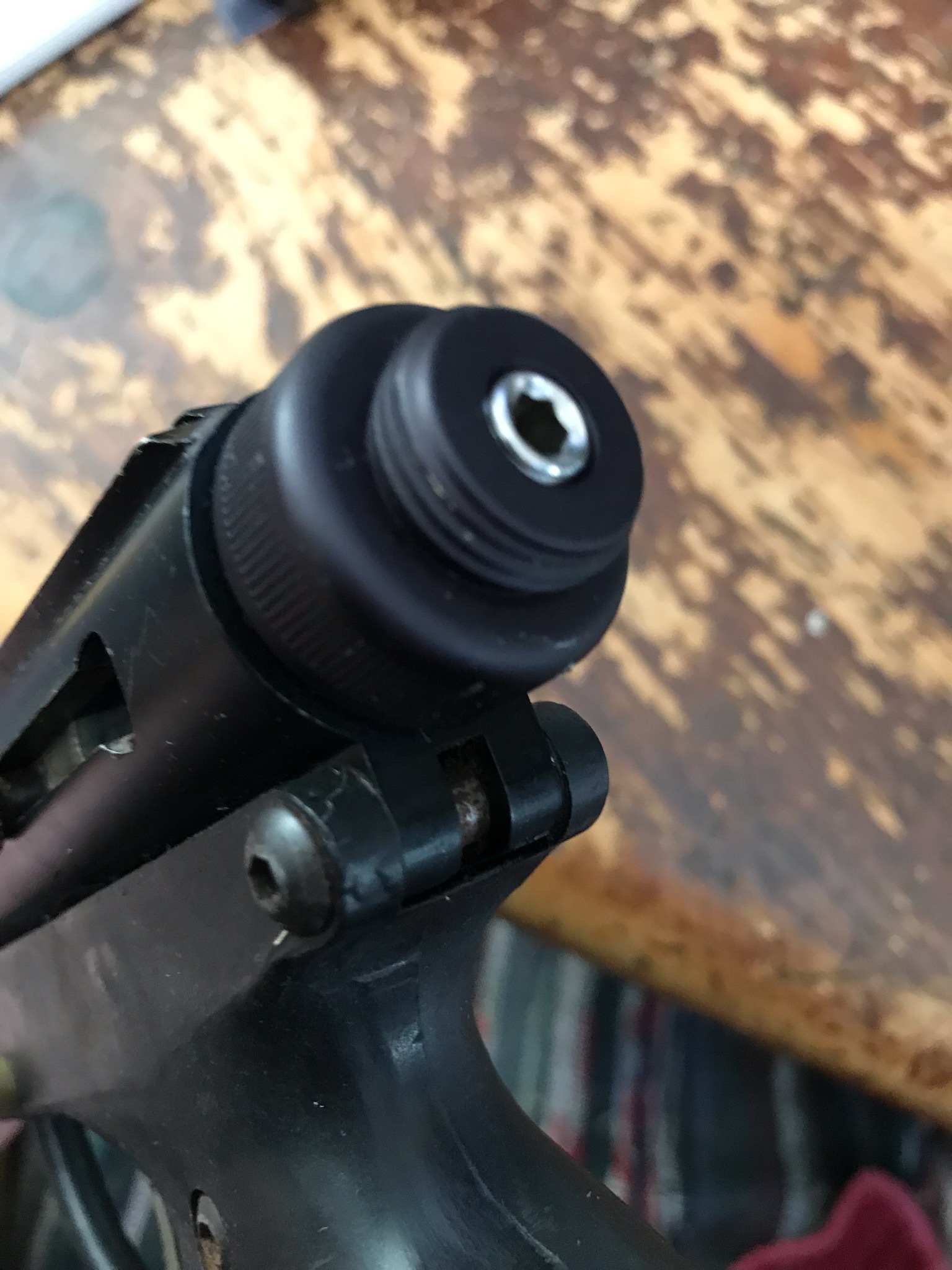

                  - Rear Velocity Adjuster for Tippmann Pro-Lite/Carbine/Pro-Carbine (and not the LAPCO/TASO/Proline version with the big silver knob with no tournament lock). I've attached an image. It came with a fancy cap that screwed on so you couldn't see the Allen screw. The cap and threads aren't necessary, but the threaded section extends it enough to provide more adjustability for the Allen screw.
                  Click image for larger version  Name:	IMG_2778.jpg Views:	0 Size:	342.2 KB ID:	345425

                    - Rear Velocity Adjuster for Tippmann Pro-Lite/Carbine/Pro-Carbine (and not the LAPCO/TASO/Proline version with the big silver knob with no tournament lock). I've attached an image. It came with a fancy cap that screwed on so you couldn't see the allen screw. The cap and threads aren;t necessary, but the threaded section extends it enough to provide more adjustability for the allen screw.
                    I'm digging this style of RVA, it could come in handy with my Mini-Lite liquid co2 tuning, reducing the need to cut my somewhat rare prolite mainspring.

                      I got it because I play mostly outlaw and the next CO2 fill is a long drive away, so I tune as many of my guns for efficiency as I can. I also own a TASO and a Proline version and they're not nearly as good as this one. I wish I remember who made it. The one upgrade this needs is some holes drilled into the sides like the stock Pro-Lite plug to let you start turning it with an allen wrench. Right now I have to remove it with a plumbers strap wrench.
                      I think the M98/BT-4 spring kits are the same as Pro-Lite spring kits. I see them on eBay from retail stores pretty often.
                    -Yep, I did a couple a lot like that back in the day. I can't really see making a large run of the retainer nuts, but I wouldn't mind making a dozen or two.
                    -Easily doable.
