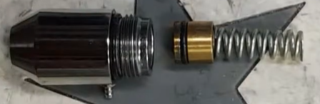

        -This one's doable, I think. It's been a long time since I had an actual Twister in the shop, but I have a ton of Sledges on hand. Might take a minute to reverse-engineer...
        Doc.
        Just for a touch of reference, I snagged a screencap from this vid Tim Firpo posted on rebuilding an LPR with a Twister cap.
        https://www.youtube.com/watch?v=rAE3hCer7so

          This would be a real winner, IMO. Semi-matte black ano that matches the original LPRs. I'd buy a few.
        • Cunha
          Cunha commented
          Same thing as the akalmp adjustable reg cap for the Wgp stock reg. It would mean you could run a stock 2k cocker with all stock parts with those two minor upgrades and have all the conveniences of easy to adjust regs.
        -Oh, right. Man, it's been a while since I had one of those in the shop... Thanks for the pic, should be easy enough- though I wouldn't be able to guarantee it'd be parts-compatible with existing ones... though we also don't necessarily need it to be.
