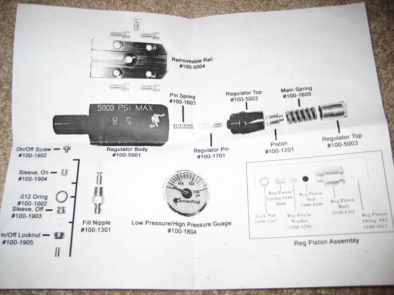

      I just found this gem on my hard drive. The carpet makes me think I may have taken this picture myself. If so, there's a chance I might still have the physical copy somewhere.

        Levi's diagram points out something I missed yesterday, and only realized last night as I was doing up my notes on this: The translucent plastic thing isn't the seal. The seal is in the front piston- as shown in the drawing- and is a simple urethane disc. (That I even already had the right size punches for.)
        So a rebuild kit will be even easier than I thought. I'll be ordering up some O-rings (a bunch, actually, I have three or four kits to put together already) and once those come in, I should be able to put together some solid kits in short order.

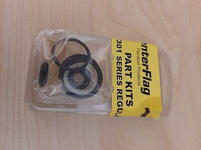

        Includes the little hard plastic seat/piston thingy. The o rings are long past the use-by date, but the hard plastic part doesn't seem like something that age as poorly.
        Click image for larger version  Name:	20230223_172033.jpg Views:	0 Size:	3.01 MB ID:	375171

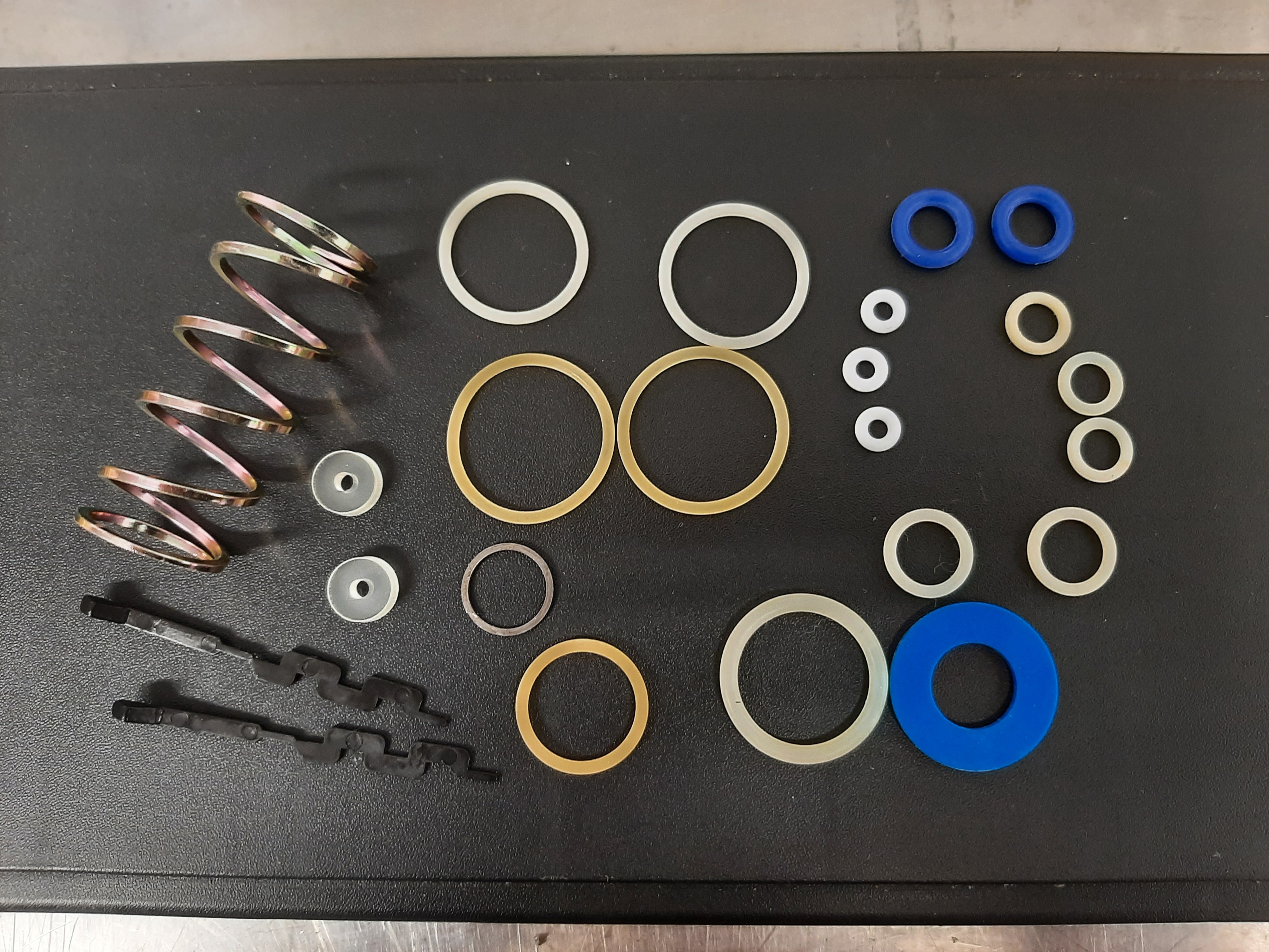

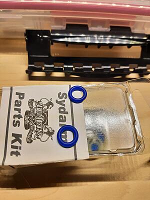

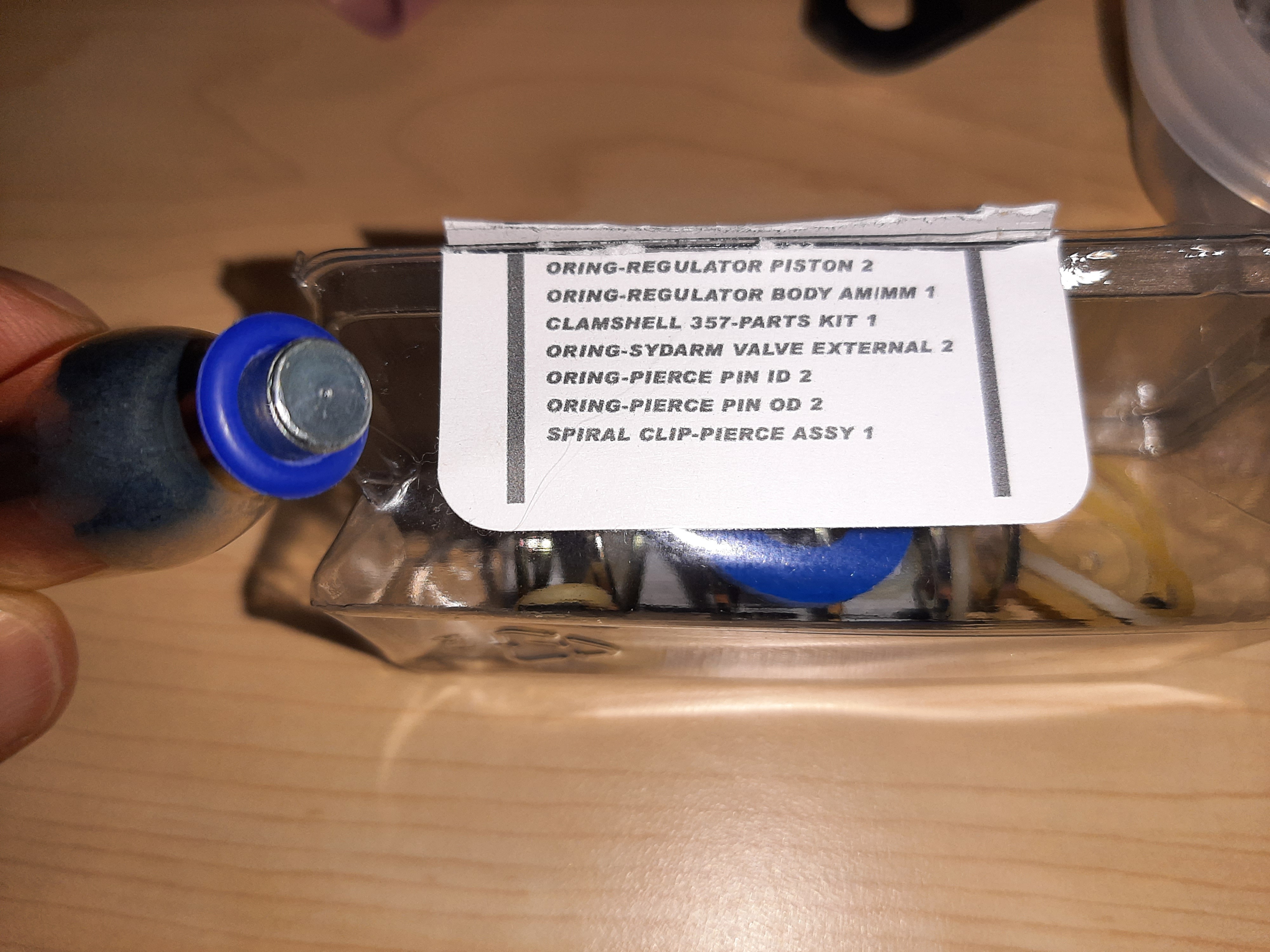

          Here's what the Sydarm kit looks like. It all looks like standard fare classic mag stuff except for two items. The blue O-rings at top right, and a steel spiral retaining ring immediately to the right of one of the reg seats.
          Blue O-rings: The color suggests they are fluorosilicone not urethane. https://www.globaloring.com/oring-colors/

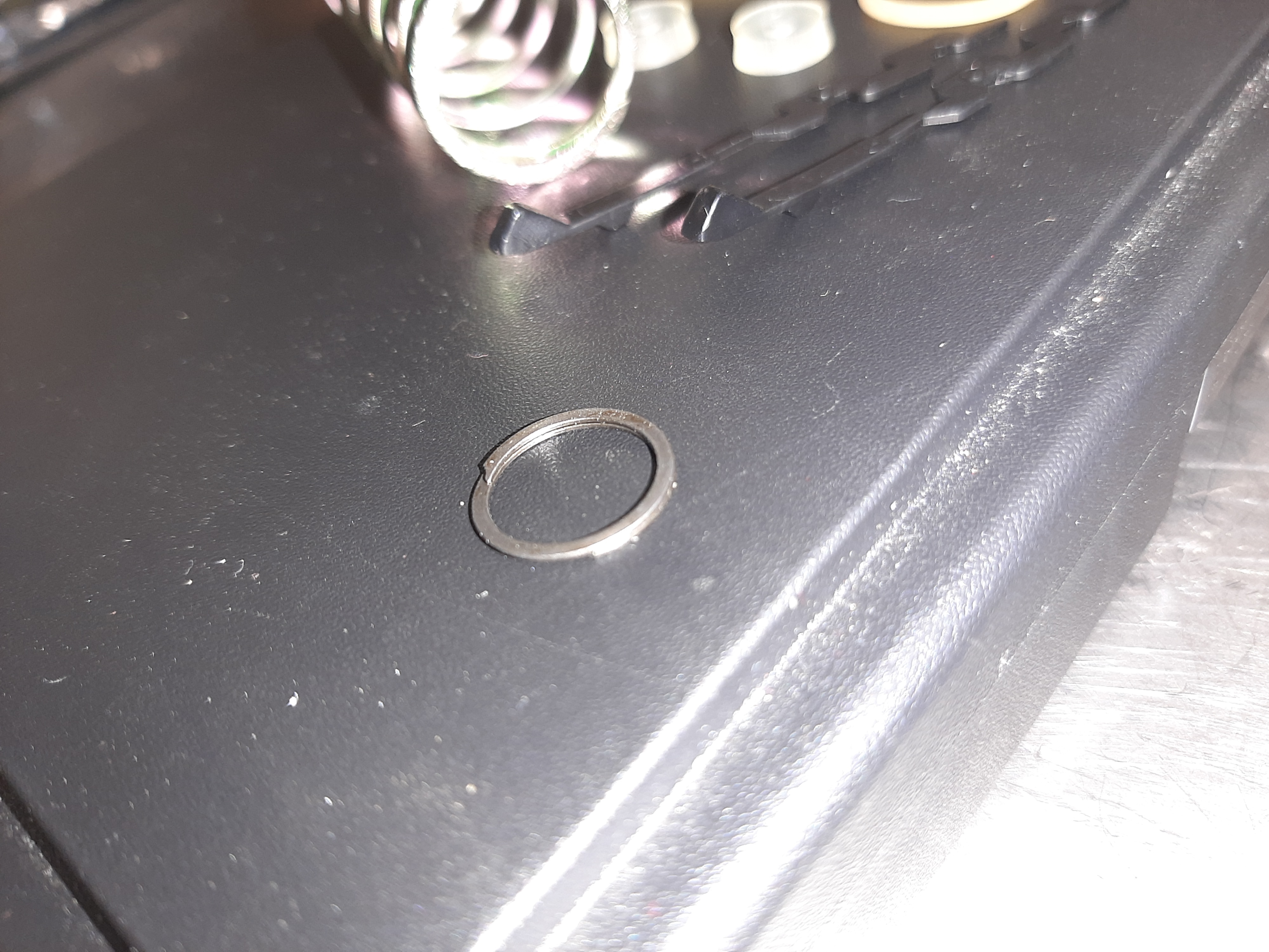

          The spiral retaining ring measures as follows:
          OD: 0.537"
          Wire thickness is 0.018" and the clip makes a little more than 1.5 turns, so where there is overlap it is 0.036" thick.

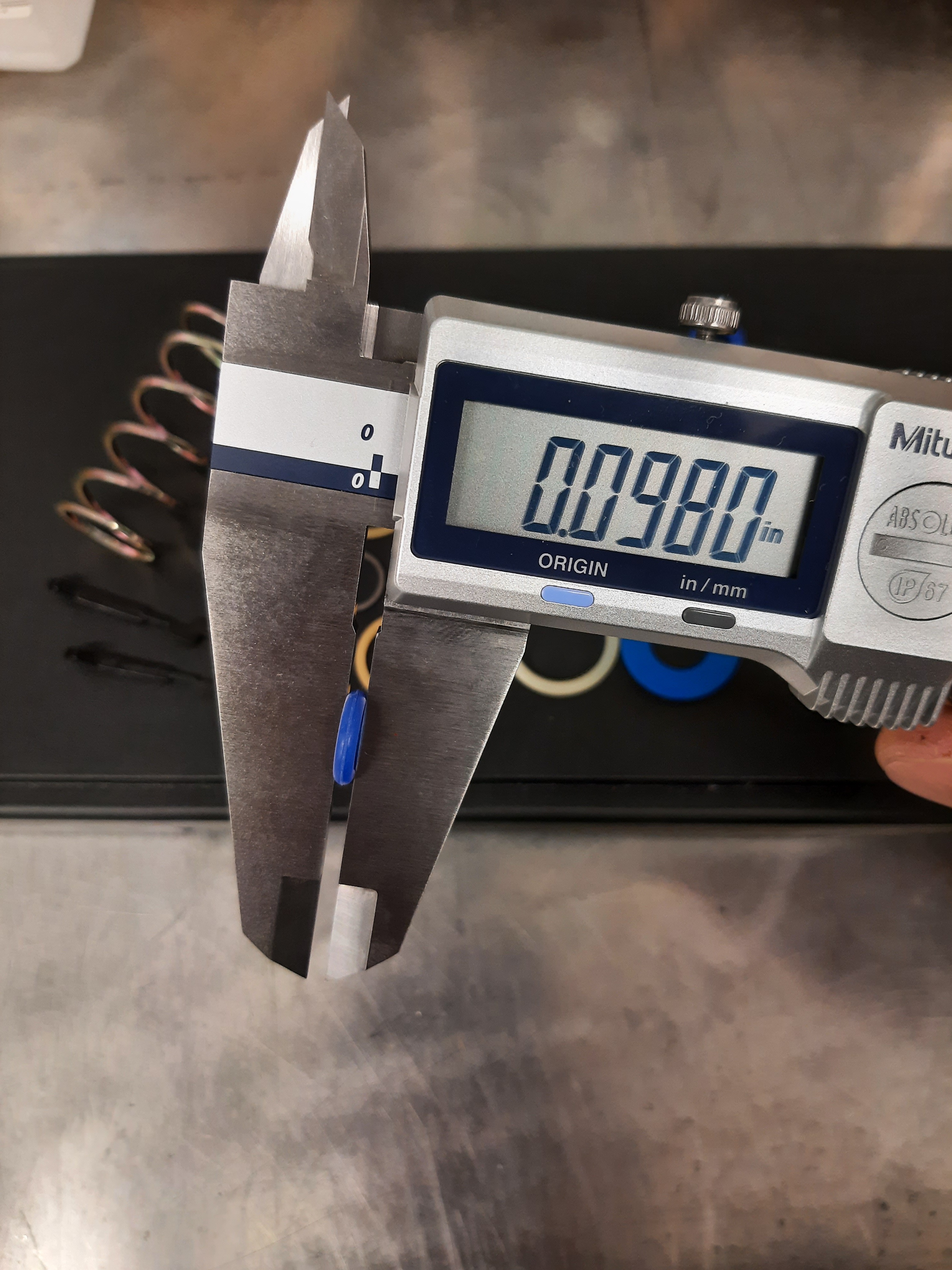

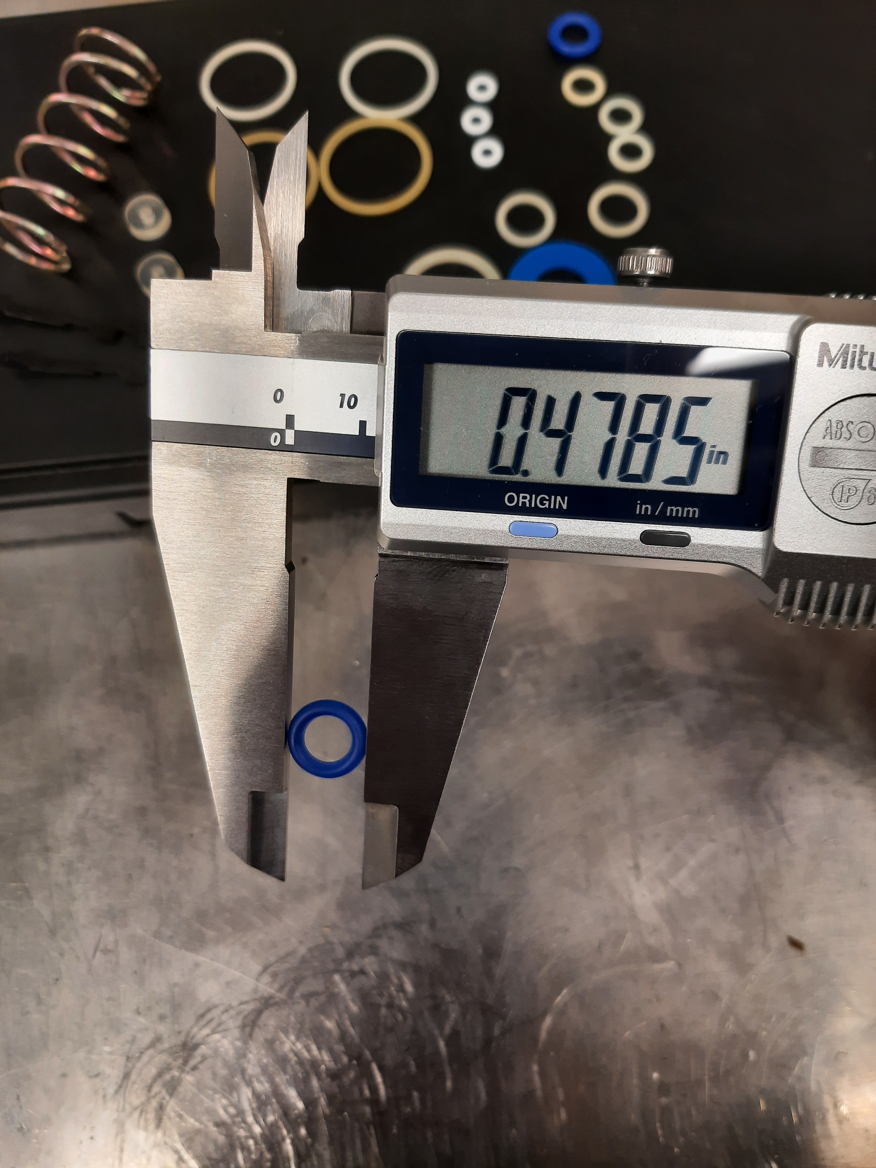

          The kit labels this as "SPIRAL CLIP-PIERCE ASSEMBLY" and I'm pretty sure the blue O-rings are "O-RING PIERCE PIN OD"
          The O-rings seem to fit nicely around the neck of a 12g, so I'm guessing that is where they go. I wonder why they used this particular material. I don't know if this is just a matter of Tom Kaye overkilling it for the sake of overkill? Or if there was a particular problem they were engineering around?
          FEEDBACK
          • Trygve
            Trygve commented
            Yes youre correct thats where the blue o ring goes. My sydarm was leaking from the 12g chamber couldnt figure it out for the life of me. Found the remnants of a sticky black o ring inside the the neck of the pierce assembly. Really hard to see and remove. Get a flashlight and a dental pick. Replaced it and it fixed the leaking.

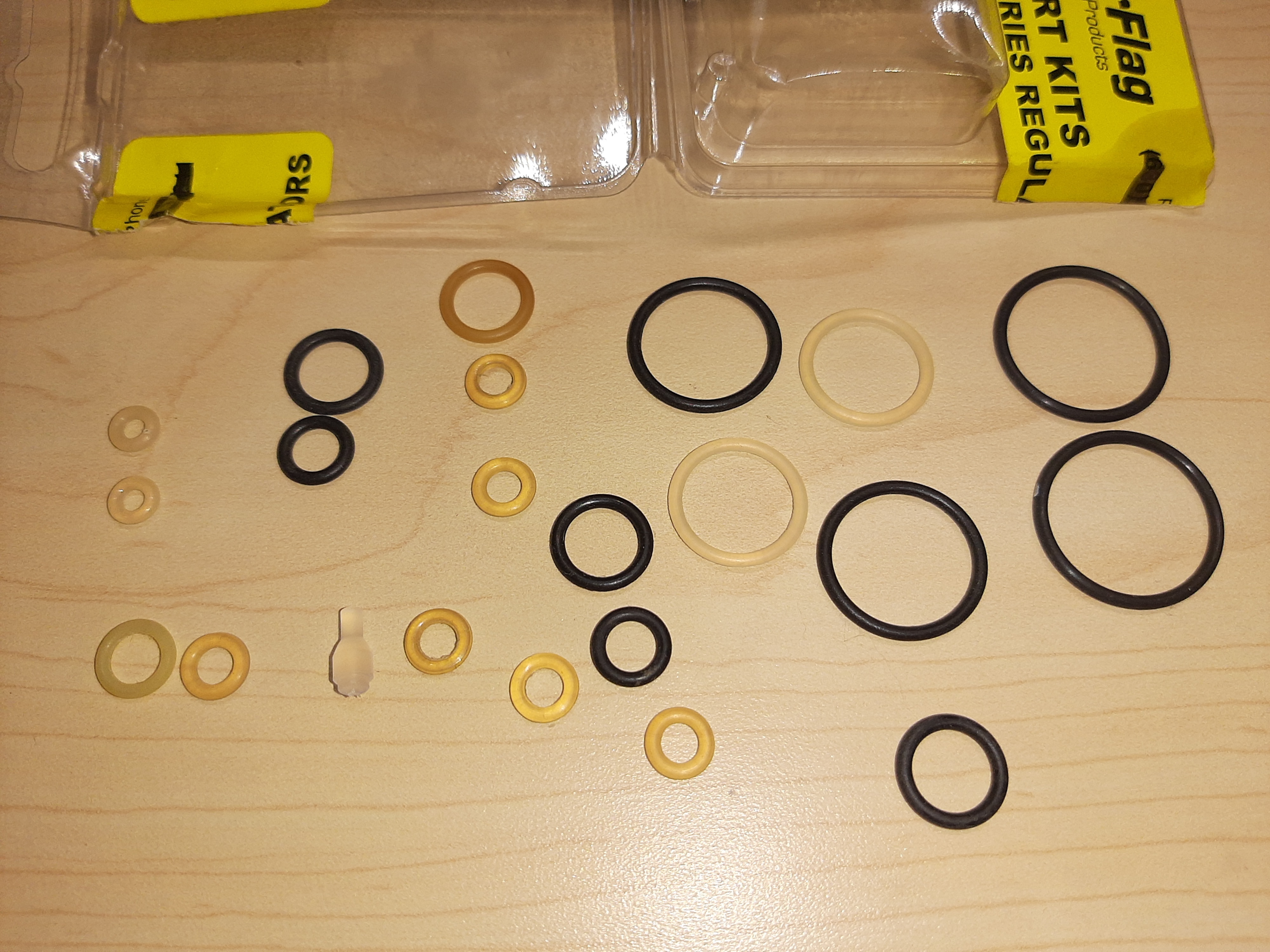

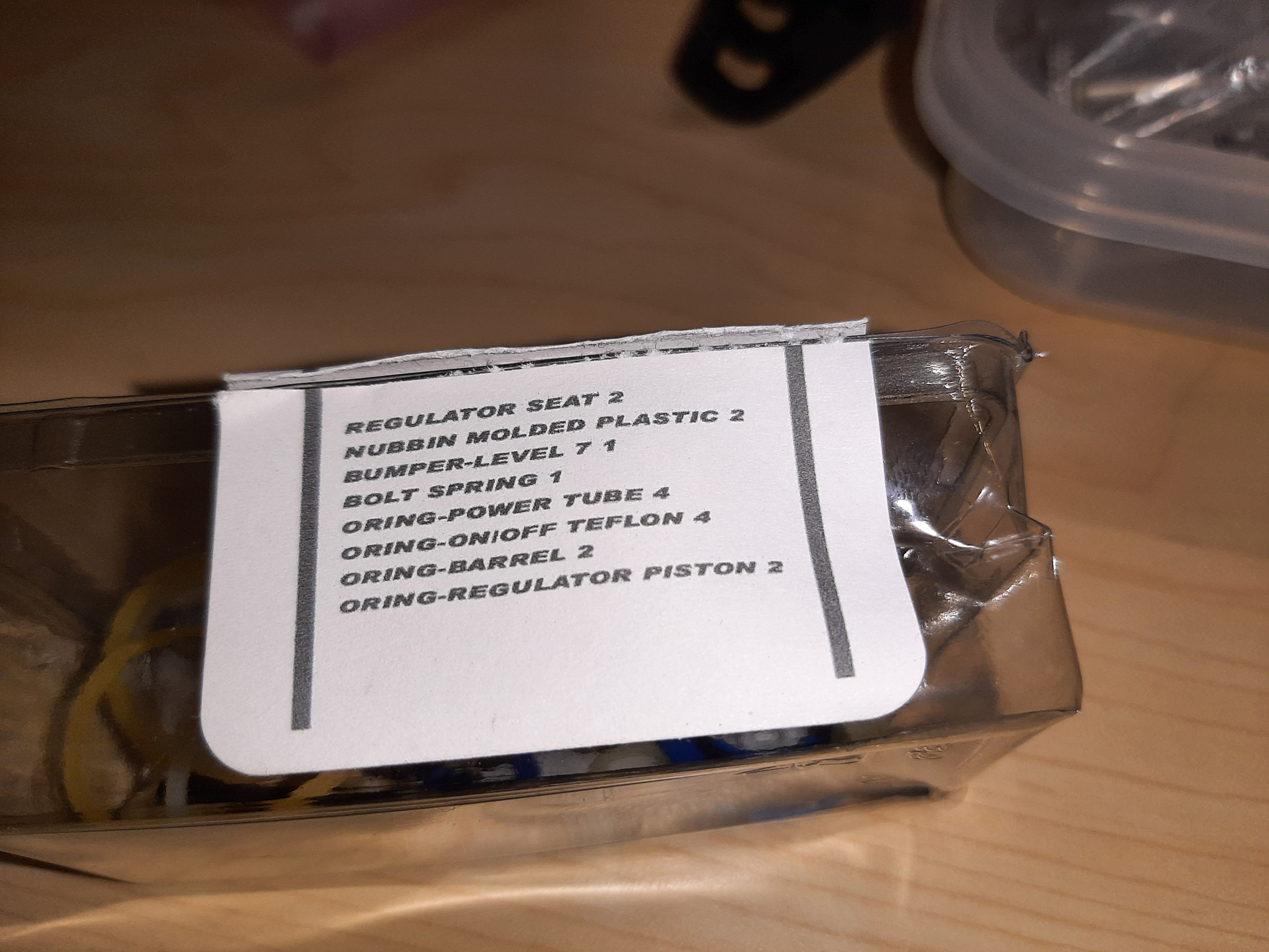

          Here's a shot of the other side of the label which shows the rest of the kit contents. Nothing fancy there.
