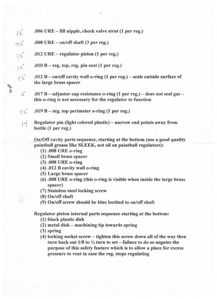

                    Doc is there information out there that list the size and durometer oring specs of those Dynaflow regs? I’d love to try one out since they’re such a neat, compact design.
                    • DocsMachine
                      DocsMachine commented
                      I haven't looked, really. That's the kind of thing that I figure was last posted on some long-gone board, and if it got reposted anywhere, it'd be buried in somebody's Facebook feed or something.
                      I've been working up O-ring specs on each one of these guns I've worked up seals for, I could sure put up a page with the info.
                      Doc.
                        Here's what I have archived from way back.
