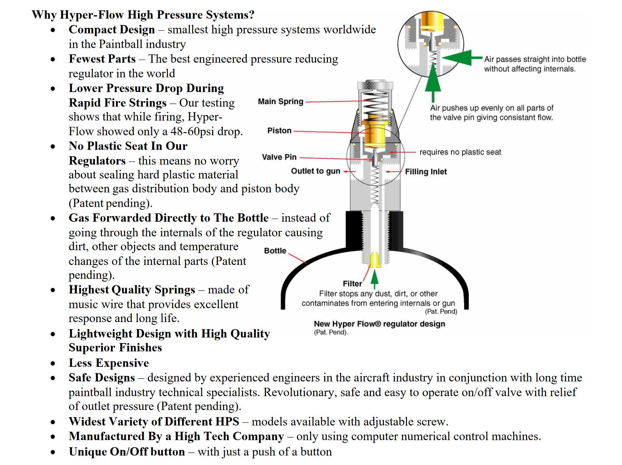

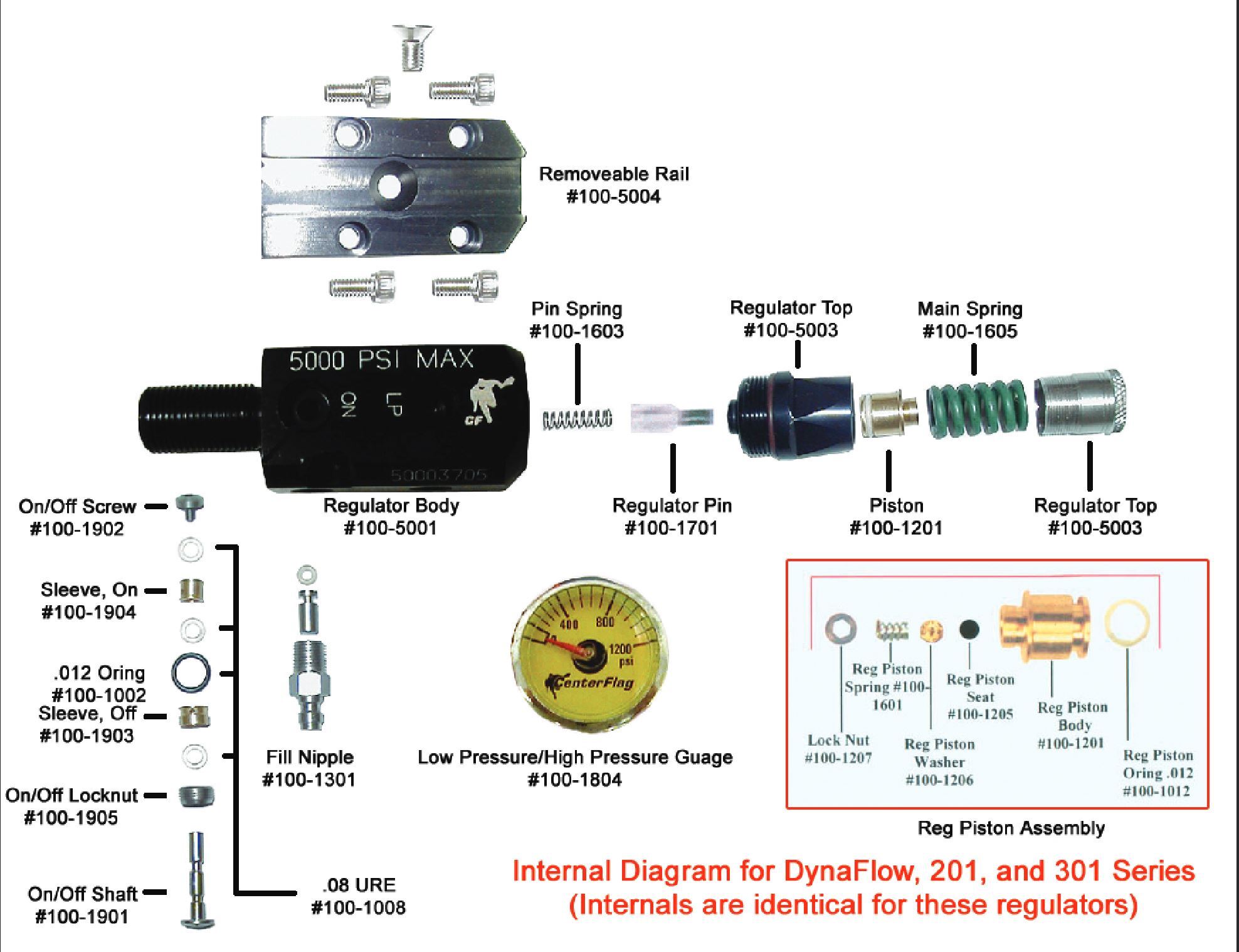

        I just found a little treasure trove of Centerflag technical pdf's on the Wayback machine!
        https://web.archive.org/web/20070203...h_support.html
        Click image for larger version  Name:	Hyperflow Function.JPG Views:	0 Size:	377.3 KB ID:	377979
        Click image for larger version  Name:	Dynaflow Breakdown.JPG Views:	0 Size:	254.3 KB ID:	377980
        There's more to be had at the link.

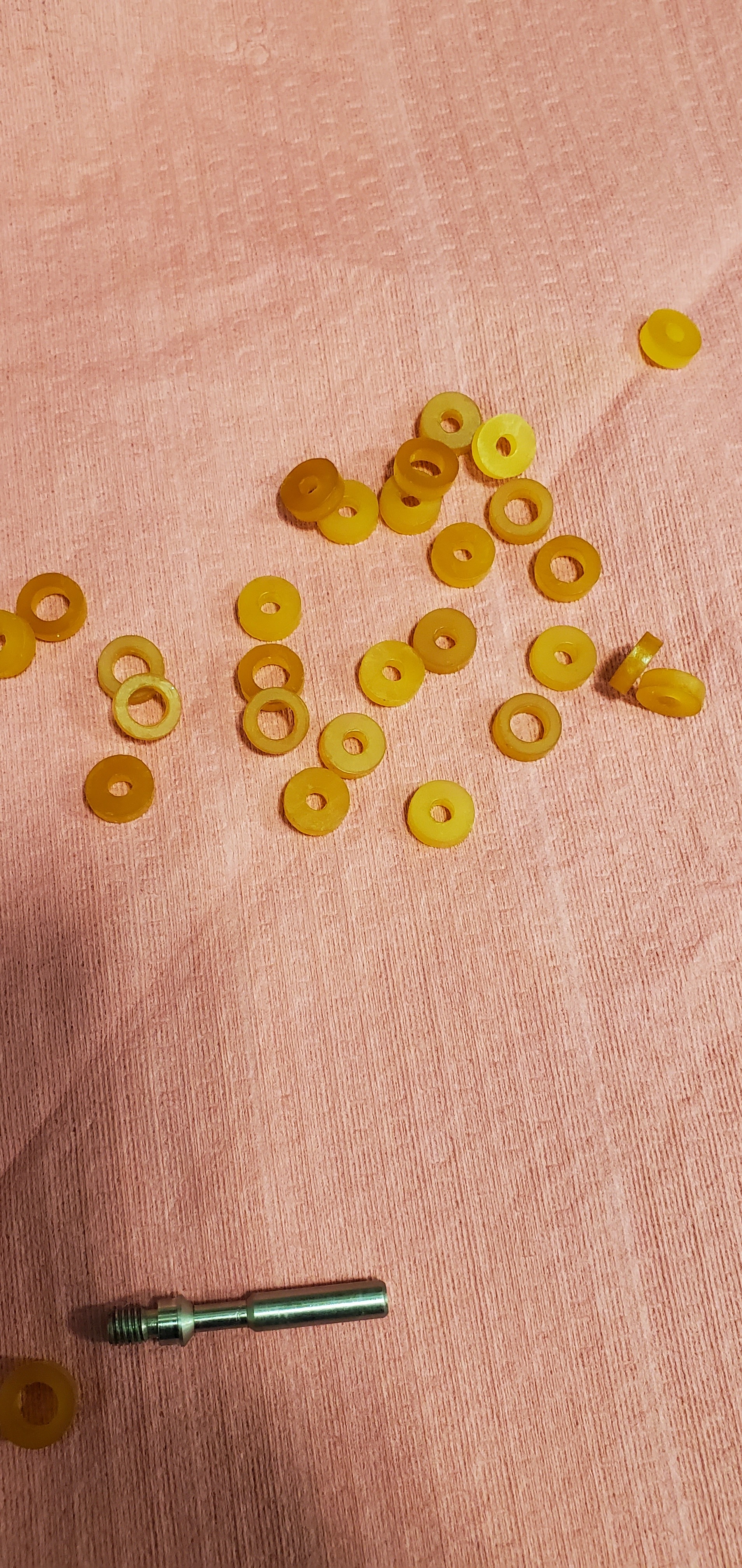

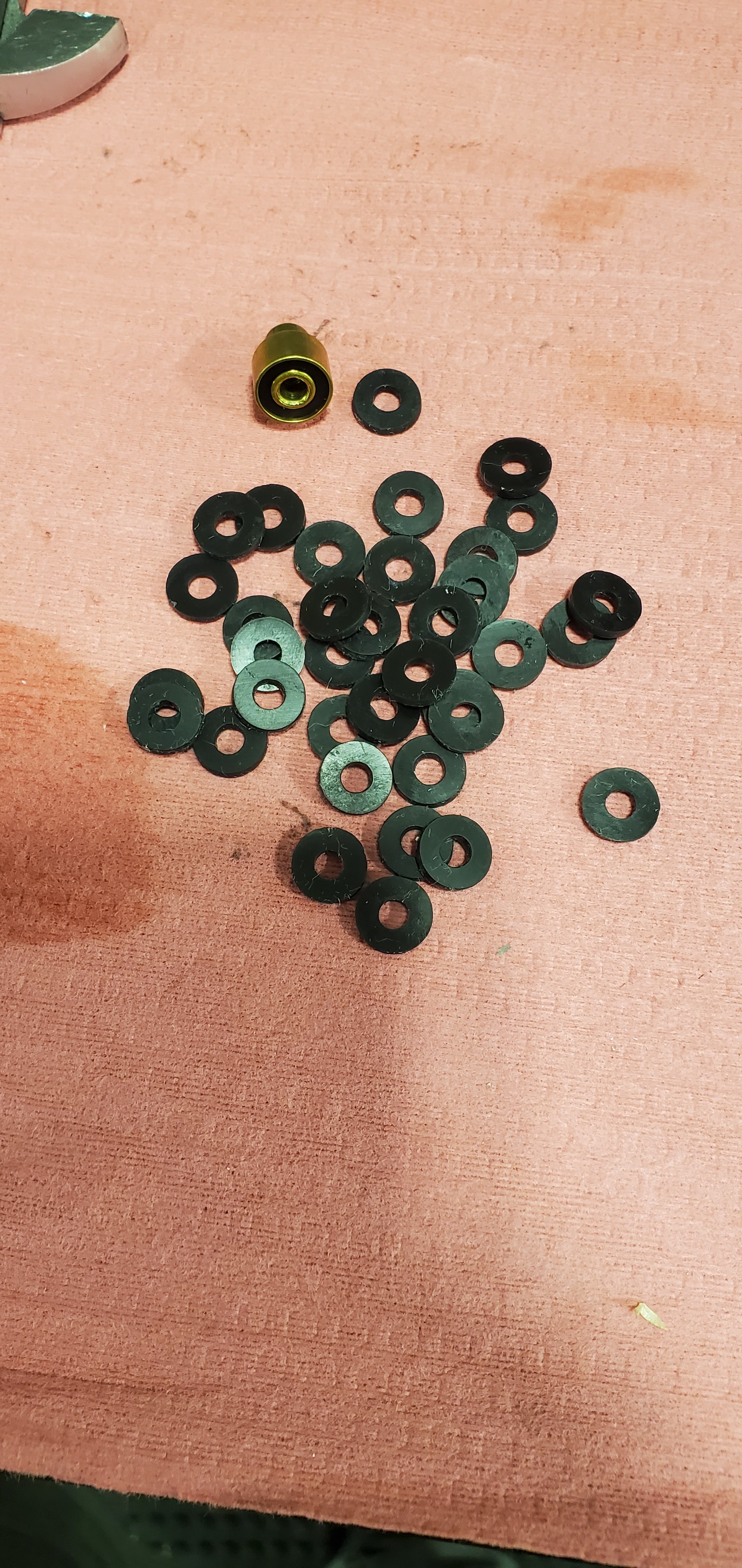

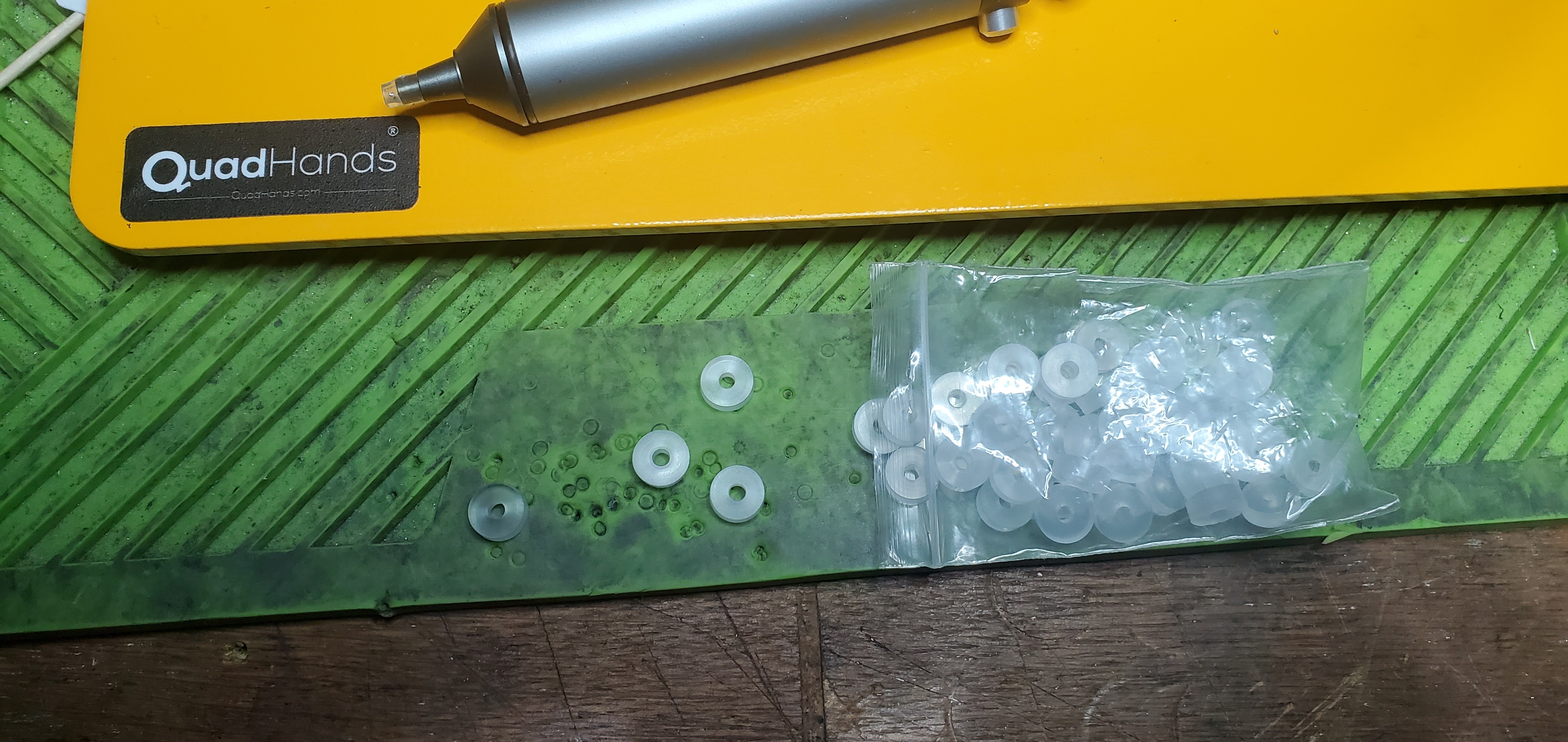

          -That's actually one of the materials I was leaning towards, along with Rulon-J and one other I seem to have closed the tab on.
          Thanks for the info! How'd you know that, out of curiosity?
          Sorry for the necropost, my notifications are all screwed up. About a decade ago, Air America bottle reg seats were getting scarce, so I set out to make enough to keep myself and a few friends supplied for the foreseeable future. I figured they were PCTFE given it's application and distinctive translucent appearance, and I was able to confirm off an old Air America patent drawing. It's a very common high performance seal material in and outside of paintball due to its superior physical and chemical properties compared to some of the more pedestrian engineering polymers like acetal, UHMW, PTFE, etc. Only downside is it's pricey.
          The swiss lathe at my job at the time made all these in about a minute.
          Click image for larger version  Name:	20211125_201350.jpg Views:	2 Size:	1.54 MB ID:	386501
          Lately, I've taken to laser cutting any flat seals I need, as It doesn't require any tooling to be made. Some ICD B2k/promaster cupseals & reg seats and some phantom cupseals. both 90D urethane.

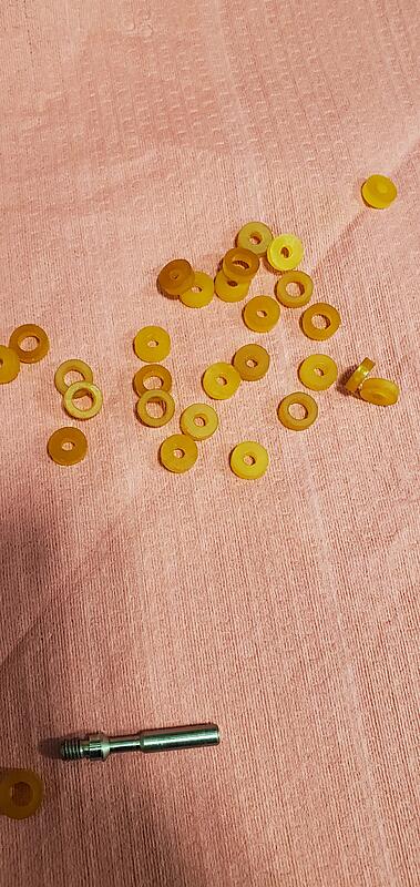

                  Click image for larger version Name:	20220919_193131.jpg Views:	2 Size:	1.82 MB ID:	386503
