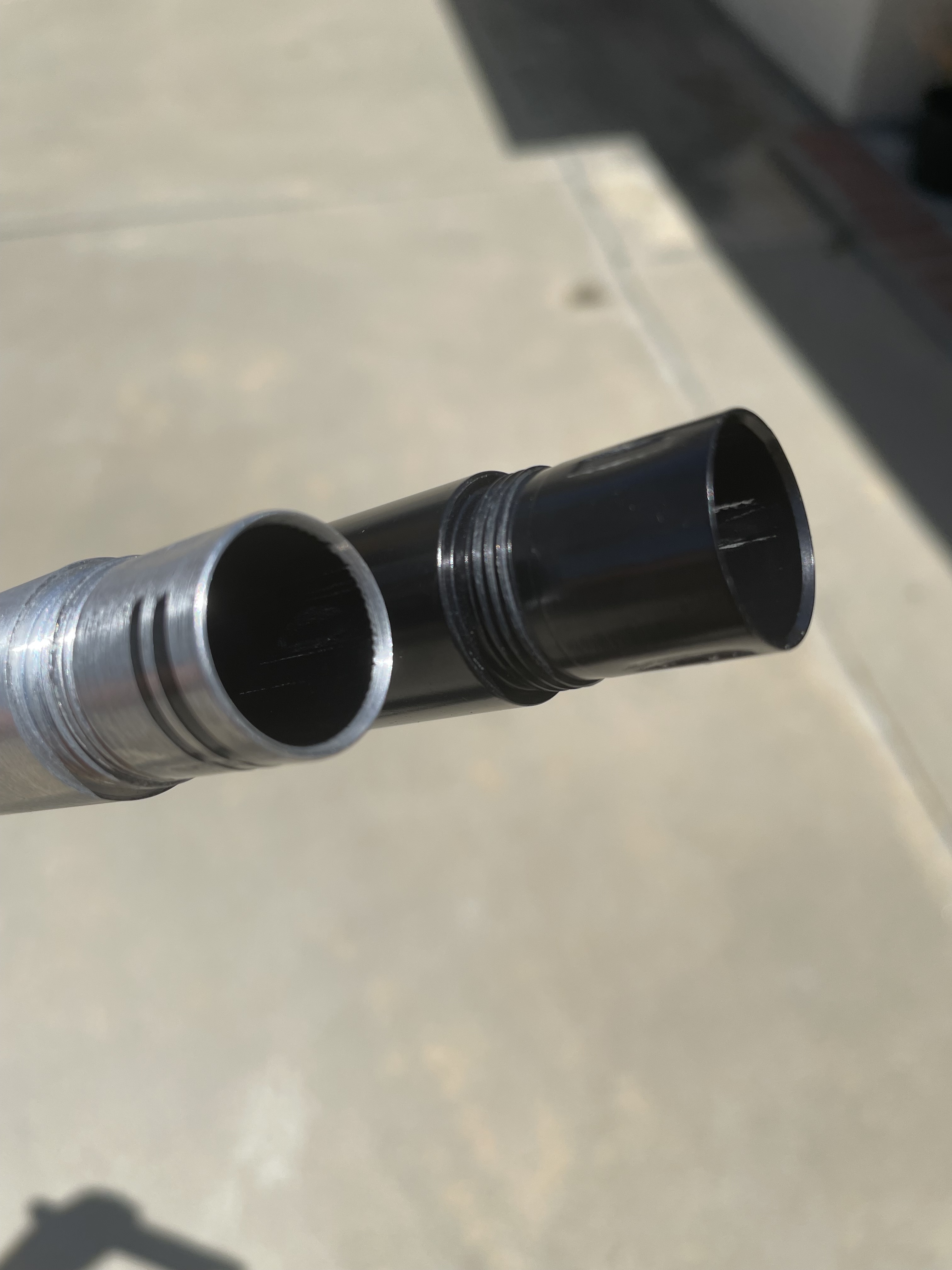

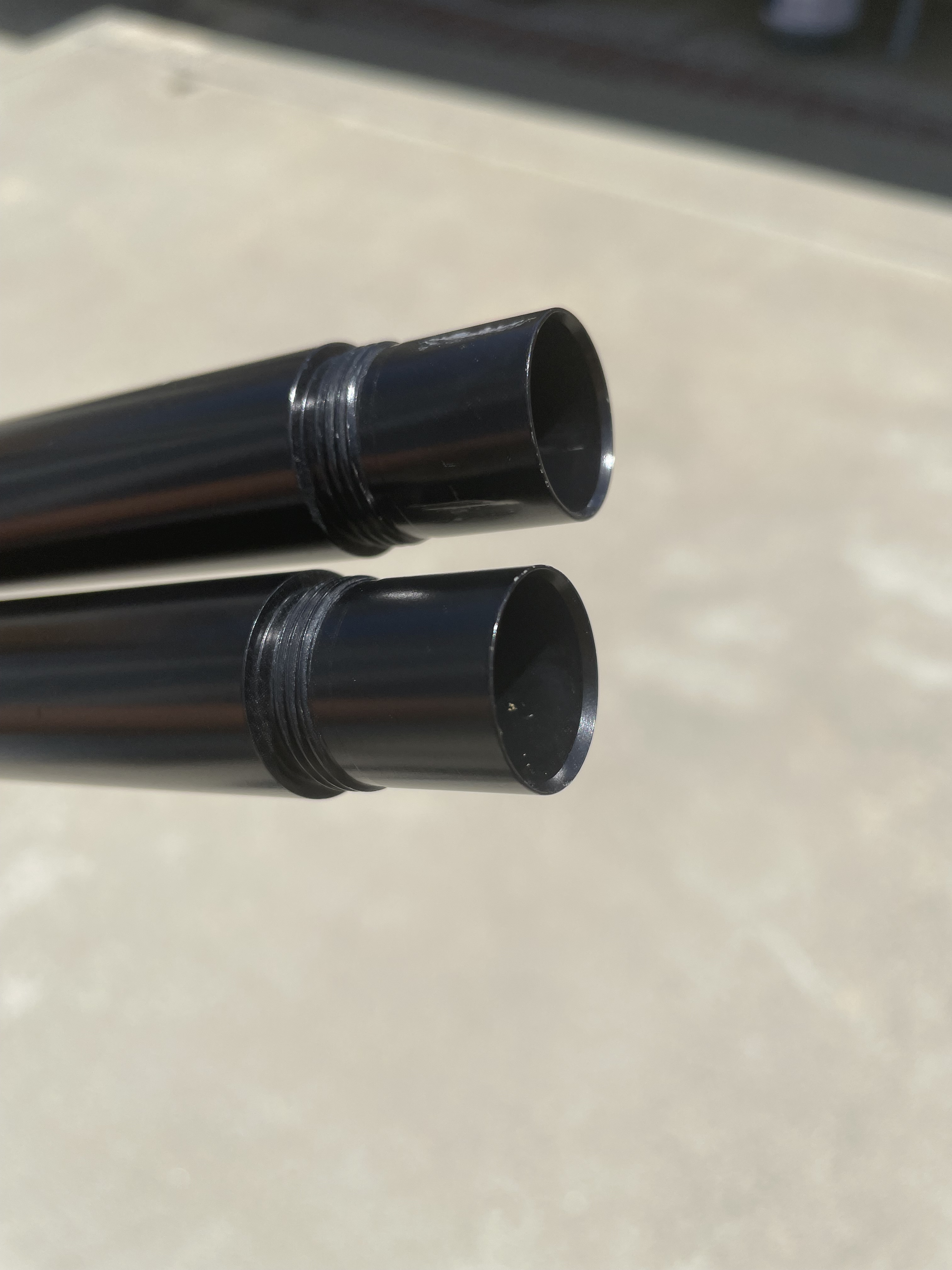

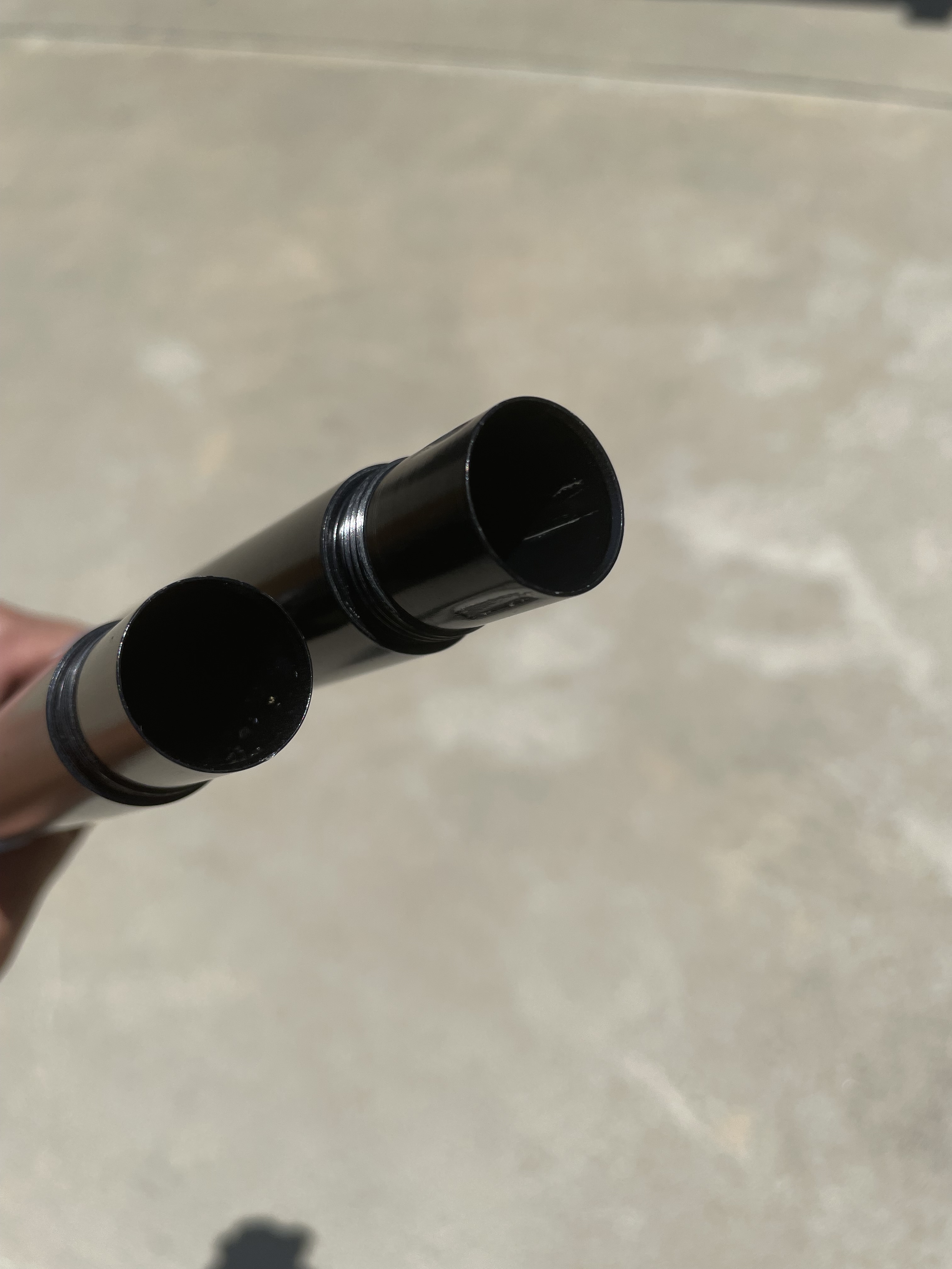

            I had 2 barrels sent in to Palmers Pursuit Shop(PPS) to install wedgits, an original Trracer barrel and an Allen Paintball Products(APP) rifled barrel.
            Palmers(PPS) installed the 3 wedgits in a triangular orientation as to evenly apply pressure to the paintball as opposed to a single point applied by a ball detent.
            The wedgits on the APP barrel is difficult to see due to the bare aluminum. Comparing the depth of the wedgits, the original Trracer barrel's wedgits is more pronounced than the APP barrel's wedgits. This might be due to the APP barrel being .685 bore diameter, the original Trracer barrel's bore diameter I am unsure of.
            Unfortunately, I am unable to confirm the smallest paintball diameter that the wedgits could successfully prevent rollouts.

            More pictures of the original Trracer barrel compared to a wedgited one.

            My opinion would be to create Trracer-Spacers in .670 and bore them to the desired size of the customer.
