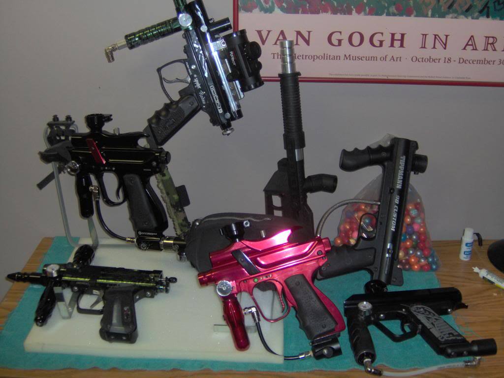

            Pimps can be rebuilt and you can get parts for them. I did some a few years ago. Just be prepared to replace every.single.oring! But other than that, they will rip. You can get a was board and they will ramp at ludicrous speeds. Here's my journey rebuilding one. I link all the parts and stuff you need. https://www.pbnation.com/showthread.php?t=5614225
            Omens are rebuildable too (https://www.pbnation.com/showthread.php?t=5975135) but they are more of an acquired taste. I rebuilt one of those a few years ago. They are much easier to rebuild and recently a guy put a different board in it to get it shooting 10.5. I would recommend starting with a 2.0 if you go that route.
