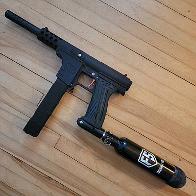

                  I ditched the CF20's and have never looked back!
                    • 6386
                    #27
                    What is that setup? I've never seen it
                    • Squid
                      • Mar 2025
                      • 7
                      • WI
                      #28
                      The half mag lower is made by Skibba Rigged
                      The upper and bolt cap are made by East Coast Anarchy Productions
                      8" Deadlywind freak barrel
                      20 round Dye Dam mags that I literally cut in half with a hacksaw
                      Inception Designs trigger
                      PE 3-way valve (Deadlywind 45 hair valve is not compatible with the lower)
                      It's about 3lbs with full tank and mag. Hands down the most fun marker I've ever owned.
                      • vijil
                        vijil commented
                        Who made the magwell? Did you print your own?
                      • Squid
                        Squid commented
                        It's the SHAM lower, designed and printed by Andy Skibba. Search "Skibba Rigged" on FB and send him a message if you're interested.
