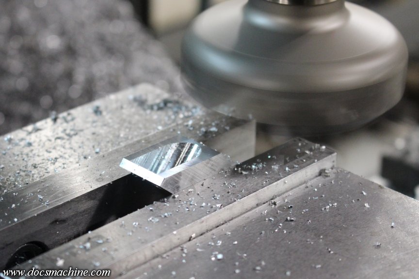

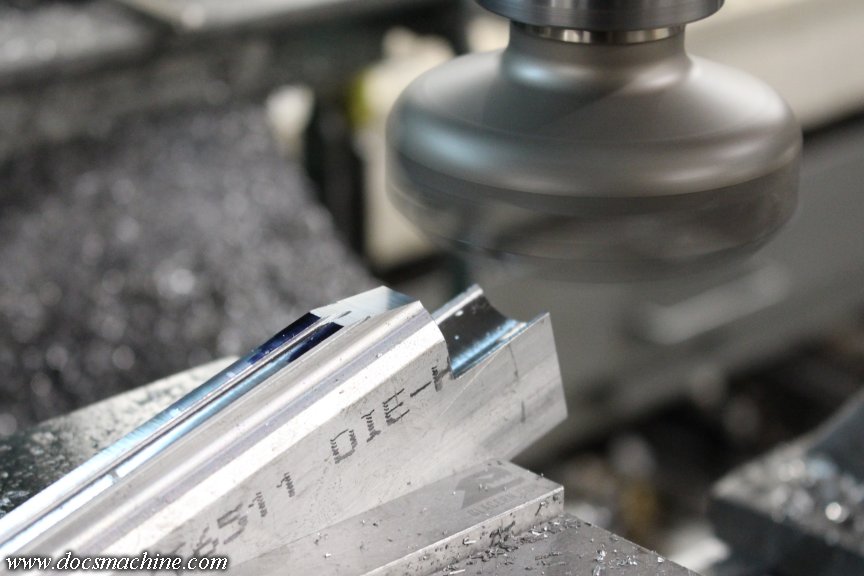

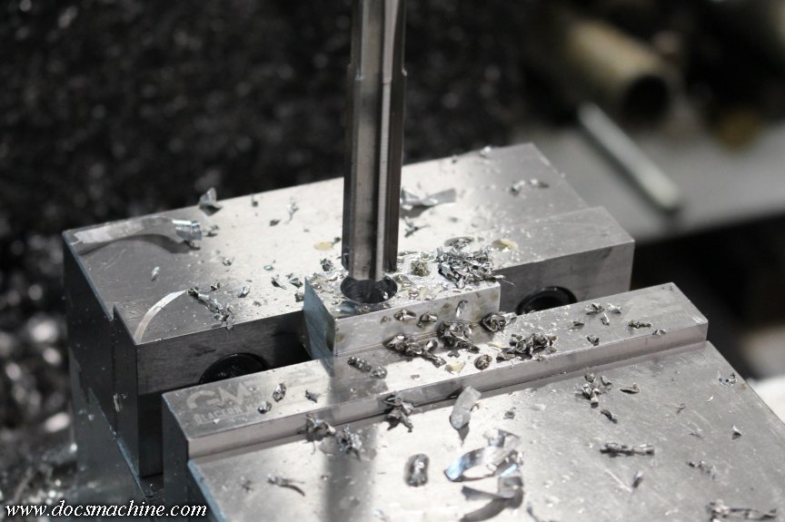

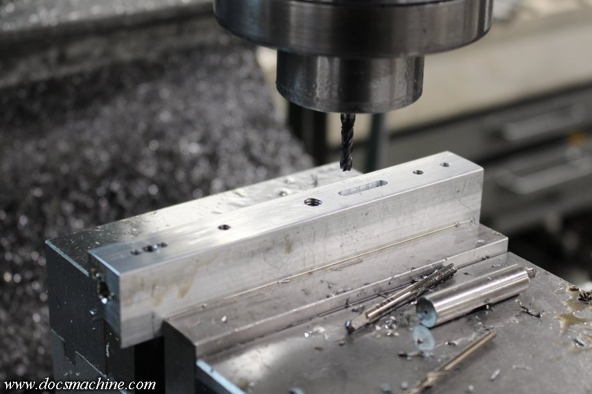

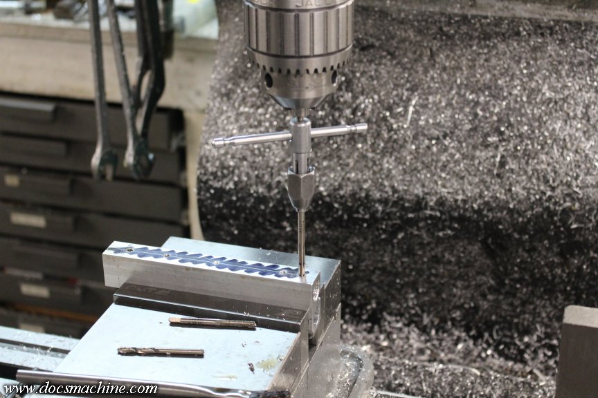

        Continuing on what has become known as the Three-Quarter Sniper Project, once I had the internals drilled and tapped, I plunked the body into the horizontal mill, and rough-grooved the sight rail.

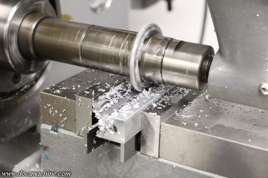

        A quick 90 degree roll and a different cutter, and the pump-rod groove suddenly appears!

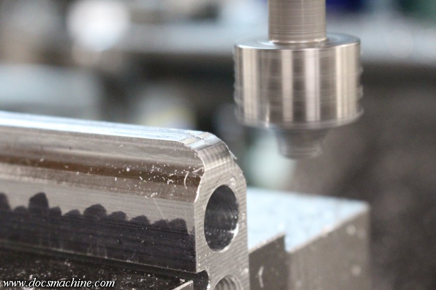

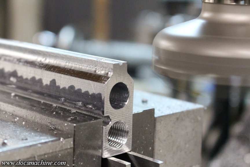

        Now, I don't have the right cutters to profile the body properly- something I'm already attending- so I used the 45 degree edge of the face mill to at least taper it a bit...
        And a corner-rounding bit to finish off the back of the rail in standard WGP fashion.
        The front gets a 15-degree angle, and that finishes off the top side

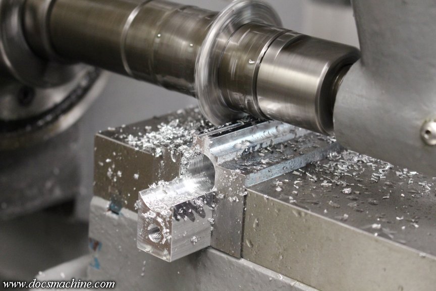

        Flipping it over, the center is located, and the grip frame, vertical air adapter and inner gas passages are drilled and as needed, tapped.
        Finally, the hammer lug slot is milled.

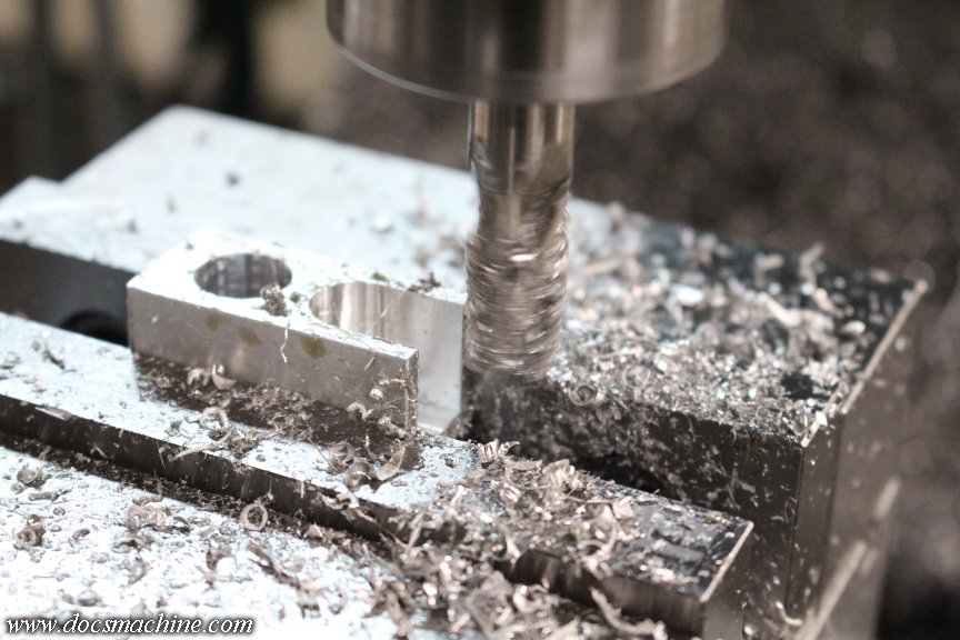

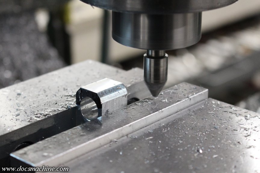

        A Sniper pump needs a backblock, so a blank is squared up, and the bolt passage drilled and reamed.
        The lower half is drilled and then the pocket milled out...
        ... And then sliced off at an angle.
        The same face cutter and a handy 60 degree taper mill profile the top a little to match the body...

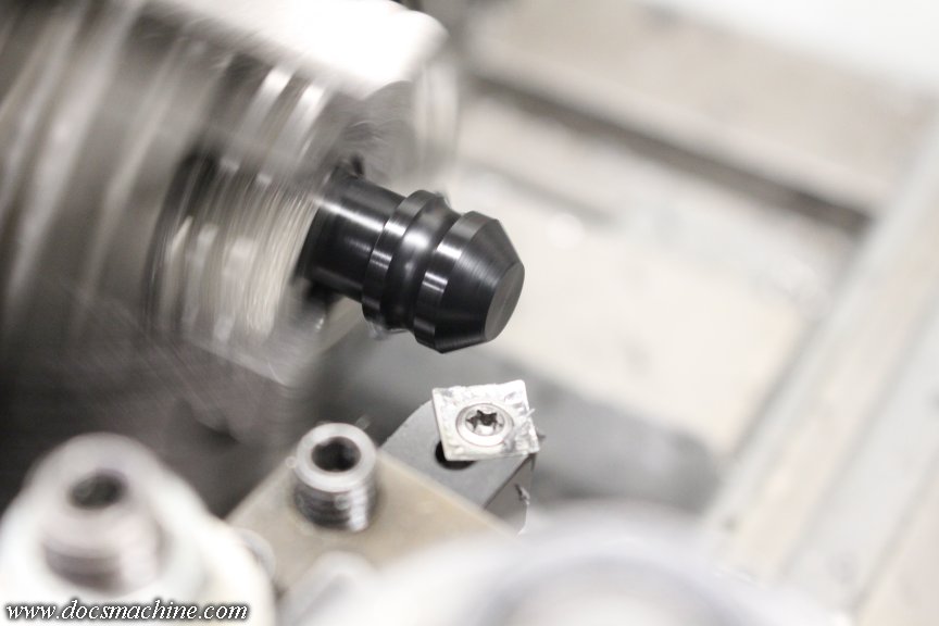

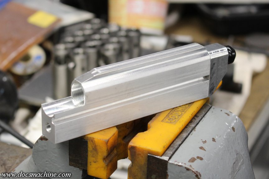

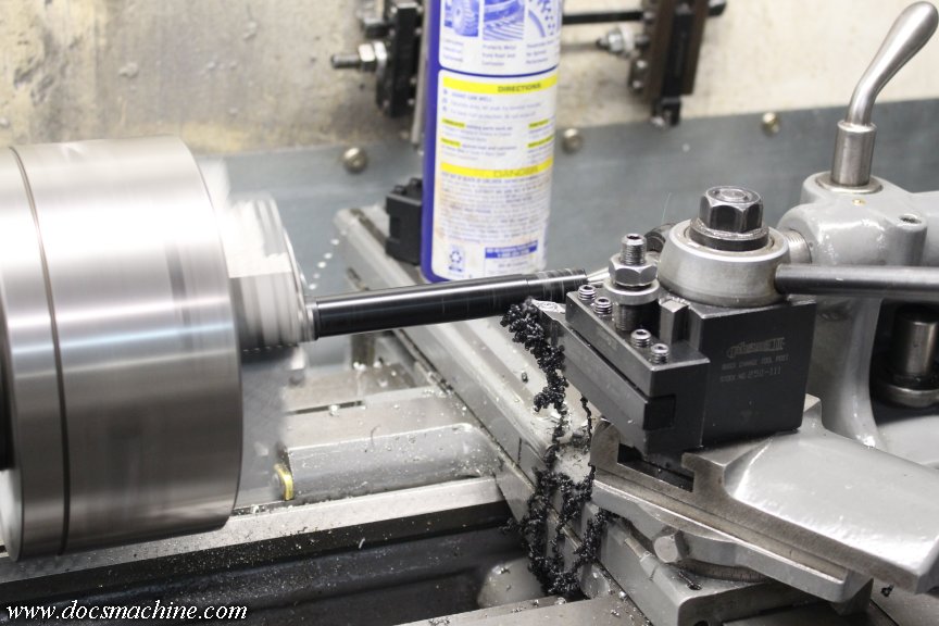

        And all we need is a bolt! Turn down a handy stick of black Delrin...
        Gussy it up a bit...
        And voila! She's still a little rough, but starting to look like the real thing!
