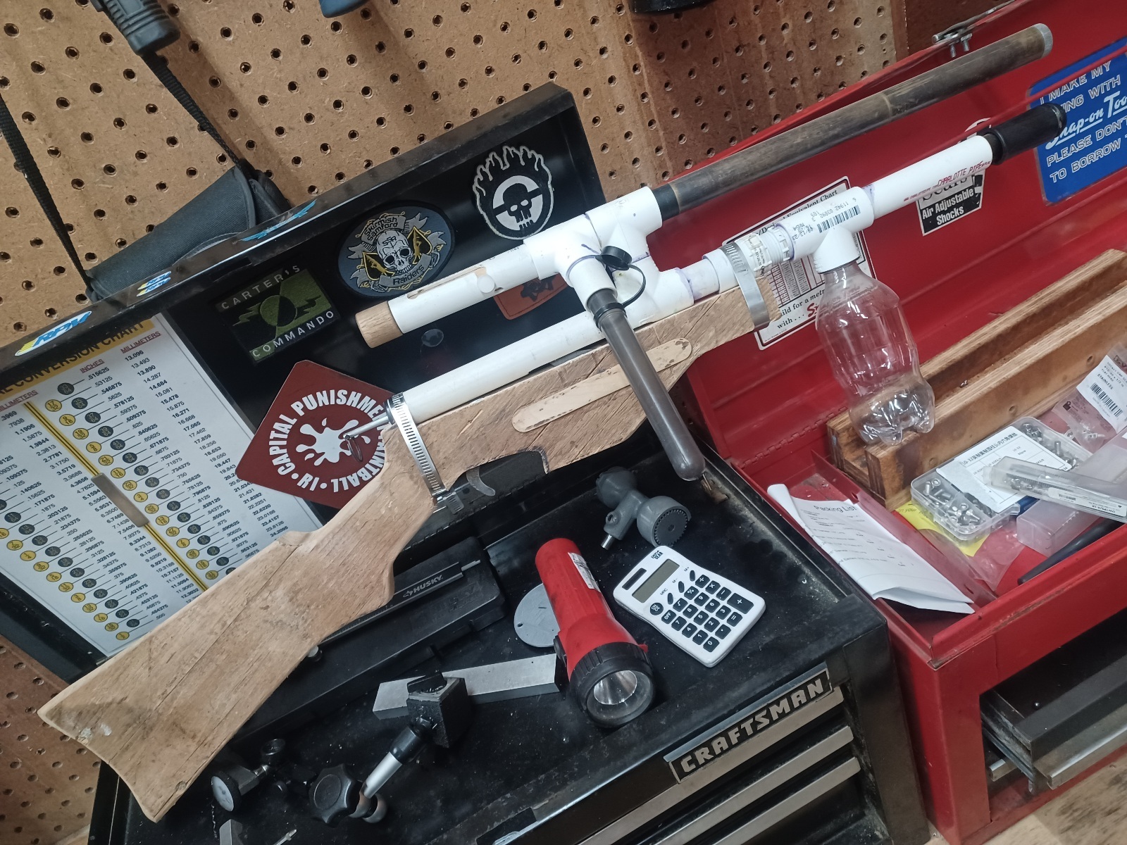

    The stupidest and most fun gun i ever made. For the Junk Class event that was held at Warzone last year. Bicycle pump, soda bottle, pvc and wood.

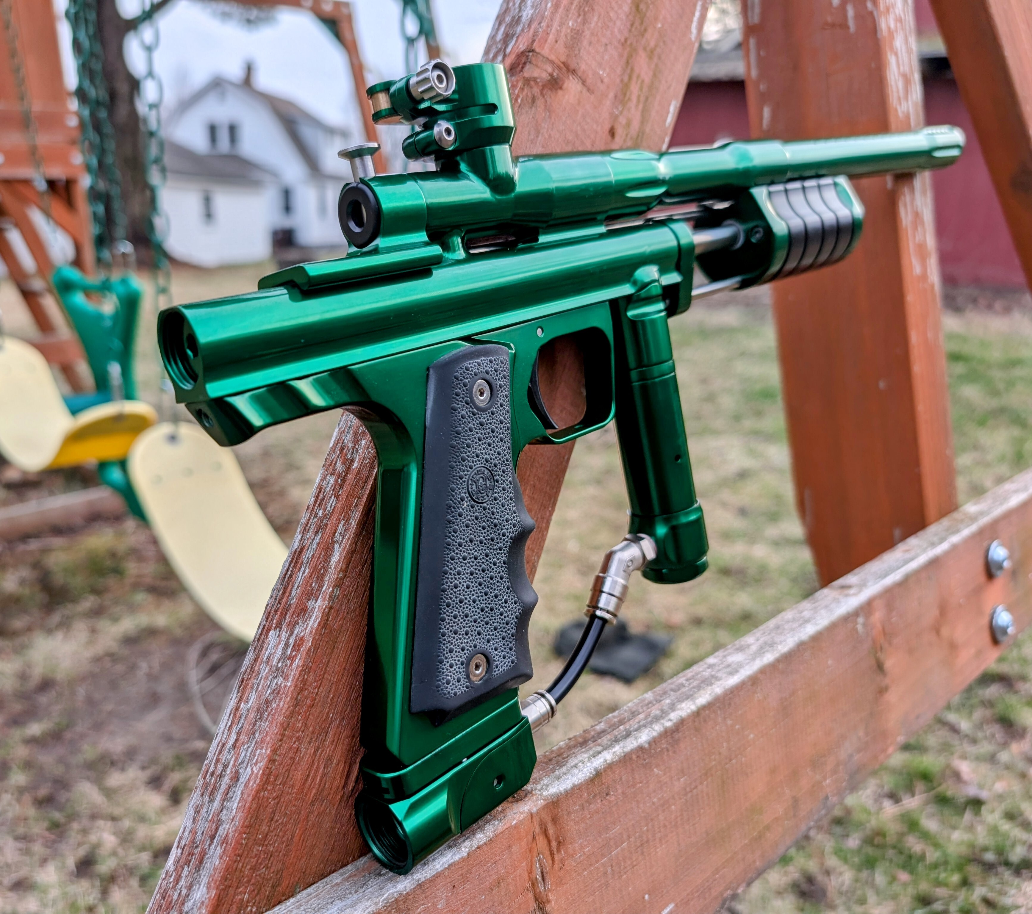

      What perfect timing for this month! I just finished my first fully custom build. By that I mean the first gun that I've hand picked every part and had it all anodized to match.
      Mozak Machine "Slender Cut" Half Block Sniper
      Build Sheet:
      • Polished Green by Ruckus Anodizing
      • CCM 45 Frame
      • ACP V3 Slice Pump Kit & Ultralite Sleeved Barrel
      • AKA Sidewinder Regulator
      • Lazarus Valve
      • Jenni Kraig Delrin Hammer
      • Inception Trident Bolt, FLE Feedneck, EZ On/Off & Rail
      • Shocktech Detent
      • Hogue Grips

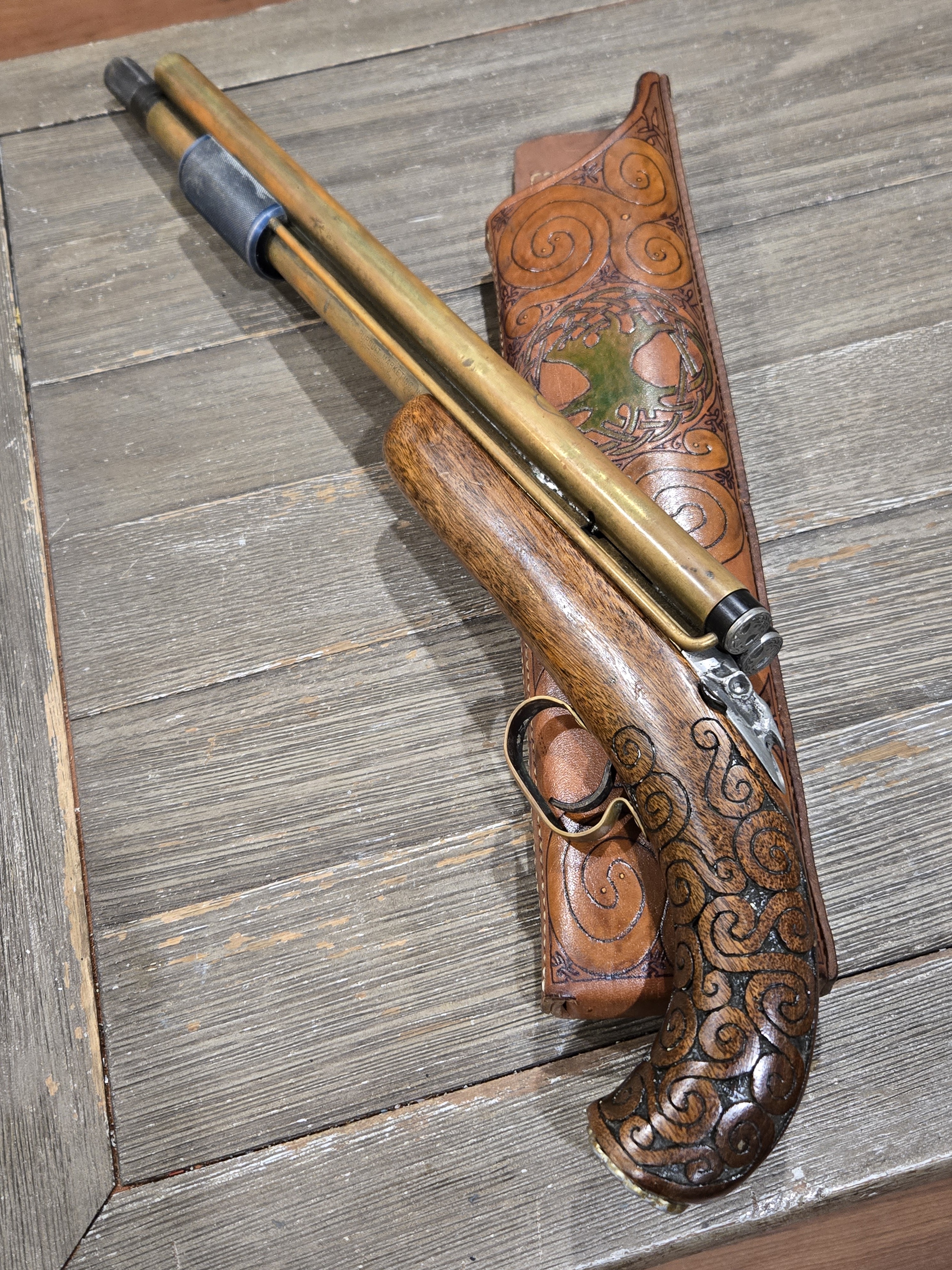

        Almost everything I have is a custom build, so I'll put this one in the spotlight today.
        Creeper Custom BS-VCS (Brass Sterling, Vertical Stock Class)
        -Freak barrel with CF tip. (I also have a brass pointy tip)
        - removable 12 round feed
        - CCI bucket changer
        - detent to hold a ball in the chamber
        - modded PGP grip frame (for now)
        Ion Long Rifle
        Spyder Pump
        BST Feedback
        Brass Thread

        • ChuckLove
          ChuckLove commented
          That's awesome!
        • JeeperCreeper
          JeeperCreeper commented
          Same to you, sir. I just saw the shooting video, that thing is smooth!
        • ChuckLove
          ChuckLove commented
          JeeperCreeper It took a bit of tinkering with both pump return and hammer springs and then some bolt O-rings. The pump stroke is comparable to my CCM MBP so I'm happy with it.

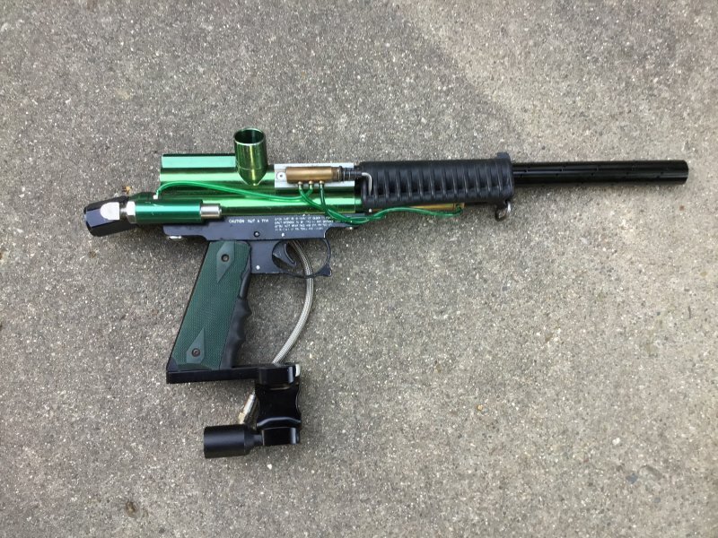

        My balance valve on twelve gram experiment
        Stockclass feed
        asa threaded the front of the body
        11/16 bored running dye Lazarus valve
        Delrin hammer with SLP hammer spring
        Palmers stab as a reg and guide rod
        • Psycho91
          Psycho91 commented
          This is clever

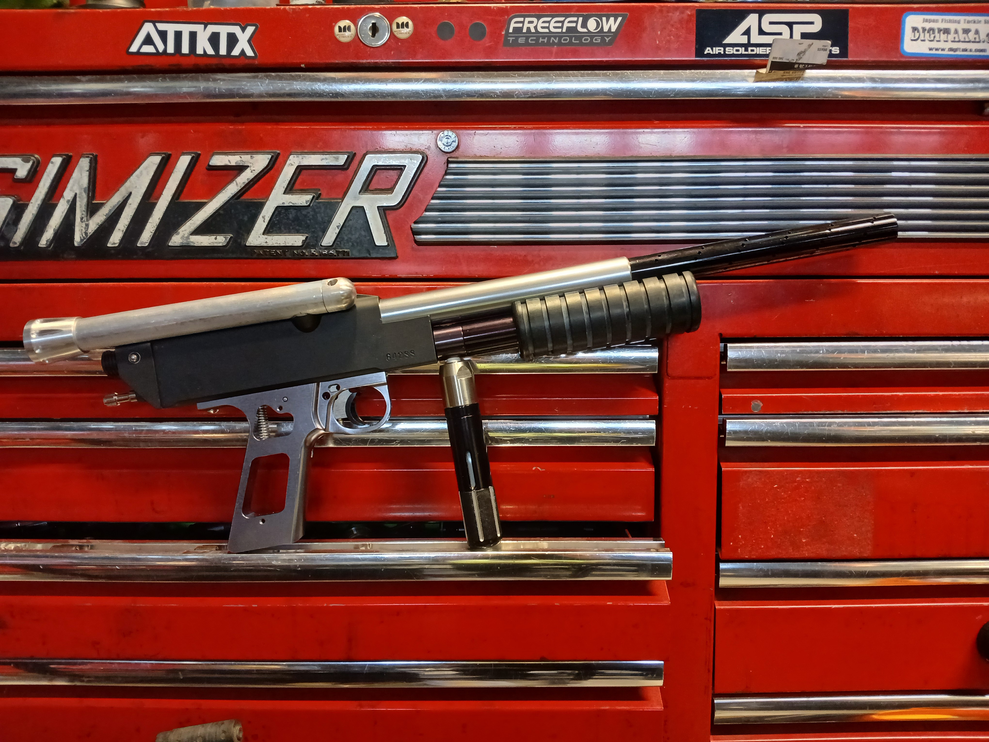

        Trilogy,
        • feedneck mod,
        • half-block, used the original back block to make a new back block, with ACP slot blocker
        • Machined off ram
        • inception bolt,
        • modified lazerous valve,
        • pump return spring for the hammer,
        • CCM Quad Rod pump kit with Mini pump handle
        • mozak frame, AKA sidewinder short, bob long cam drive asa, freak barrel, Doc's detention.
        • anodizing by Fab
        • pressure is at 135PSI shooting 295FPS​​ - where are all my silly long volumizers at?
        • Psycho91
          Psycho91 commented
          What did you do to modify the laz valve
        • Moodog
          Moodog commented
          Also curious to know how you modified the valve.

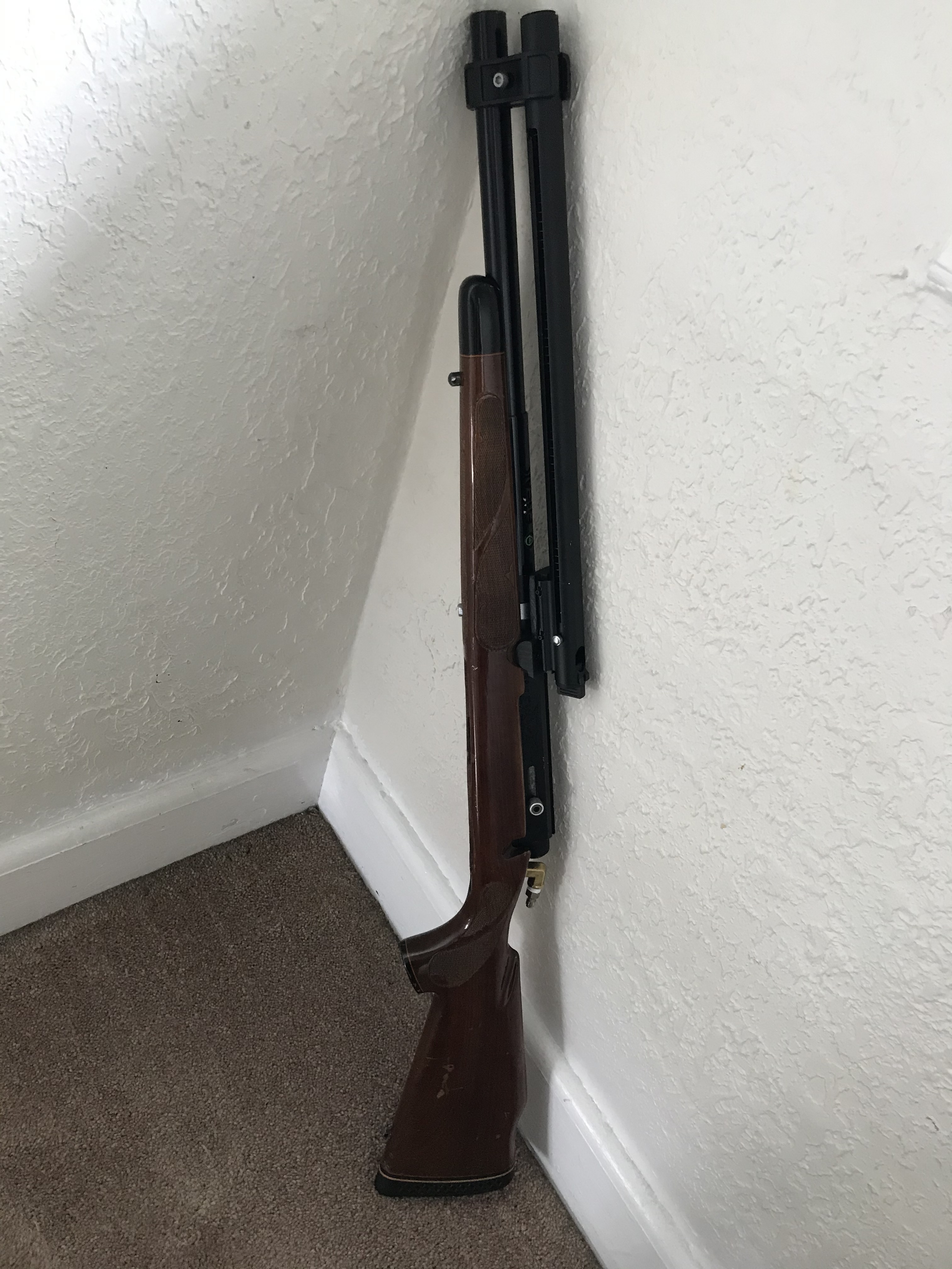

        I'll throw in some brass... my old k2. it's my second brassgun, and first k-series, came to me heavily chopped/df cut/constant air/pumped. I learned a lot of what I know slowly repairing the d/f cut, replacing the ammo tube, flat top rolling, making the handle, etc.
