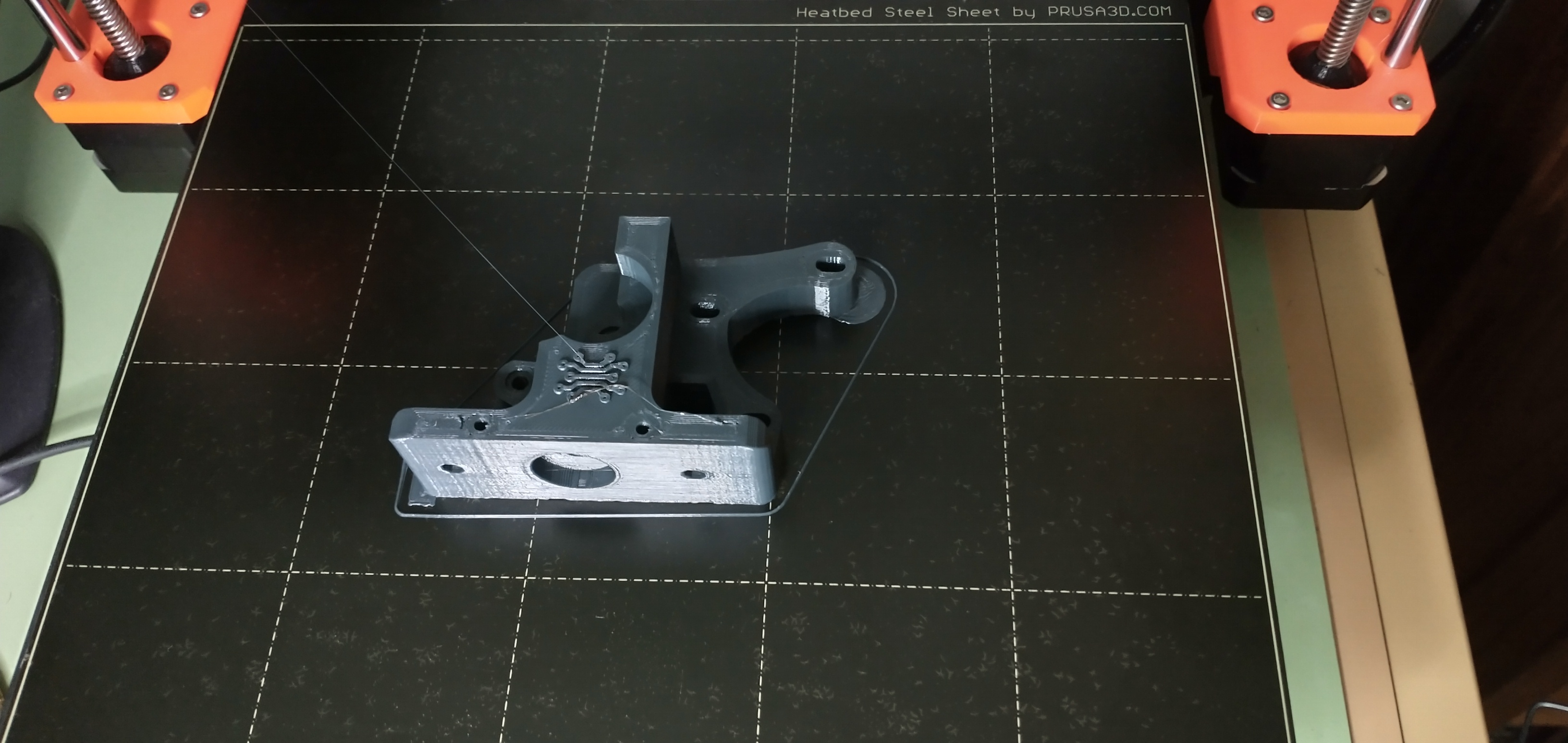

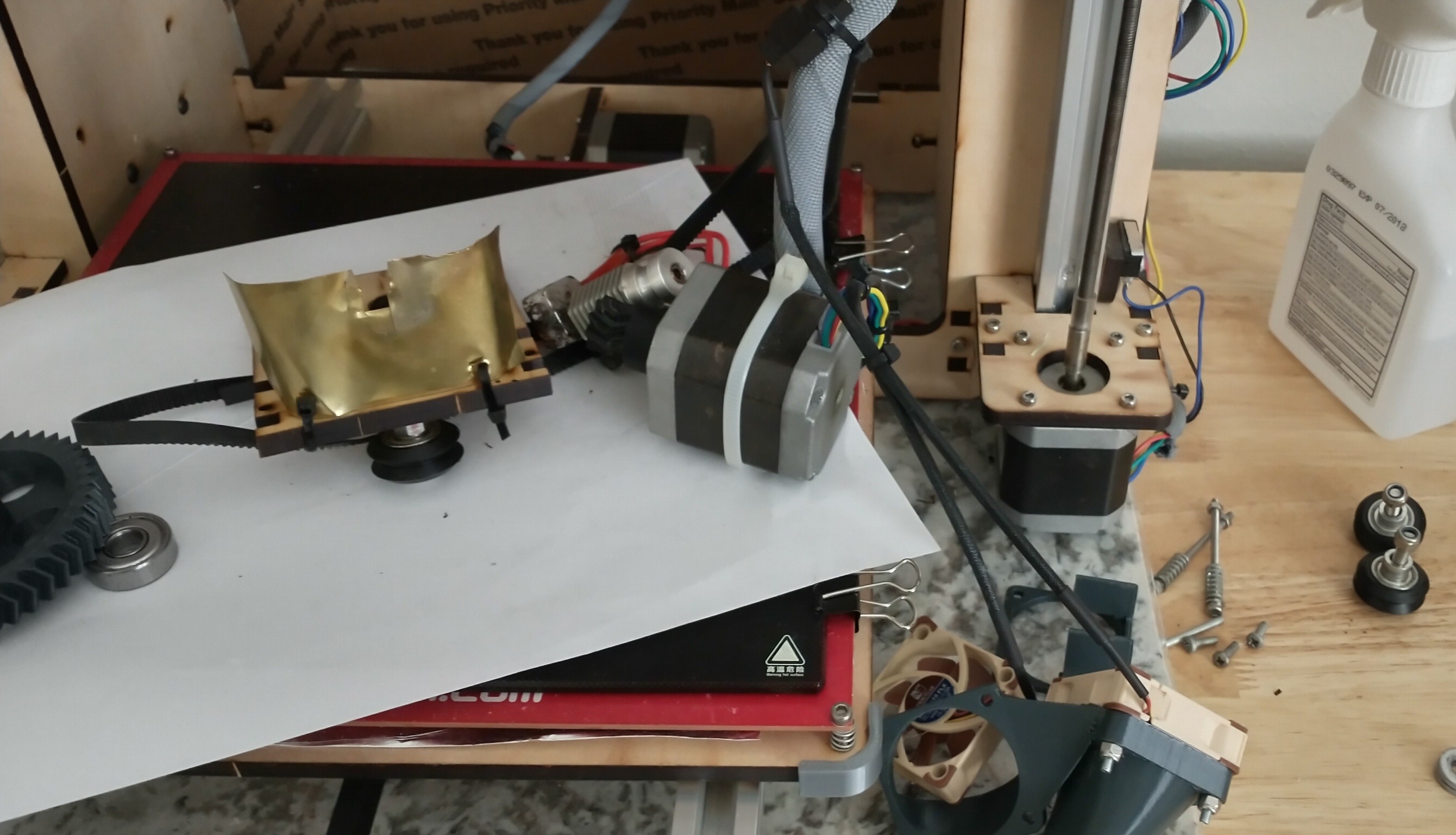

    Finally attacking the last trouble spot on the old printer. Still not sure about the bearing mounts on the original design. Seems to leave a lot up to shaft tension.
    • Ratzkie
      Ratzkie commented
      I've never seen another maker farm machine in the wild! that looks like the 12 inch i3v? same one I have. I'm converting mine to direct drive, and i dropped a little tiny nema 17 or something on it. finally got around to putting a full size 12 inch glass bed on too, but now i'm thinking i messed up and i should have looked to see if anyone makes a 12 pei smooth sheet.
      Is your heat plate warped to hell as mine is?? the only thing i could come up with was packing it with foam core underneath, which also acts as insulation
    • Spider!
      Spider! commented
      Ratzkie, mine is a 10" i3v. I kind of like the glass; I use it for different types of filament and switch back and forth from coated creality sheet to plain glass Creality sheet because they are both 4mm thick. Be sure and see the pictures in my bed temperature thread around here. I just use a couple layers of foil under my bed. My son had stuffed a half of a oven mitt under it, which warped it a lot. Taking out the mitt and using thick glass makes it very flat, just slow to heat up. I added the later groove to the outside bearing seat in the extruder base and a longer lip on that rim, so lmk if you want it. I also discovered that the makerfarm base was teflon tube ready (mostly). With the new slicers able to program around the z-steps, it runs pretty well once you figure out what it is supposed to be doing. This one was a bit of a kludge of metric, imperial, and ansi sizes, so some things didn't fit quite right in its younger days.

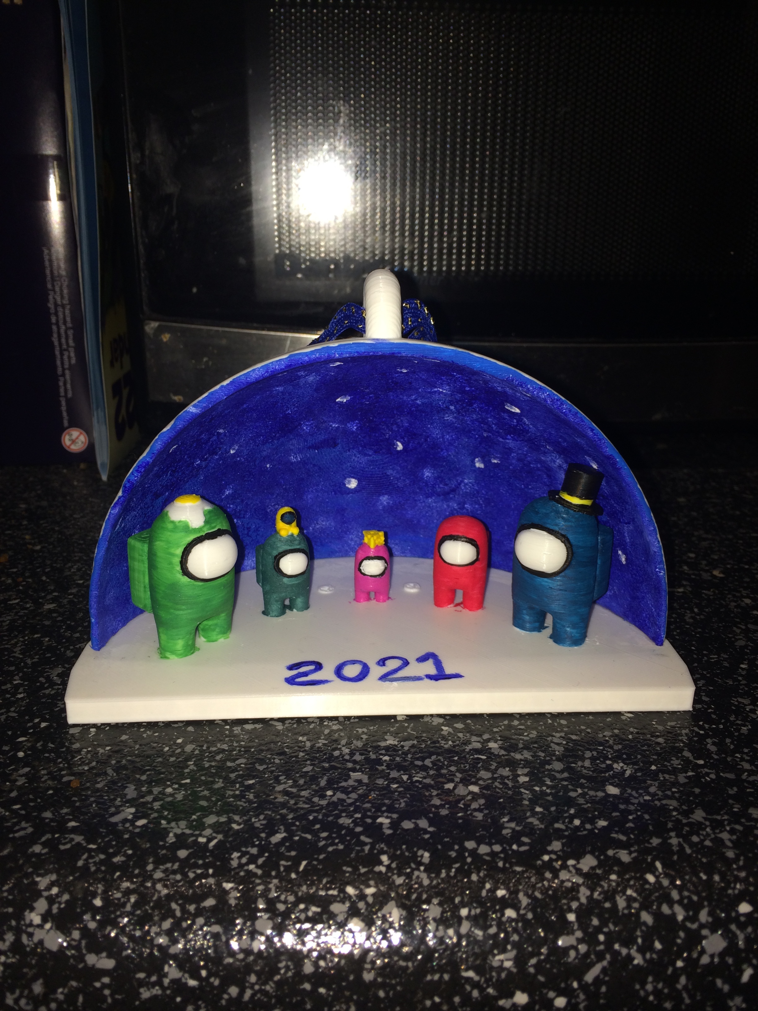

    Earlier this week, our 2021 family ornament was finished including paint and assembly.

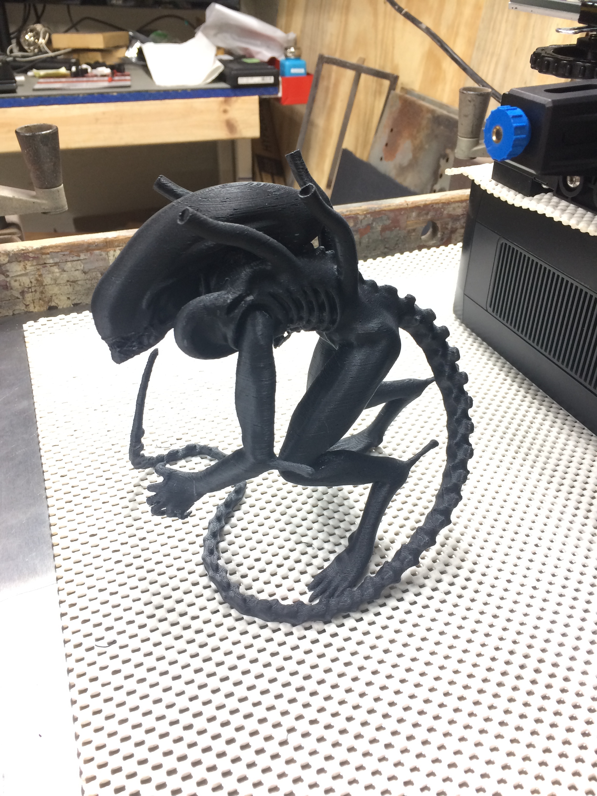

    My most complex and long print yet finished up early this morning. A Xenomorph warrior drone for a gift. Lesson learned: more perimeters and don’t fret about the extra time needed.
    My feedback
    • Foster
      Foster commented
      Great prints!
      I skipped the 3 when I decided to buy a printer. Mostly because of advice, but mostly from seeing grainy stringy prints.
      Yours seems to be dialed in and producing quality.

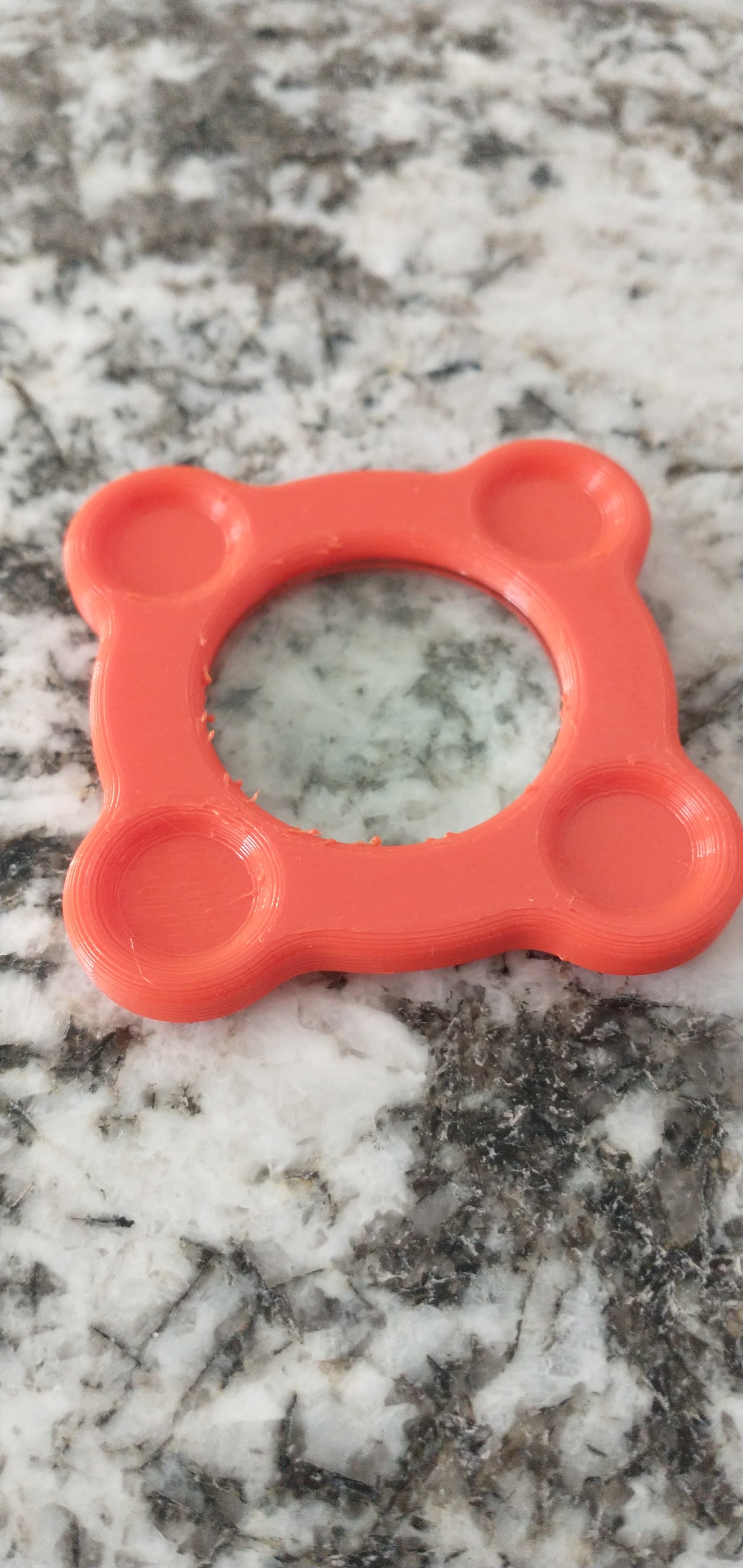

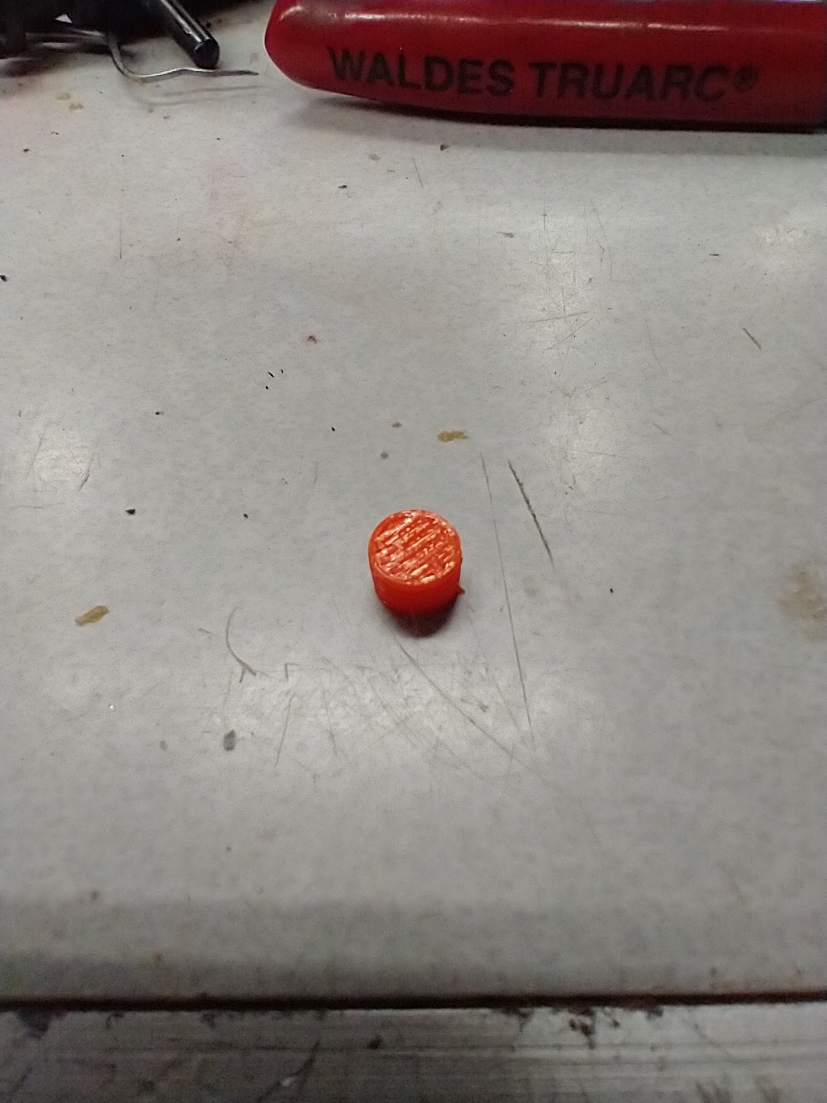

    I've been rebuilding azodin KP 3s. These seals have been working perfectly so far (5 regs).
    IMG_20211224_080450382.jpg Then I made a lens holder for my shaving kit magnifier.
      Alexndl commented
      What material are you using for reg seal?
    • Spider!
      Spider! commented
      Alexndl, it's original ninja flex. The reel is about six years old. Hard to keep the boogers off, but great otherwise.

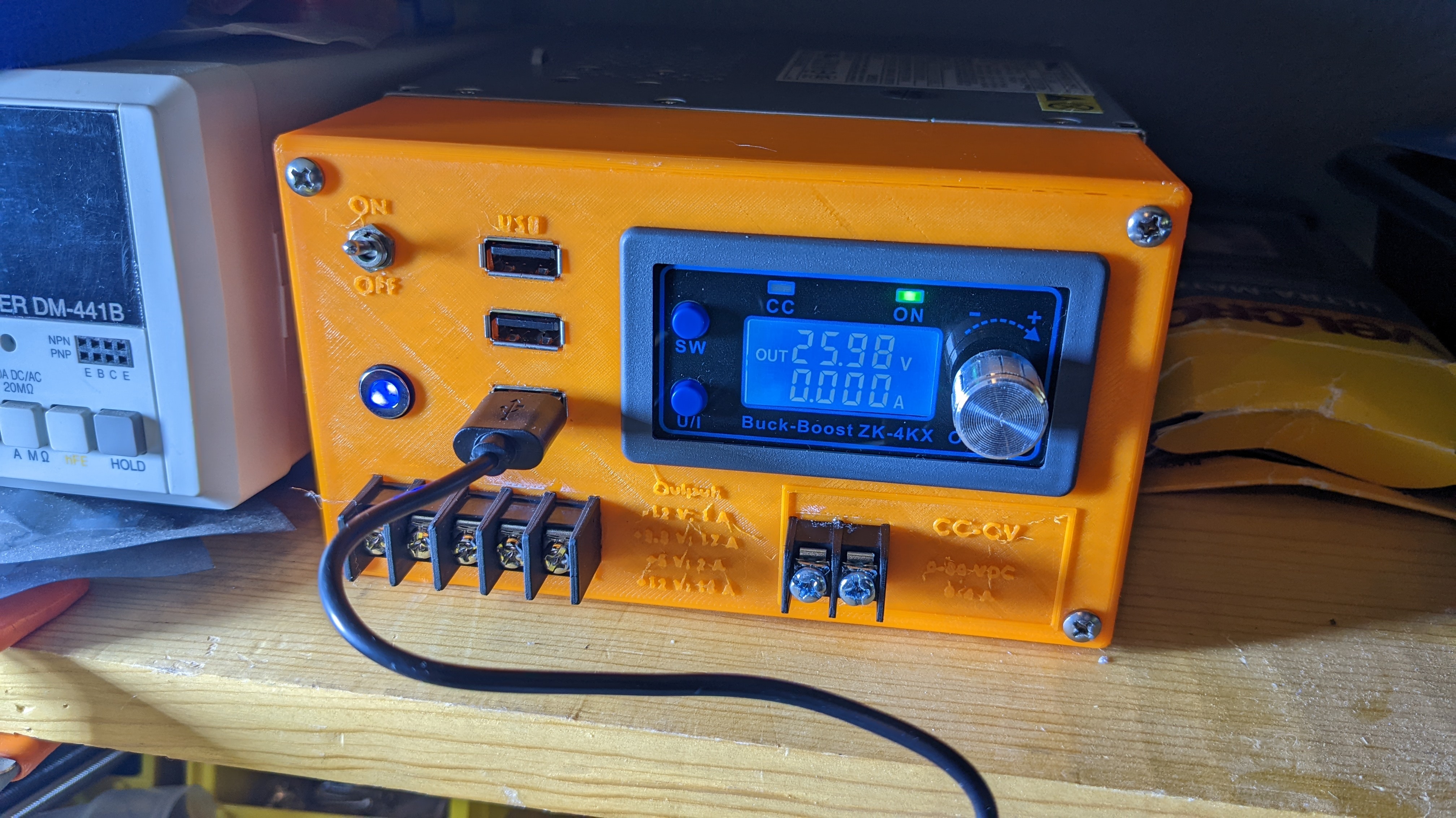

        Finally got my bench top power supply complete.
        • Spider!
          Spider! commented
          Nice! I've been sitting on an old computer supply, but I haven't needed another supply.
        • Spider!
          Spider! commented
          So was that one from thingiverse, or did you design it?
          XEMON commented
          I designed it from scratch.
          I've been thinking of making a clean one (cleaner than my last one 😅) for a while, the last one was done in a hurry ...
          Got -12, grn, +3.3, +5 and +12 on the left
          And 0-30v 0-4A CC-CV on the right
          The 3 USB plugs are on the standby so they are powered all the time.
          This particular power supply is a bit fancier than standard ATX because it has 2 independent 12v output (18Aeach). One goes to the 12v post, the other to the CC-CV controller

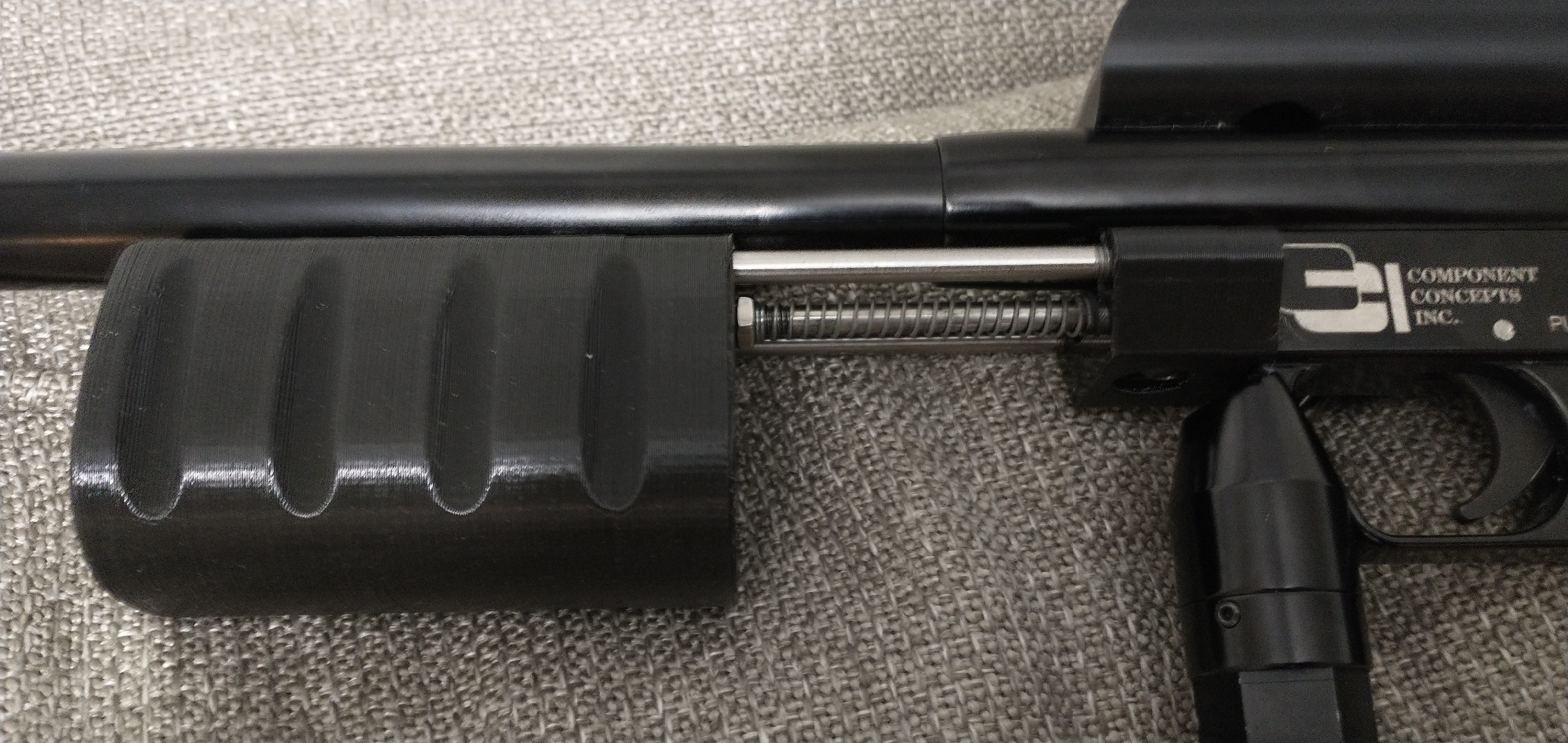

                  My first paintball related print, Rainmaker phantom reverse feed moded for a 2 screw spyder
                  I think a thicker wall and slower print could get it smoother but still not too bad I guess
