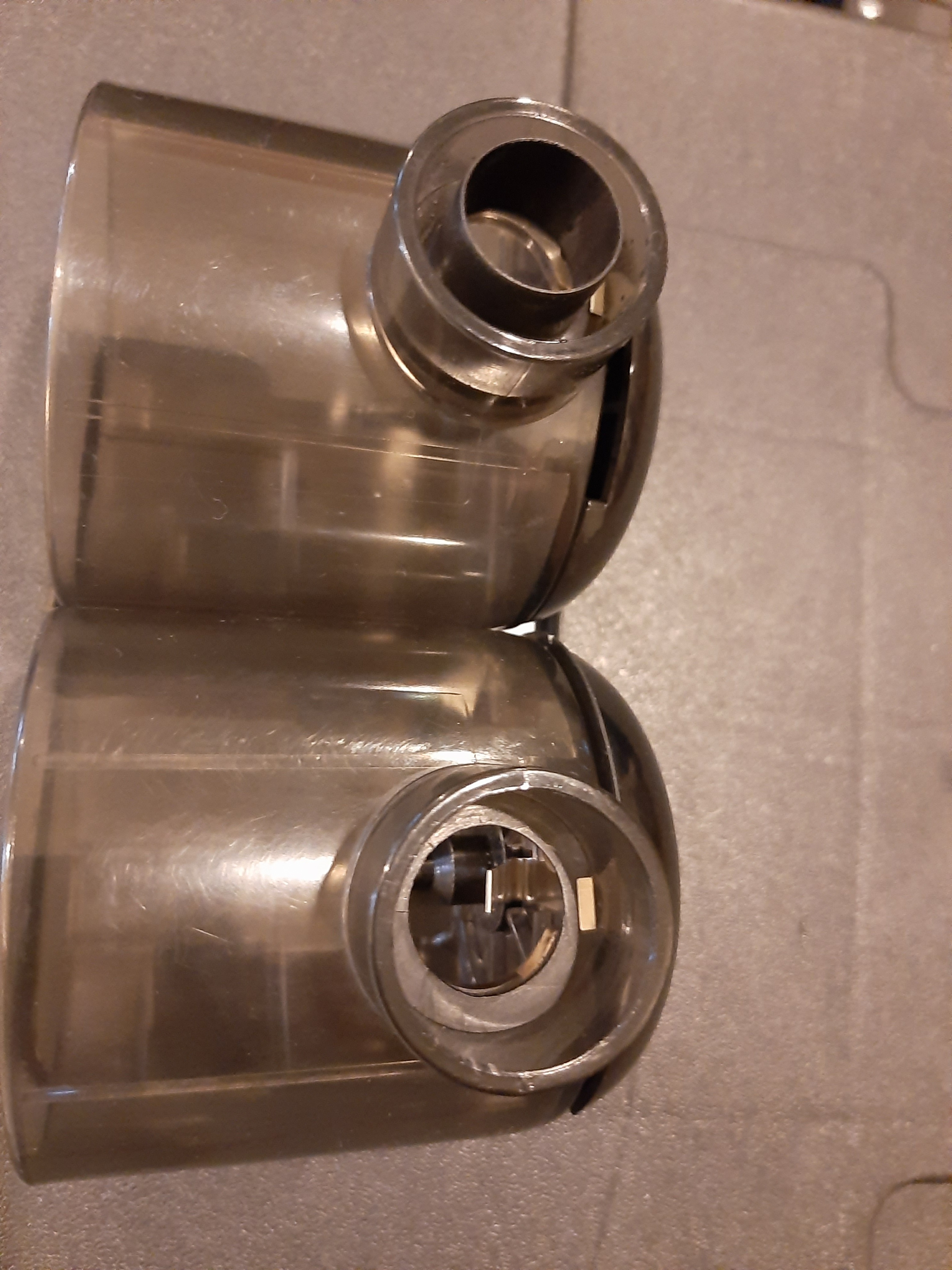

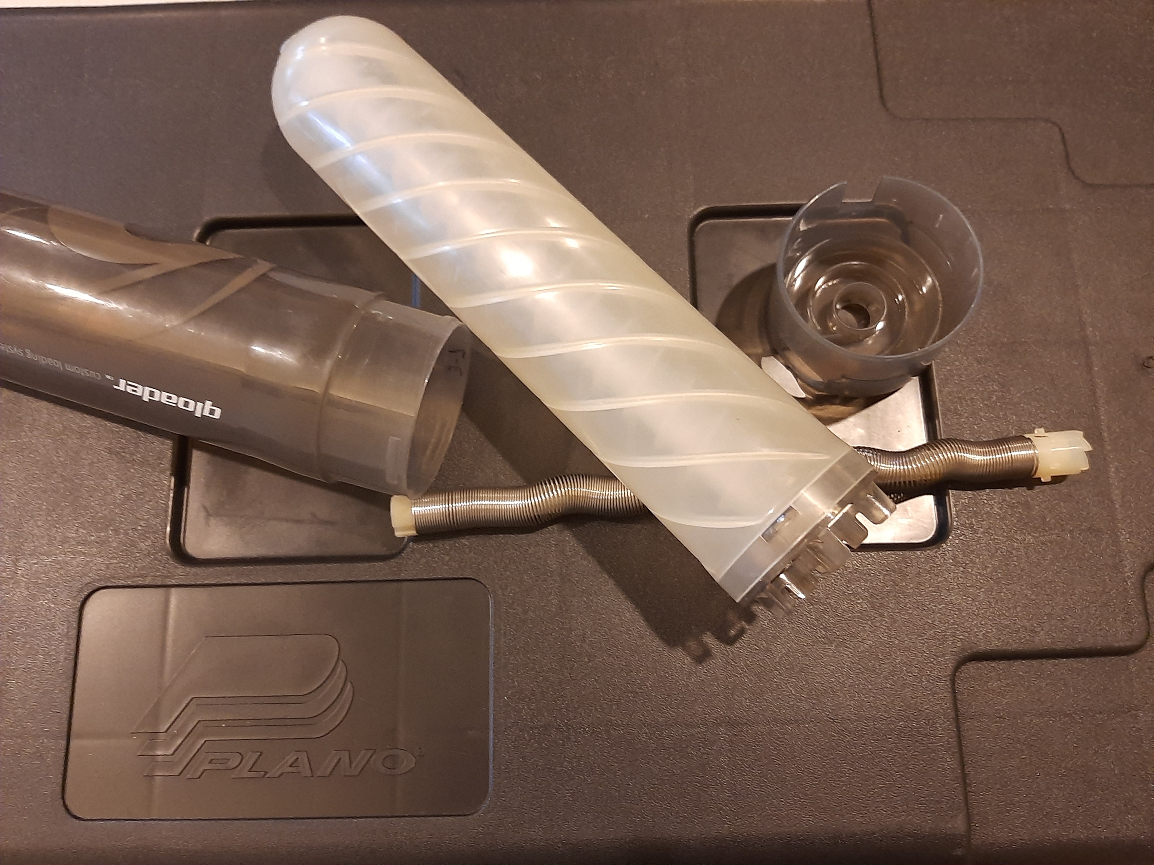

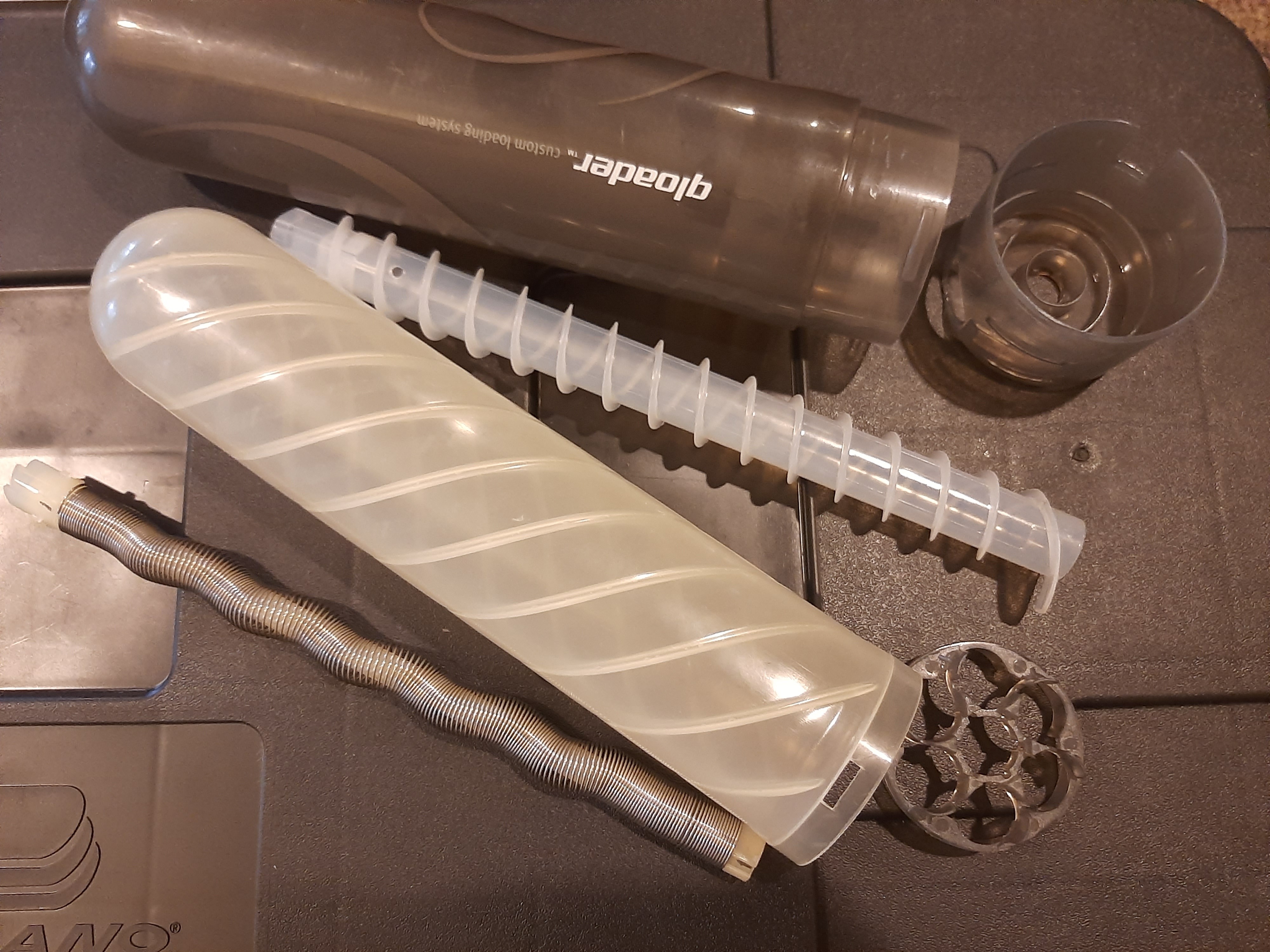

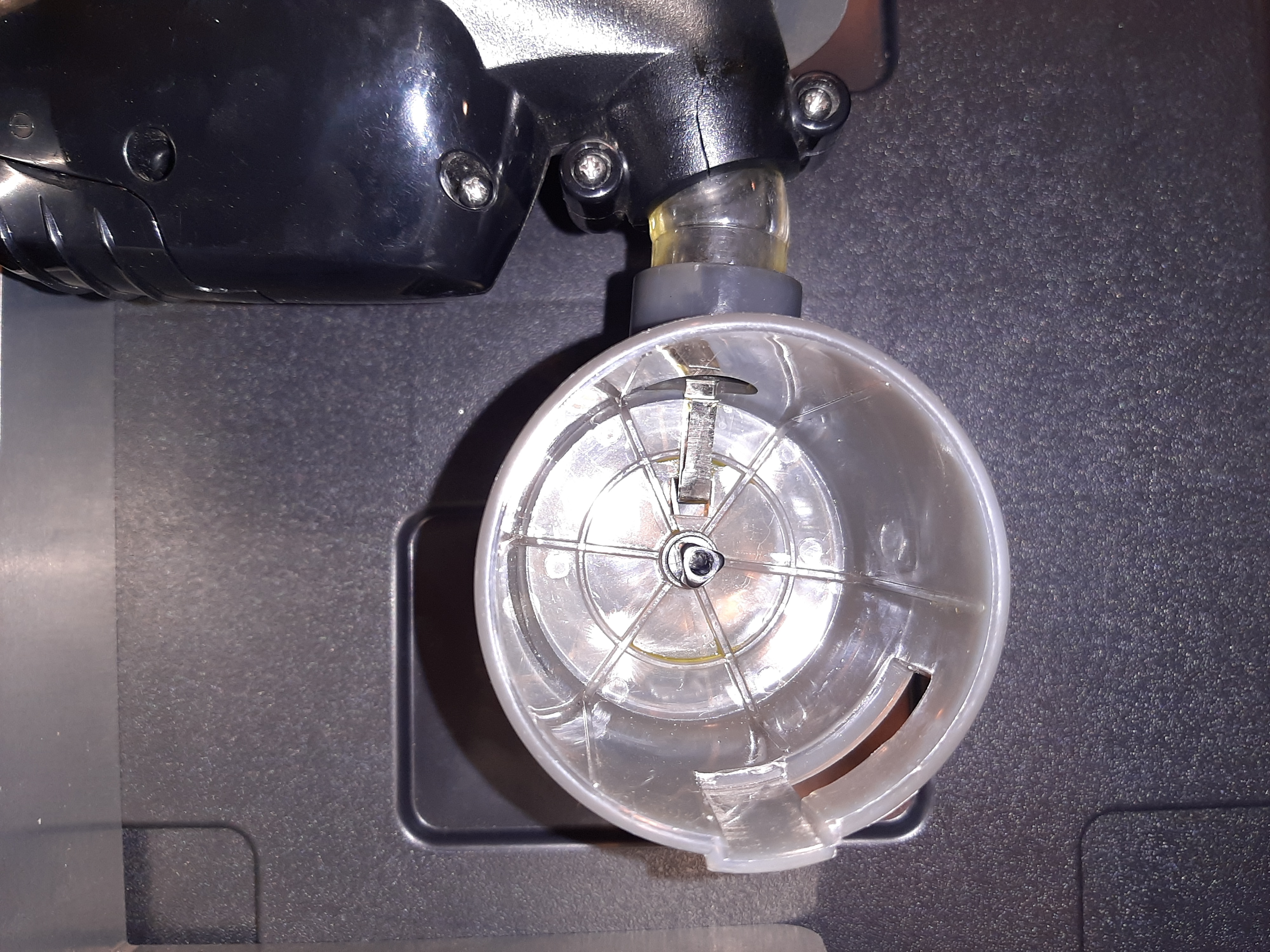

      Cleaning Q-Pods:
      They really aren’t too bad to take apart for cleaning. The outer (top) cap pulls off, and the spring motor will slide right out. In most cases you can leave the plastic parts (screw, drive tube, and inner cap) assembled and just rinse them out and let dry. When reassembling, put a little light oil on the spring, the threaded rod, and hub. Then put it all back together.
      Typical Disassembly:
      Full Disassembly:

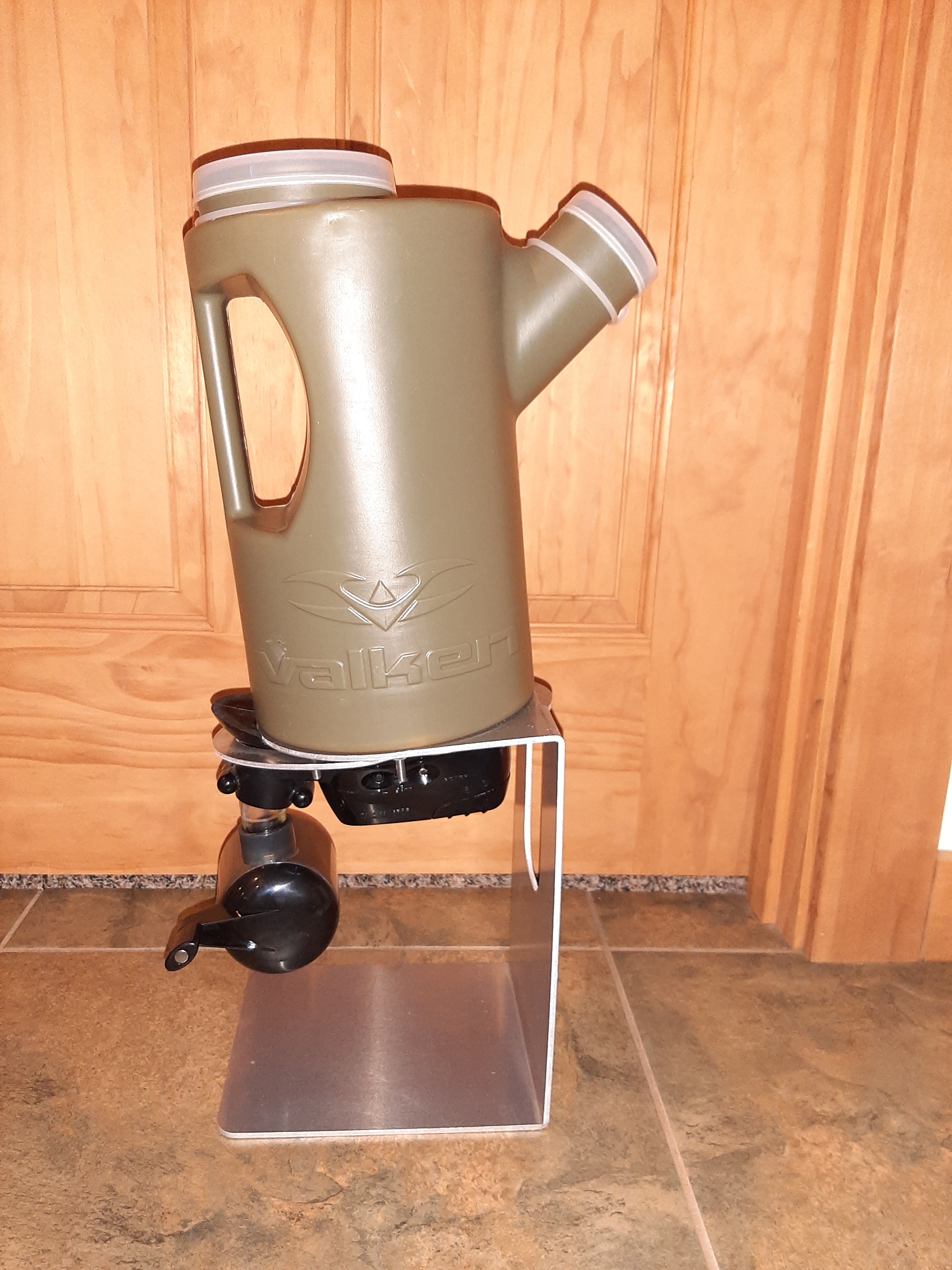

      Loading Q-Pods:
      Loading your q-pods requires some attention, but isn’t too difficult once you get the hang of it. The most important thing is to make sure your Q-pod is loaded without ANY gaps between balls. The manual states: “Avoid gaps between paintballs when reloading a q-pod. Gaps of more than one paintball may cause paintballs to break when the q-pod is feeding.” I disagree with the one gap is ok mentality. Remember the Qloader is a finicky system with many variables that all need to be right… with a little attention it is easy to eliminate the gaps and potential breakage issues they introduce. My advice is NOT EVEN ONE gap should be allowed.
      Now, how to do it…
      First off, don’t use the banana shaped loading "silo" thingy. Throw it away, use it to store your beanie baby collection, whatever… just don’t use it for loading pods! Seriously, don’t even try, you are wasting your time.
      Instead, grab a non-force feed electronic hopper like a revy or an egg or something else equivalent. Using electrical tape or some other means, adapt the loading socket onto the feed neck of your hopper. Put balls in hopper and wind them into the Q-pod. I use an egg, and it works really well for me. The feedneck on the egg is clear so I can watch the balls feed as I turn the handle on the loading socket. It is important to watch the movement of the balls as you turn the handle. If you are turning the handle and the balls stop moving, that means you are creating a gap inside the Q-pod, which means you need to stop and correct the problem. If you frequently encounter balls not wanting to feed smoothly while loading, look closely at your loading socket. You may need to do some light sanding to smooth the transition and prevent hangups.
      As you can see, I have the socket mounted directly on the feedneck. This works with the egg because I can see through the feed neck. If you have a revy or something else with an opaque feed neck, you will need to put a short length of hose between the feedneck and loading socket so you can see your balls. An even classier option would be to use a piece of clear acrylic tube to connect hopper and socket. I’ve been tempted to do this with my current setup just to give me a better view.
      The only downside of the hopper method is that you will need to refill the hopper after every pod you load. This is my somewhat extravagant solution to that…
      When you are getting started just use the hopper, it’s not that big of a deal to refill for every pod. Wait until you know whether you are going to stick with it before considering anything fancy here.
      Next important item. When you go to load an empty Q-pod, give it about a half turn before allowing paintballs to enter. Here is how I do this. Insert the empty Q-pod in the loading socket, but don’t twist it all the way to where paintballs would be able to enter. Give the handle of the loading socket about a half turn or so and then twist the Q-pod the rest of the way to where paintballs will begin to drop in.
      What can sometimes happen at the end of a Q-pod is the “paddles” at the top of the pod can stop with a paintball only partially pushed out of the pod. When this happens, you have a situation where you can chop the ball with the Q-pod when you twist to remove it. I’ve found that adding this half to full turn seems help to push the final couple paintballs out of the pod. It is not a %100 fix but seems to help. I have some other ideas I will be tinkering with that may eliminate this problem completely… more on that later.

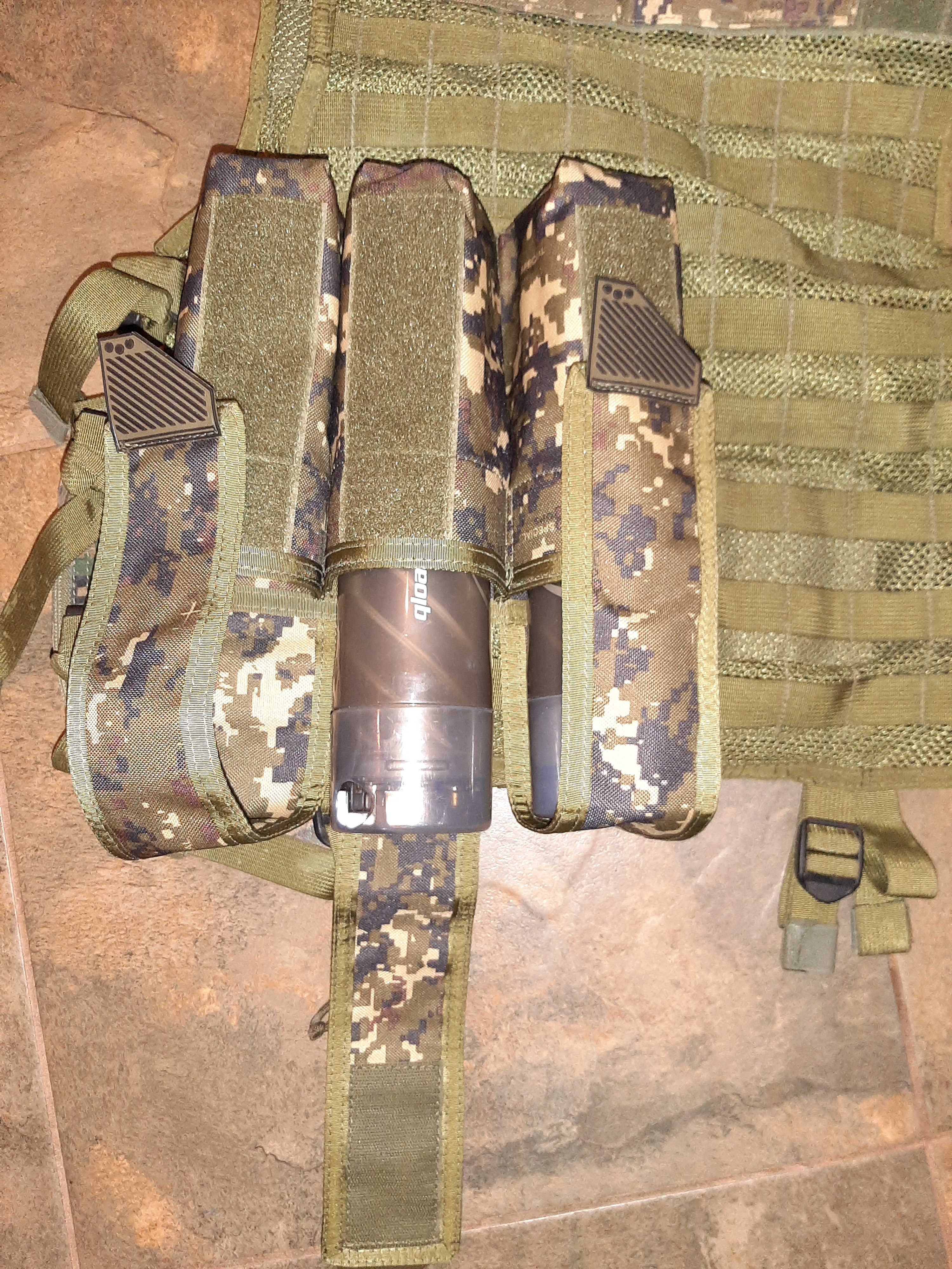

        Carrying Q-Pods:
        This can be a little tricky since the Q-pods are just slightly bigger than standard paintball pods. I’ve found they are a too-tight fit in most standard pod packs. There was actually a Qloader branded pod pack they sold for these. There are several pod packs recommended in the PBN thread, however most of those are long gone. I use a molle tactical vest with pod pouches from Special Ops Paintball… which does not appear to be around anymore. Finding these pod pouches on the used market might be a viable option.
        If anyone knows of a currently available pod pack that fits the Q-pods nicely, please post and I will add your recommendations here…

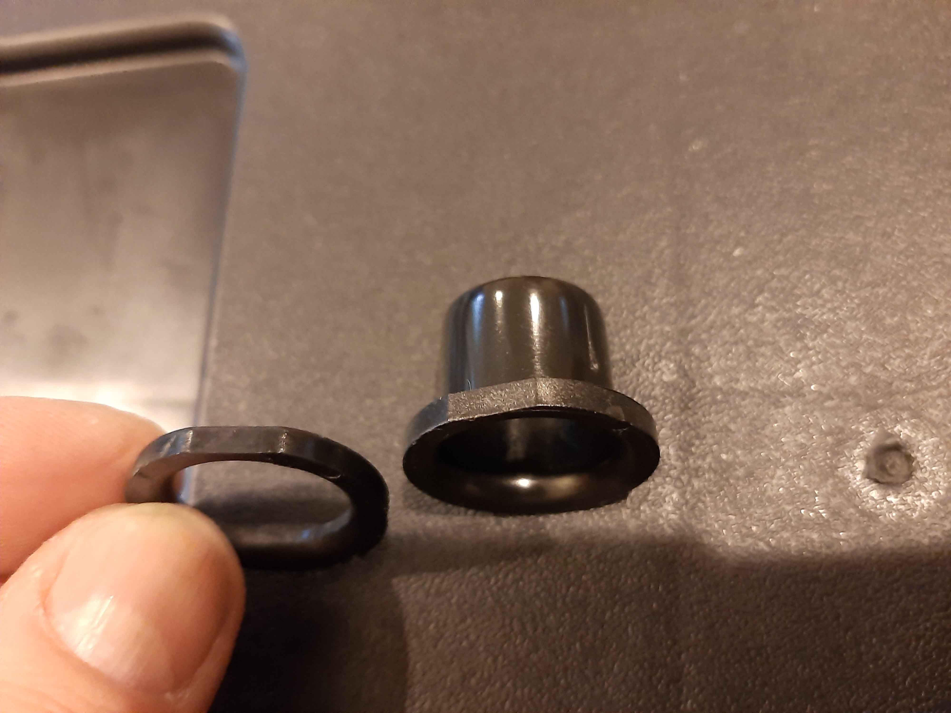

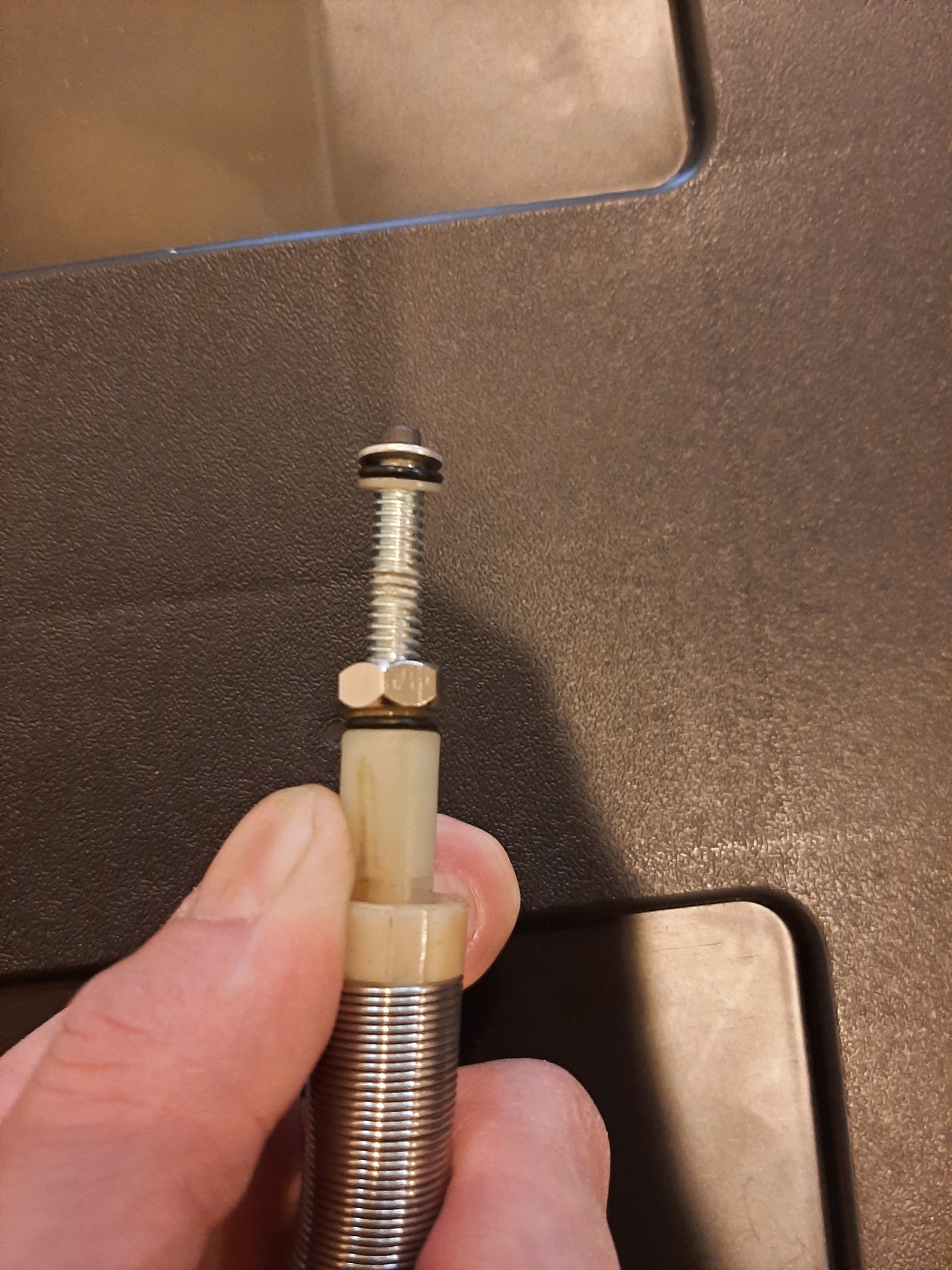

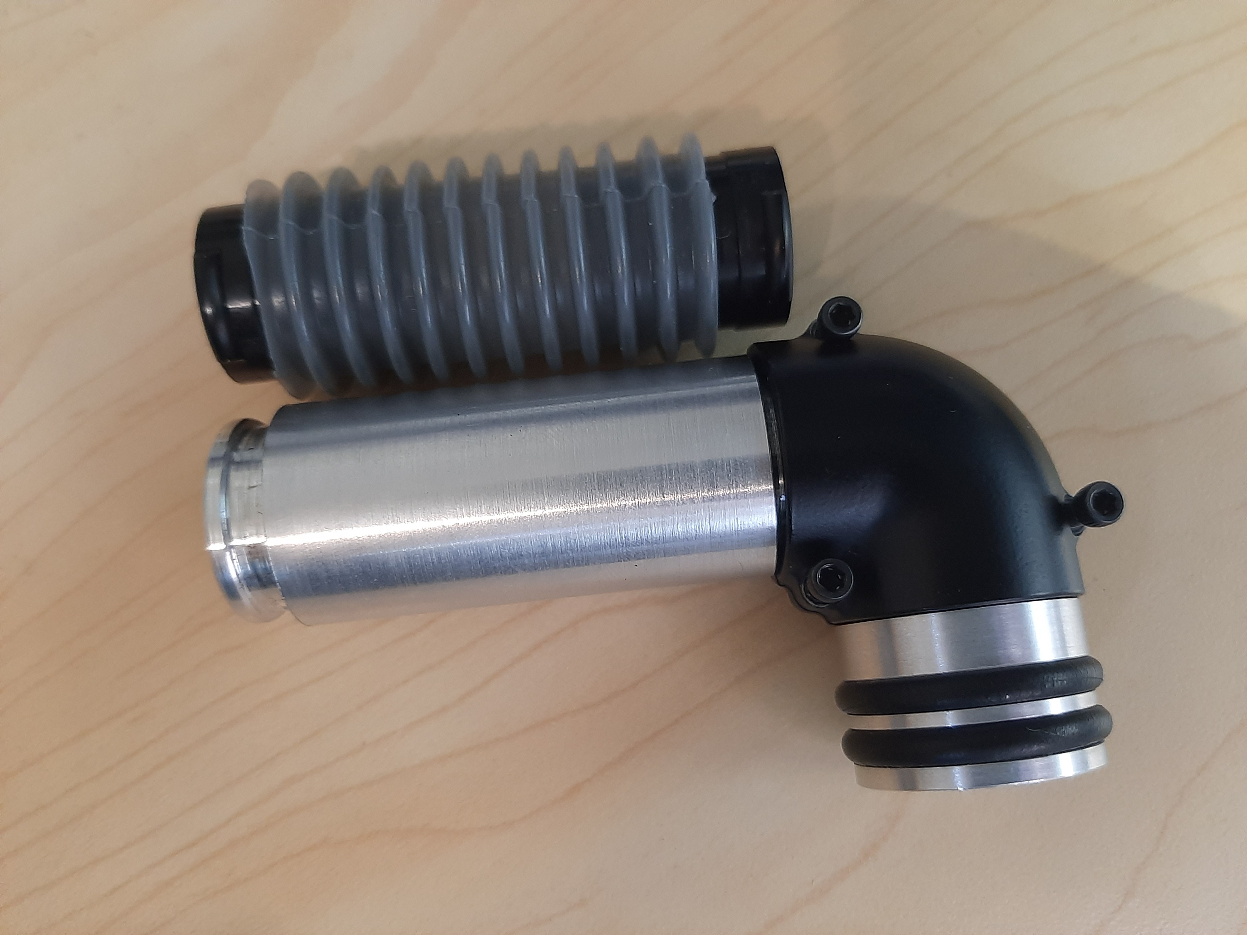

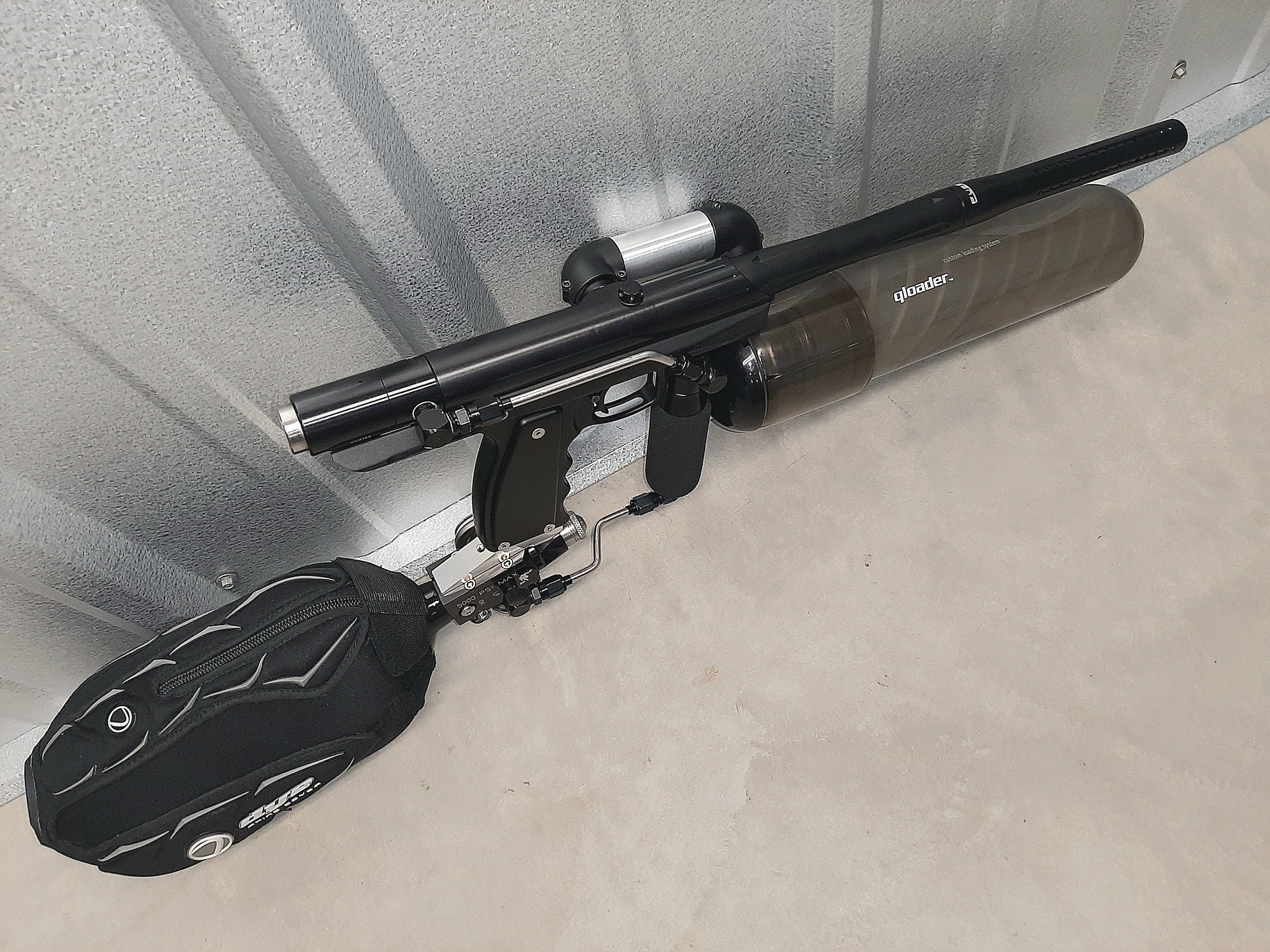

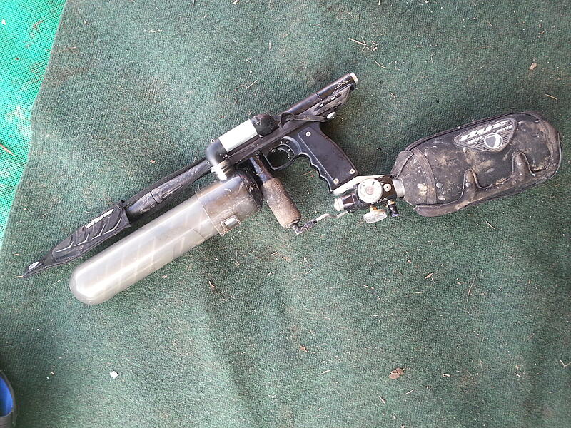

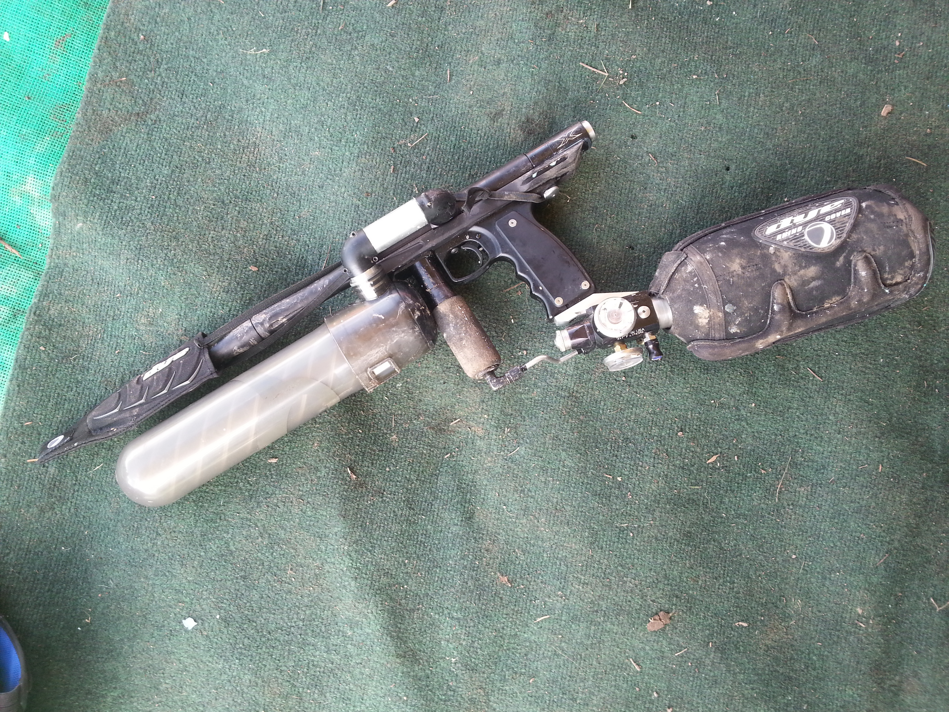

          Now for the particulars on my Q-Mag. I machined an adapter that fits the socket and made up an aluminum feed tube. The Qloader socket is their Custom Mounting Socket (CMS). The elbows and feedneck adapter are factory Qloader accessories. I’ll go through all the parts in detail now because I have modified every single one of them.
          SOCKET:
          Here’s the modified socket (bottom) & an un-modified one (top):
          The little black “top hat” piece that holds the feed valve spring in has been modified to make room for my socket adapter. Cut the protruding tube portion off so you are left with the bottom “washer” part. This will now press into the socket and hold the feed valve spring in place just like it did before.

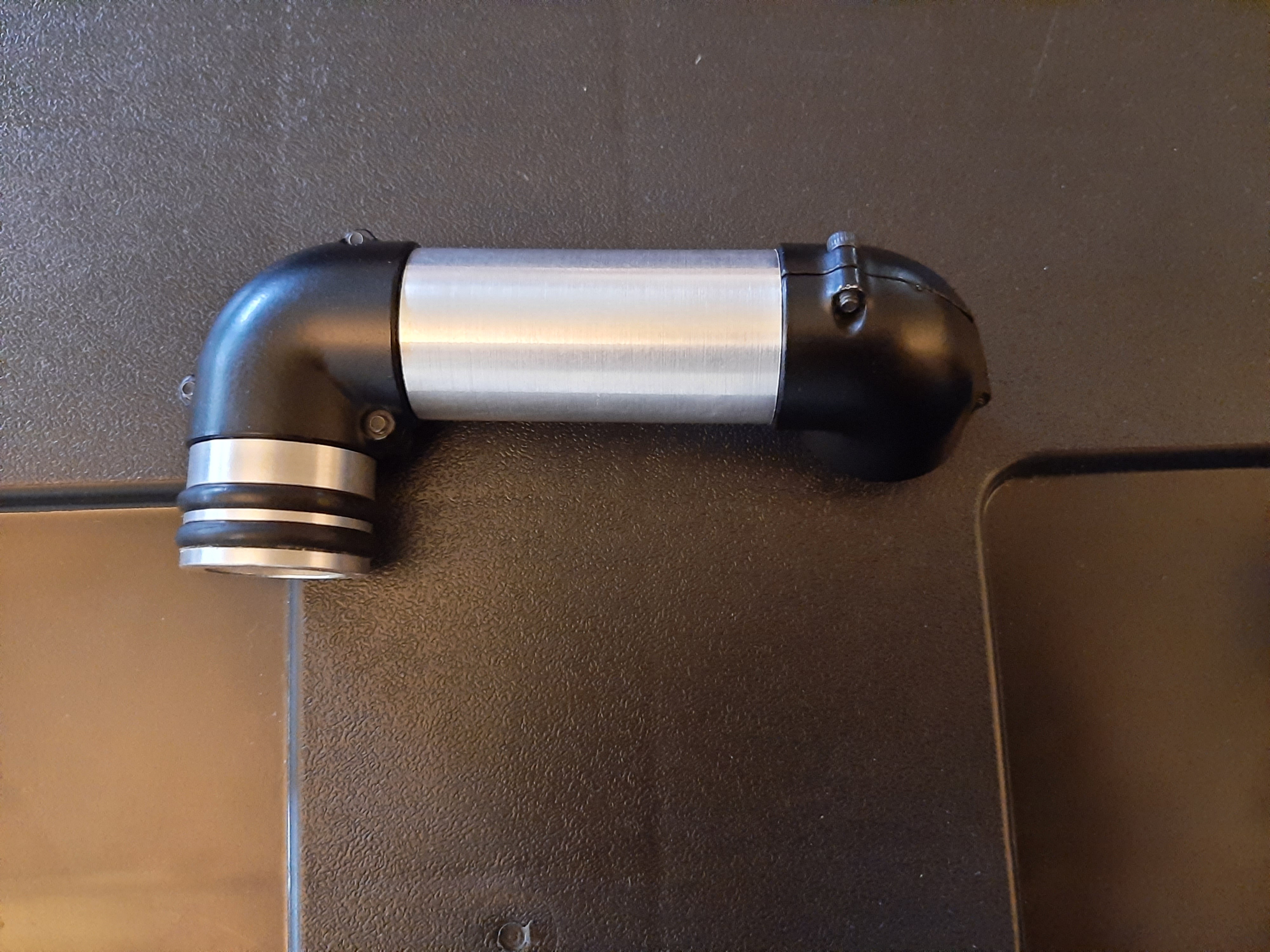

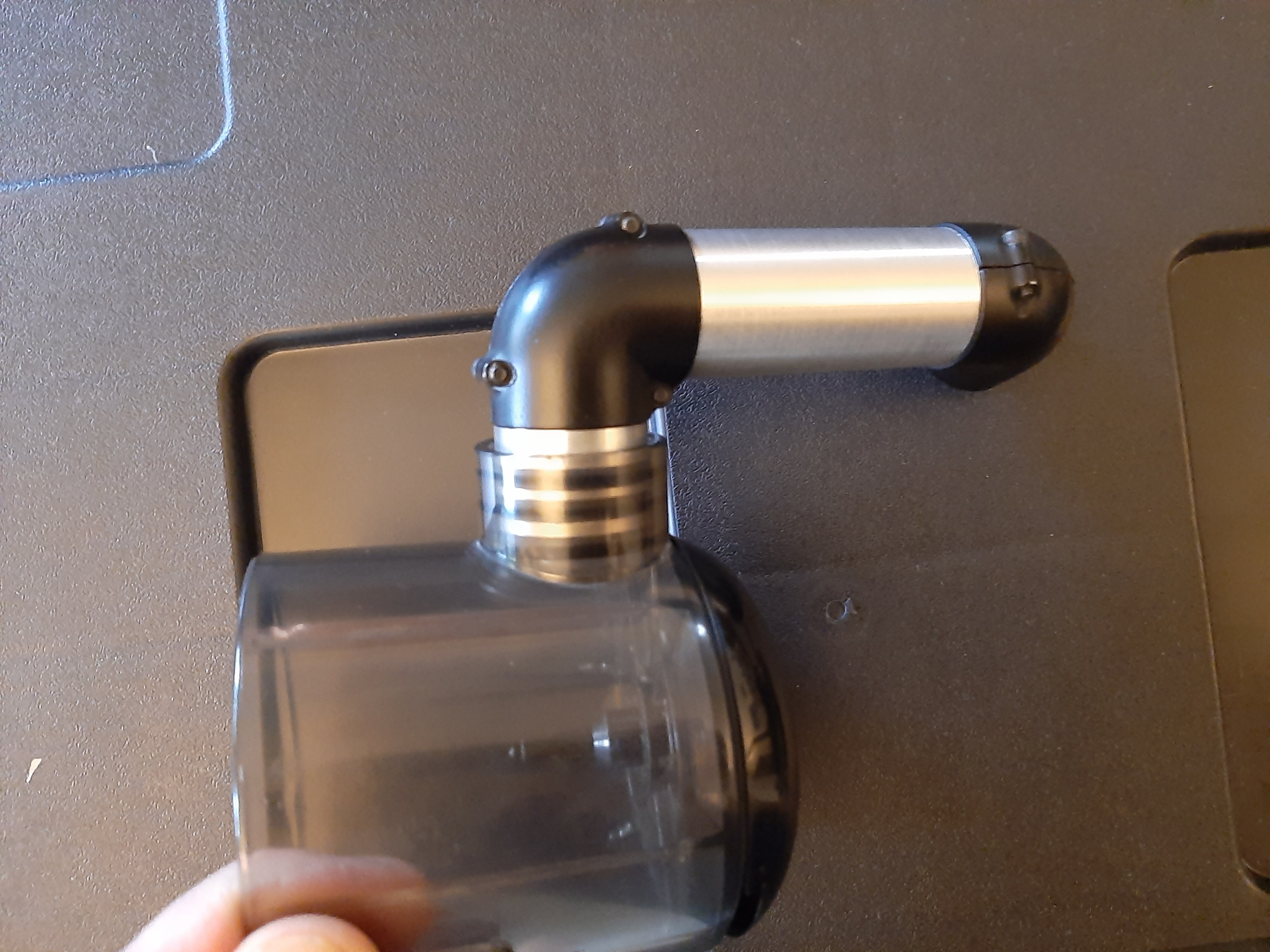

          Socket Adapter & Feed Tube:
          Here’s my feed tube assembly:
          The socket adapter is friction fit into the socket. The two O-rings hold it securely. I have an earlier version of this socket adapter that used only one O-ring which did not quite hold well enough.
          There’s nothing remarkable about the adapter & tube. They are made to fit the elbows & be the right length to fit a whole number of balls between the breech & socket. To determine the right length for the tube, I used a couple of the “quick release hose adapters” to make up a short hose & adjusted until it was the right length. Then I measured it & made the aluminum tube to match.
          If anyone wants dimensions on the socket adapter & tube just let me know. I’d be happy to post them.

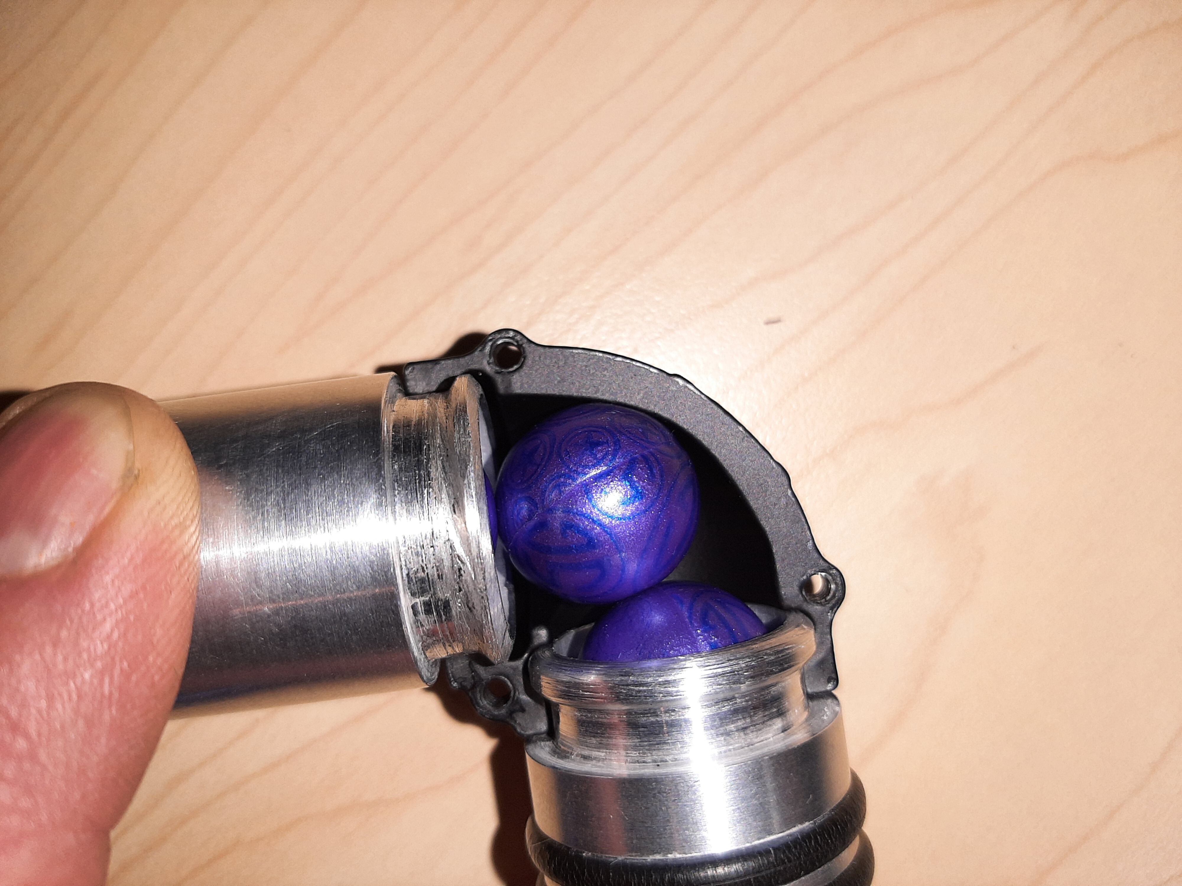

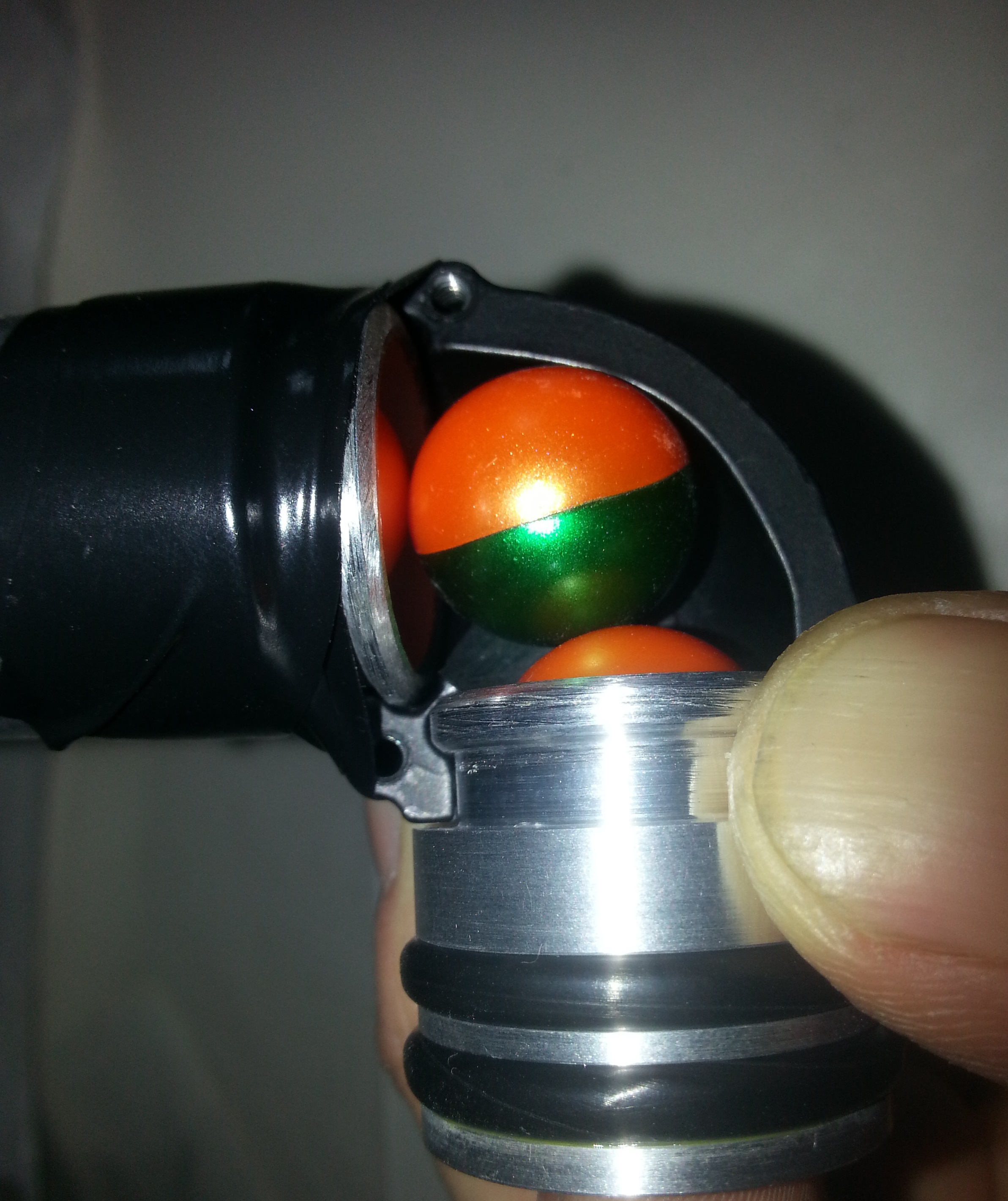

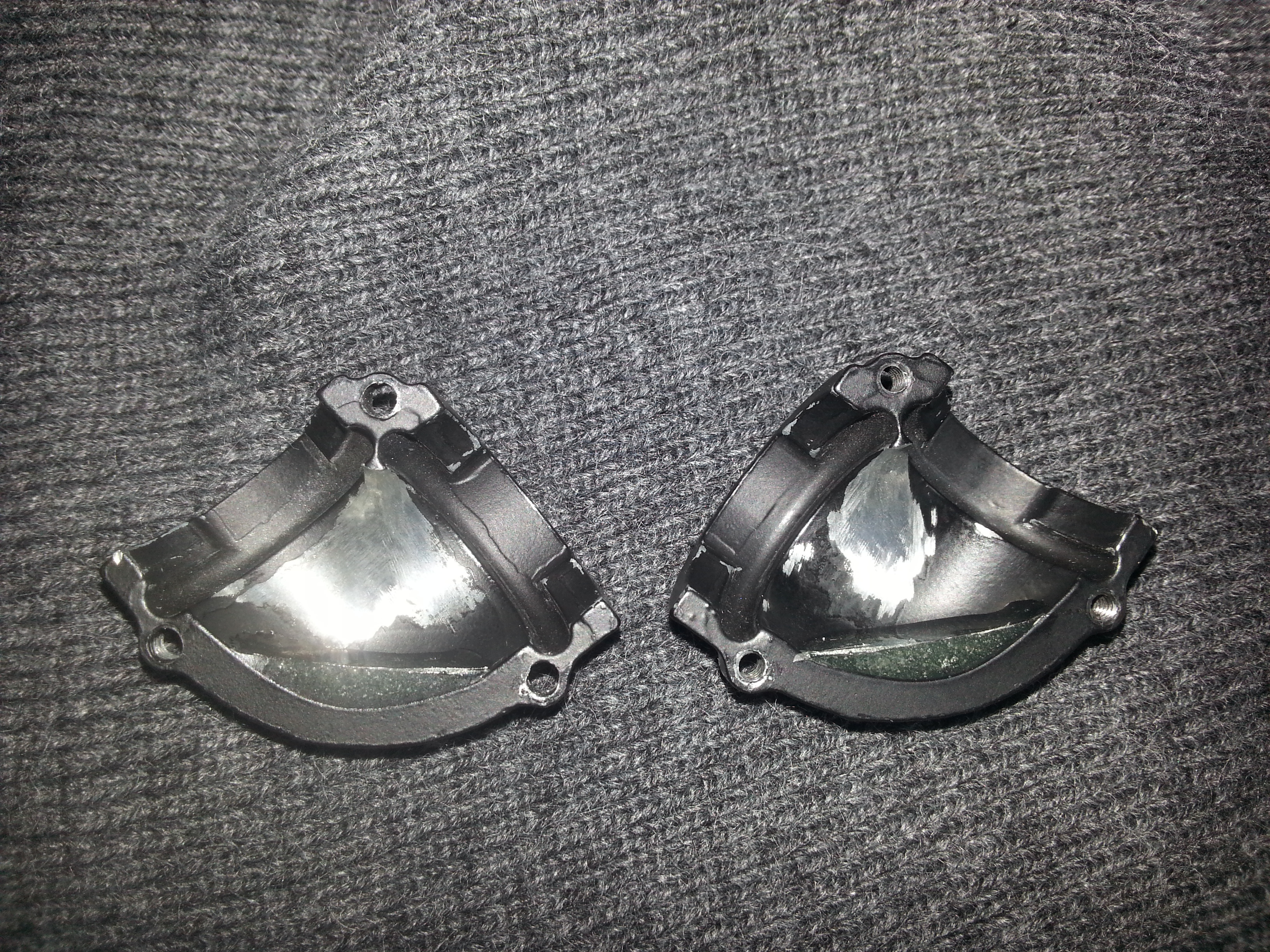

            ELBOWS:

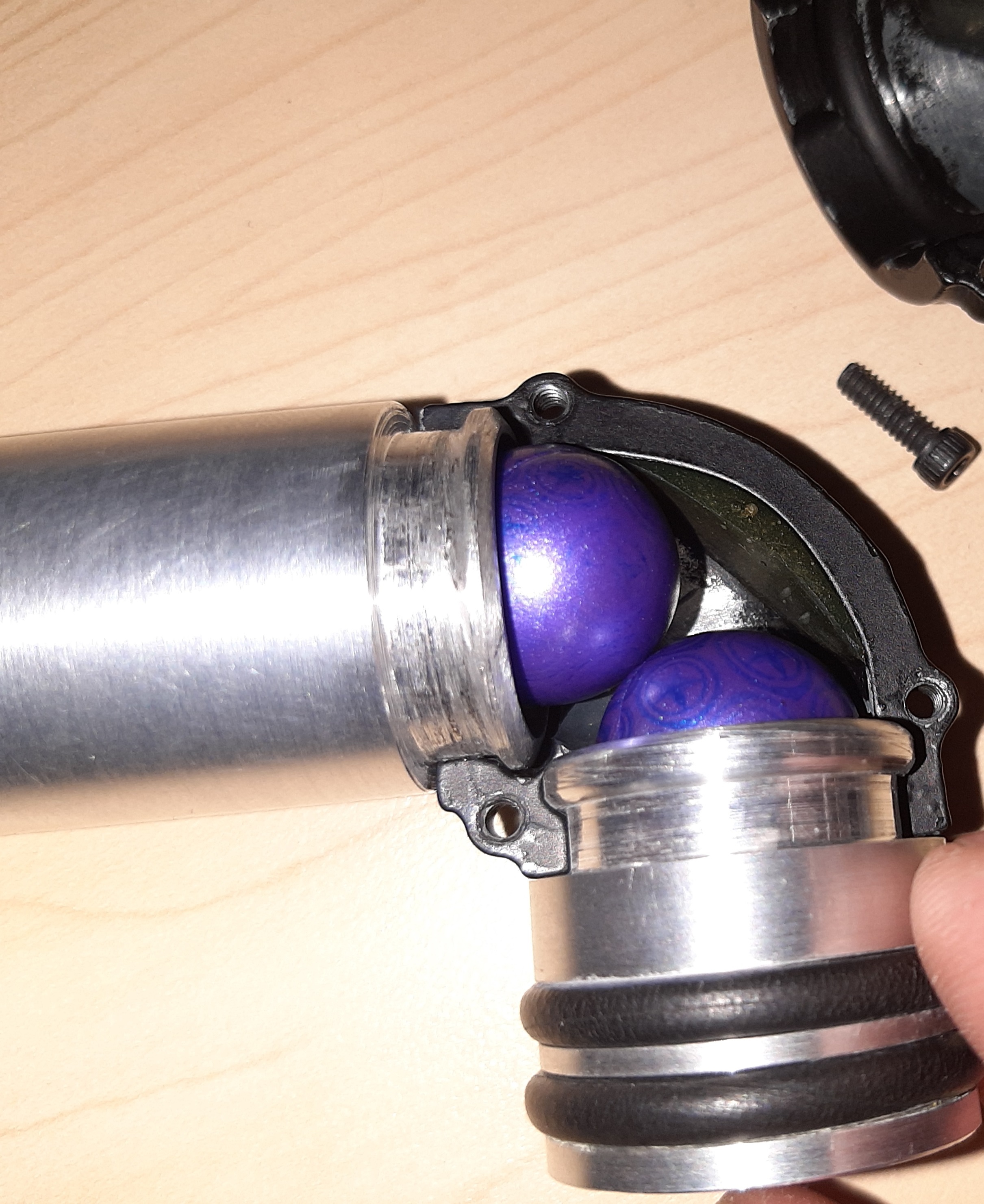

            Now the elbows… these are an accessory that was offered back when Qloaders were a thing.
            When I first put this together it did not feed well at all. It was massively disappointing. I’d get a couple shots then it wouldn’t feed, I’d whack the side of the gun and get a couple more shots before it stopped again. I jacked the pre-winds up which helped at first but caused other issues. With the ball stack pressure now being so high, the paint would turn oval inside the feed tube. Since the balls were getting squeezed smaller in one direction, my feed tube was now the “wrong” length and I chopped balls in the socket when I would reload on the field. Not to mention lots of barrel breaks too.
            Turns out the culprit was these damn elbows. They were trying to turn the corner too tight and the paint was jamming up. These just weren’t a great design from start. The good news is that they are fixable.
            If you look at the standard Qloader plastic elbow you’ll see they are not quite 90°. It’s like they recognized that trying to turn a sharp 90° was an issue, but forgot when they designed these low profile elbows. My first attempt to remedy this was to smooth out the inside corner with a Dremel. This didn’t help much on its own. You can see below how the paint is still hitting the outside wall of the elbow almost straight on.

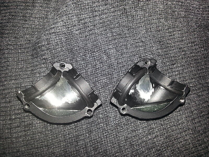

            The real game changer here was modifying the shape of that outside curve inside the elbow. I accomplished that by pouring some epoxy into the outside radius of the elbows. To keep the epoxy from gluing both halves of the elbows together I used a piece of electrical tape to create a parting line. Just screw the elbows together with a piece of tape sandwiched between, secure them somehow so the outside radius is down, and pour a little epoxy in each side.
            Once the epoxy cured I tuned it up a little with the Dremel by adding a slight radius down the center (where the two halves meet). By filling the outside radius and removing material from the inside corner, I was able to re-shape things so the balls are sort of cutting the corner inside the elbow end never meet a wall head on. This worked wonders, I was able to drop the pre-winds way down, and the whole system started functioning much better.

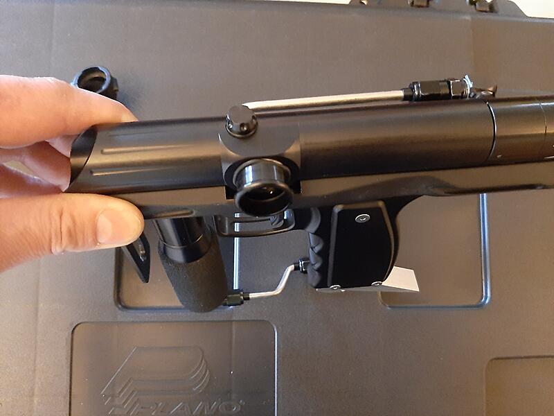

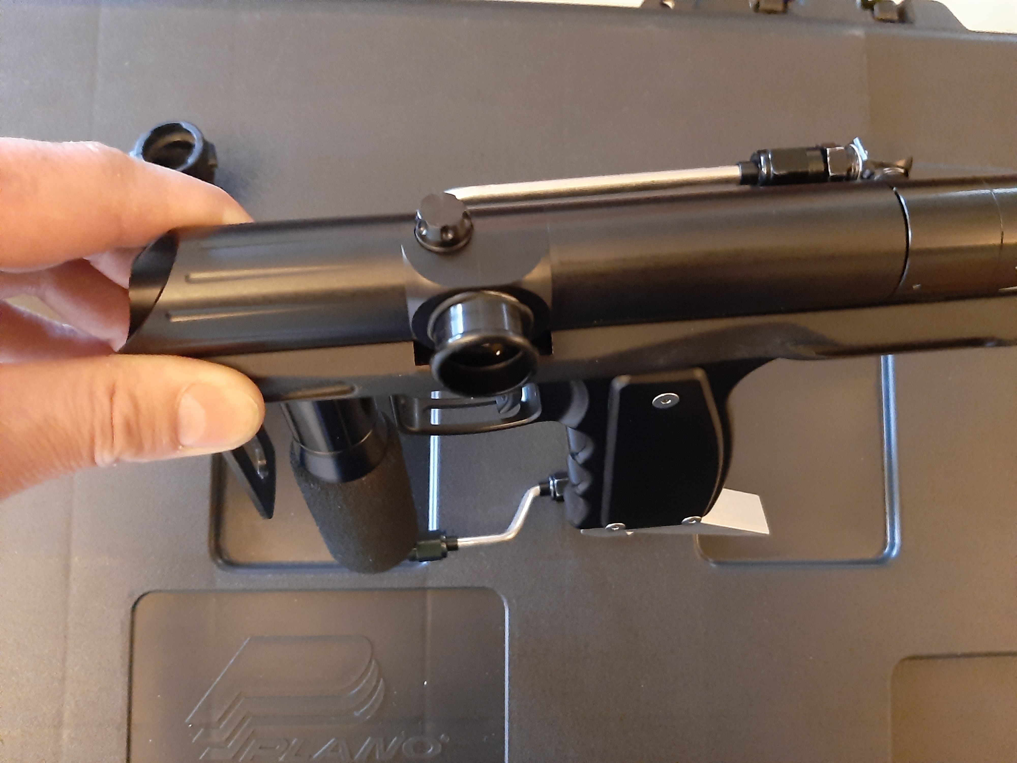

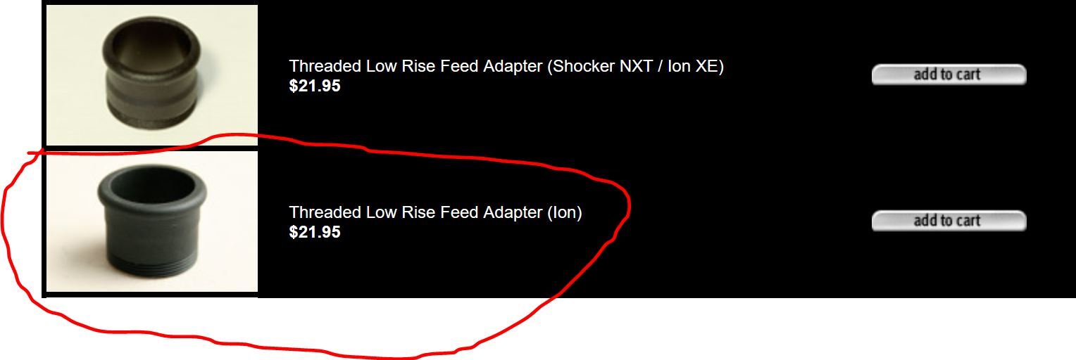

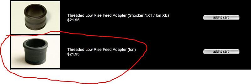

              Feedneck:
              Now for the feedneck part that screws into the warp body. This is another Qloader factory accessory that was available back in the day. The one shown here I bought off their website a long time ago. This is one of those parts I wish I had bought a few of when they were available. If anyone has one I (and one other person I know of) may be interested in purchasing it.
              It can be a little tricky to get the right part here because there were two different versions that were often confused. They had the Shocker NXT/ION XE adapter and then the regular ION adapter. The one you want is the regular ION adapter. Here they are on the Qloader site courtesy of the Wayback Machine…
              Notice how the NXT/ION XE part is a little fatter at the threads. This is because it is a larger thread (7/8”-32), and it does not fit in the Mag body. The Automag bodies are Angel threaded (M21x0.75mm), and technically the ION threads are different (13/16”-32). However, when you convert the metric units you’ll see they are so close they may as well be identical for this application.
              The one you want does not fatten up at the threads. I’ve seen listings for the NXT/ION XE one that have the picture of the regular ION adapter in the listing. So it can be a little bit of a crap shoot, be careful.
              This is where the next problem crops up. Once I started really playing with this setup, I found I would often shoot a Q-pod empty and continue to shoot through most of the paint sitting in my feed tube before I noticed the pod was empty. The paint just tended to keep rolling into the breech as I moved. Now I stuff in a new Q-pod and the paint zips through my mostly empty feed tube and creates an unholy mess in my marker.
              To fix this, I modified the feedneck to accept an O-ring “detent” that prevents the paint from rolling freely into the breech, but is light enough that the Qloader can easily push past it. I cut two opposing slots in the feedneck using a thin cutoff wheel on the Dremel and snapped an O-ring around so it protruded in through the slots like this.
              The slots should be cut so that the inside edge of the slot is flush with the outside of the Mag body. In other words, with the feedneck screwed all the way in, the O-ring should be right up against the body.
              Now, how not to do it… When I was first trying things to fix this issue I had cut just one slot. I started shallow and slowly worked deeper to find the point where the O-ring was deep enough to do its job. The problem was that by the time I had the O-ring deep enough, it stuck too far in and it would occasionally get folded over the edge of the slot by the incoming paintball and create a jam in the feed tube. I ended up filling in the ends of the too deep slot with epoxy to bring it back to where it is today.
