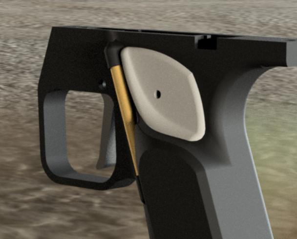

              #36
              Small grip panel for the left side.

                #37
                It's basically done. Grip panels installed, leaks all sealed up, and I was able to get the cocking rod blocker to work.
                The interesting thing about the cocking rod blocker - I ended up press-fitting the white piece into the back block, and making it about 3/16" short, which gave the cocking rod 3/16" of float. this was because if I directly affixed the cocking rod to the back block, it was not allowing the bolt to go all the way back. Not sure if this is a cocker thing, and I'm probably describing it terribly. This also helped solve the problem I was having earlier, that the hammer wasn't fully actuating the valve.
                Anyway, I shot one ball in the garage, and it works!
