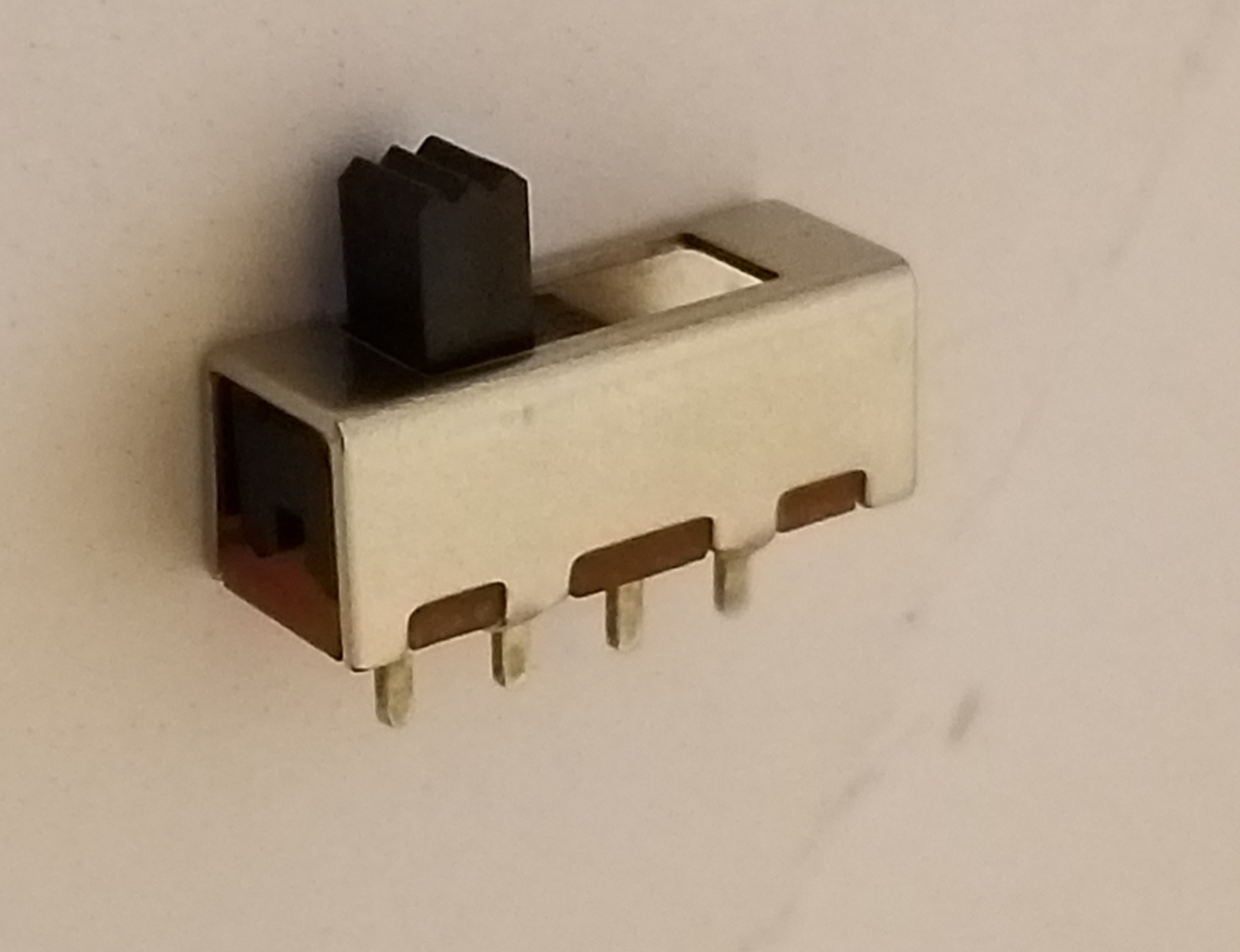

    Yea the grip frame will be printed
    Found a switch in a parts bin in the garage that I'm gonna try to add in as the power switch.

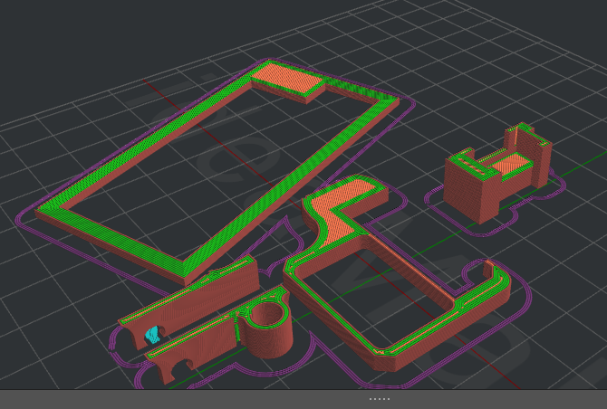

        And also printing several small test sections to make sure I've got the fit right for various pieces.

          #19
          And everything fits! I know this was probably an unnecessary step, but it gives me peace of mind that when I do the full print, everything should fit nicely.
          A couple tweaks, and then ready to print the final grip frame.
