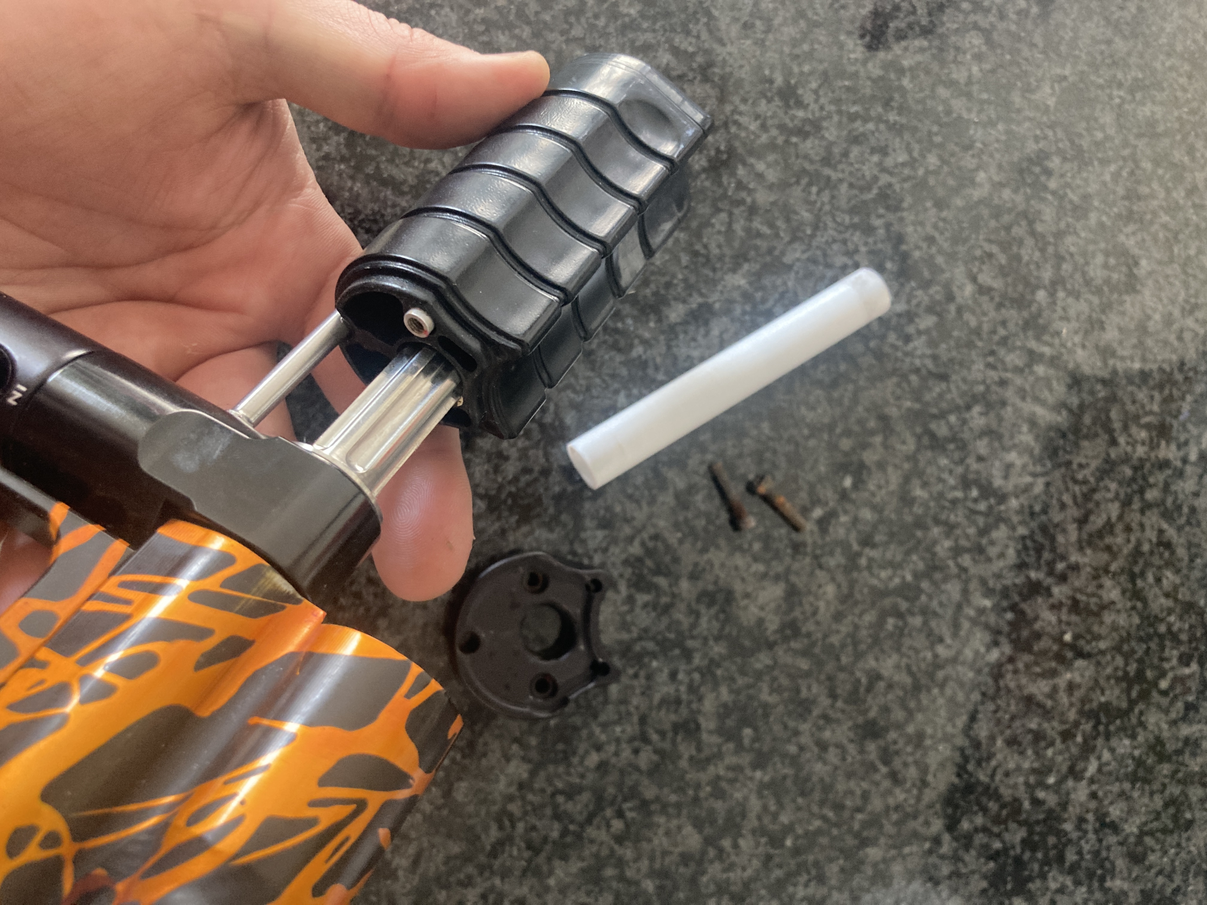

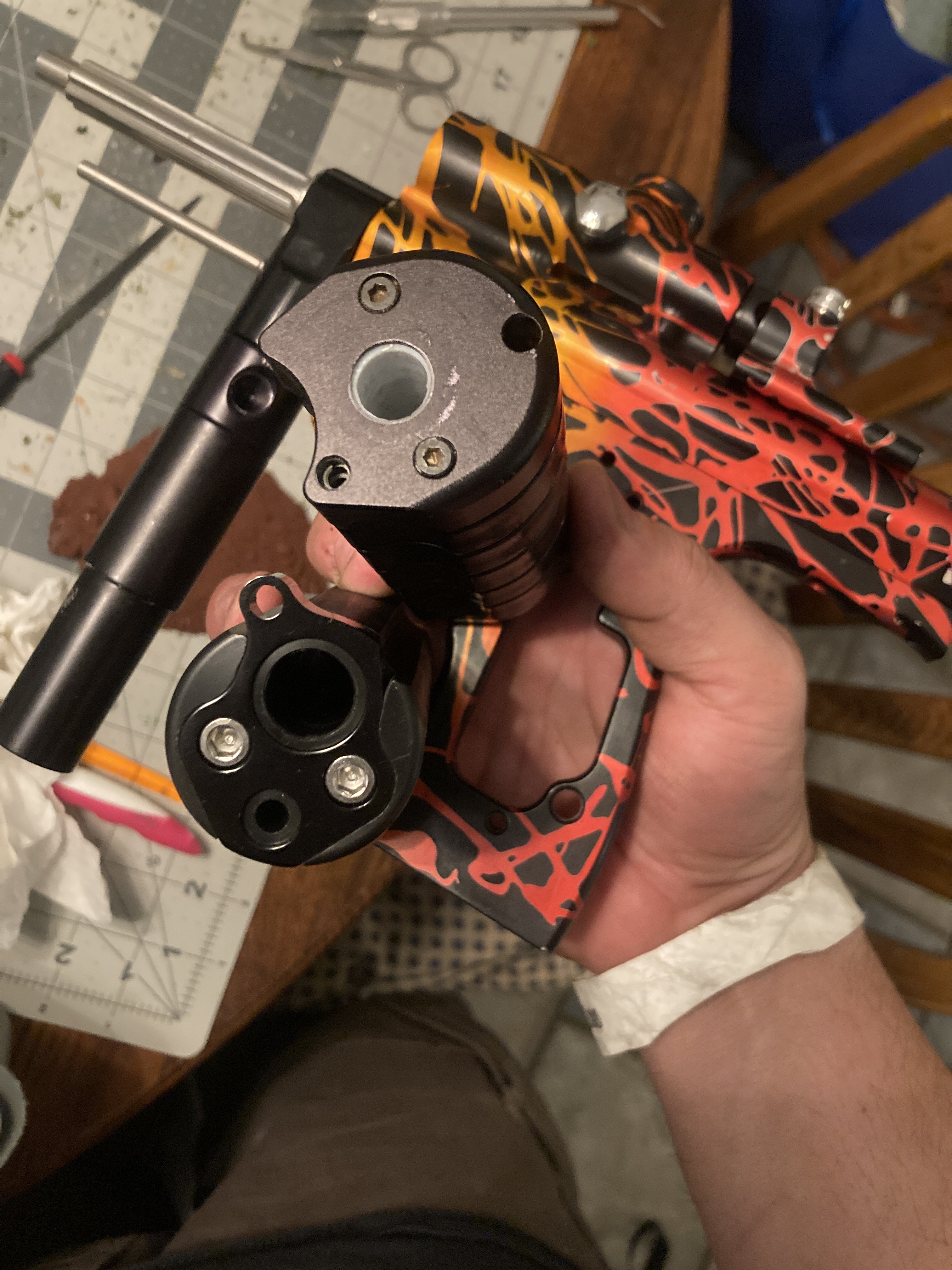

      SLiCEPTiON!
      love the slice kit. love the vendetta kit but the handle is juuuuust not my flavor and theres not really any other options
      acp hasnt had a mini kit in stock for a long time, soooooo.....
      this was very easy, only main guide hole on the back plate needs enlarged, and the insert sleeve removed. can finally finish this one off

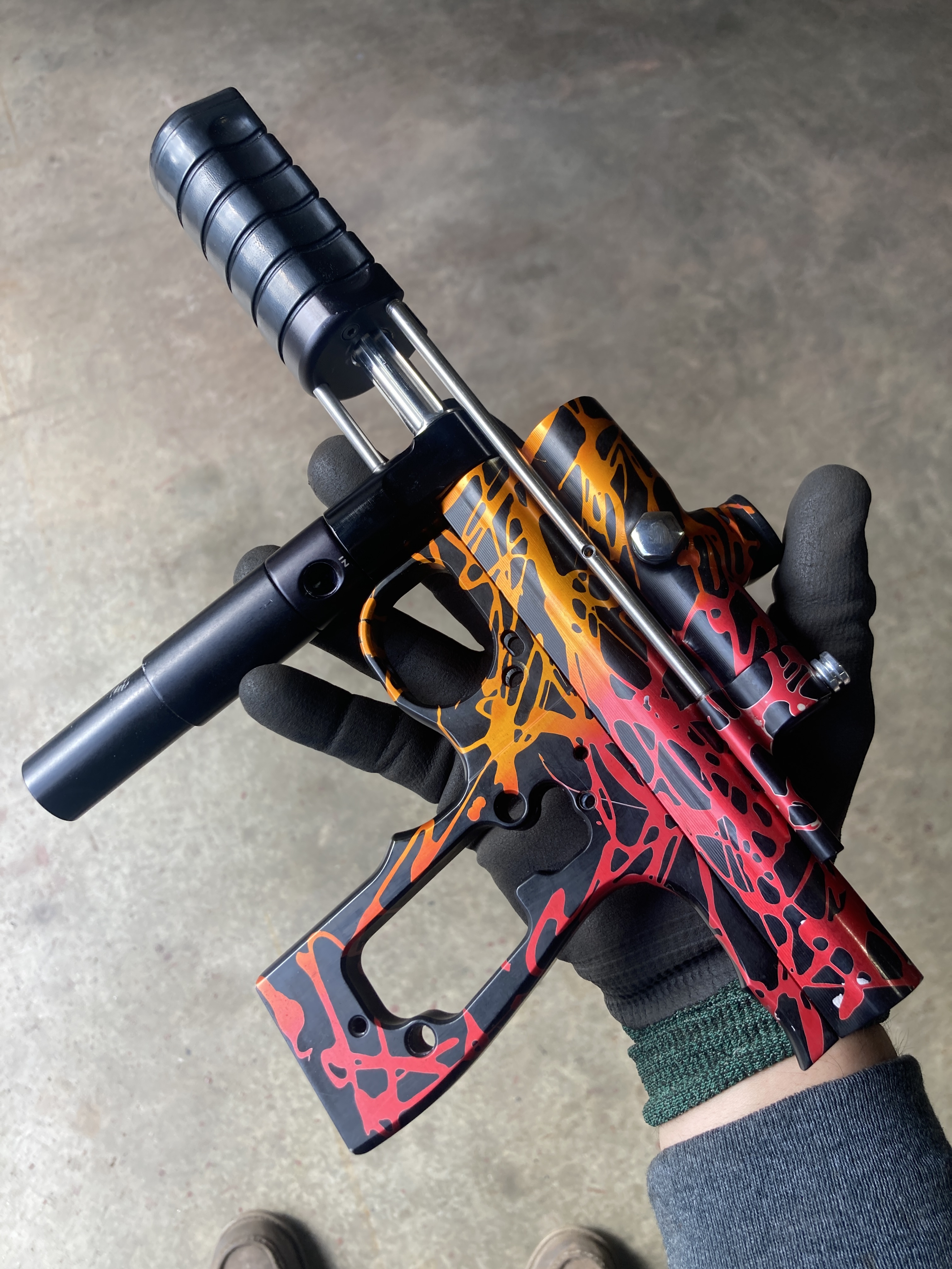

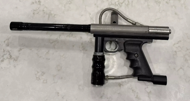

          I've had this PMI stock kicking around for a while so I decided to mod it to accept an HPA tank.
          (I really wanted to run tank rings of some kind like an old-school setup, but alas, that's beyond my capabilities.)

            looks like youd have to pull the macro out of the reg and remove one of the drop rail mounting screws and loosen the other to make that happen.
            but theres not really any reason to.
            Jordan commented
            I'd need to pull the ASA off to unthread the tank, if I needed to remove it for some reason.
            I don't plan on running anything else on it.

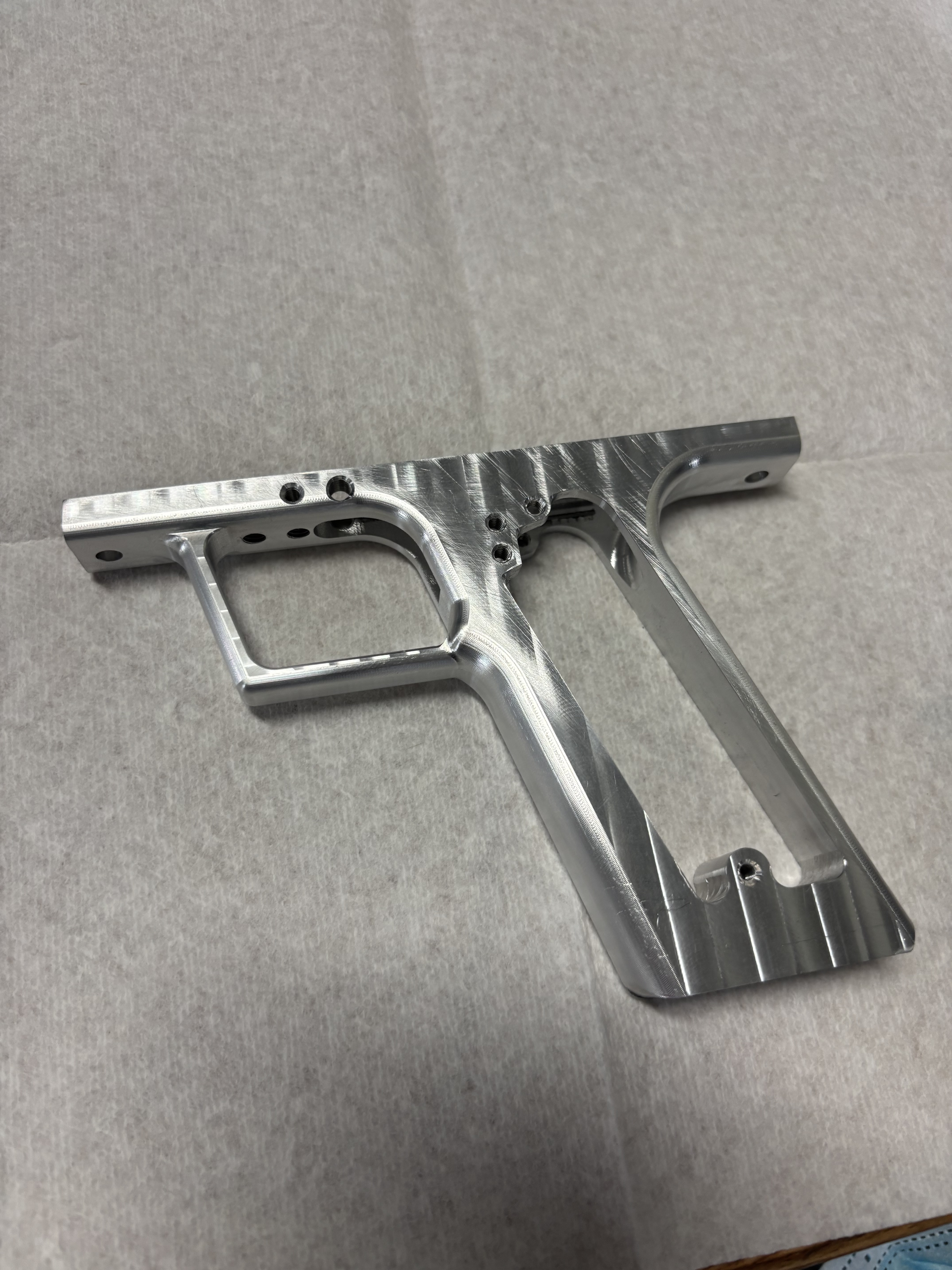

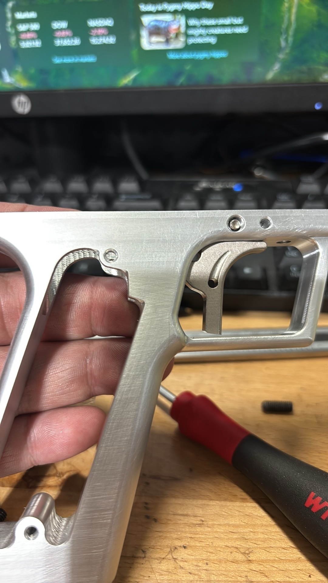

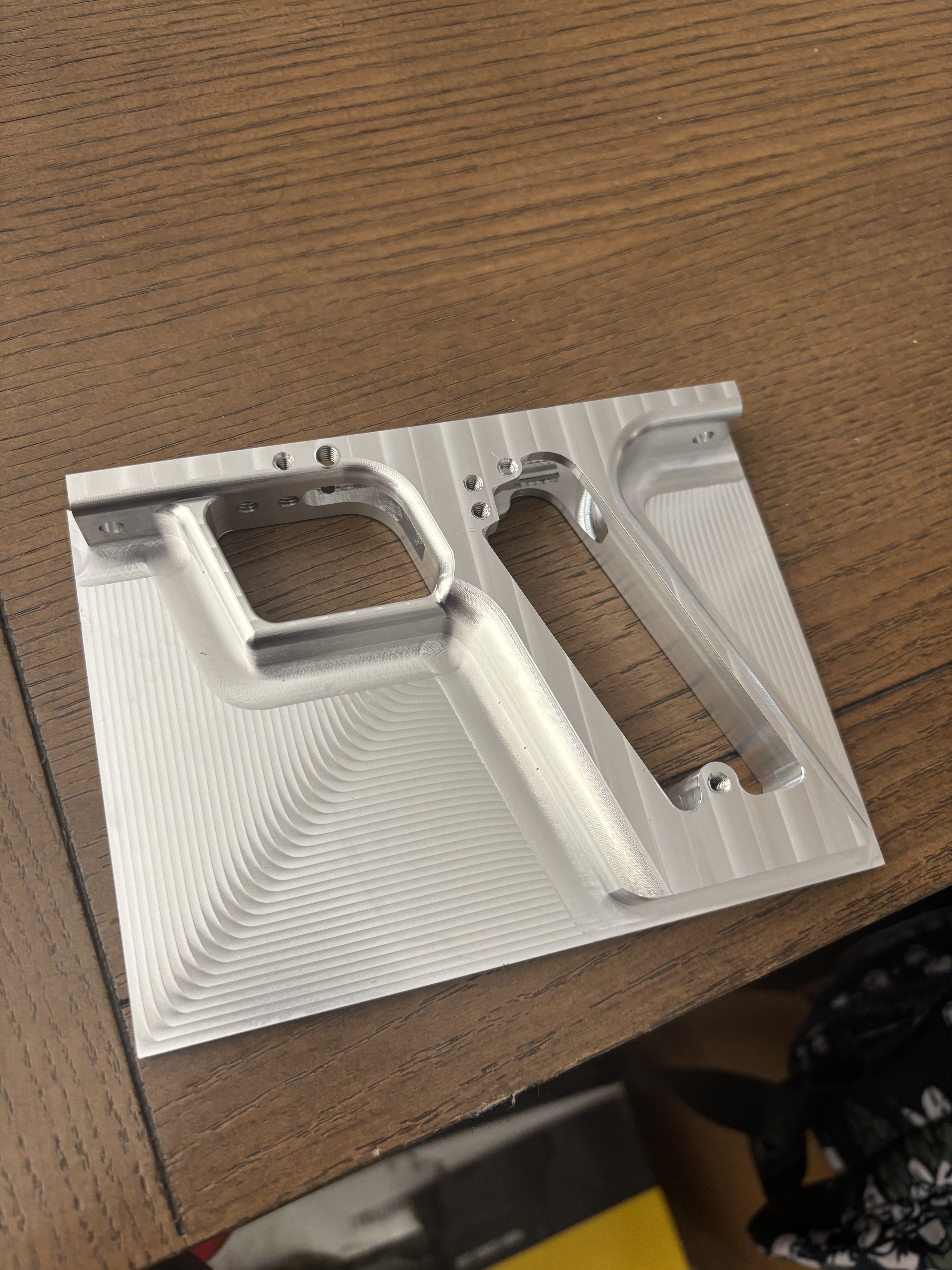

ID:	679784 finished my frame and added a SUPER fancy trigger, lol

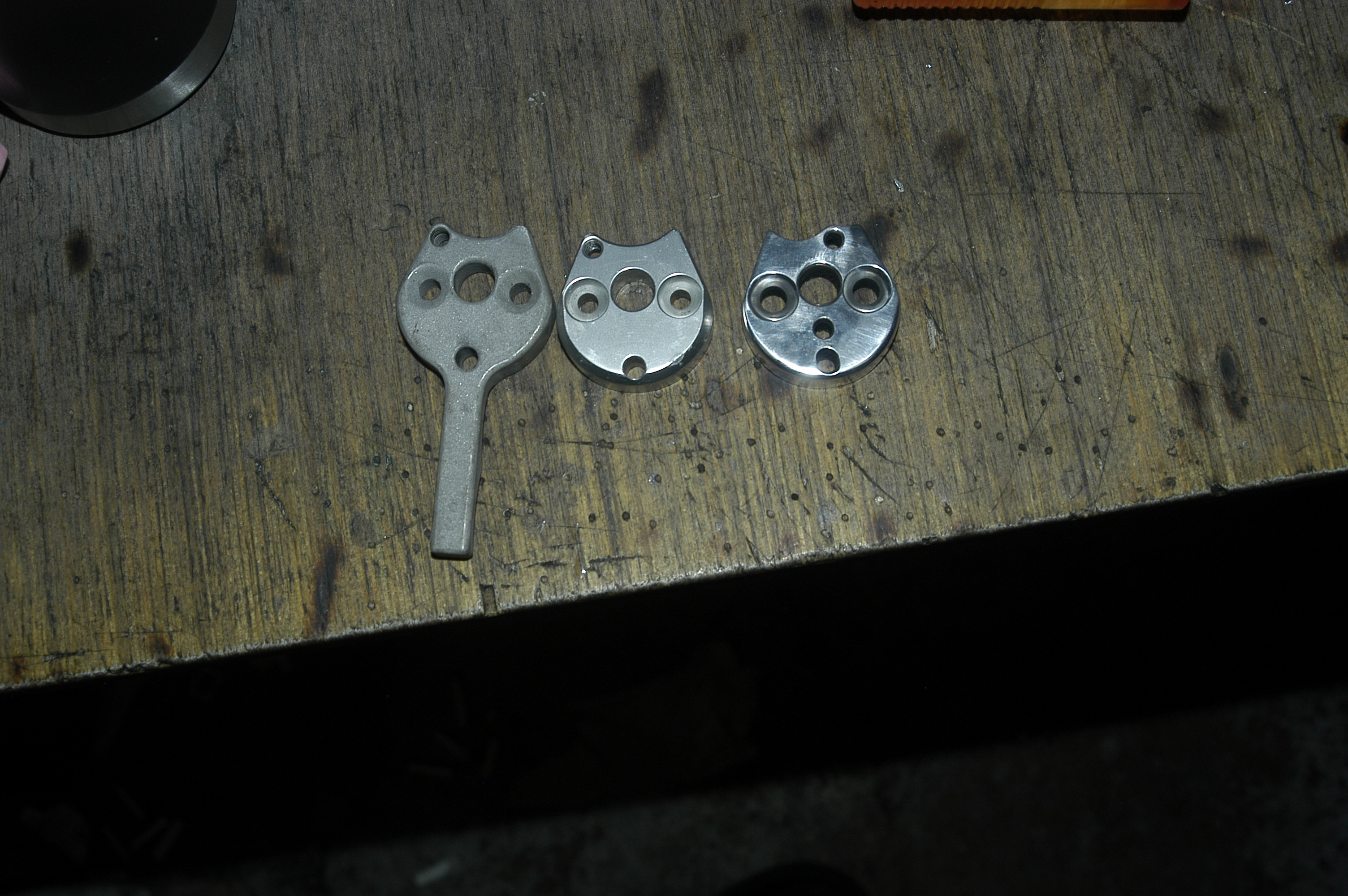

          Not nearly as cool as the previous post, but I made a custom K-frame trigger.
          Ion Long Rifle
          Spyder Pump
          BST Feedback
          Brass Thread
          - - YouTube - -
            Make me one of those in brassssssssssss!
          • JeeperCreeper
            JeeperCreeper commented
            I plan on making some real soon
          • Impactfour
            Impactfour commented
            Put me on that list as well! My mission to make the whole marker brass is nearly complete

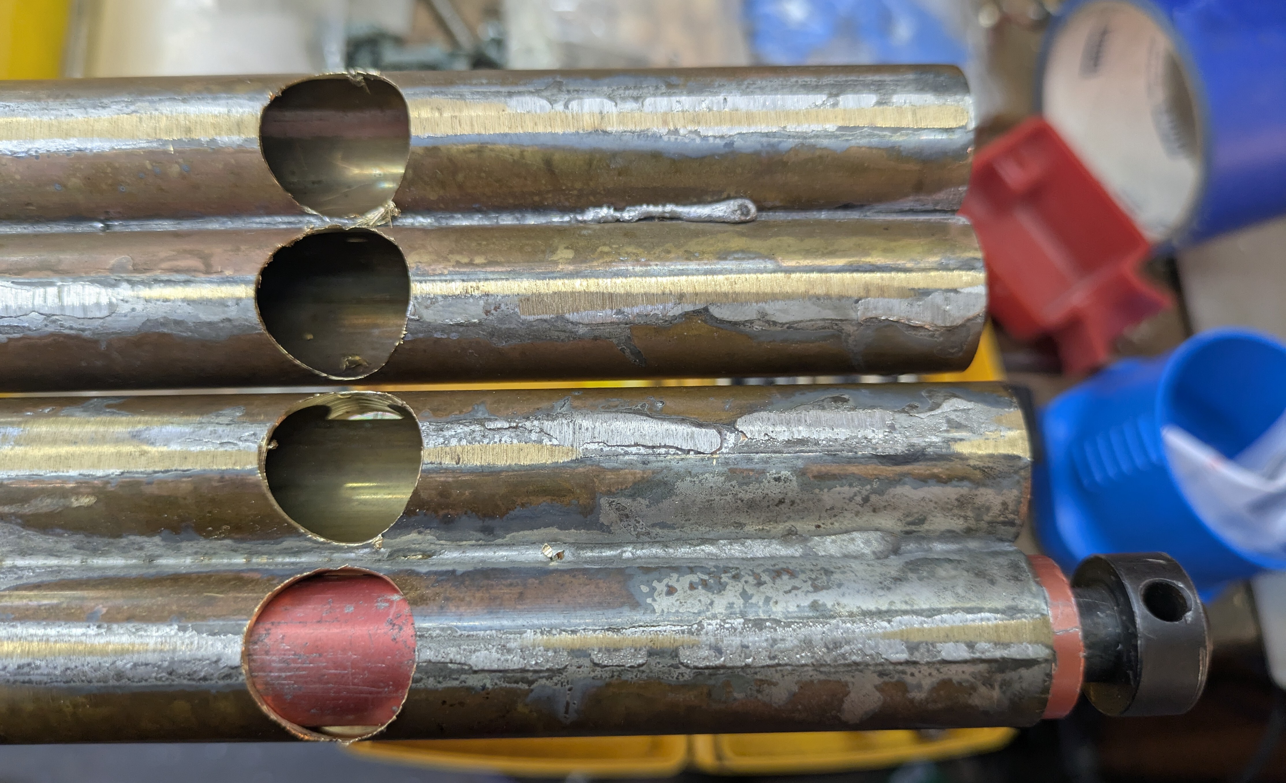

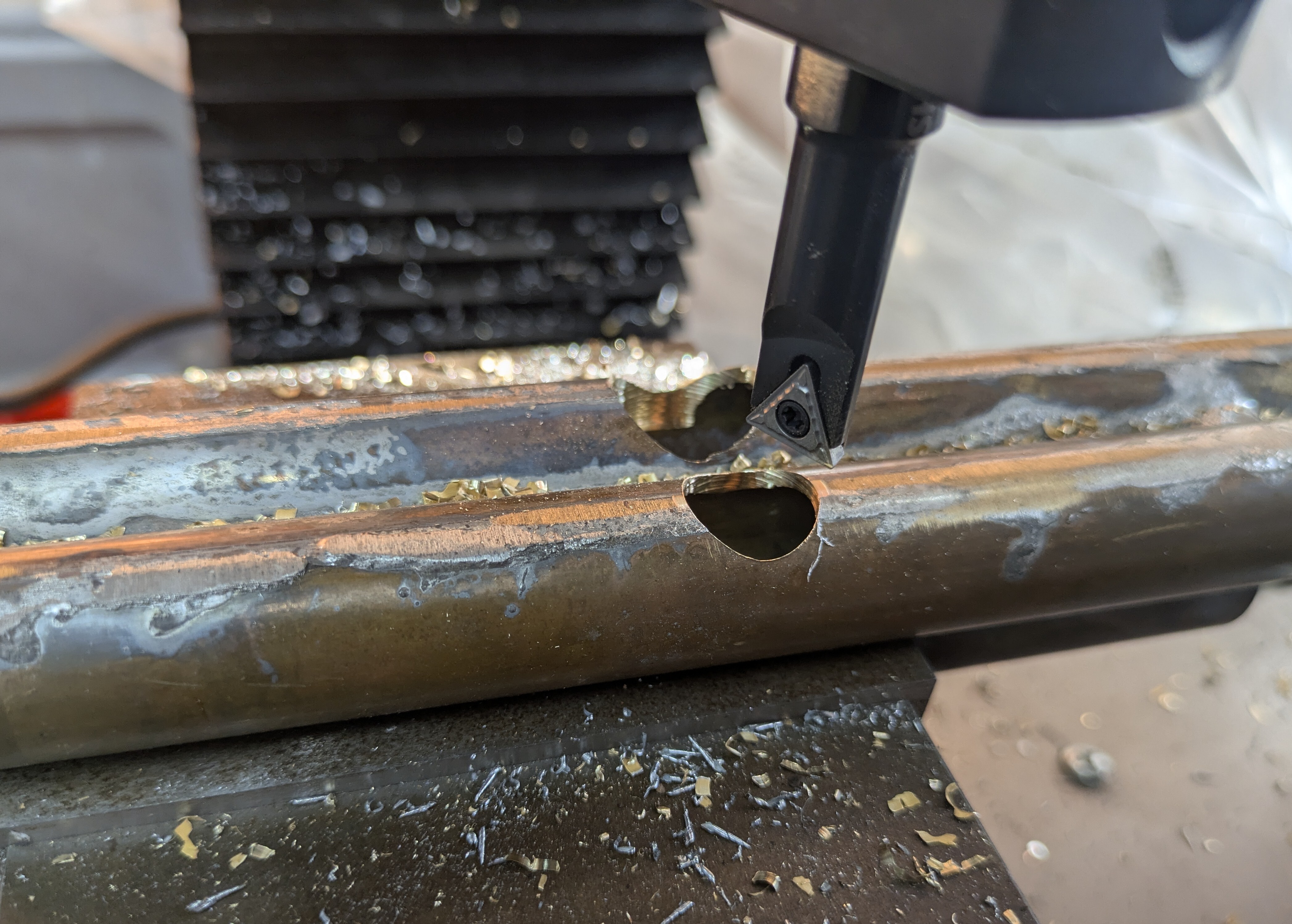

          After too many fuck up and repairs, I finally make progress on Big Bertha 🥳
          That project might actually hit the field ... maybe ... One day 😅
            XEMON commented
            Double stock class 😁
            The Sheridan valve doesn't have quite enough volume to handle more than 2 barrels ...
          • Meleager7
            Meleager7 commented
            dat illuminati drill bit.......it pleases me
          • JeeperCreeper
            Makes me want to start my 4 barrel build

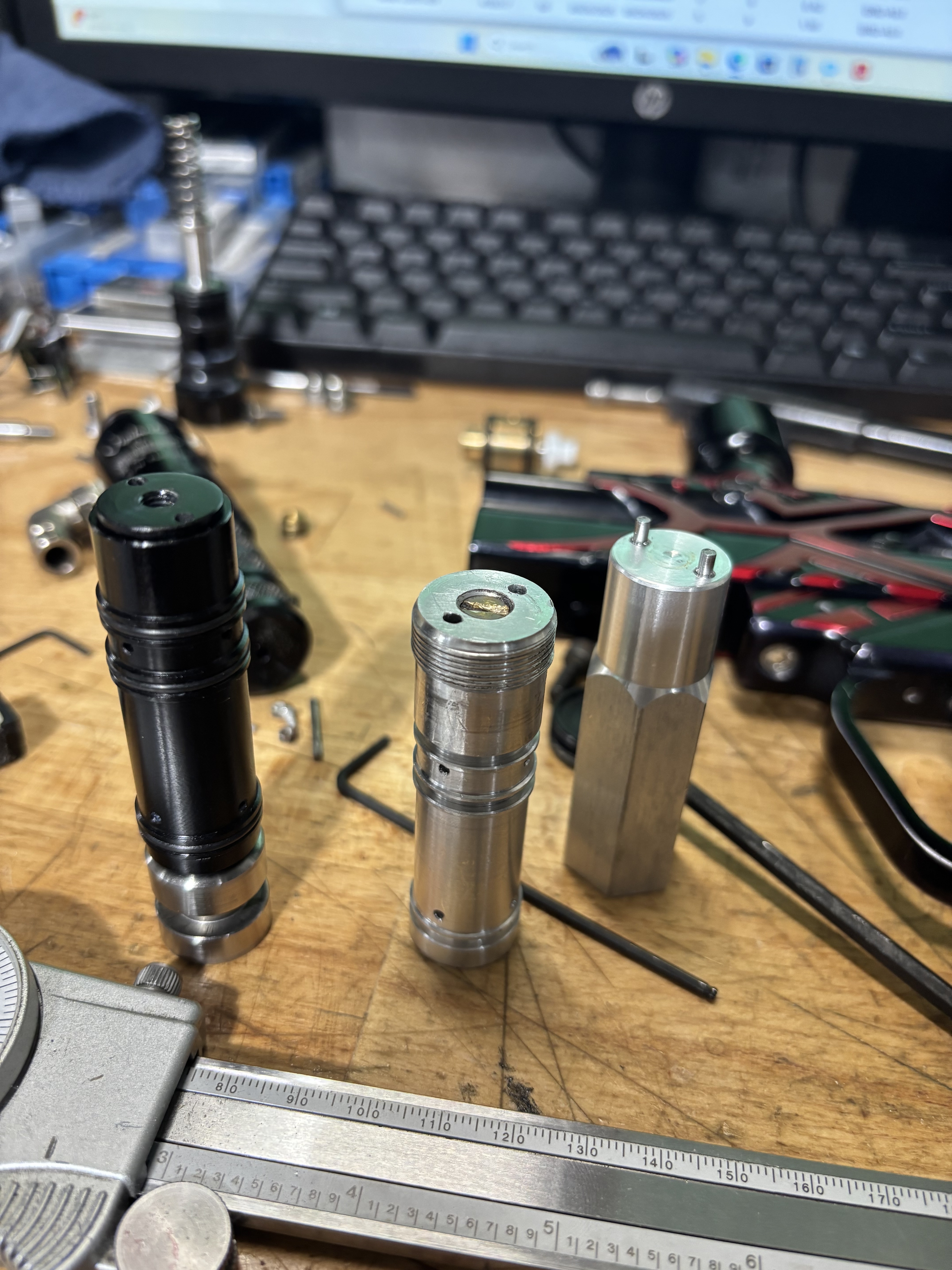

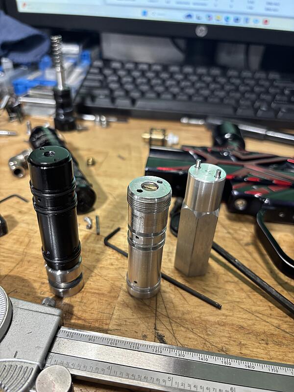

              God I love being a machinist…. I bought a tribal addicted and plan to get it running, well I go to take out the ram so I can rebuild it and it won’t budge. First I tried my two Allen key trick (what works for a vast majority of these older markers).. after that failed miserably I decided to make myself a disassembly tool… easy enough to start with hex bar aluminum, turned down the neck so it will fit in the pocket and drilled two holes. Then turned down some hardened pins and pressed them into the body… total time 20-30 minutes and now I have a rebuild tool
              As it turns out, the ram was green loctited into the body

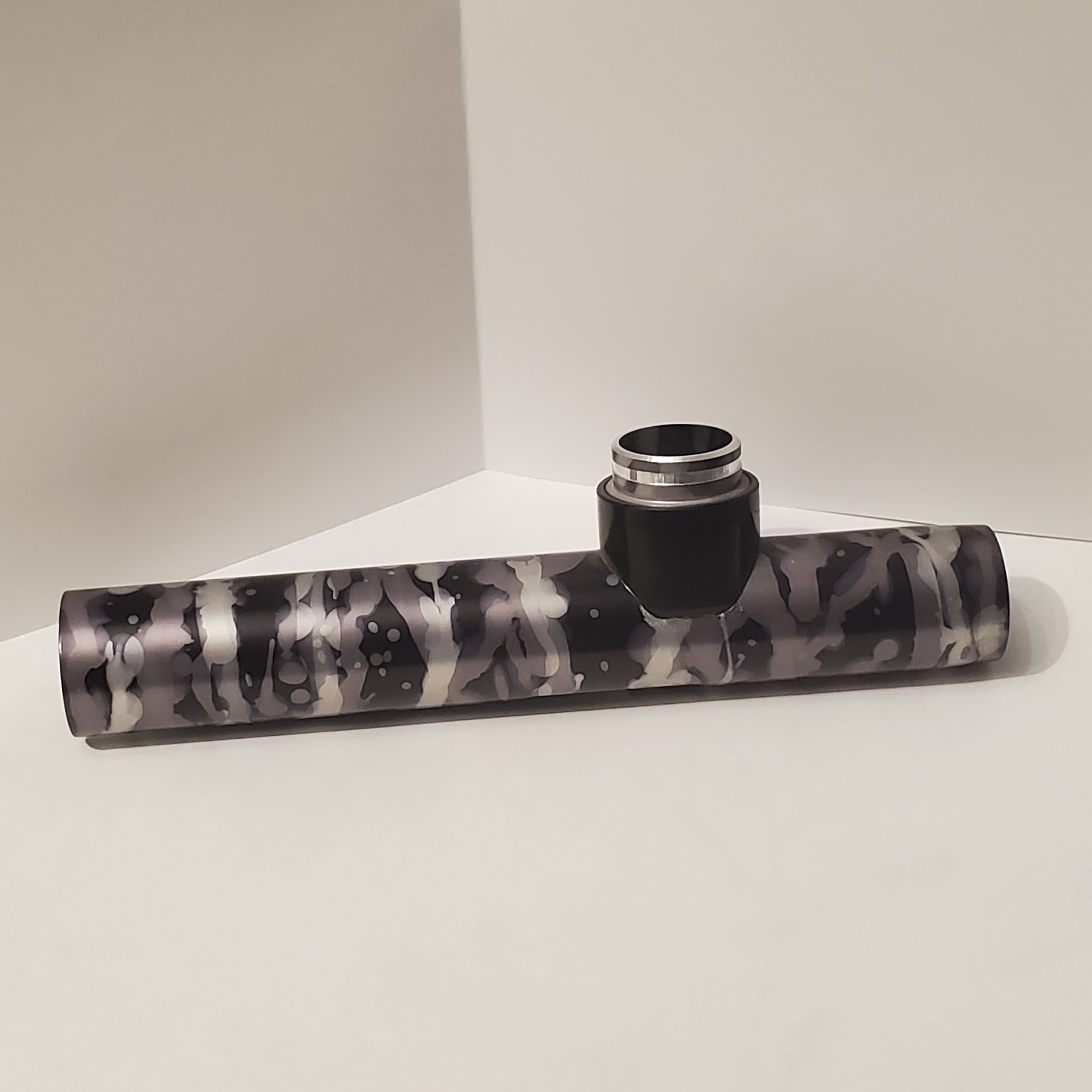

ID:	735374 A few days ago, but I empire-modded a Phantom. Super skinny feedneck so I'm debating shrink- fitting a little extra meat on there to keep the neck from rotating.
                All because I couldn't find a straight elbo... er, hopper adapter. (Is it still called an elbow if it's straight?)

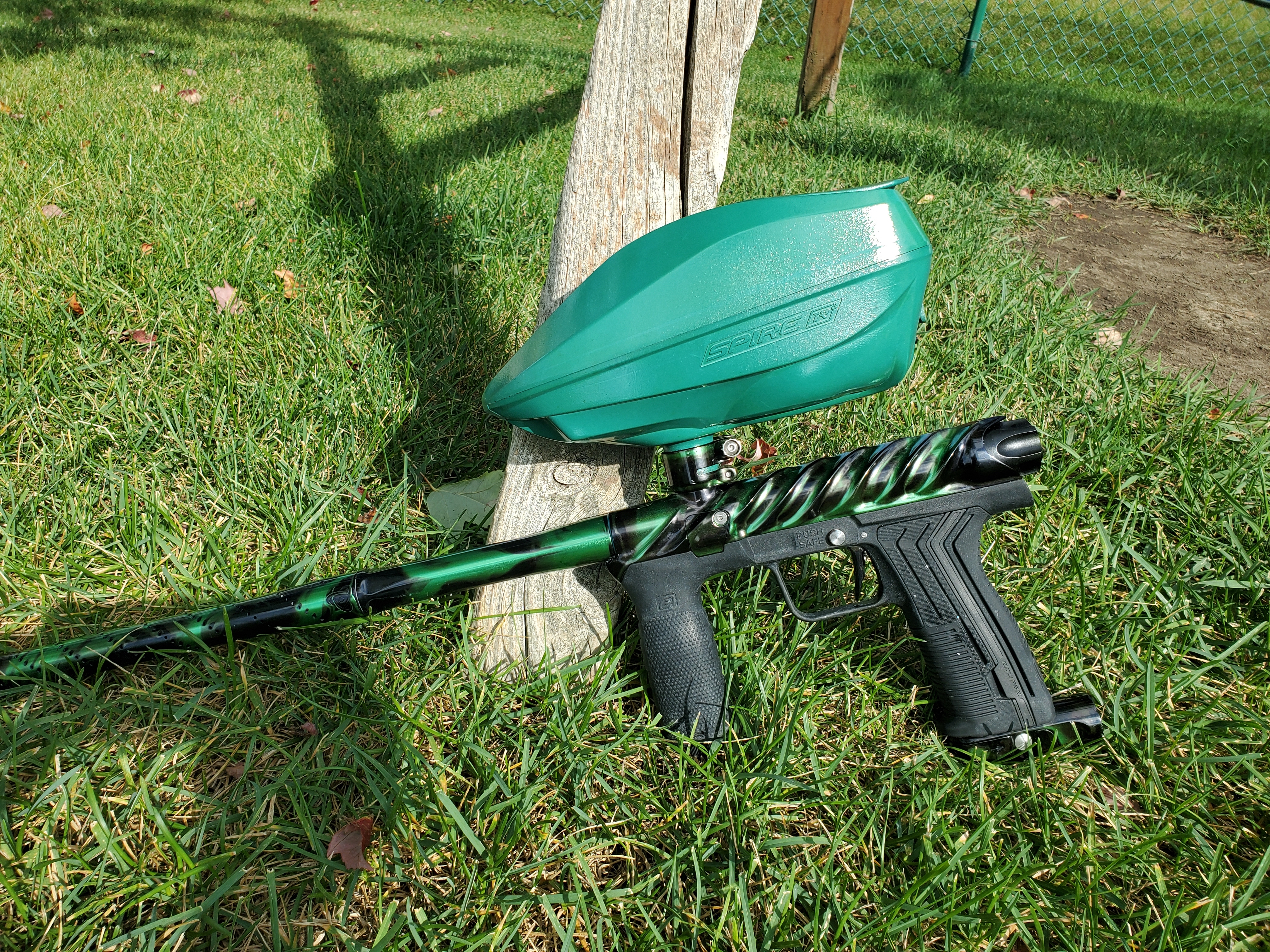

                  The wife was unhappy with the lack of green hoppers that weren't lime or olive, so I picked up one of the white virtue IR2 and some green Rit synthetic dye. Ended up throwing a couple coats of clear coats in it as well. For my first try dyeing something I think it came out pretty good, but there are a few spots where the dye was kind of splotchy.
