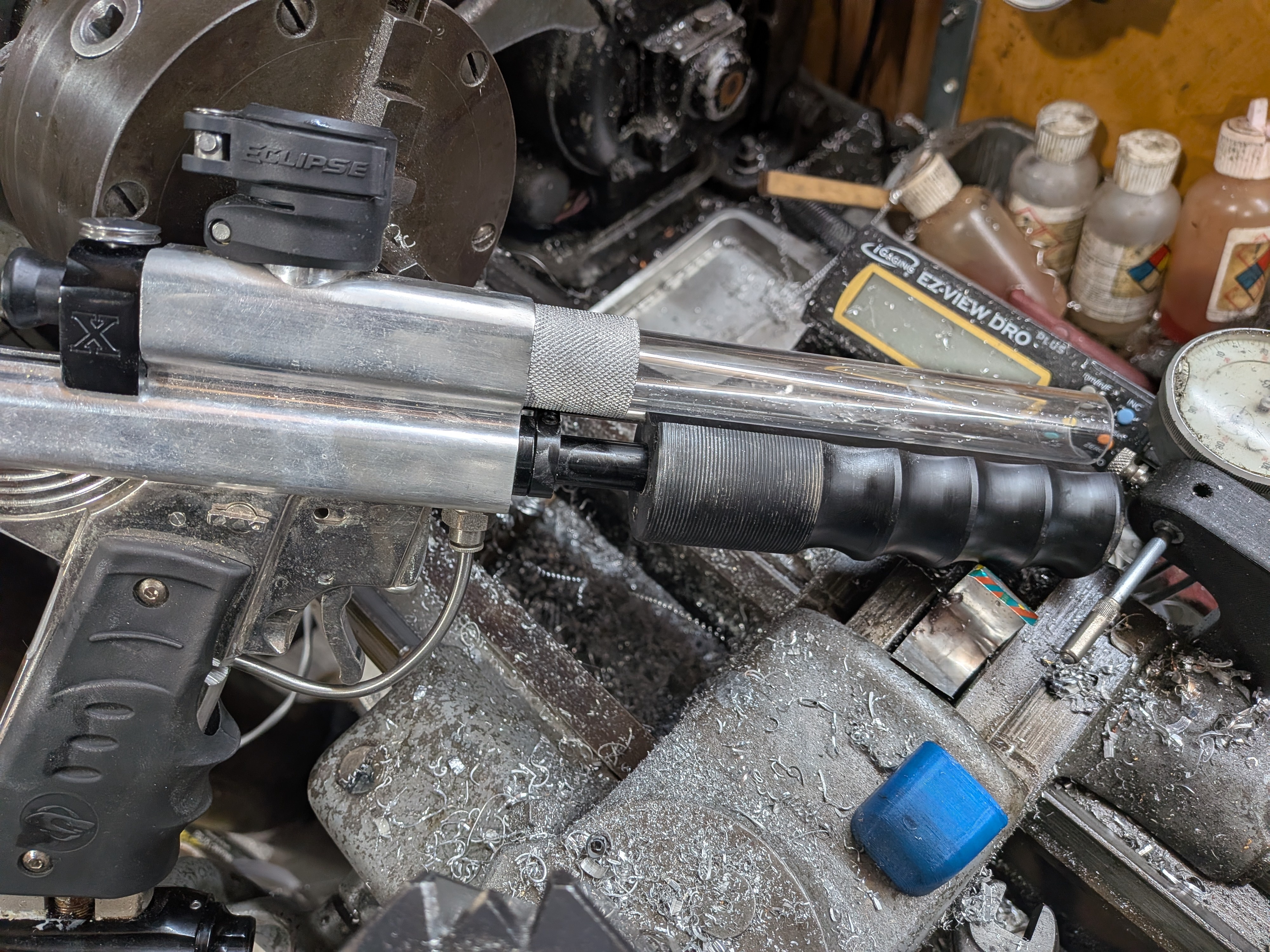

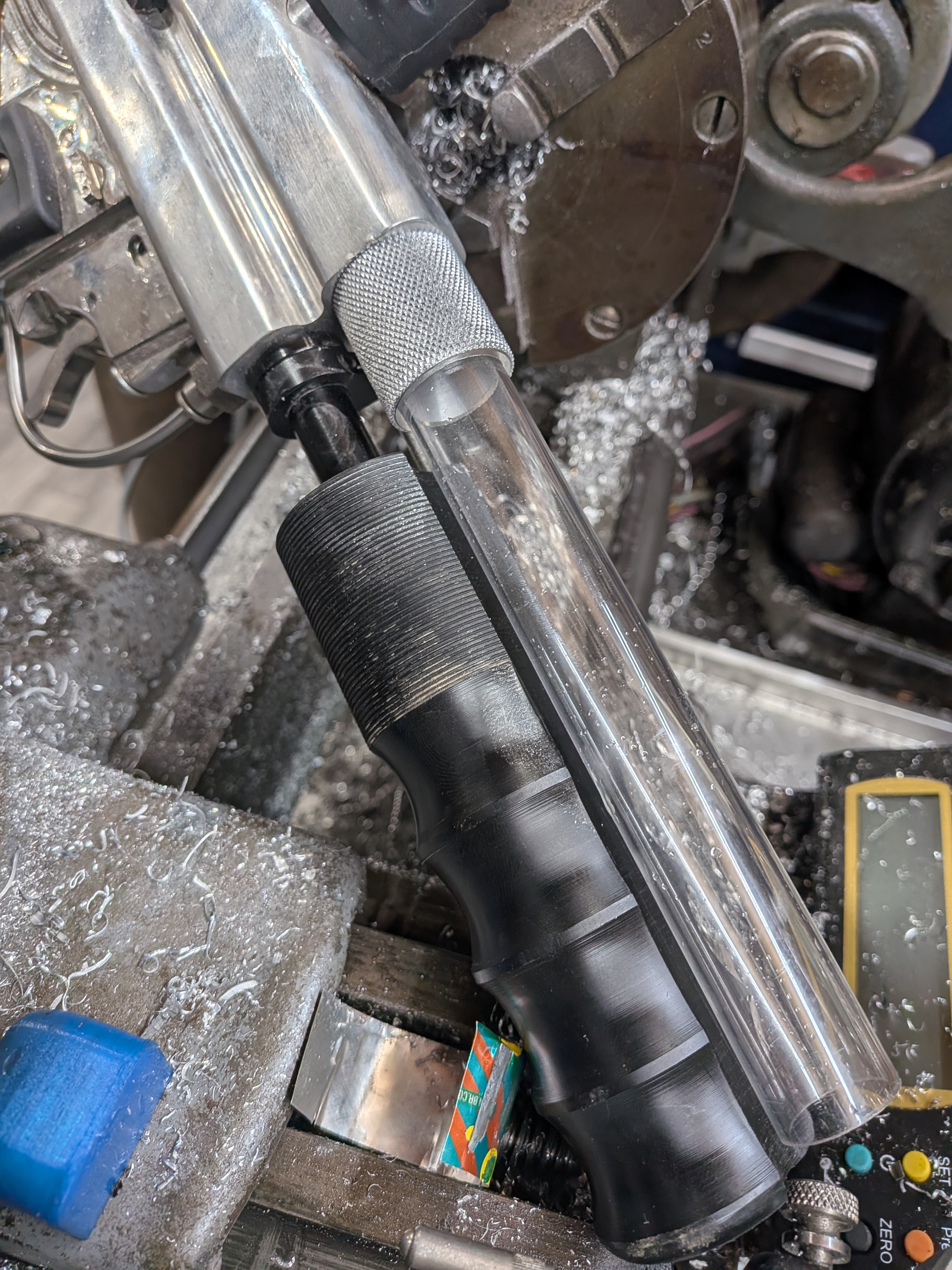

        Finally got around to re-programming the electronic lead screw for the lathe, and taking it for a test drive I ended up with a new barrel 😅
        I might make a barrel tip for it ...

          scottieb commented
          Tell people it's swarovski crystal.

        Which ELS did you end up going with? I've been looking into several for my 9x30
          XEMON commented
          I used Clough42's kit, it saved me a lot of time getting the base started.
          After a few firmware tweaks, i added some custom thread modes, a threading cycle, and a switch i can put on the ways to stop the carriage.

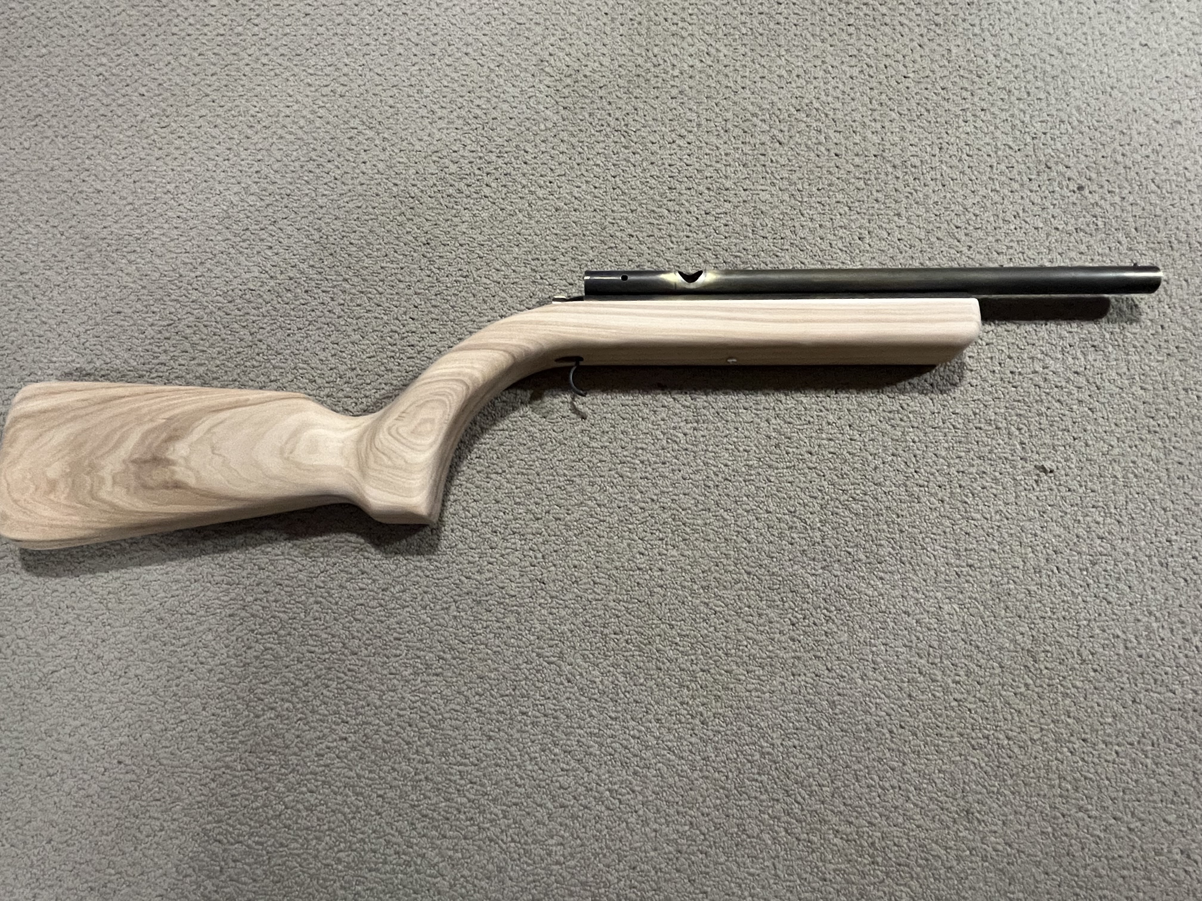

        Did a lot of sanding today, Plan is to next wet sand out with true oil, to fill some small pores, and harden it up a little. waiting on some brass bar stock, and tubing for a spring feed tube.
        I Would love to Find a old PT Extreme Lever changer, or palmers/docs quick changer..
        The fore end is staying a blank slate till I figure out what method of 12g changer i'm going to end up using, as well doing alot of brainstorming on how to fashion a lever changer/ pivot block for it, or to go the bolt action route. Open to suggestions/ opinions.

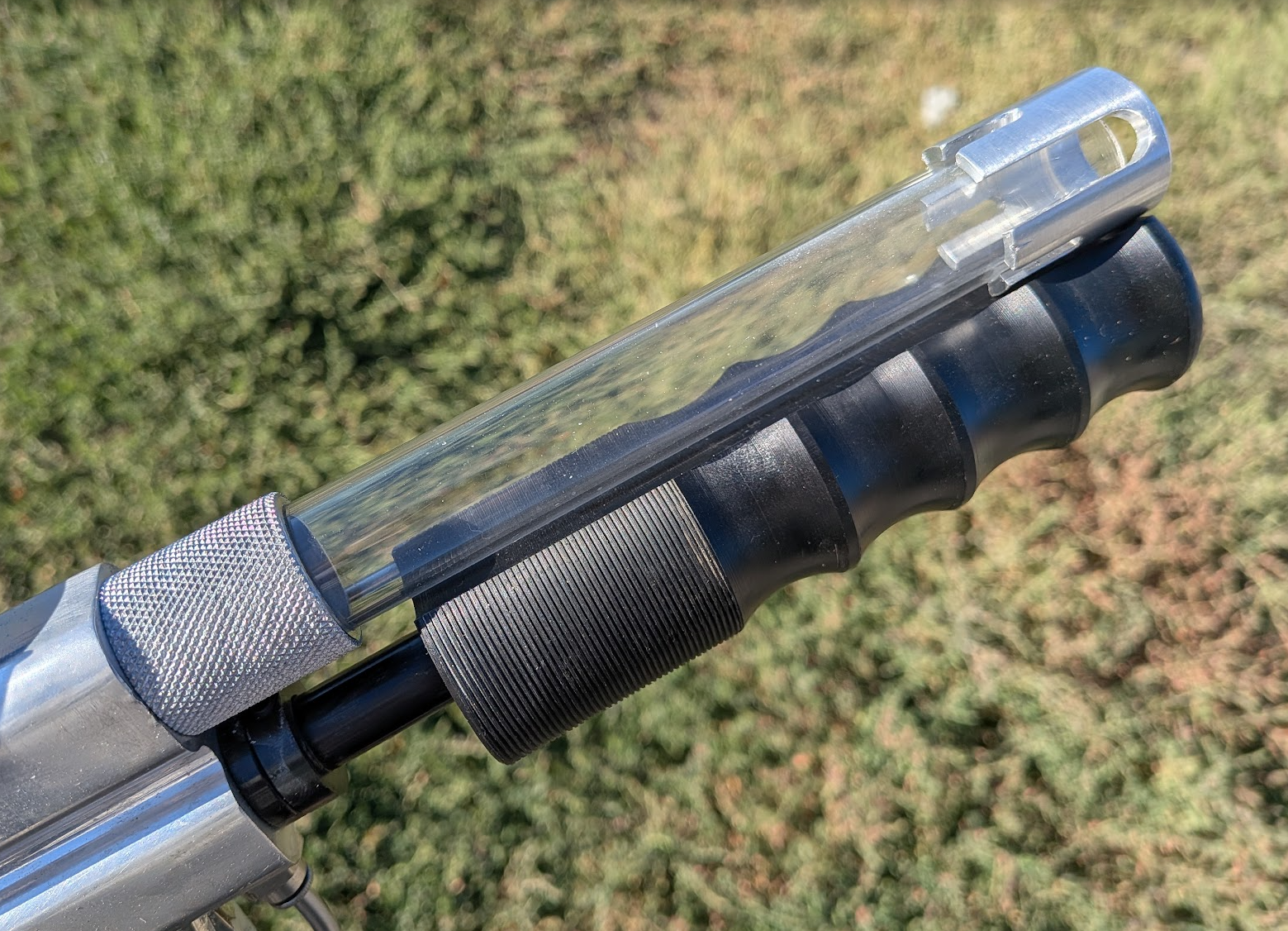

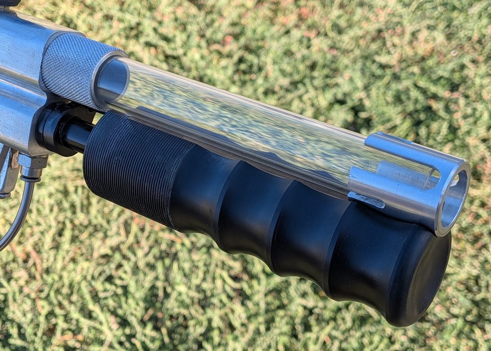

          well ... i did 😁
          Final barrel:
