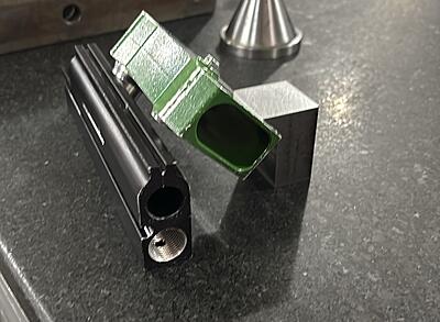

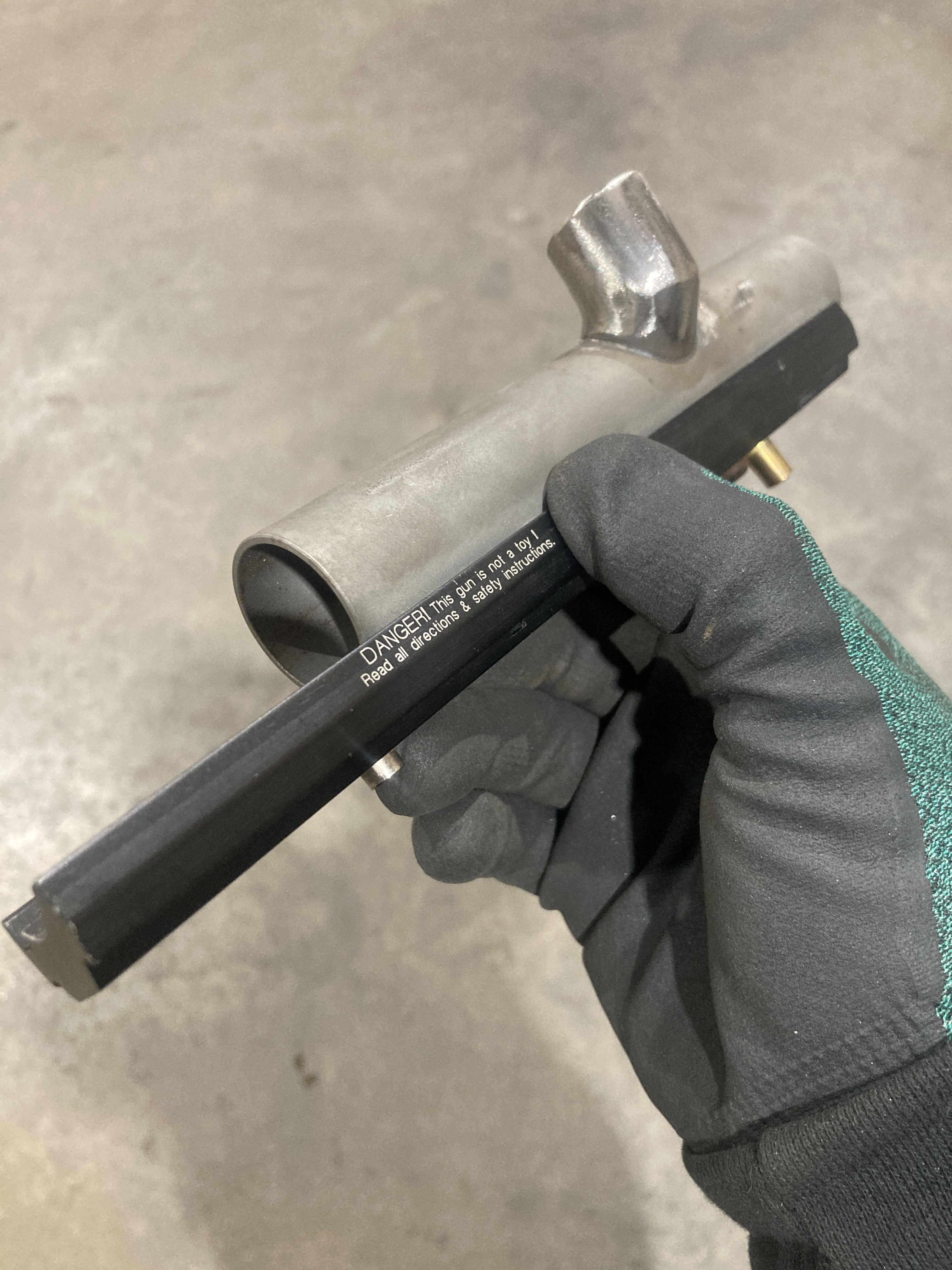

    Was going to go with a simple “ultralight” design but in for a penny, in for a pound.. so I threw together something a little wild for funzies…
    Merlin spec tube spacing, 11/16 lower tube, dye magazine…

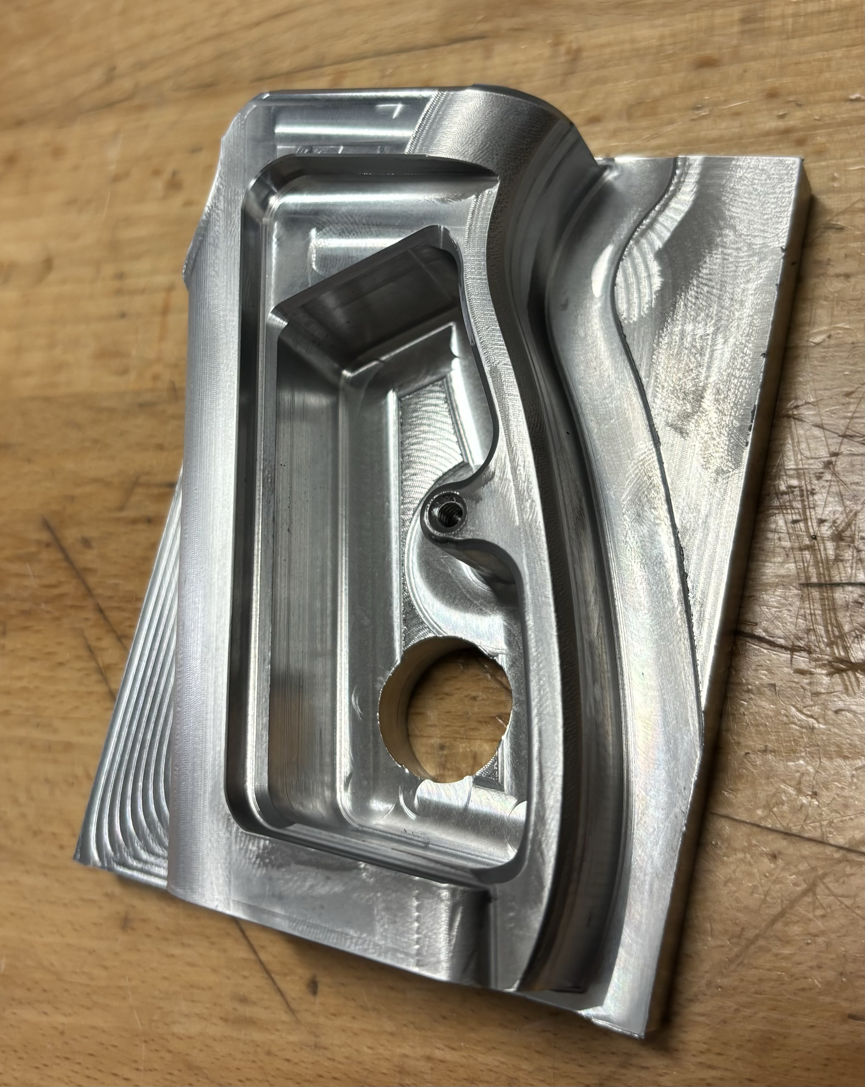

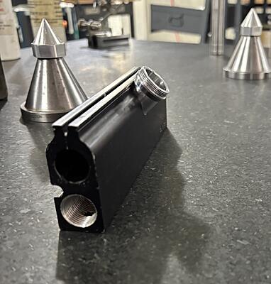

      While I’m working on the fine details of my magfed autococker.. decided to take on something seemingly simpler… made a fat finger mess up while manually programming and turned it into a mini lol. Oh well.

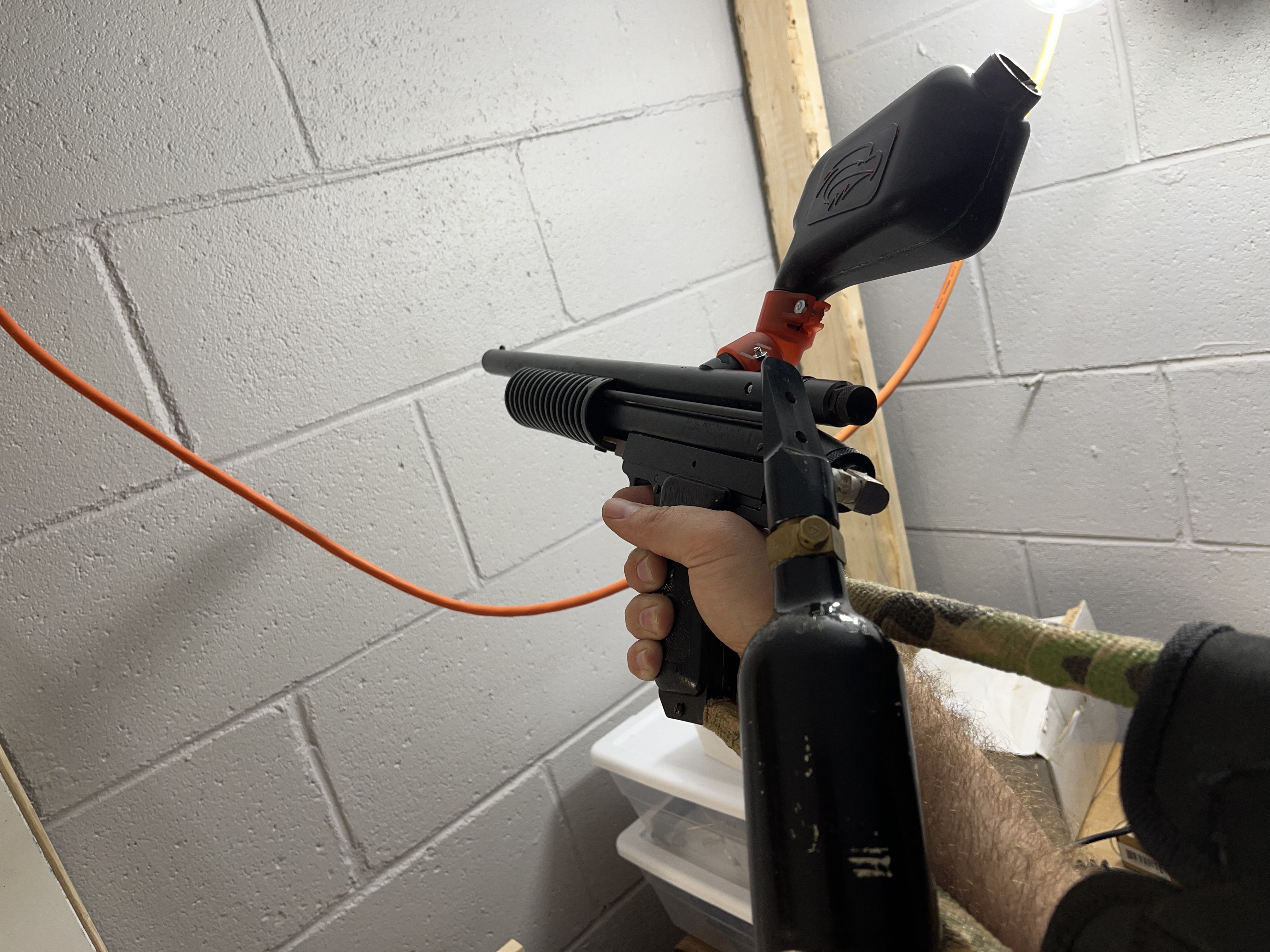

      #34

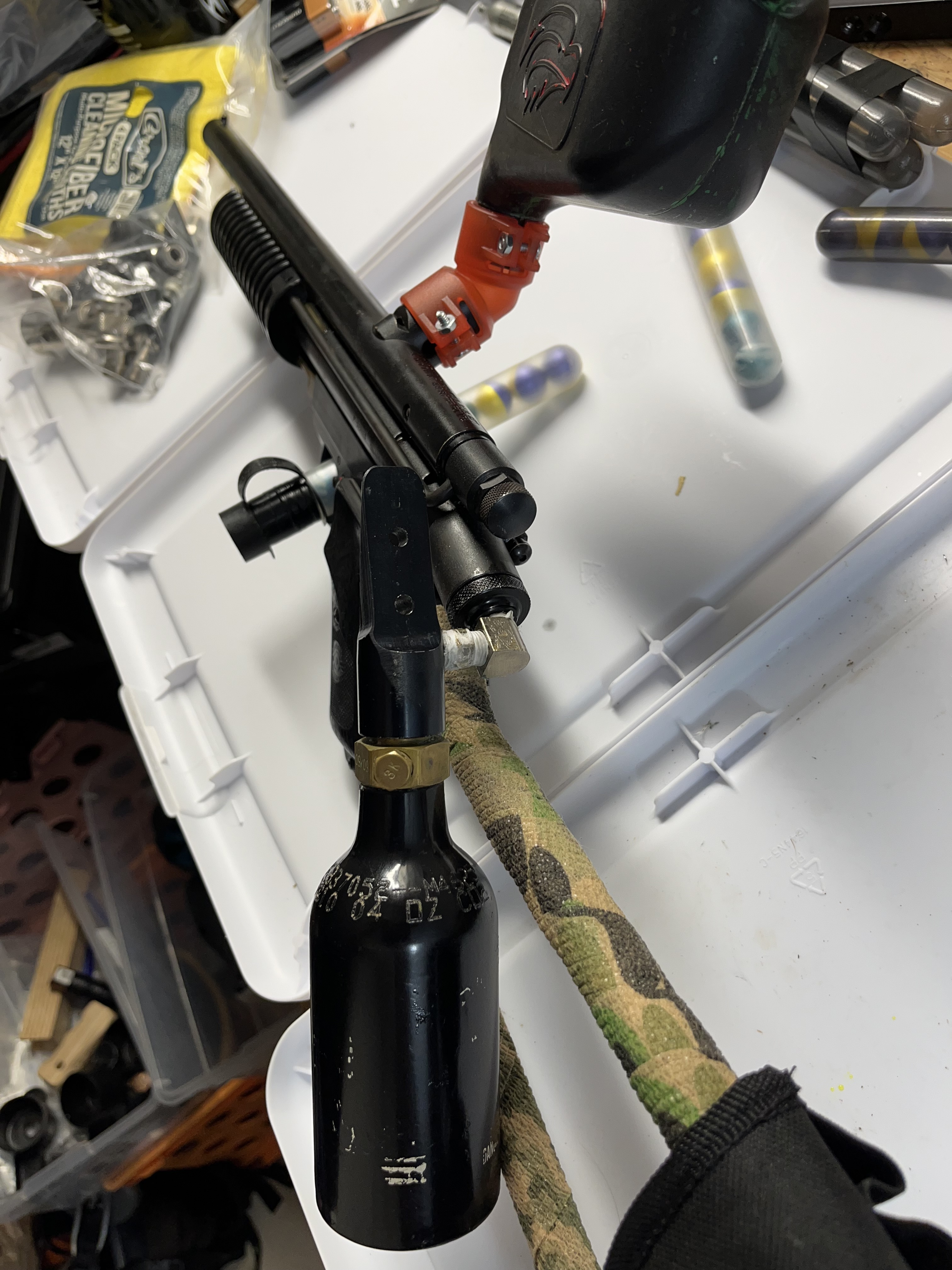

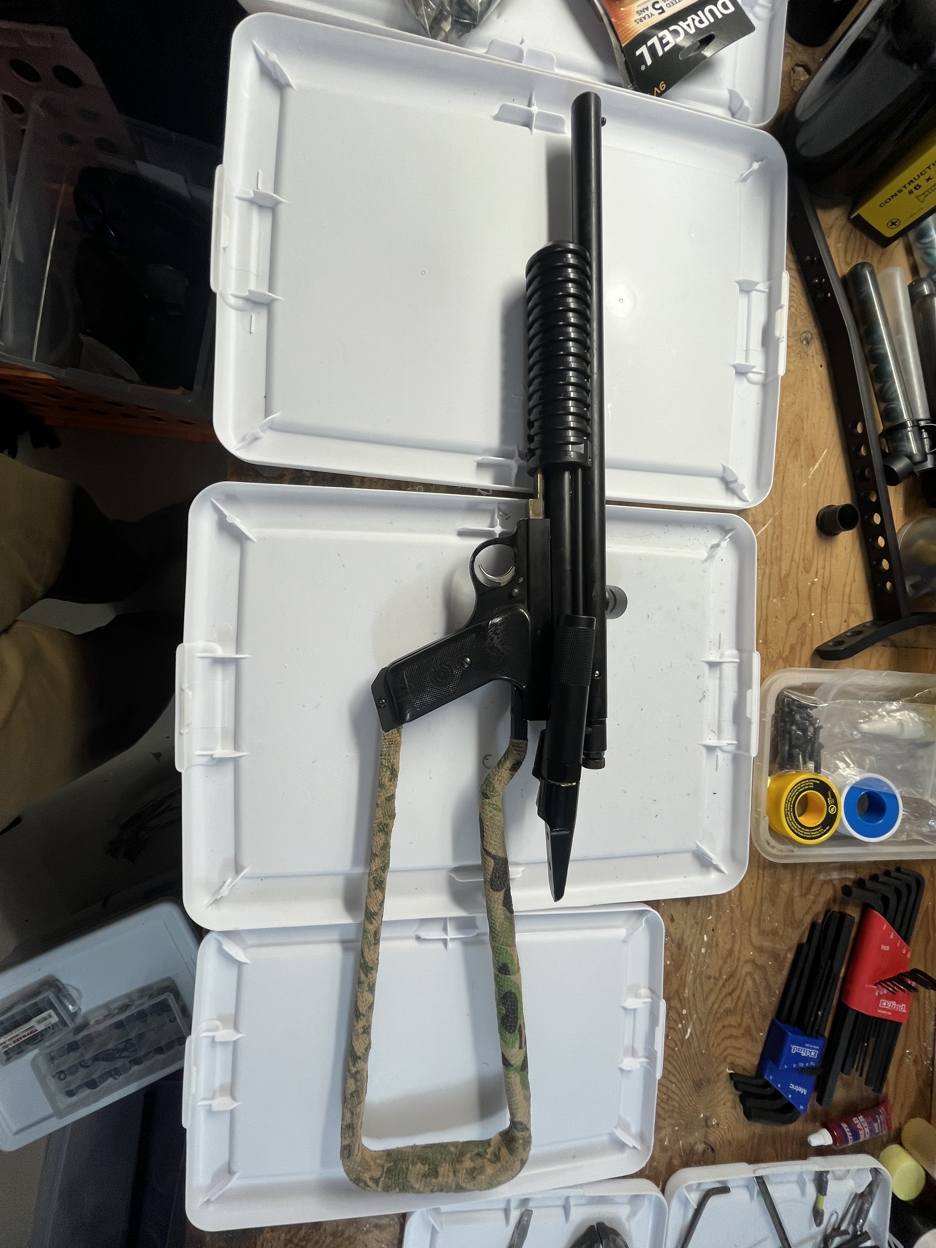

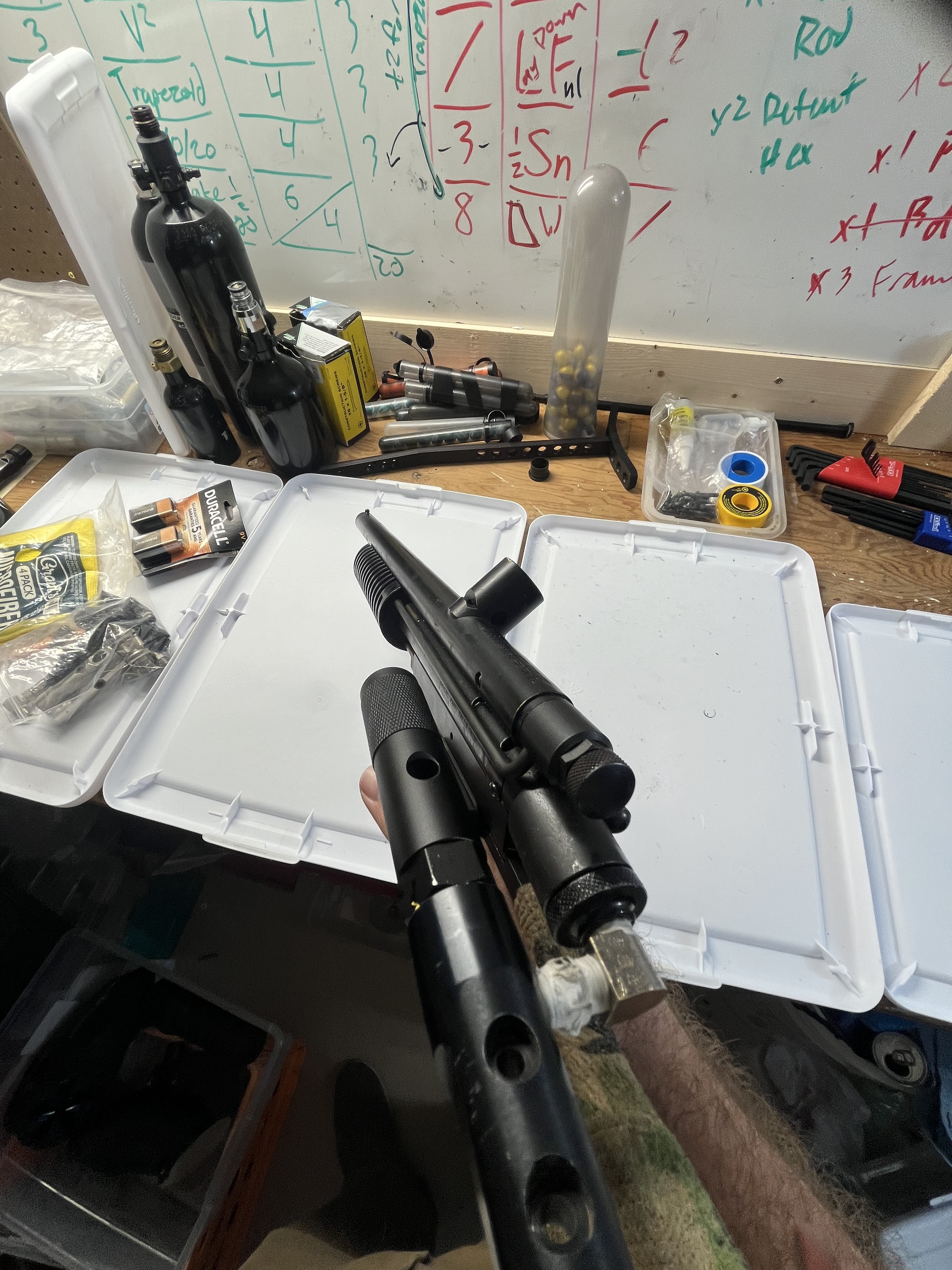

      Click image for larger version  Name:	IMG_2597.jpg Views:	0 Size:	2.66 MB ID:	610779 Click image for larger version  Name:	IMG_2598.jpg Views:	0 Size:	2.96 MB ID:	610778 Put together this monstrosity:
      I had wanted to put the stock on the PMI-II I picked up recently- but with the back bottle adapter in the way it won’t connect… however, there’s just enough clearance with a 68-AT… but no room for the bottle now.
      Made a side-saddle out of it
      Too bad it’s gotten too cold for 12g…

ID:	610781 Good thing 4oz fits just perfectly

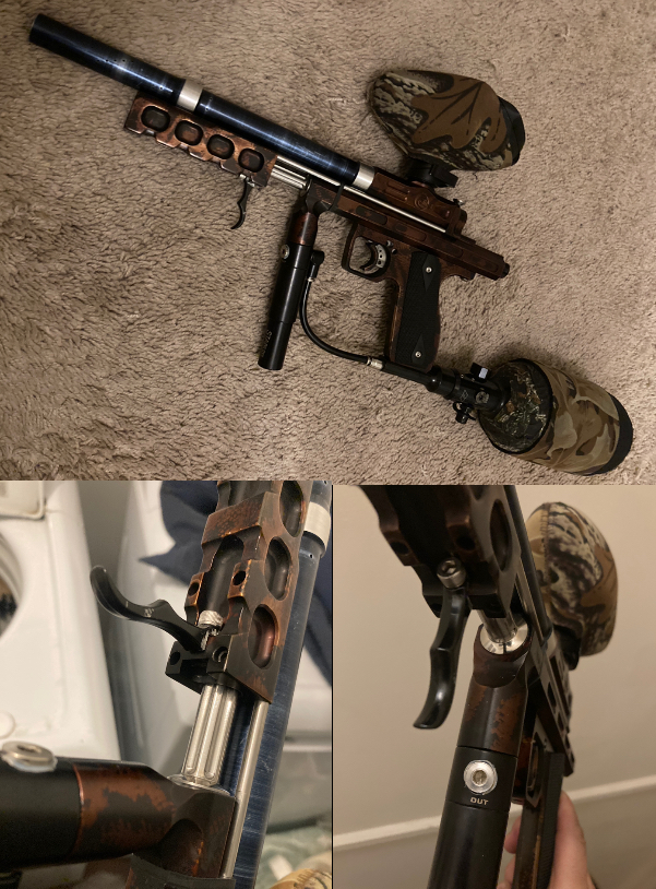

      #36

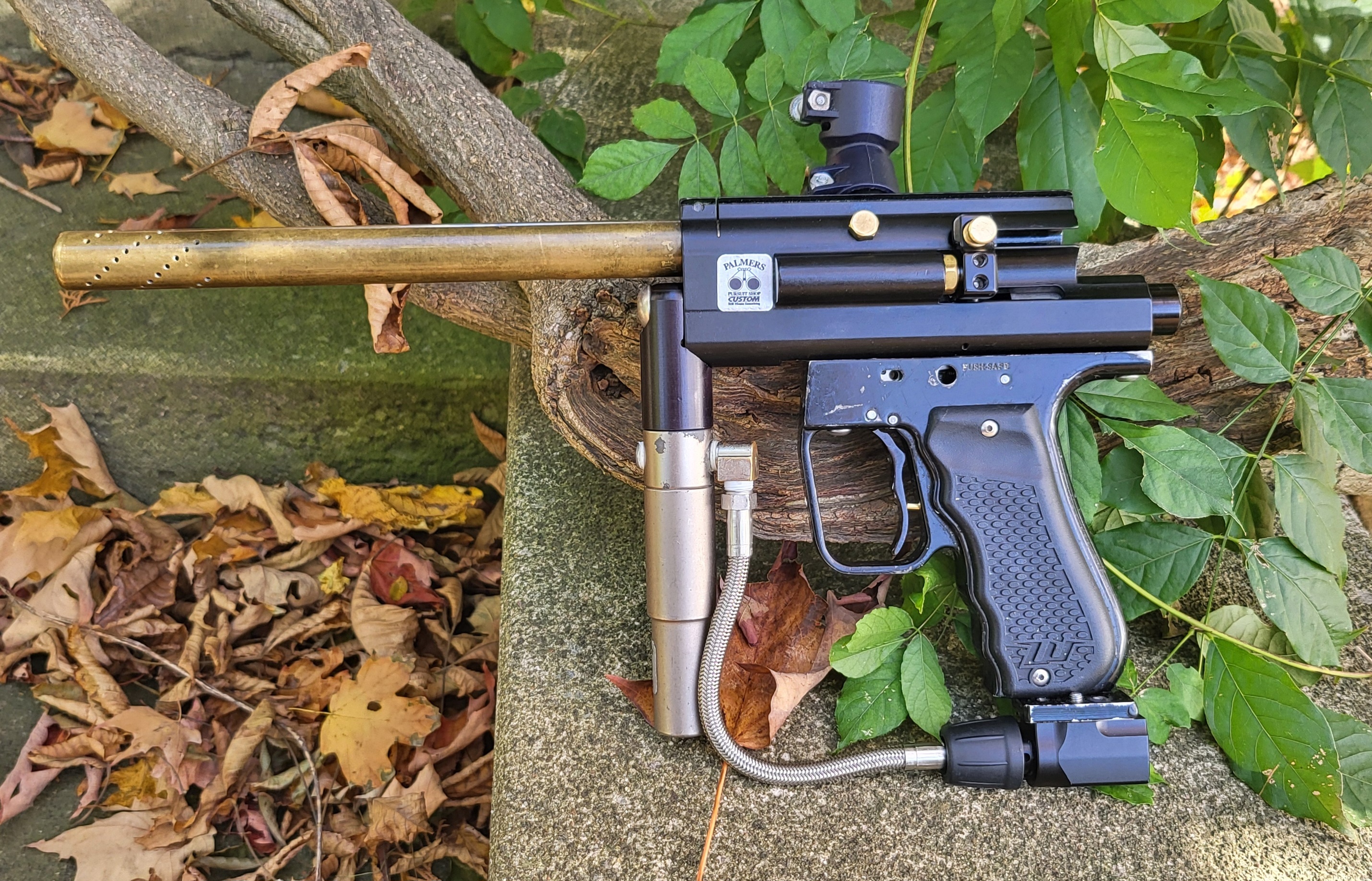

      I made a pneuBlazer out of a Trilogy SF frame and a 1k Blazer I bought off Walker last month.
        Alexndl commented
        Wow!
        I never knew cocker sear where compatible with Blazer
        Love the brass barrel with the porting
      • Meleager7
        Meleager7 commented
        this baby pretty fast !? Amazing !
        Jordan commented
        Alexndl they're not really, I had to modify the frame internals to work with the Blazer sear. Might do a build thread on it if it proves itself.
        The barrel is a stocker, 10.5" with dual venting and matched to the gun. Still need to build a Freak for it.
        Meleager7 it's not very walkable. It needs a little more tweaking to get there... it's fast enough for me, though. 🙂

      Had a little extra time today

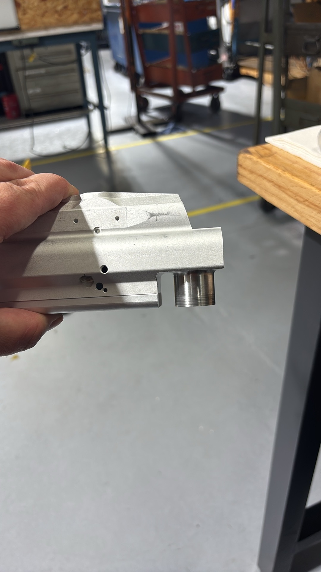

        #38

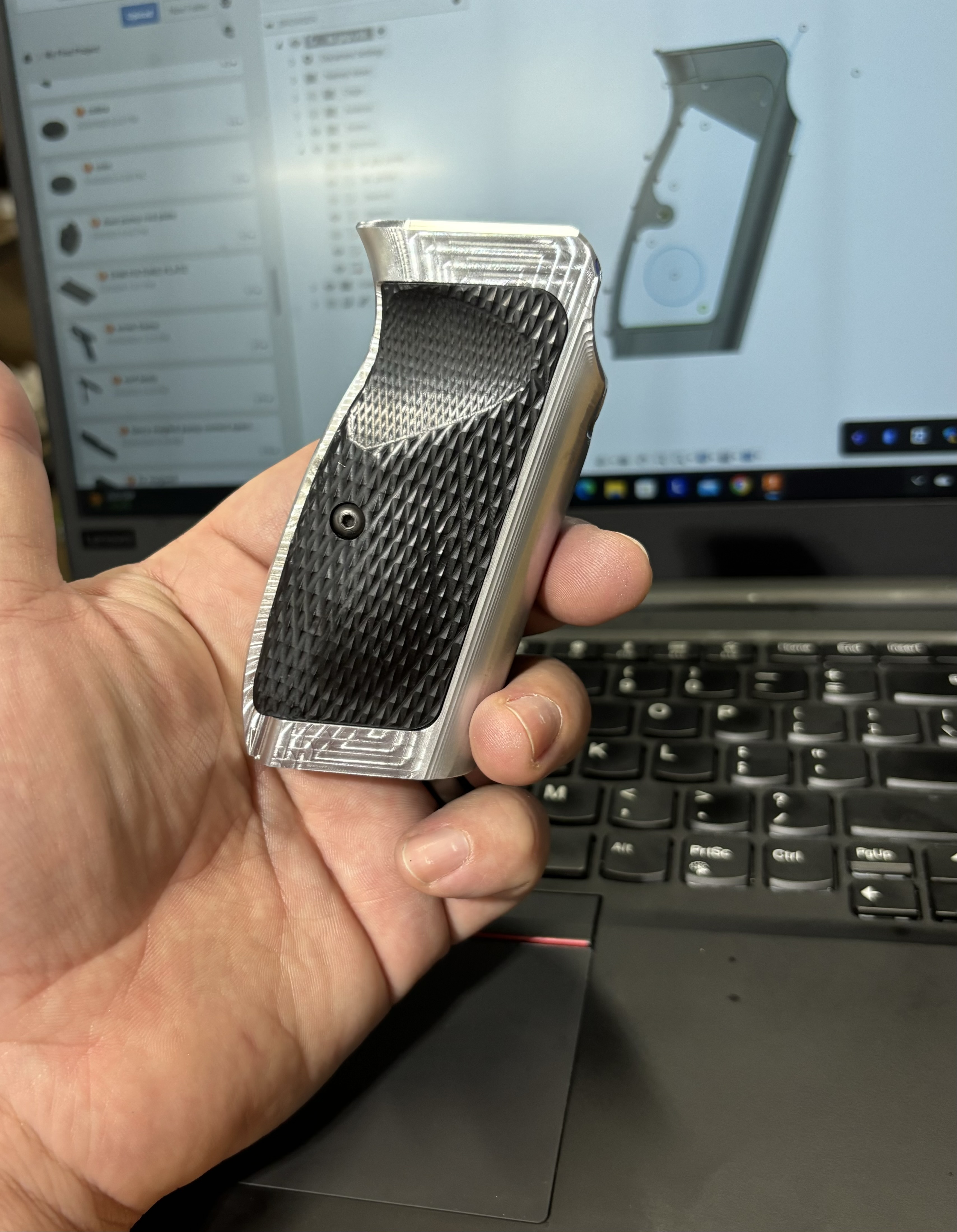

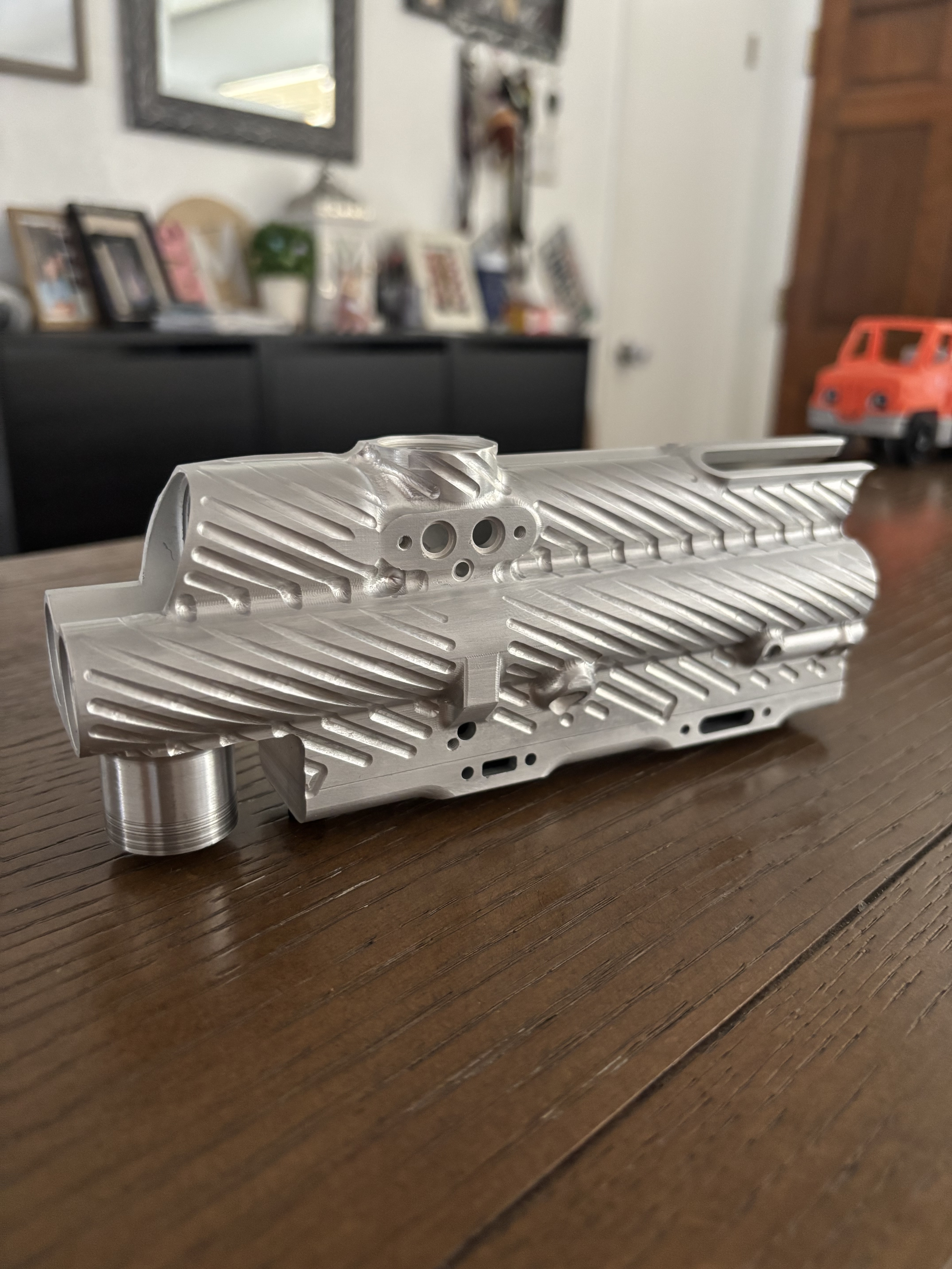

        A little extra material on the backside.. something must have moved in my drawing. So I’ll measure, make sure hogues still fit and run another to make sure it’s “all good”… very close.
          XEMON commented
          That frame is awesome 👍
          Do you have a CNC shop at home?
        • Frmrspec
          Frmrspec commented
          Yeah.. I’ve got a Bridgeport, a lathe, and a CNC mill in my garage.. but a lot of my projects I get done at work on open machines during my longer cycle times.

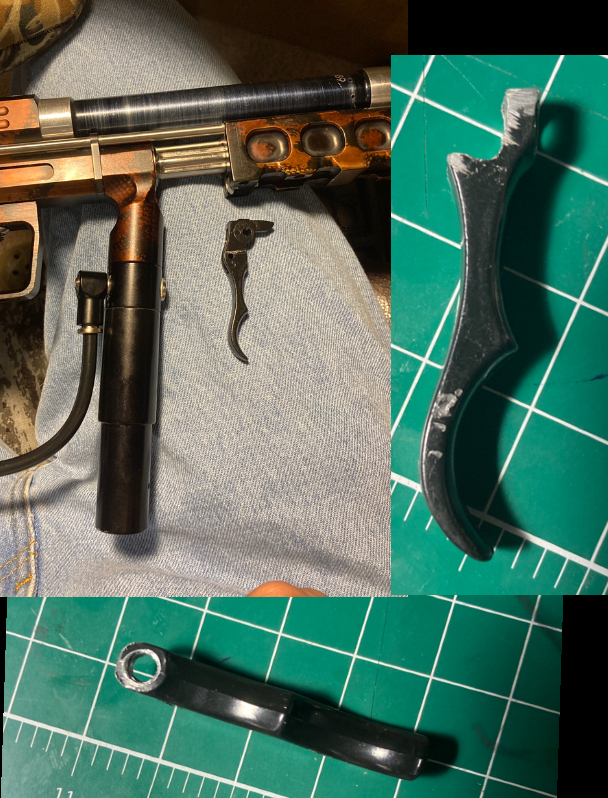

        after a deal w a fellow member for a sanchez hitman plate fell through, i pulled a spyder trigger and chopped it into one! works great!
        the way the metal is on the trigger, i had to mount it in front of where it usually goes but it feels just fine there and everything is nice and tight!
        Since its on The "Dirty" Sanchez, I had to christen it......
        The Sh_tman Mod!!!

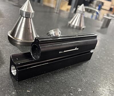

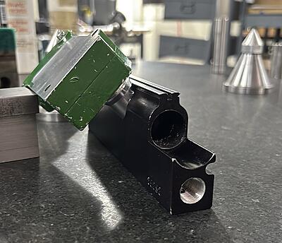

        #40

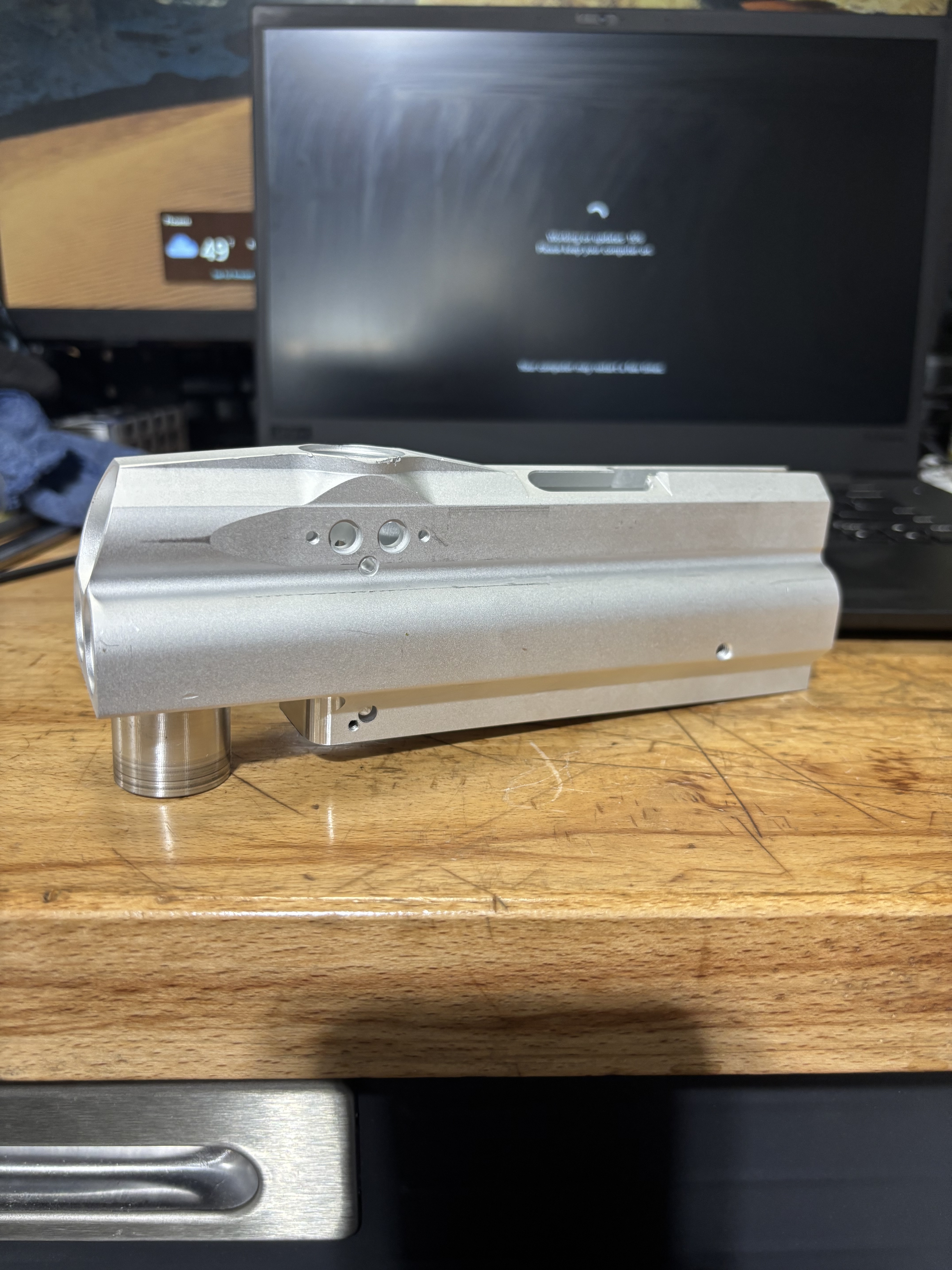

        Buddy wanted a custom rig to start playing again.. ooooooold sidefeed body, updated to 2k spec, 11/16 bored lower tube, pulled the neck and machined down an ADN tipx adapter and pressed it into the body.

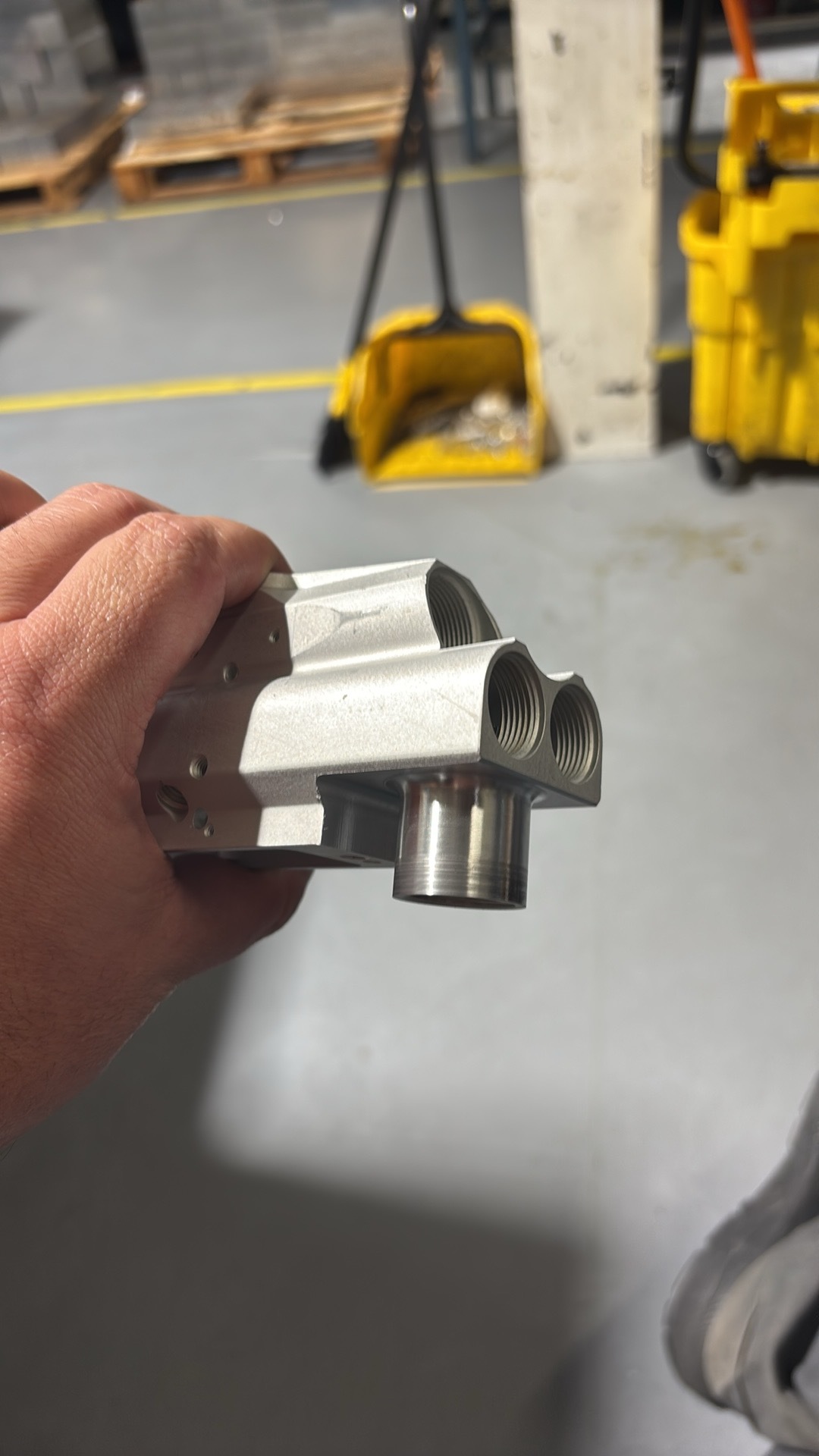

          #41
          Been a hot minute… but working on something that should excite at least a small handful of ya
          • Meleager7
            Meleager7 commented
            excal body?
          • Frmrspec
            Frmrspec commented
            Yes indeed

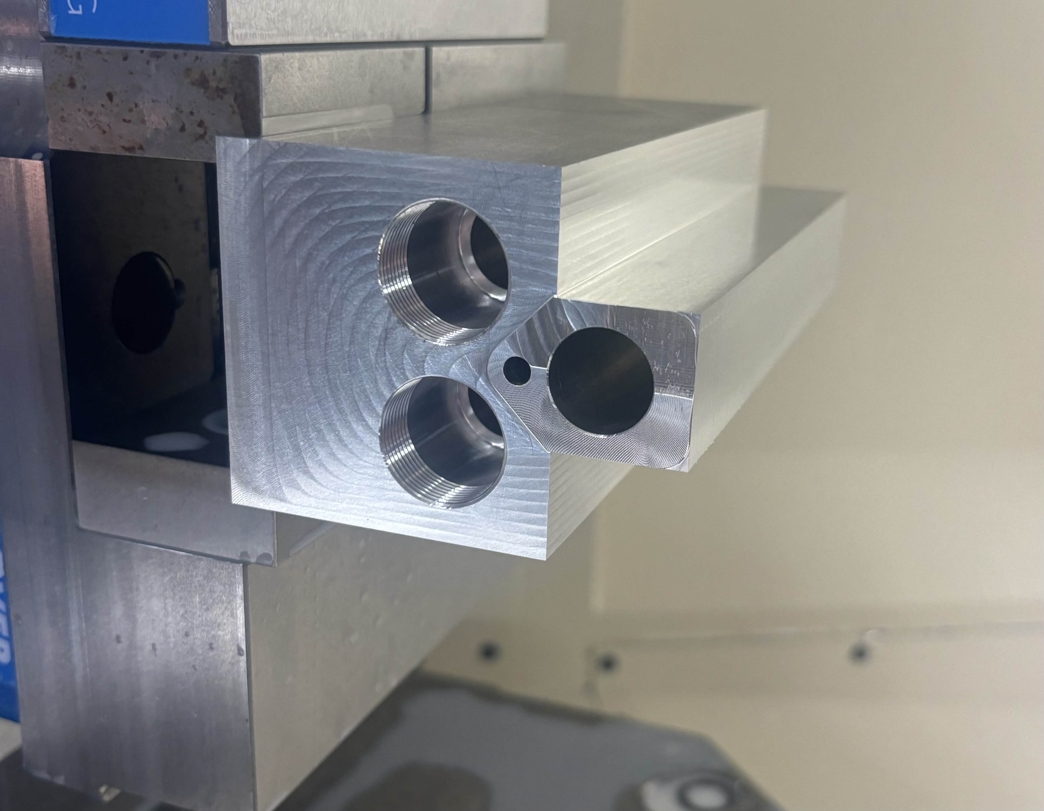

          #43
          Choppity chop chop
