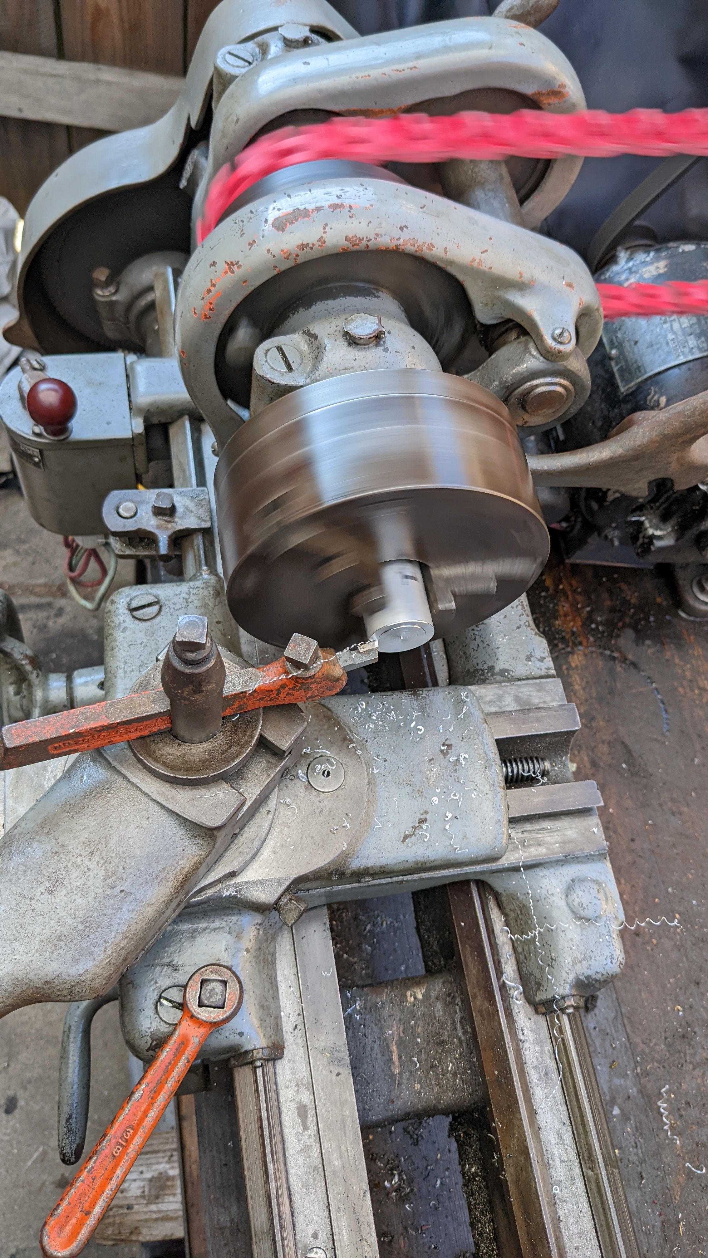

    THis lathe made it's first chip in the last 3 decade ... Super smooth!

    Now I need to get an AXA tool post ...

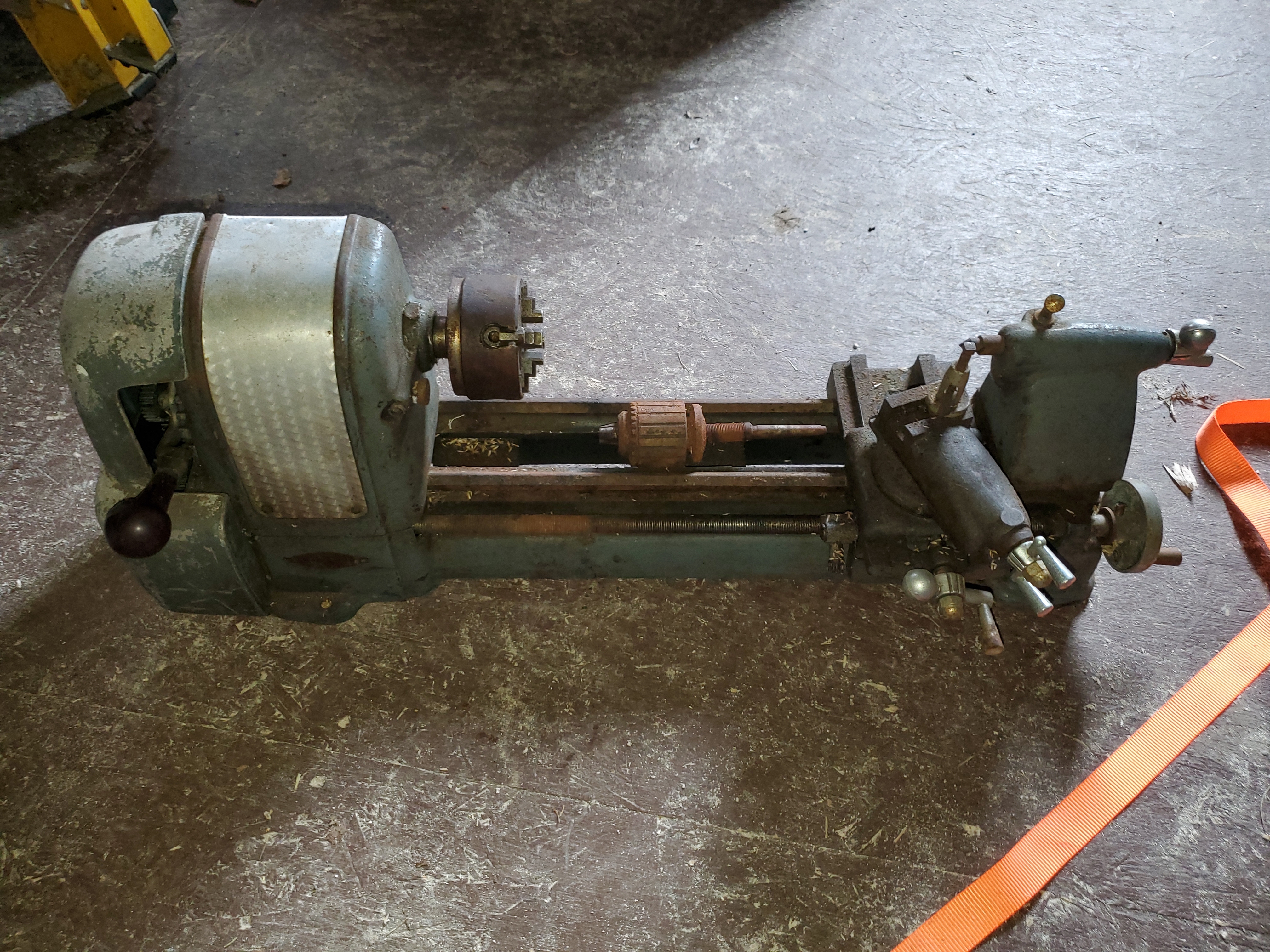

        Nothing spectacular. Its old. Its ugly. Just the way i have come to love wood or metal tools. They were just built so much better back then. Not the crap of today.
        So here it is. A 1940/1950s Craftsman Minilathe (2-3 feet long total) which I am told is a rebranded Atlas. The ways have surface rust from sitting in a garage for 30 some odd years and need cleanup and possibly a very light sanding. Don't know when or if I will use it but I have it and all the parts like the motor and gears for threading. Currently it is stored in a old wood box until I figure out what to do with it.
        But it being in that wood box is far better than it being scrapped which is where it was going if I didn't take it.
          --Noice!
          Next step, ditch the lantern and the brazed carbide for a cheap AXA Aloris clone and a couple bits of 3/8" square HSS. That SouthBend book mentioned earlier has a section on grinding the tools, and with a good wheel, and a few minutes with a whetstone or oilstone, you can get some pretty darn good finishes on aluminum.
          And keep that spindle oiled!
          -I think I mentioned it earlier in this thread, but the trick to removing rust from the machined surfaces is simply a razor blade.
          Get yourself a small pack of single-edge razor blades, and if you feel fancy, maybe a handle or holder of some sort. Simply scrape the rust off like you're scraping the frost off a windshield- for you sunbelt types, like you're scraping gun off a sidewalk.
          The blades dull in a hurry, and DO NOT flip them over to use the other side. Toss it and get a fresh one, they're cheap enough. Once the bulk of the rust is gone, use some green Scotchbrite wetted with WD-40 to scrub the rest off. The ways will never be as smooth and bright as they originally were, but they'll be perfectly usable again.
          And be sure to actually take the carriage/saddle off and do the underside, as well as the underside of the tailstock.
          For things like that tailstock chuck and the leadscrew, try white vinegar or Evap-O-Rust.

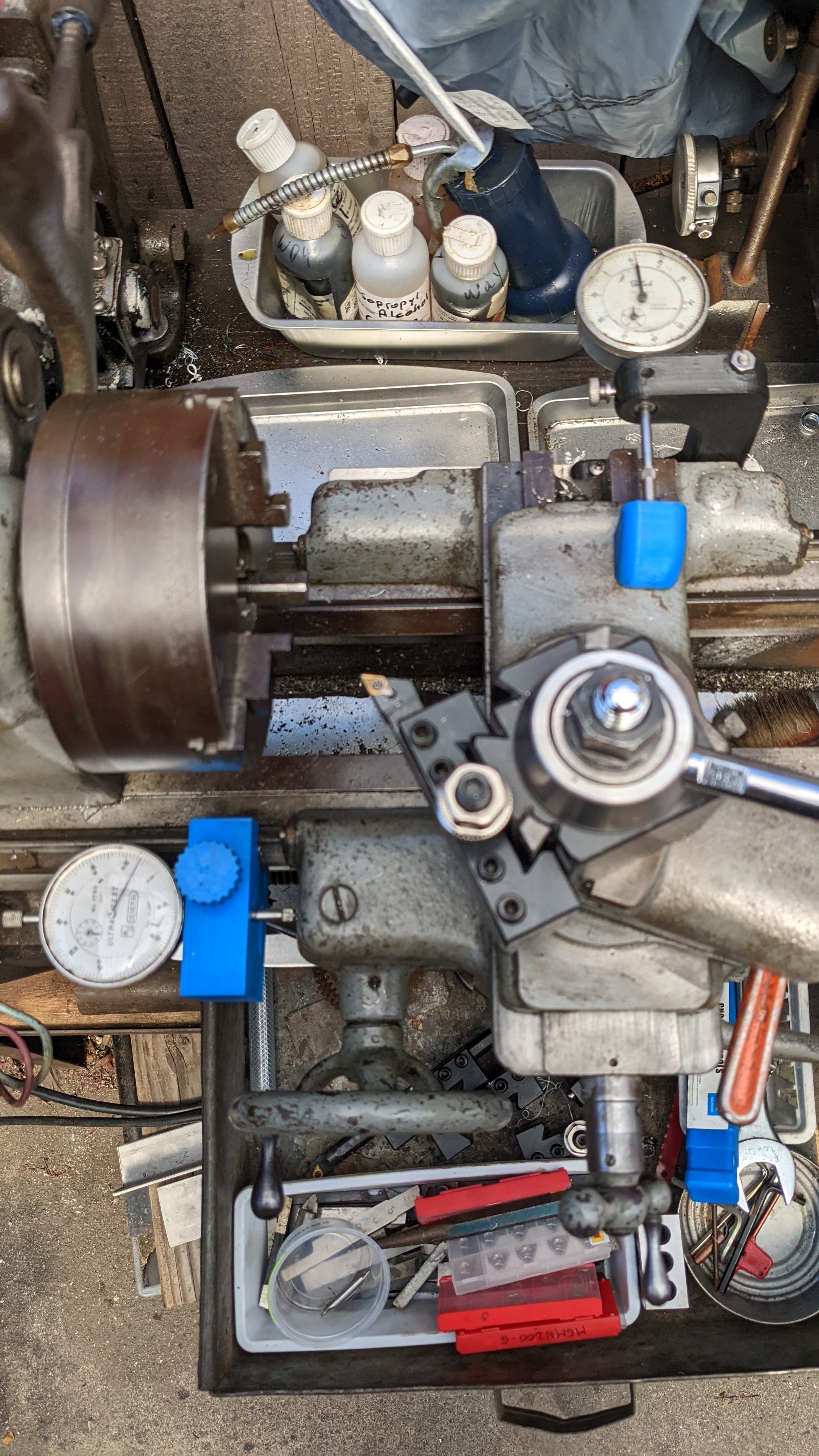

            That's literally the first thing I did after I had it running, I hate those lantern šŸ˜…
            also added a tachometer, and printed a few dial holders to make life a bit easier ...
            Next is to get a DRO (at least for the Z axis ...) and a collet chuck (thinking about an er40)
              XEMON commented
              Thanks šŸ‘
              The left one (z axis) is just clamping on the ways (not my design)
              The top one (x axiz) is a bit different. I made a plate that bolt on the bottom of the carriage and the 3d printed holding the gauge goes around the cross slide. The blue Bock the dial press against is a magnetic so I can place it where it fit the part I'm working on. I can take more pictures of you want a better idea of what I did there.

              Magnetic - very cool!
              I don't have a printer, so I'd be making them of wood, but the concept is gonna get me started. So much better than counting sloppy threads!
              XEMON commented
              If you have an SB9, id be happy to print you a set.
              Doc.
              Thank you. That is awesome advice.

                    another solution would be stoning the rust off.

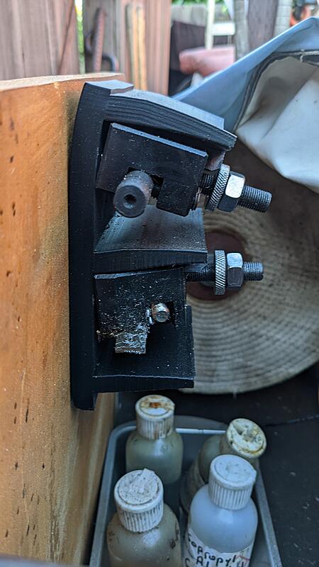

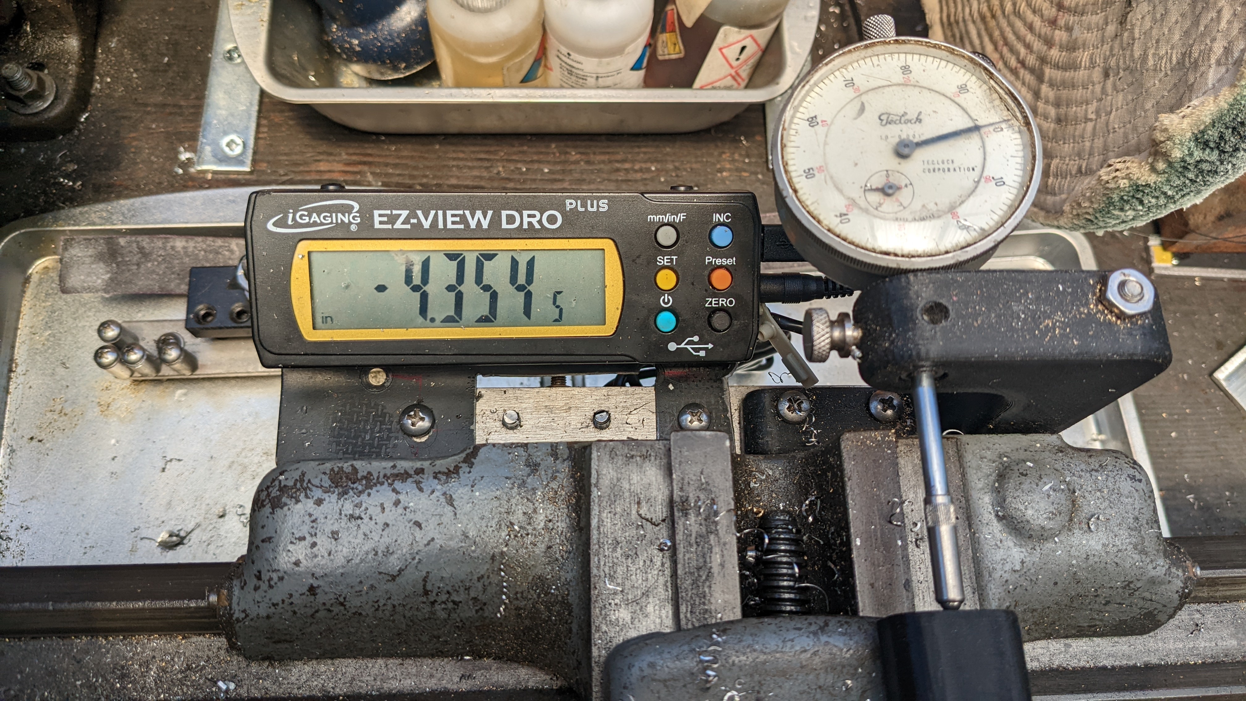

                      Nothing new per day, but keep modernizing my old lathe ... made a "chuck end stop" this we ...
                      it's just wood for now, but I'll likely mace one out of aluminum if I use it ...
                      Also found a good spot for the DRO:

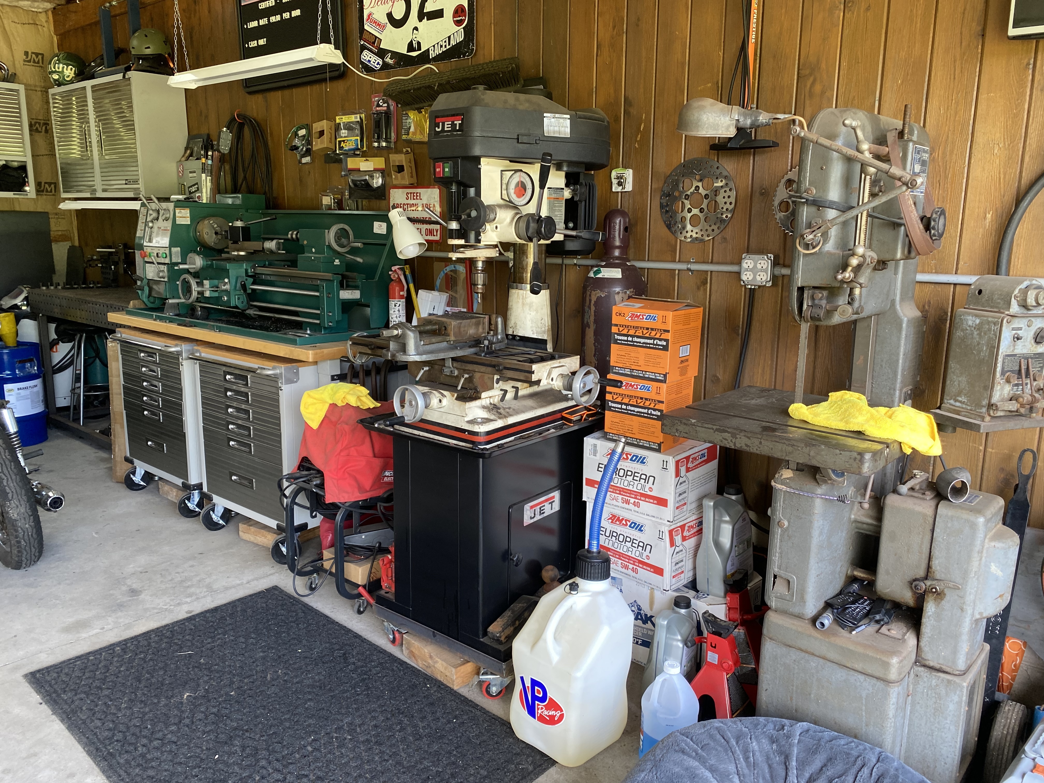

                            Some of my shop tools.
                              Cafe build I’m restoring for a customer of mine.
                              XEMON commented
                              How do you like the jet tabletop mill?
                              Starting to look at smaller mills ...
                              It works well for the projects I have used it for.
