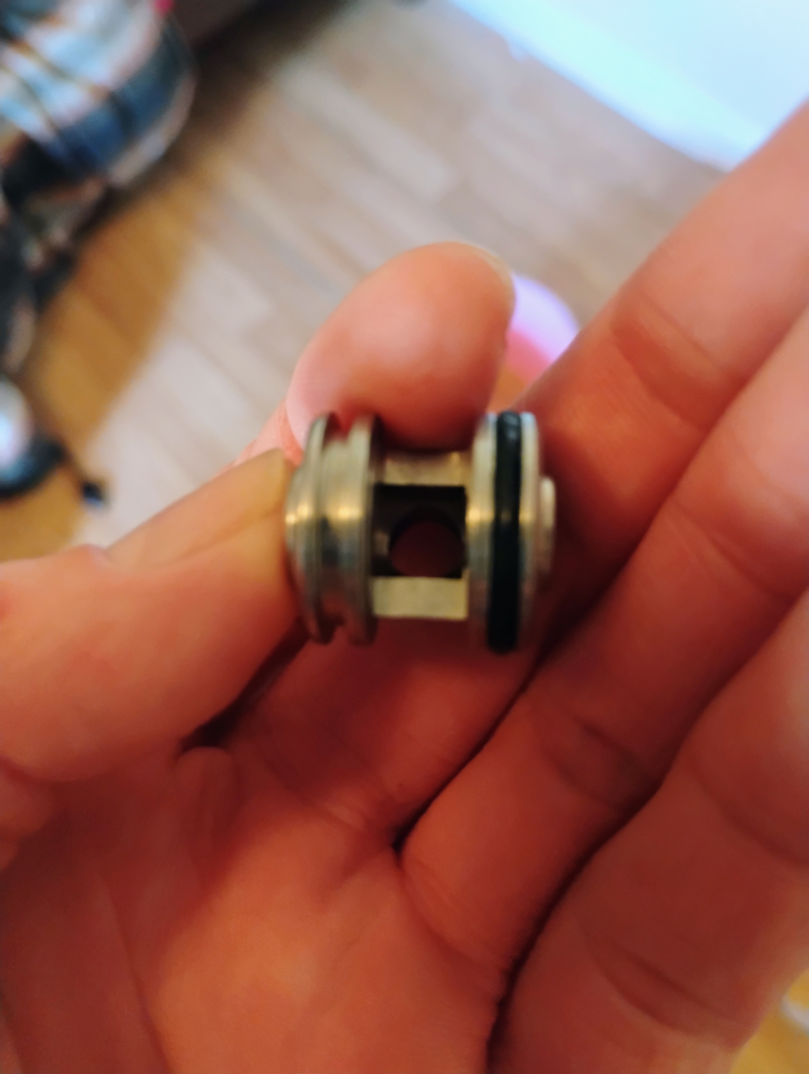

    Originally posted by RhoXi
    It's the stock valve out of later Spyders. The valve pin is designed in such a way to allow more flow and blowback is provided via a small hole in the valve rather than the valve pin. My hope is to increase volume/flow so therefore I can use lighter springs/striker.
    Which later spyders? I've taken apart pretty much everything there is outside of the balance valve and spyders have always had the cut out of the valve stem not a hole in the valve itself
    There's a lot of stuff like JT and off brand that run the valve hole but I've never seen it on a spyder

      From a quick glance, it looks like it came on the fenix, MRX, MR100, MR5, etc. Here's the ANS page for the vavle body.
      https://ansgear.com/kingman-spyder-f...e-body-itp025/
      I read some threads on LP spyders where people got some good results with these above 400 or so psi. We'll see if I wasted my money or not.
        • 6182
        #19
        Weird, wonder when that changed because I've had most of those you listed cross my work bench

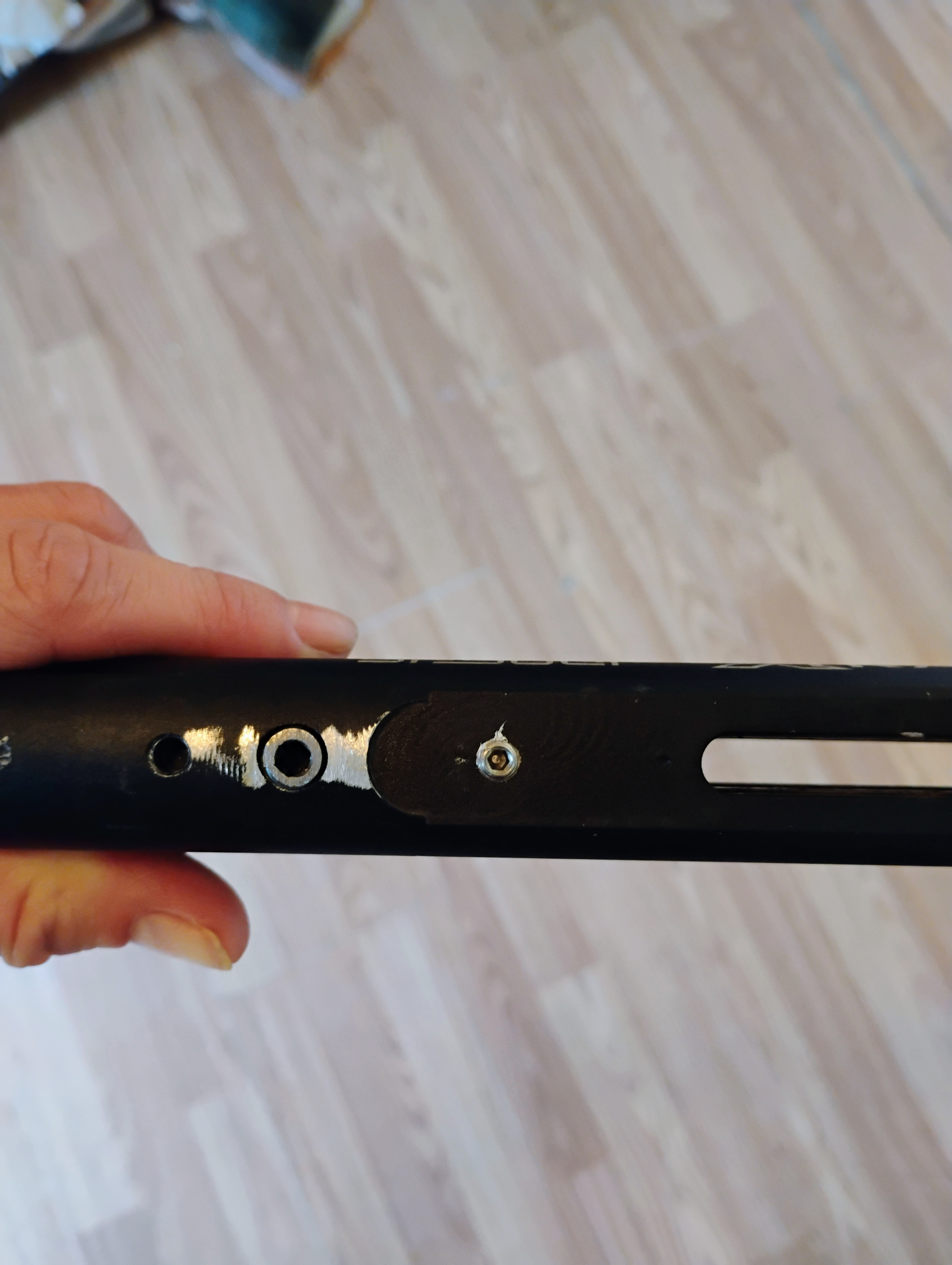

          Also me and my niece went digging through my junk trunk again and we found some bodies and a frame that had a battery in it that seems to function just fine it's off of a mongoose, although one of the bodies had a random hole right behind the valve retaining screw plugged why do this I'ma guess it lets excess blow back gas out or something, I believe I got it from a member here that had built a LP Spyder that he couldn't get to work
          • Toestr
            Toestr commented
            Some bodies use a set screw behind the valve to retain it instead of a pin like earlier Spyders.
          • Psycho91
            Psycho91 commented
            No this screw was added it is not factory

          This is what I'm talking about
            scottieb commented
            The hole there vents gas coming through the valve towards the striker. It is very common to plug the hole in LP builds.
