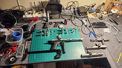

    I am beginning to reassemble the remains of 4 once proud Minimags. I haven't airsmithed in 17 years, so I chose the one platform I have no previous experience with. Having asked multiple questions in posts and via PMs (many thanks for the replies), I decided to stop contaminating the rest of the forum and concentrate the silliness to follow in one place. My minimum goal is to get 2 of these running again. If a 3rd sputters to life against all odds, that will be peak winning. The primary is starting to come together. Most of the orings are ordered, and I have one new main seal on hand. The primary will be running twistlock barrels with BW TPU detents. The backup will be running Docs AC adapter. There will be sooooooo many stupid questions and clarifications to follow before I can successfully get my butt back onto a paintball field.

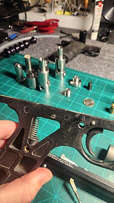

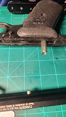

              This brings me to my first issue. I currently have 1 seer spring for 4 grip frames, 3 of which are in good enough shape to use. Are mags sensitive to the seer spring type? I have found some at the local hardware store that are similar, but not exact matches. Not seeing any for sale on ebay either.

                Sear spring? No sear spring, so sounds like you have 1 too many.
                I mean technically there was a questionable mod with a tension spring to pull the trigger forward, but ain't nobody got time for that. Maybe you have a sear spring for a WGP sniper/cocker? they used the same (ish) frame. It would be a little bigger than a 1/4 inch and kind of a mid level stiffness?
                Do you mean bolt spring? Square wire, fits over bolt? That's a very specific spring.

                  As I stated, this is a platform I am just starting with. 1 of the grip frames had this spring in this space clearly designed for a spring. The other 3 frames did not. Most manufacturers don't take the time to design in a spot for a nonexistant part, so please forgive my confusion.

                    Yep, that's for a Sniper, you can ignore that, just set it aside and you are good to go. There is also a slim chance that is a trigger for a Sniper if it is kind of a dull grey metal, and that would bind (as I recall, it has been 30 plus years) on the sear, and might need to trim it, if it causes you trouble, or just switch to one of the other frames.
                    If it is a plastic GF nylon, then you are good to go.

                      Thank you for the info. Its a nylon frame that looks identical to the others. I will remove the spring and carry on.

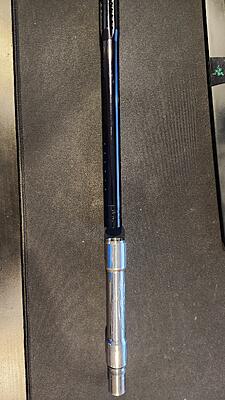

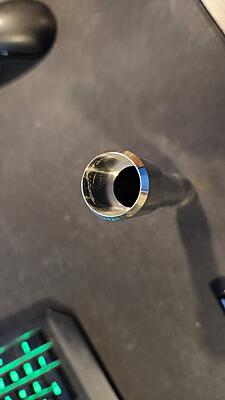

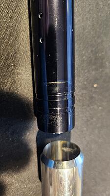

                        Super discouraging day. I cut down a powerfeed on the most beat up minimag body I had, and cleaned up the cut nicely. Sanded down the body 240-600-1000 to remove the most of the scratches, but not leave it too shiny. Everything looked great. I knew a 16" Dye Boomstick from Ebay with AC threads is out for delivery so I go to do some work. Just received Doc's AC adapter yesterday, so I plan on installing that in the newly prepped body upon return. I get home, and immediately knew that the 10" long package on my door was trouble. The "Great Condition" 16" Boomstick had been pulled apart into two pieces at some point, but was shown together in a single photo for the listing as if it was still properly assembled.
                        I figured I would go ahead and install the adapter , only to discover it's not AC threaded. Not sure what the threads are, but only an old F1 Illustrator barrel is close to the diameter. I'm not worried about Doc's adapter. He'll make it right. I must admit, I forgot what a shady cesspool buying used PB gear online could be. Everything I have purchased so far has been maximumly abused, and now fraudulently so. I will get through it, but needed to vent.

                        To make it better, Doc just let me know that this was a Spyder barrel. Having not even looked upon an AC barrel in 17 years (sold all mine then), I didnt even realize it. This is gonna be a rough ride.
