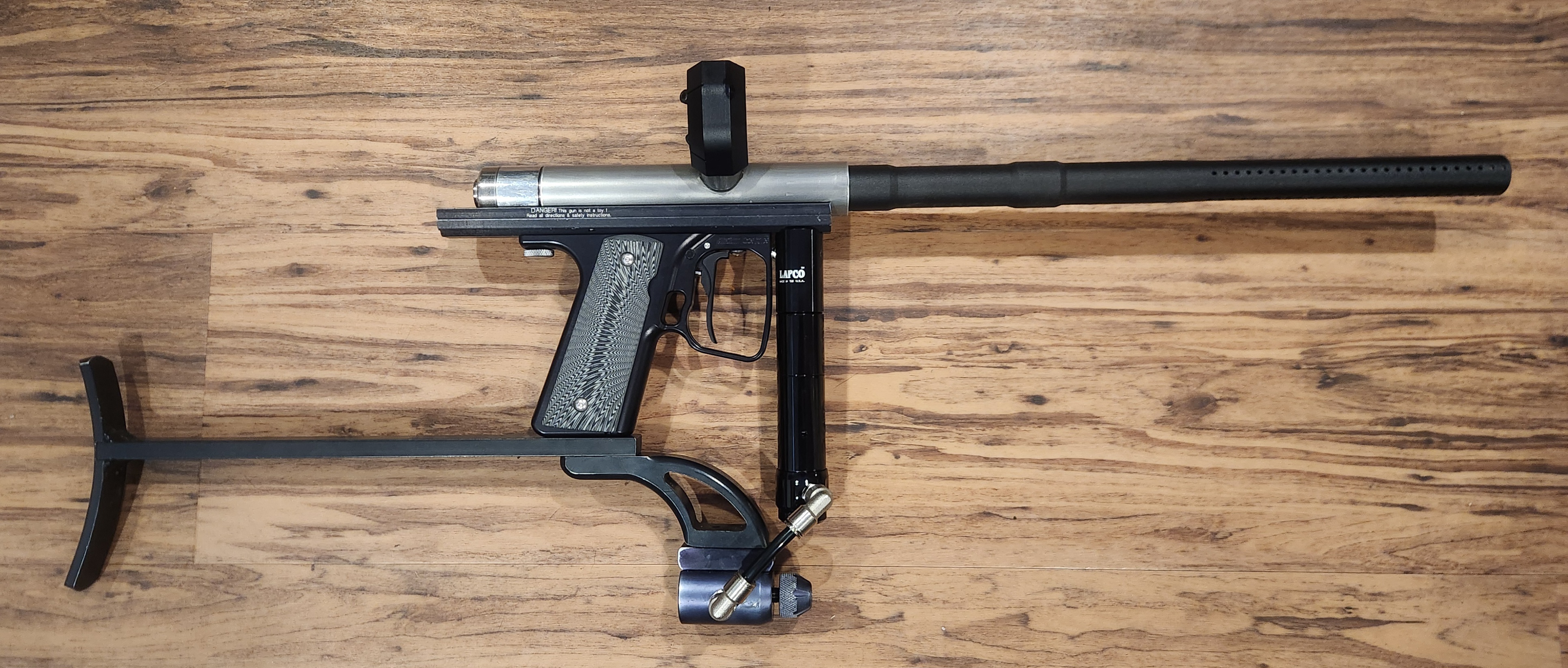

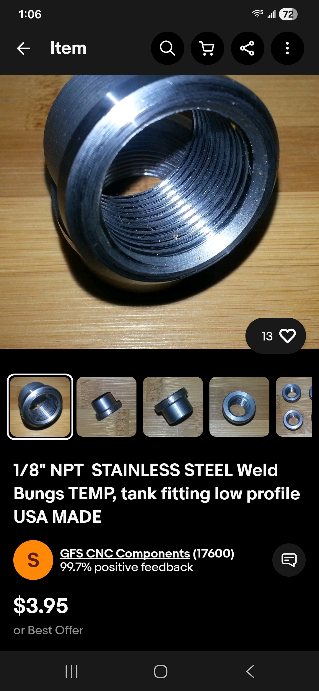

    Mag work had been on hold for a few months pending completion of this cut down cap project. I had been reading about custom made valve caps which allow you to manage the pressure in the gun using an ASA mounted HPR. As good as the built in reg is, I couldn't help but think that moving the regulation duties to a more modern reg would be a good thing. I gave 3 mismatched serial or aftermarket valve bodies to a local shop that specializes in stainless steel work, mostly for brewery rigs. I included 3 x 1/8npt stainless weld in bungs, of a type that had the perfect OD to fit into the smoothe part of the regulator bore.
    I also gave them a valve front that had a scratch inside the on/off that kept it from sealing properly. This allowed them to mount the assembly in a lathe to cut the rear of the valve body off. After the cut they would weld the bung into the back and I would have a cap with a 1/8npt female for a guage.
    It took 3 months for them to finally get to it, but they did. In yet another example of small town livin', they refused payment. I guess my giddy schoolgirl joy was payment enough for them.

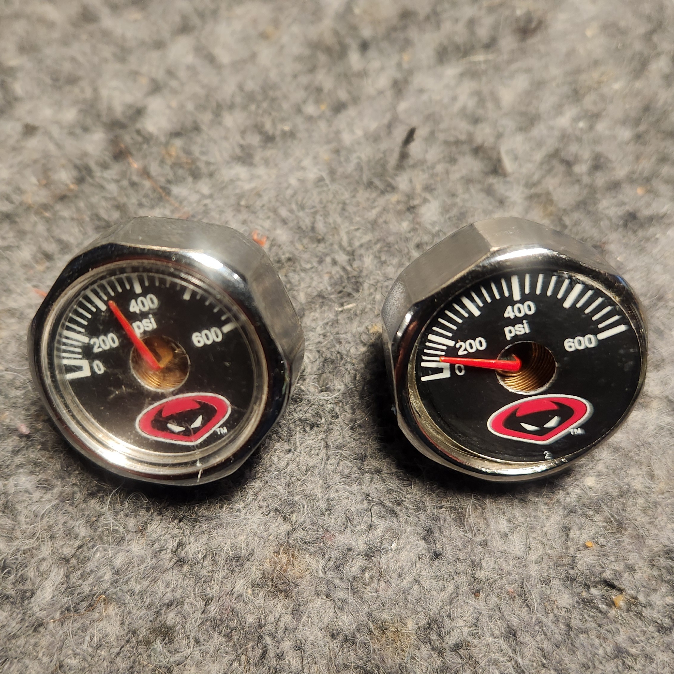

    I ran home and mounted it on a dusty mag that had been sitting for months awaiting this moment. The reg seal, reg pin, and reg spring had been removed. Within 10 shots, the dial on the guage started rotating internally and the guage broke. Hmmm, I say to myself. I mounted another guage. Within 10 shots that guage started rotating internally, and then the plastic lense cover popped off and the guage jutted out. It appears guages don't like whatever pressure pulse goes on in that area of the gun.
    Undaunted by this fully expected and almost assured dose of failure, I put a 1/8npt plug in and sent it. The gun runs great!

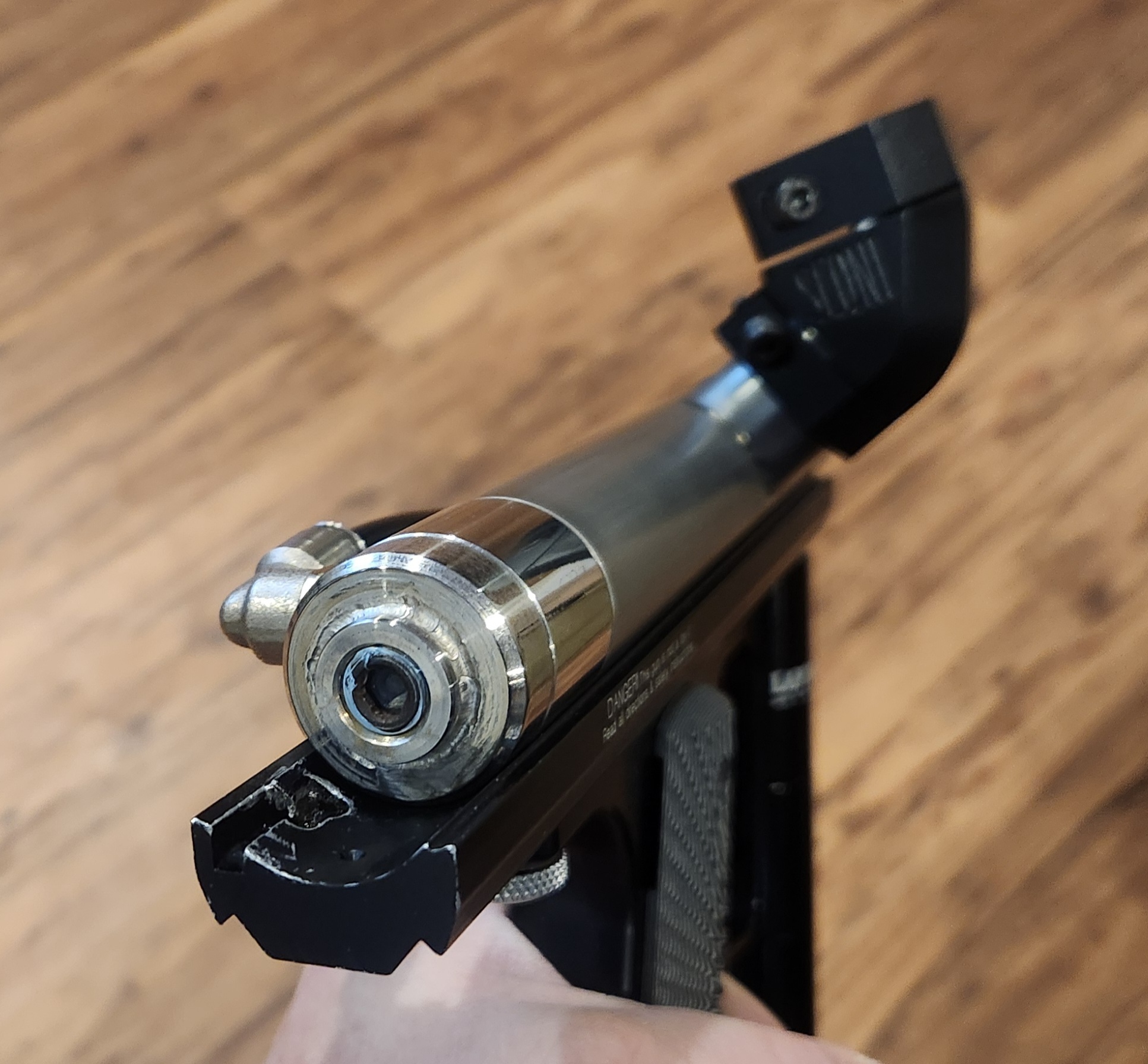

    20260206_130436.jpg I am going to cut the rear of the rail down about 1/4" inside of the back of the cap and call it a day. I need to order 2 more sidewinders and then I can install the other 2 caps. I'm ultra chuffed that this finally came to fruition!

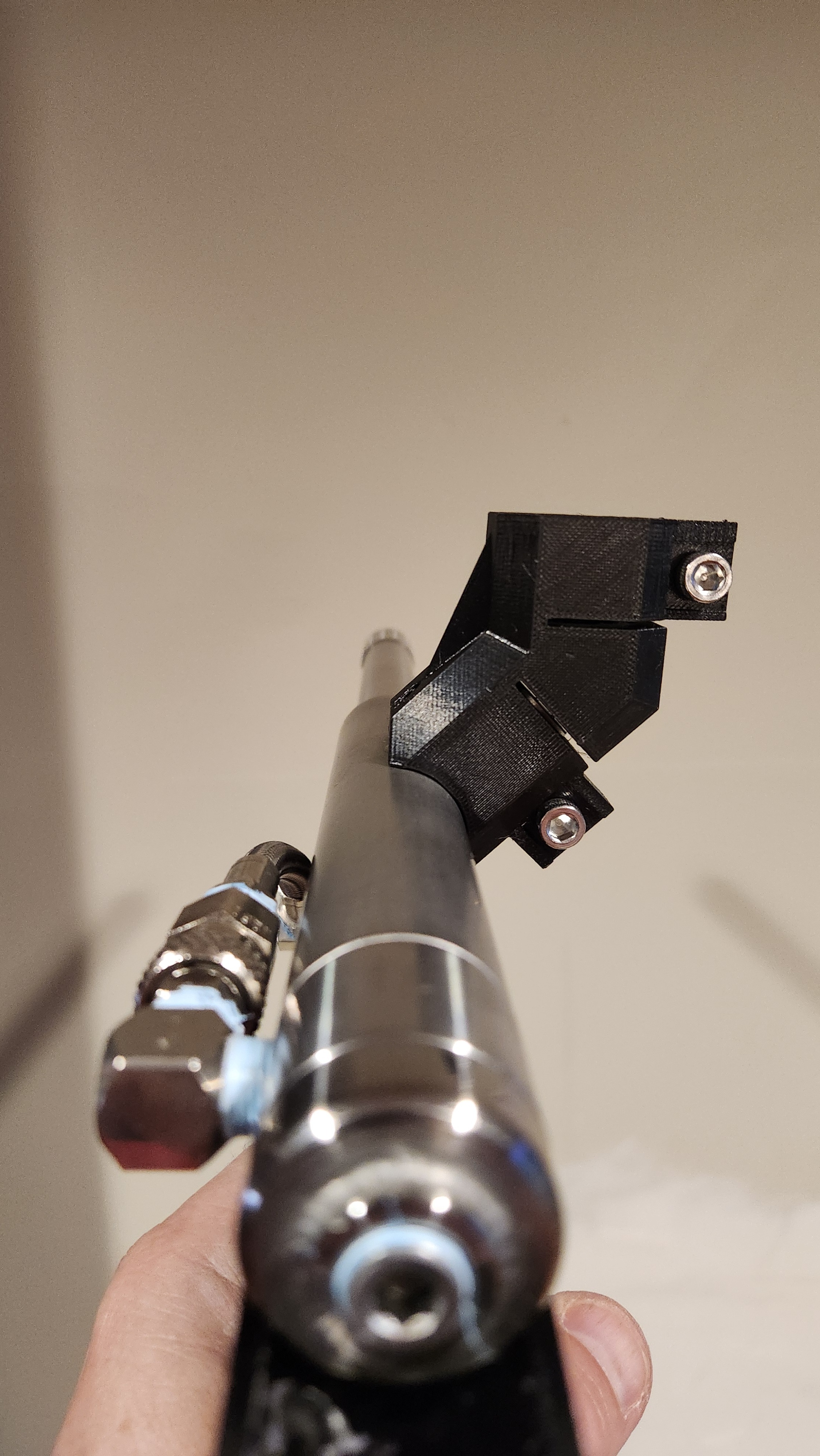

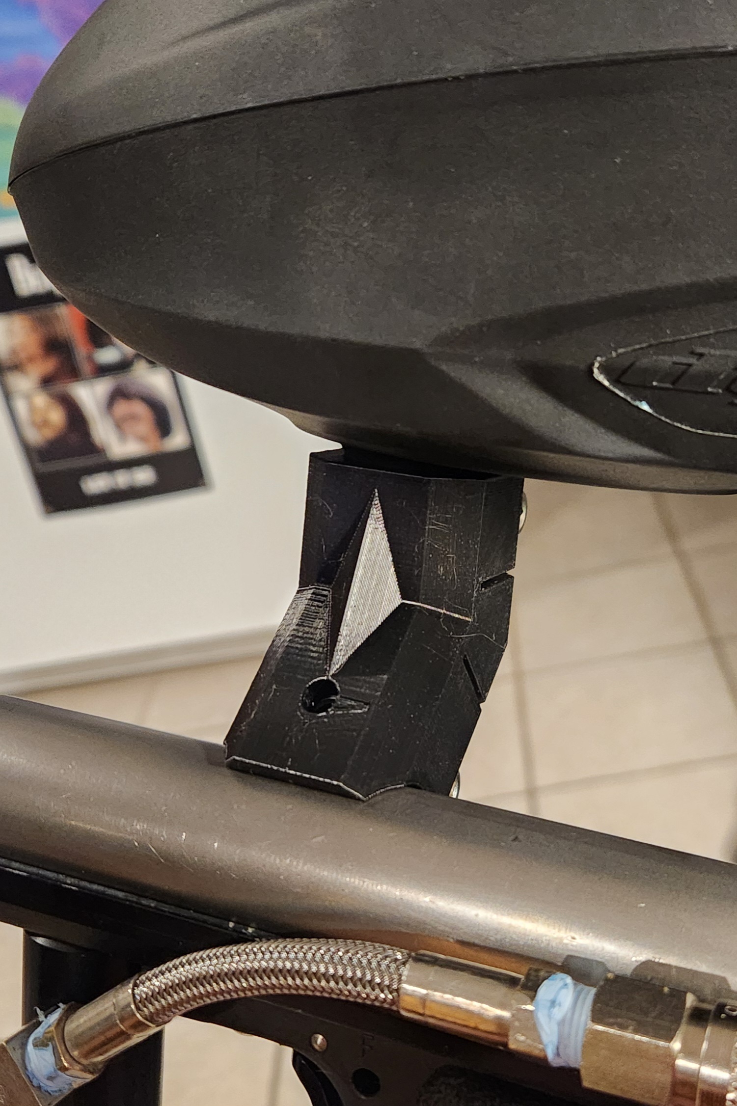

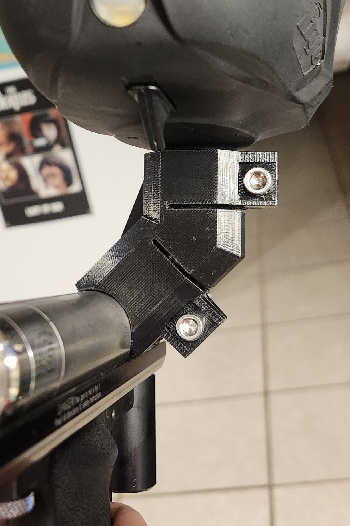

      Waiting on the last sidewinder reg to finish these 3 mags. I had the sudden epiphany a couple days ago that a warpfeed left body with a 90 degree elbow would be fantastic for a righty such as myself. The loader would be hidden and very low on the gun. I started looking for one and realized that its gonna be a process to find one. So, I figured I would practice at the design concepts for the required custom 90 elbow by making a normal 45 elbow for my last RF classic mag. It came out very well. It's a chunk, but it is beefy strong. The body fitting round bottom gives it a nice stabilizing mechanical lock. I made it out of PETG, which seems plenty strong for use. If it gives me any issues, I will get a roll of PETG-GF. Now I just need to find a warpfeed left body so I can make the 90 elbow for it.

        Nice! I really like how you incorporated the shape of the body into the elbow. It works for support and orientation but also just cleans up the lines of the elbow on the feed neck. I like the geometric gusset as well.

          Thank you, Sir. I figured it could use a little extra beef to restore the stiffness the clamping relief cutouts removed. It might be overkill because gravity is pulling the parts together, but I wanted to be sure it could resist the bouncing upward motion when one is running.

        I did one more change and cut the slope of the elbow along the centerline of the body. Gives a better reference for snap shooting.

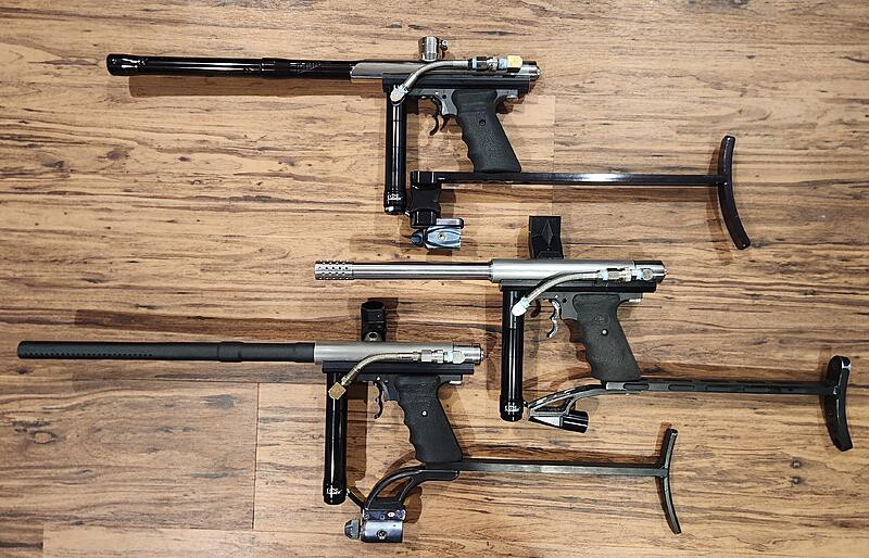

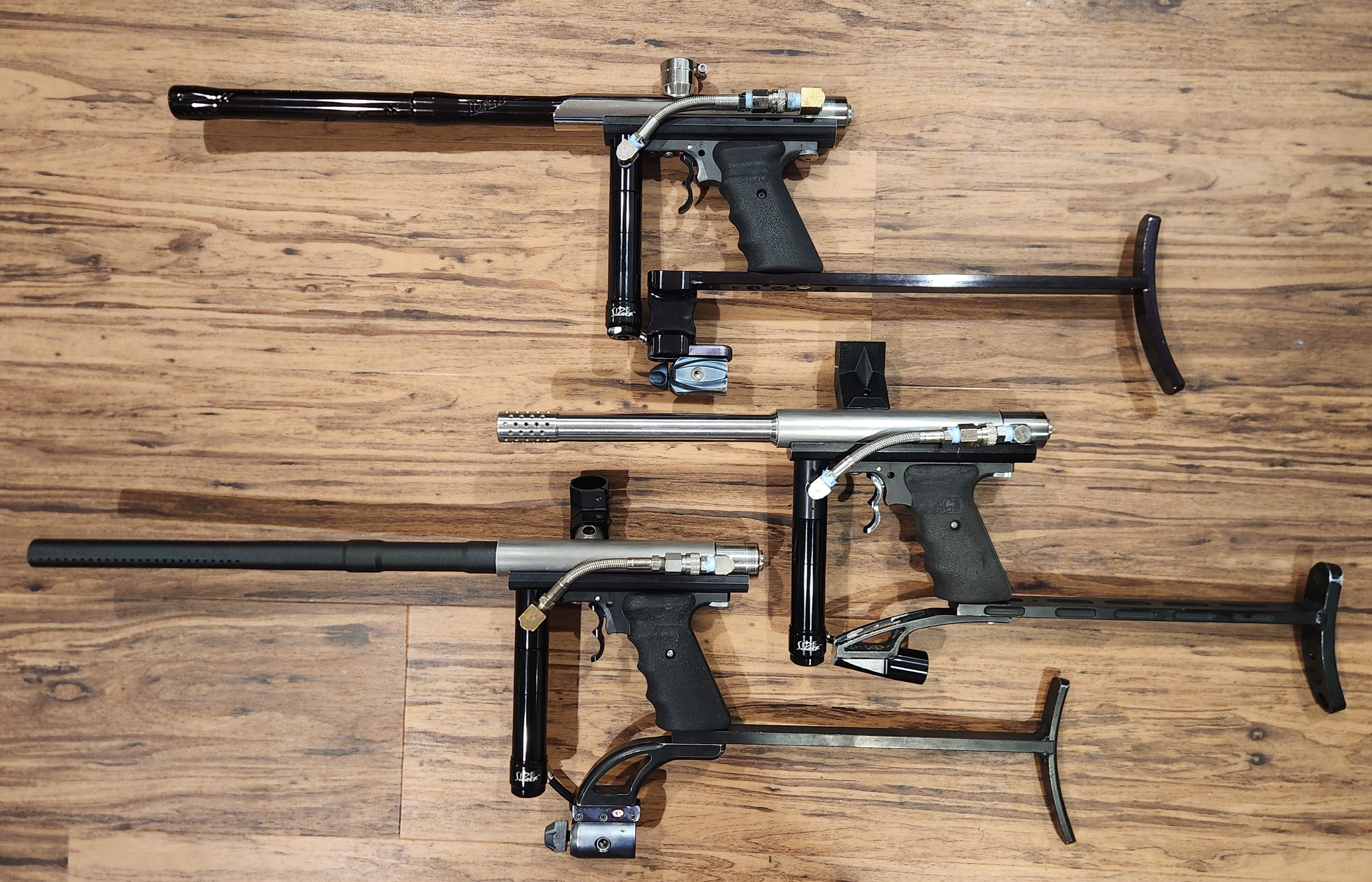

          It is with tremendous excitement that I announce the completion of my winter project. I know there isn't a minimag in sight, but I think that's part of the journey with these things.
          I present to you all, The Three Sisters!
          I had a small hitch with the last of the Sidewinders blowing air out the vent hole when installed. Jared from destructivecustoms.com got me squared away in record time, and it's good to go. Highly recommend his product and service. Just trimmed the last two rails down and chronoed them all out. Ready for the season!
          I have several other projects ongoing, but every time I pick one of these up I am amazed at how ahead of their time they are. They are just plain fun to hold and shoot. Great job, Tom!!!!
