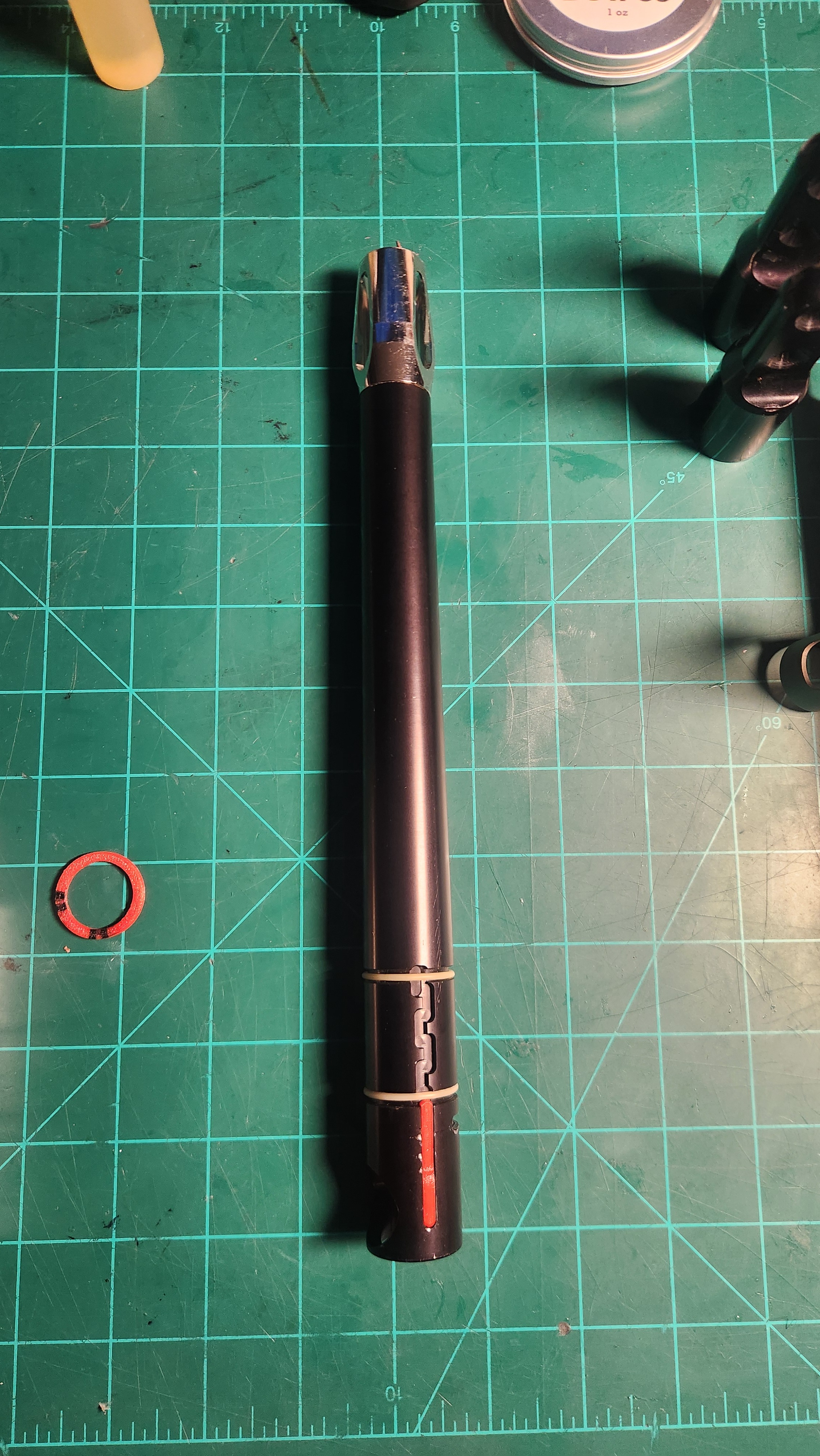

          Hi Calvin, do you use an o-ring pick and if so, which type? I have a metal dental pick, but debating if I should get the polymer plastic ones on Amazon.
          Hi Trbo323 - Thanks for your suggestion and Airgun Designs part website went up, so I'm following the recommendation to use a proper kit versus BUNA.
          MCB Community - Any suggestions on the best way to clean up the powdercoat body? Mine seems slightly stained and uneven in color. Maybe it's oil and a hot warm bath might be the best remedy.
          • Calvin
            Old n' Quick
            • Sep 2025
            • 486
            #35
            I have a dental pick that has a flat end, maybe 1.5mm wide. It slides well under orings. If the oring is going in the trash, I gently cut it half way through with a fresh xacto so it stretches easily and doesnt put up a fight. I will look into those polymer picks. Didn't know they exist.

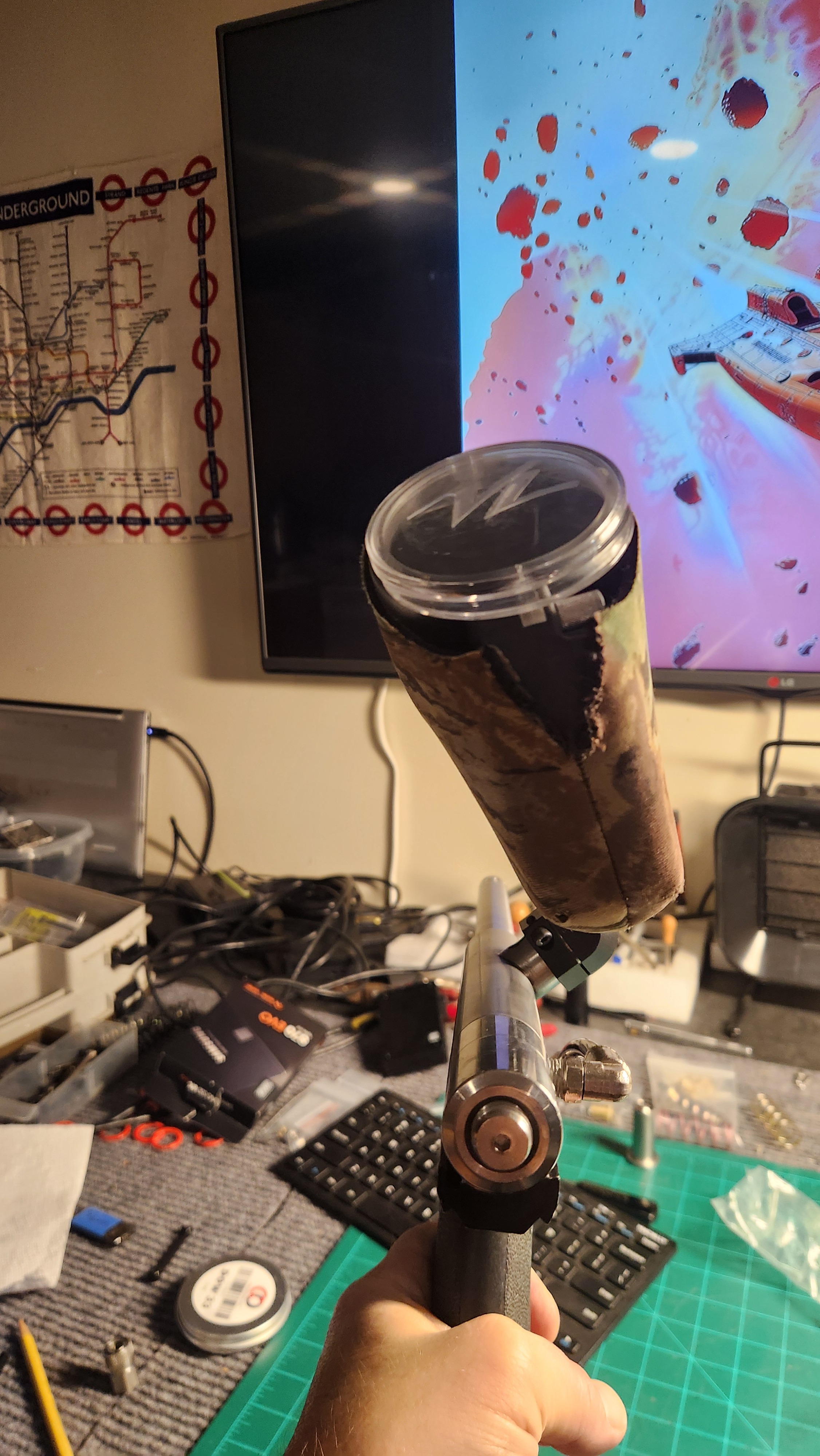

                I played yesterday for the first time in 17 years! I'm glad I did this, as I realize how much I missed the experience. The good folks at Cliff Edge Paintball had 2 large groups I was able to pick up with. The very nice shelter at the facility came in handy when thunderstorms blew through at the end of the day.
                Although it wasn't all rainbows, I am pleased with the choice of the Automag platform. I like the way it feels and shoots. Yes, its a bit heavy, but anything with a tank and a full hopper of paint strapped to it is.
                I will refer to my mags as 1, 2, and 3. 1 and 2 are twistlock setups. 3 will be a docs adapter setup, and I am waiting on some parts to finish it. 1 and 2 both had 12v x-board revvies. Paint was Valken Graffiti. I started with 1, my best setup. I had a 12 " Dye SS with a single TPU detent.
                Game 1: I chopped a ball badly. We're talking pieces blowing out the powerfeed port. Based on subsequent games, I blame myself. Trigger control and weird tilt angles were my fault.
                I grabbed 2 with the RT Stock barrel w/double tpu detents and ran back for Game 2. Gun ran great. Multiple eliminations. In game 4, I leaned right to take some shots and saw a kid in a bunker closer than I expected already shooting at me. I still have very fast reflexes from a lifetime of Ultimate frisbee, and pulled right back into cover. Sadly, my revvie sailed serenely out into the open, adhereing faithfully to Newton's law of motion.
                After bolting the revvie back on really tight, the gun ran great the rest of the day. I did shoot my own cover twice as I popped out to shoot, and that blasted paint into the muzzle of the RT barrel. It shot a bit wonky the rest of those matches, but didnt break subsequent balls. Post game cleanup showed no paint behind the muzzle brake in either instance. Inspection this am shows no paint in the body of the gun whatsoever.

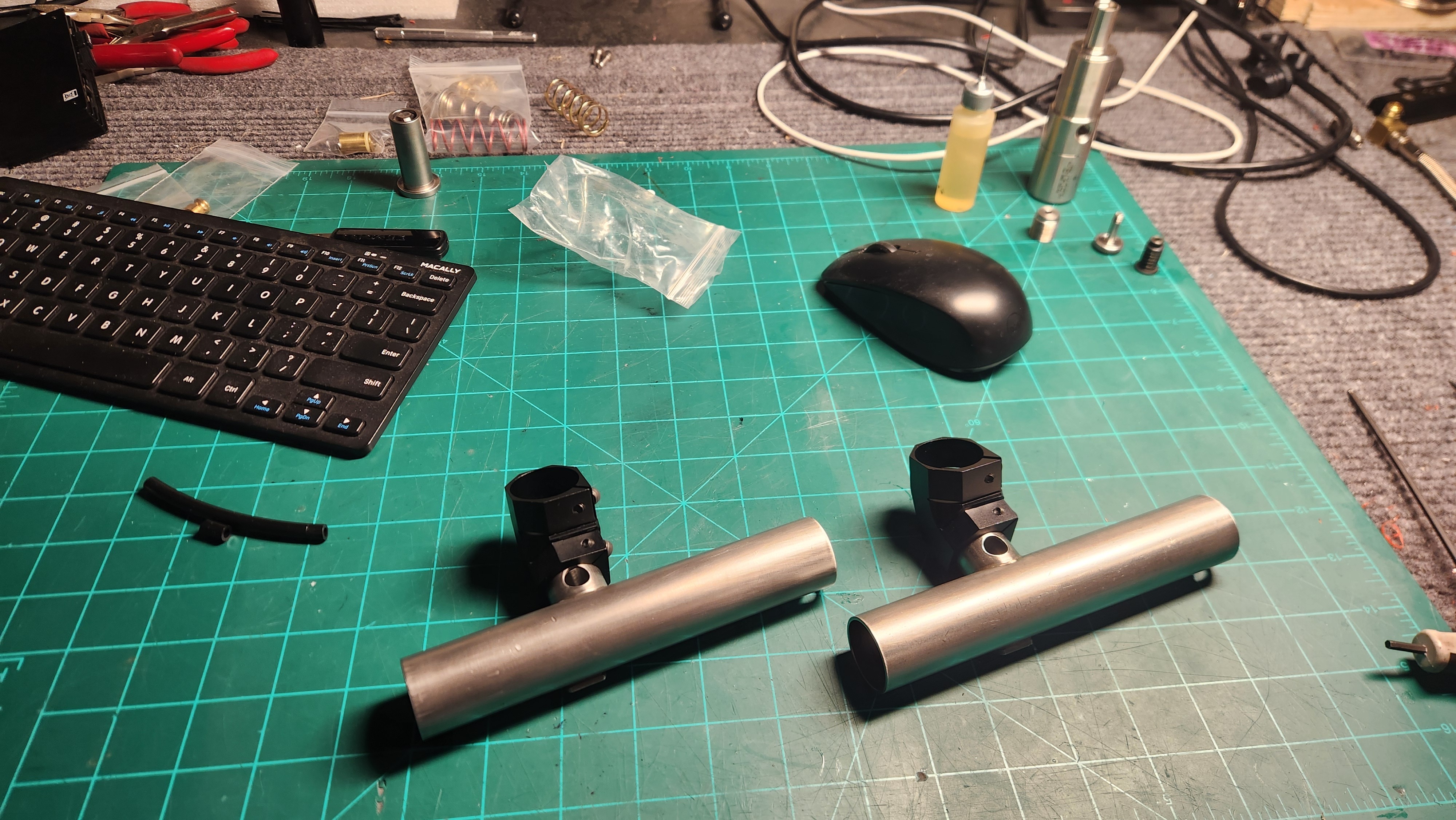

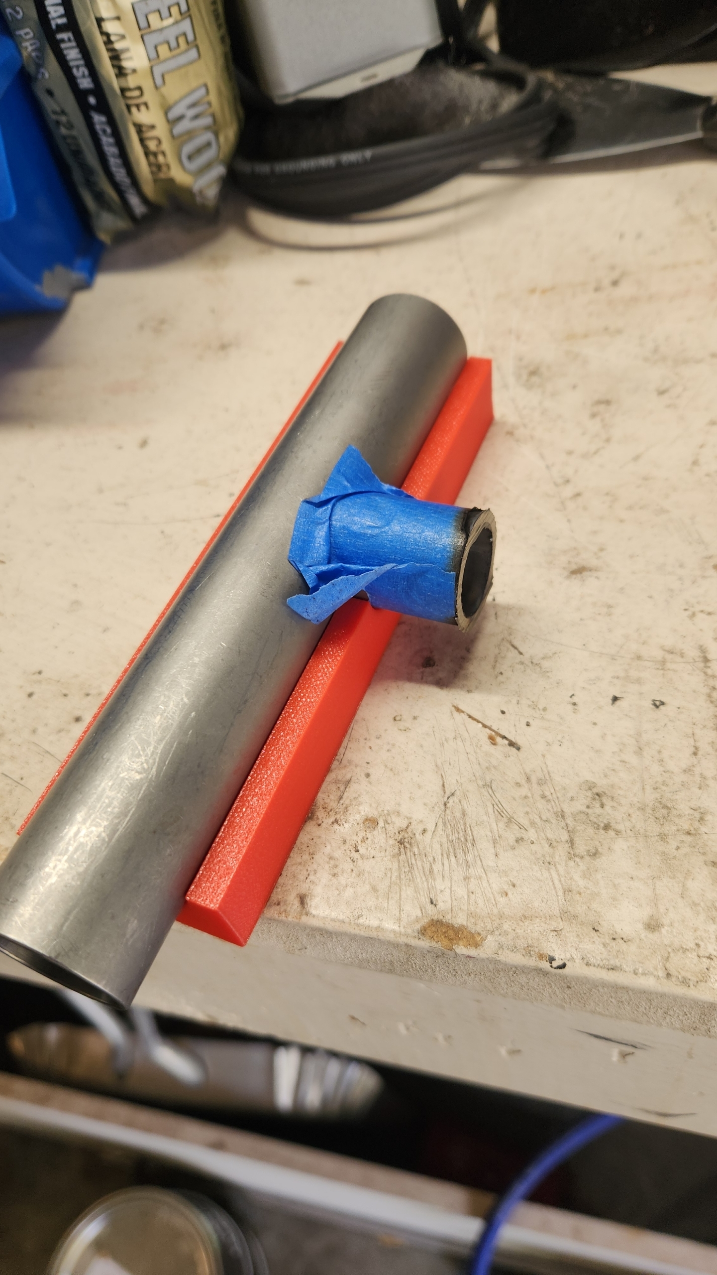

                            I got my hands on a couple classic right hand feed bodies last week. Got some time today to get the cuts done on them to fit the Sconi lean elbows I have procured. Since all I had was my 10" chop saw, I 3d printed up a cutting jig so I would get a square cut. After all the finishing work and cleanup, I just got the first setup together. It really gives me the sight line I was looking for. I also love the way it centers the mass of the loader over the centerline of the gun, and lowers the loader compared to the power feed. I need to buy a couple Dye ltr loaders, and the properly sized braided hoses to replace this macroline. After that, I think I will have 3 excellent paintball guns. I am also rebuilding my 4th valve into a level10 setup, so I can try that out. Excited as hell to get back out there on the field with these!
