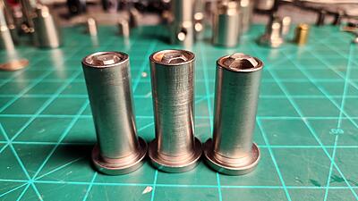

    These are the three decent bolts I have. I believe the left 2 are "short nose" and the other is "long nose". Research indicates people generally prefer the long nose style. If I do a force feed hopper, it will only be with Doc's double detent AC adapter. Otherwise, it will be twistlock with BW detents. Are these two bolt styles both good in those circumstances, or should I scrape up one or two more of the long nosed bolts?

        #18
        They should all work fine
        The long nose will have slightly less chance of choping.
        that said, I have used a concave multiport ANS bolt on my ULE classic mag with no chopping issue. I am usually using a revvy with it.
        Automag are usually low maintenance and don't really need an upgrade appart the parabolic powerfeed plug (help prebent jamming on powerfeed body) and even this I would not stress using an older plug in the meantime.

          #19
          Thanks for the advice. I will use them all and see if there is any difference. I will be using 12v xboard revvy's and a force feed hopper of some yet to be determined kind.

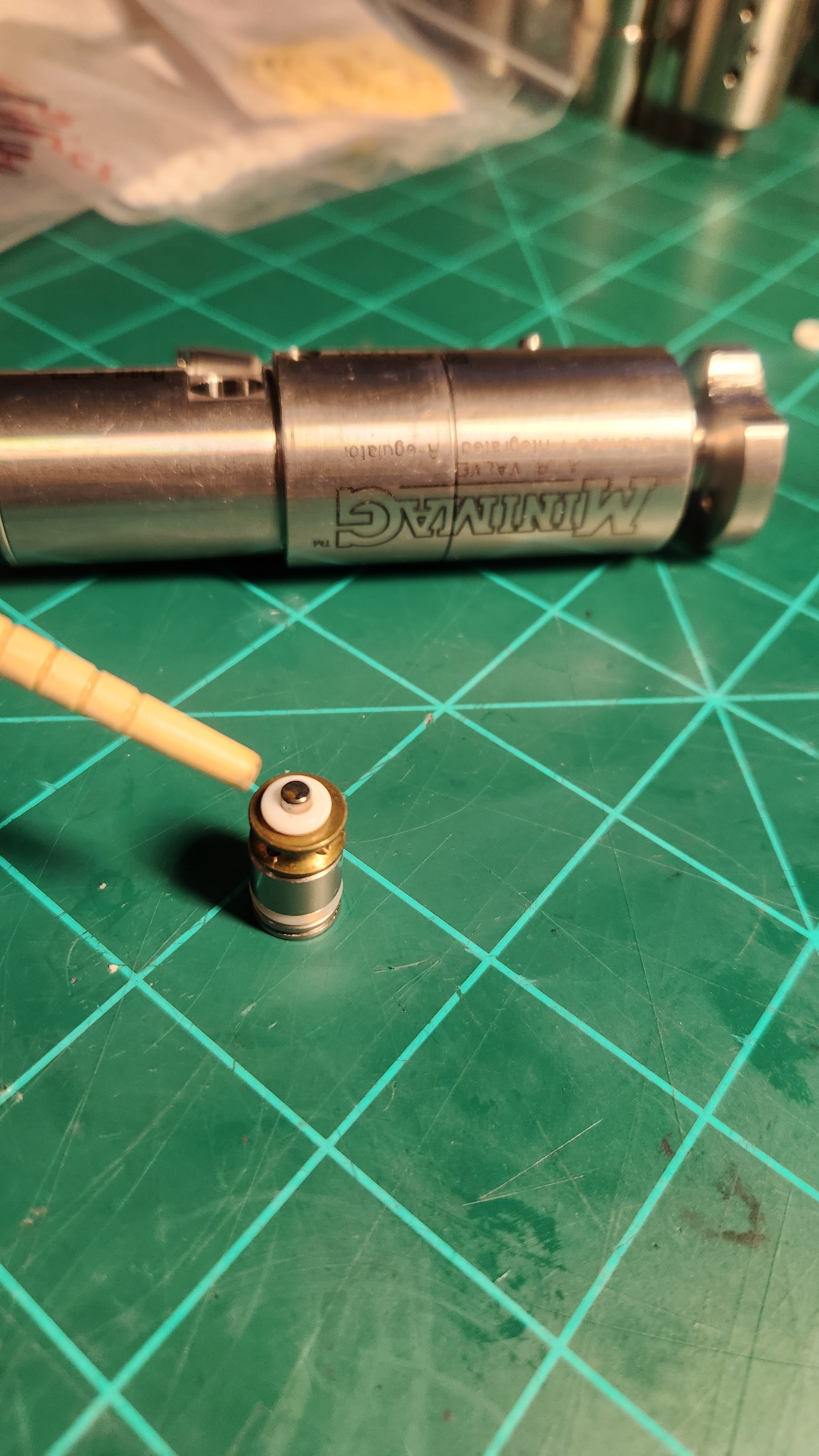

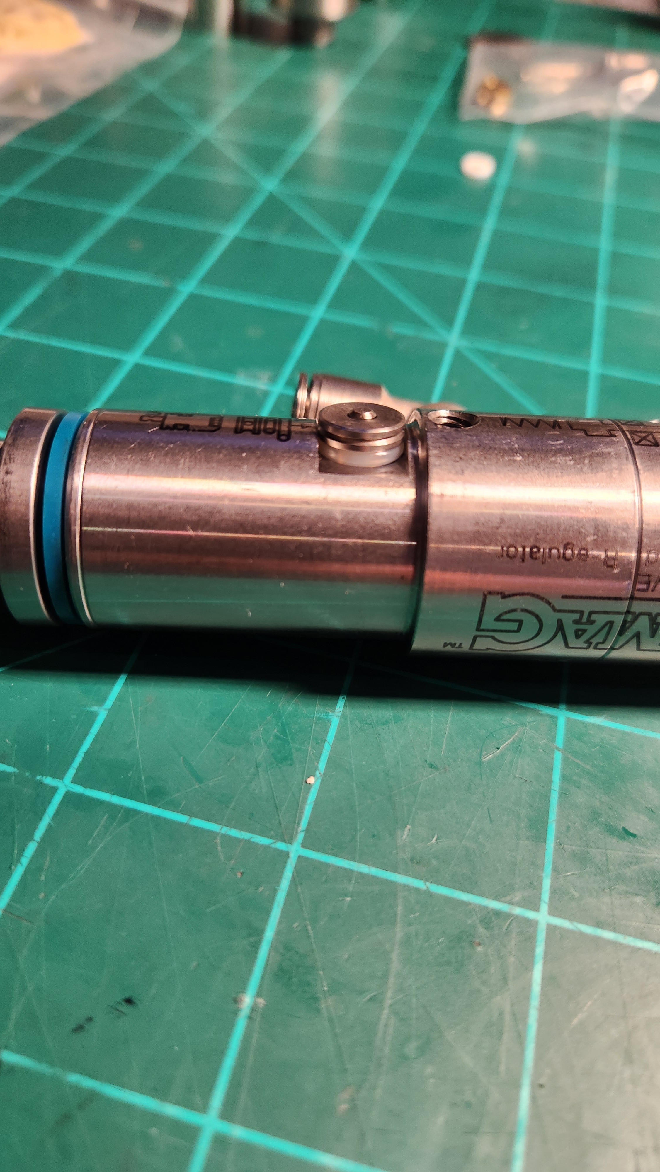

                First run at rebuilding the first valve. Watched Tom Kaye's video while working. Checked the manual as well. On the positive front, it is moving the bolt back and forth well. Sadly, the inner oring of the two under the brass hat is popping out from the outter oring and lifting the on/off assembly up enough to leak pretty well. I tried reseating it with the same result. The more I look at the assembly, it seems logical that it would do this. What am I doing wrong?

                  #23
                  Make sure you don't have another ring lodged down in your valve.

                    #24
                    There was nothing down there. All parts had been broken down and degreased.

                        #26
                        I redid the on/off setup on the 1st mag. No change. I set it aside and re-sealed the second mag. We have a runner! Encouraging.

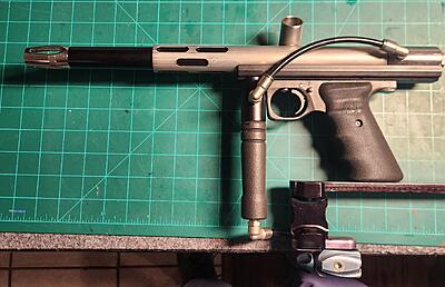

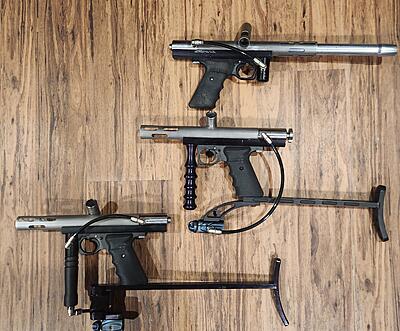

                          #28
                          Against all odds, I now have 3 minimags holding air and chuffing away. The on/off assemblies gave me the most problems, but the pistons all needed their seal flipped as well. Getting on the new AGD shop right now to stock up on factory seals.

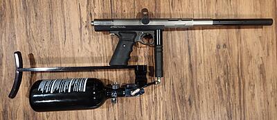

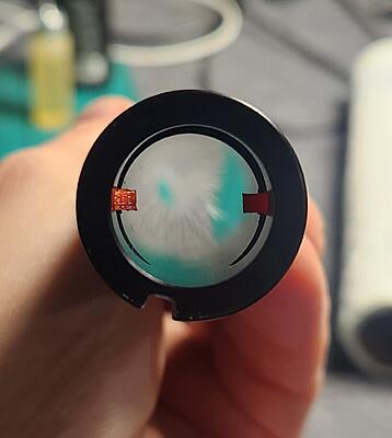

                              #30
