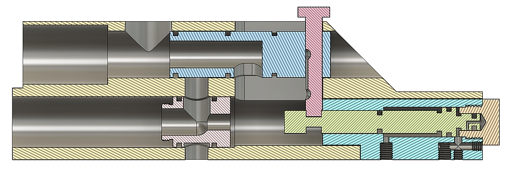

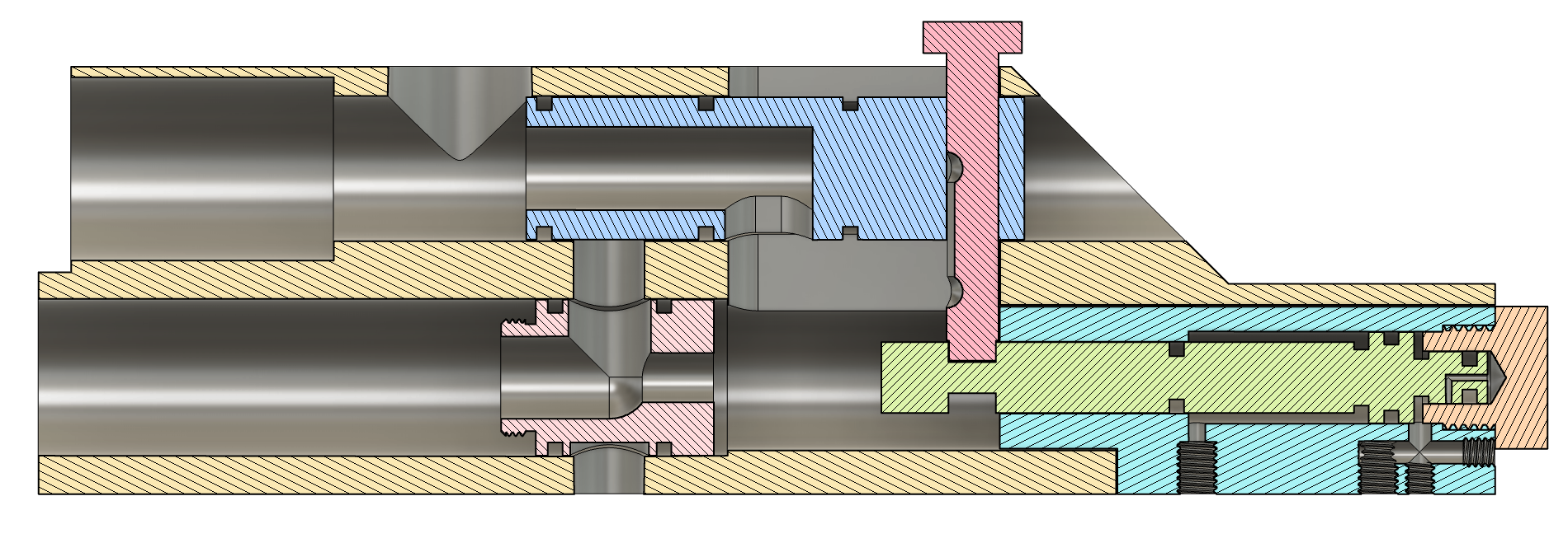

    I realized my original replacement rammer wouldn't work well, since it doesn't have much rearward force to reset the bolt, so I redesigned it and a new housing. I still intend to try a Laz valve in here but that design is pretty much fixed, due to the dimensions of the other parts of the valve, so hopefully the reduced weight and forces of this rammer will still work.
    I modeled it after an Ego rammer including the rammer oring sizes and locations and the Zick cushion feature. The design is constrained by the body of the Promaster, which is why there's that weird routing in the rear of the rammer, but I think this should be manufacturable on my manual lathe. But please point out any potential issues or pain points if you see any. The feedback is greatly appreciated.

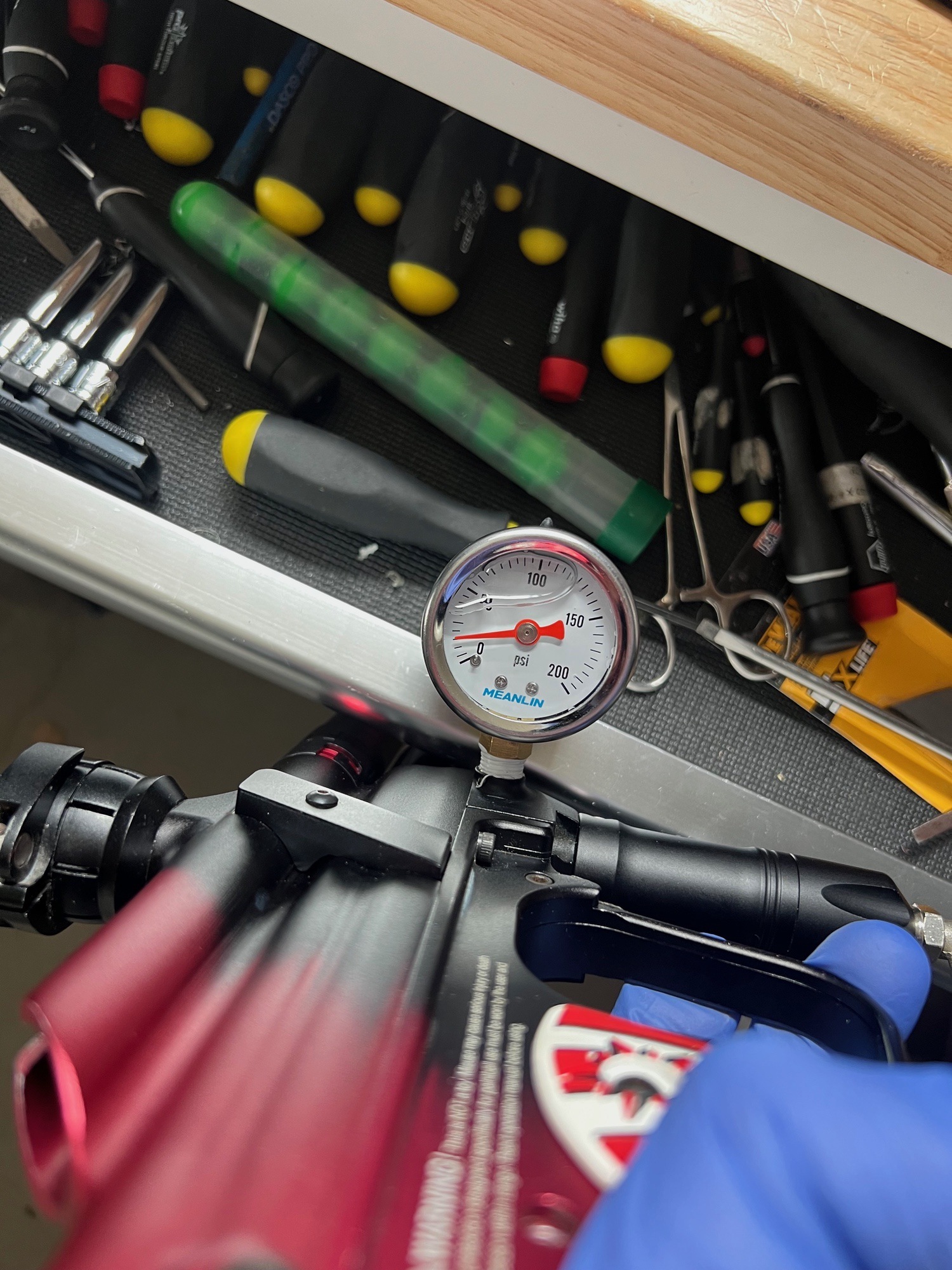

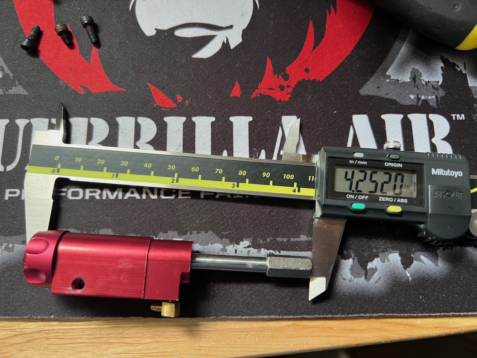

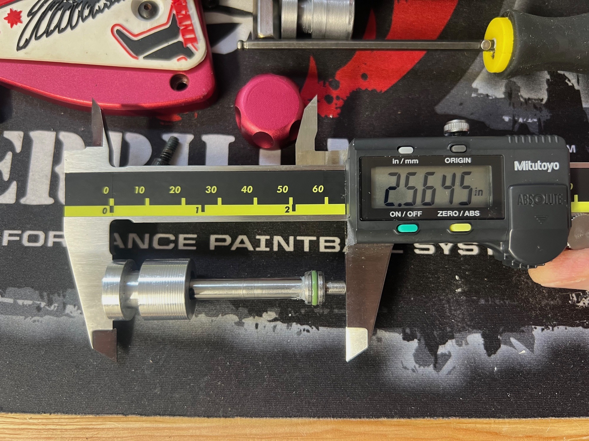

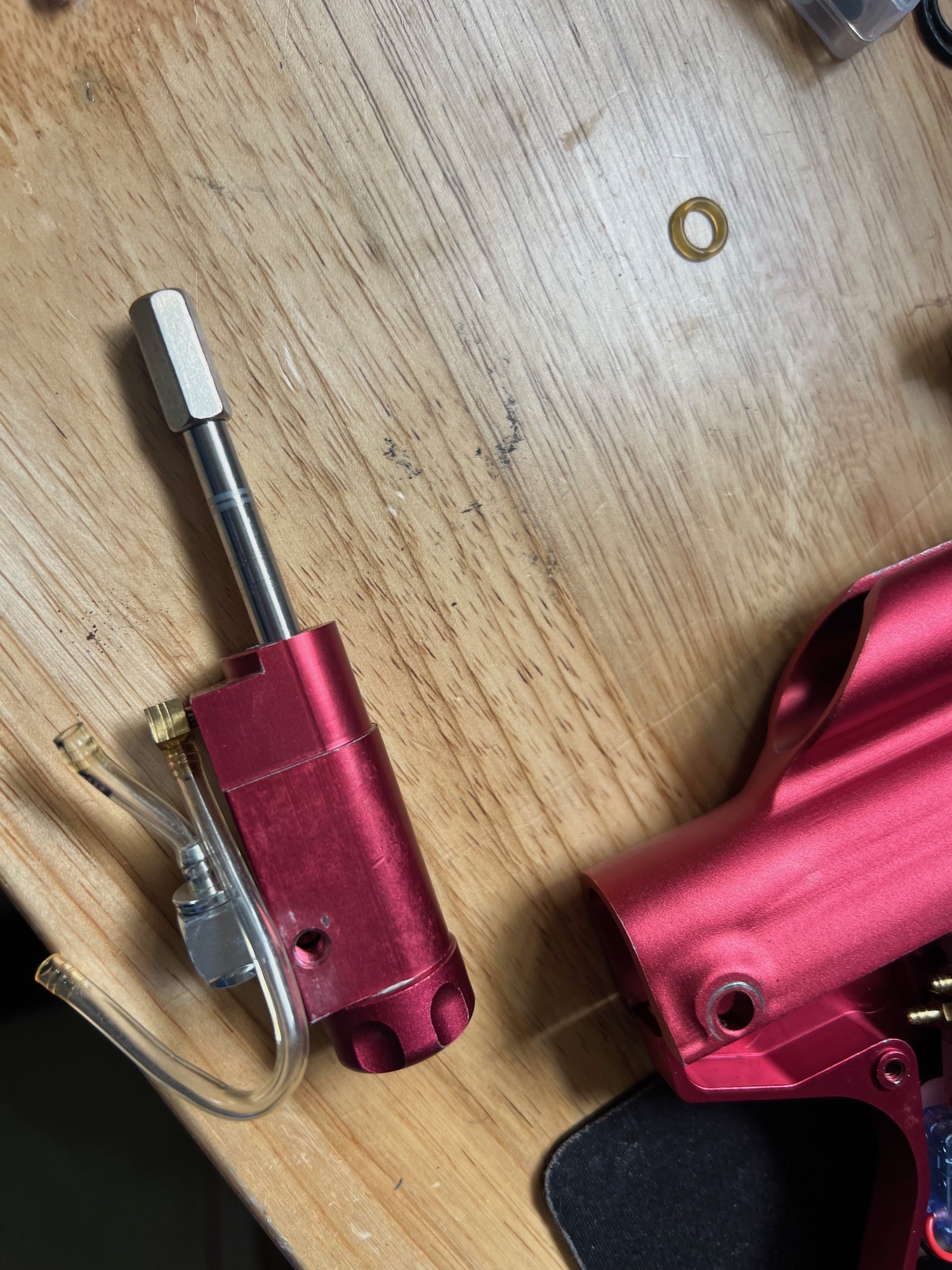

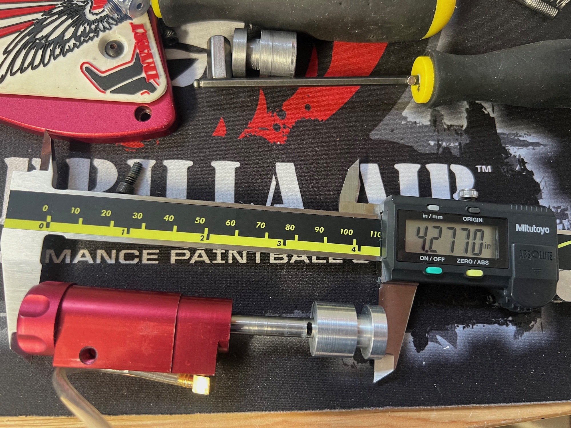

      Okay, good results today.

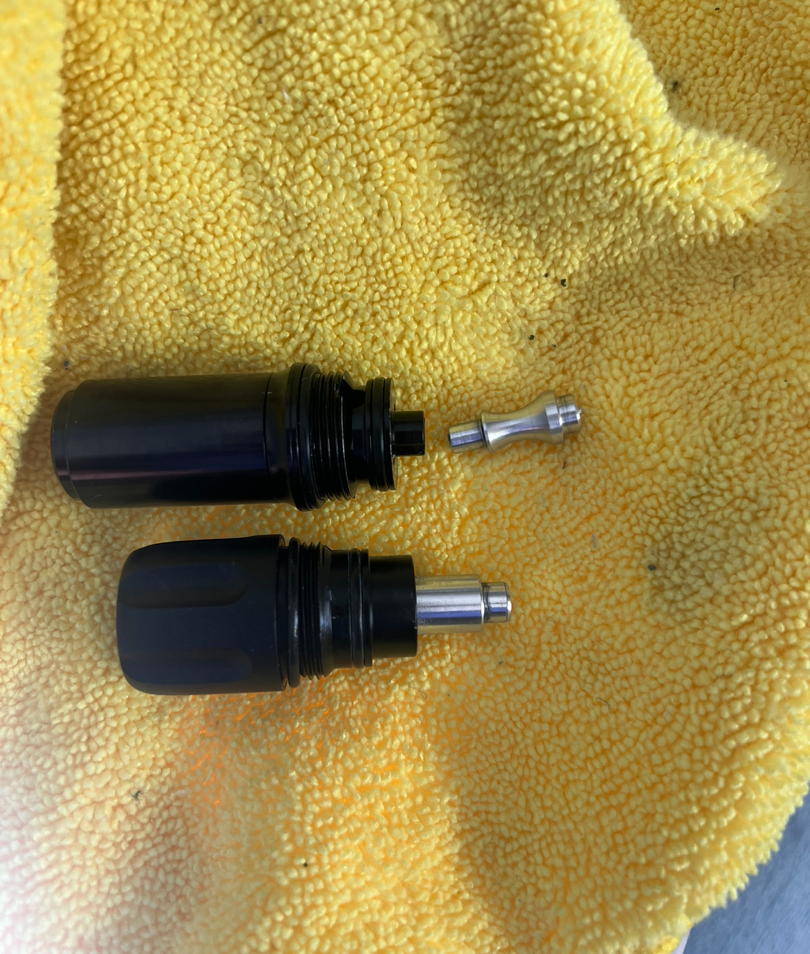

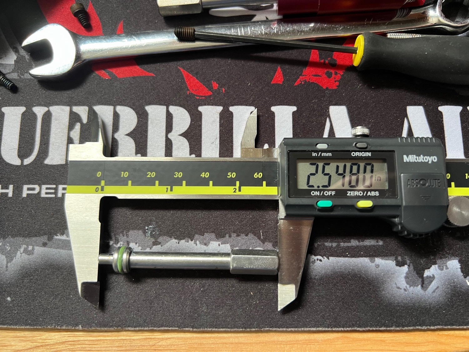

      the piston it’s self was not long enough to reach the valve stem so I added a cocking rod end to help. With this set up I hand loaded and held the bolt closed for each shot. I tested with and without the spring, spring was not needed. I was able to get the marker to fire 280fps @ 160psi & 300-315 at 190-200PSI
      Click image for larger version  Name:	IMG_0469.jpg Views:	0 Size:	884.7 KB ID:	601951

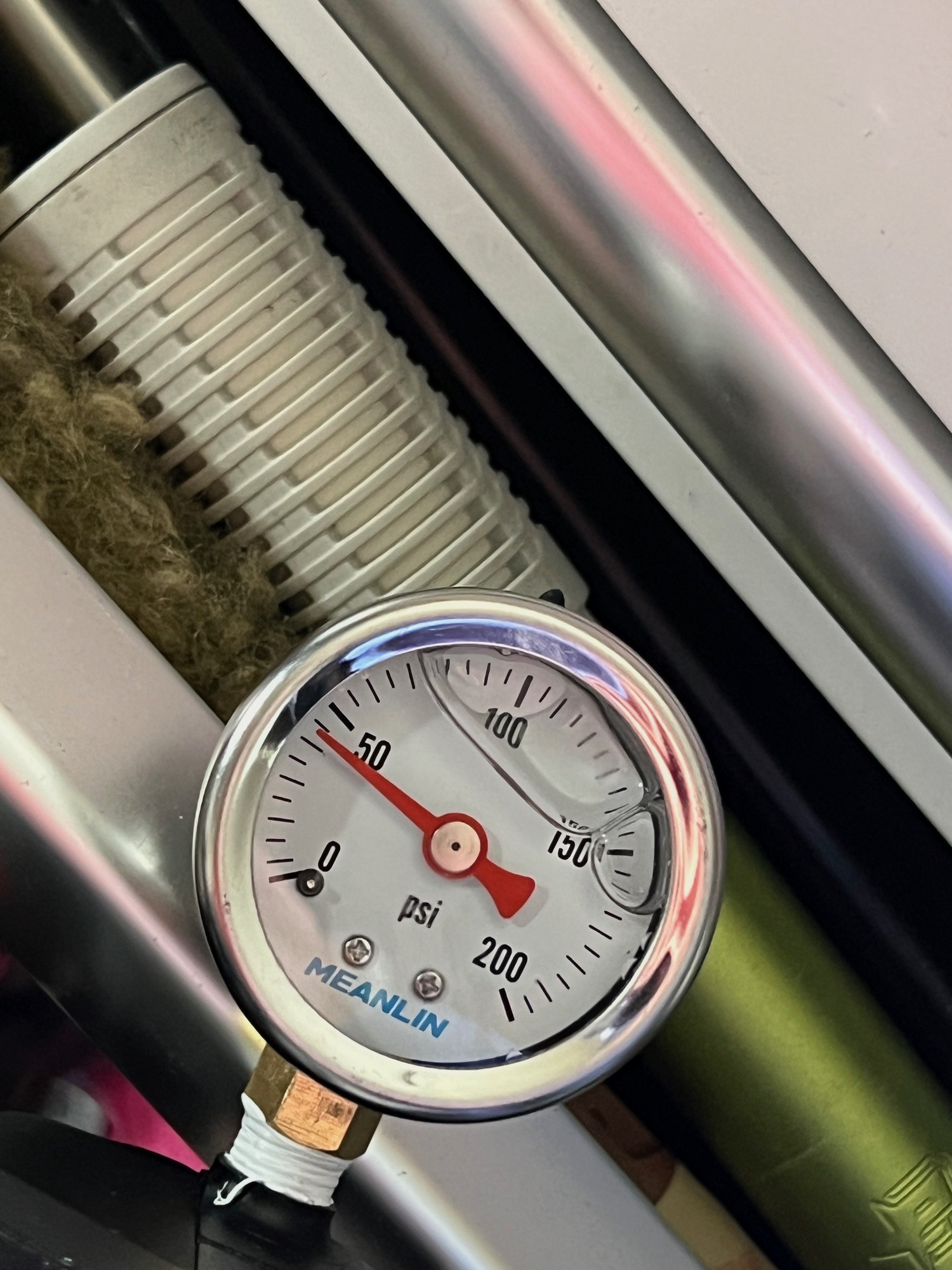

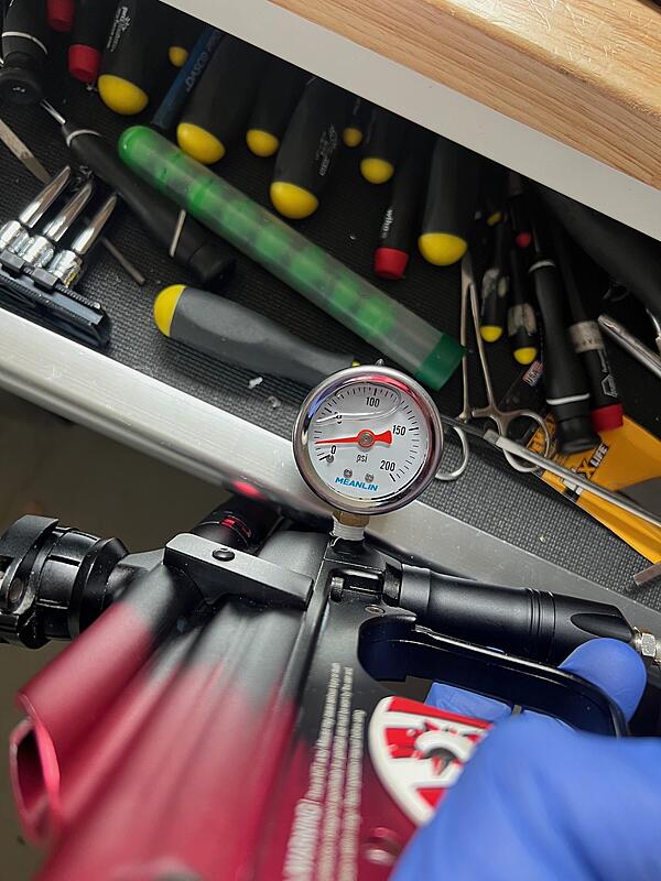

      PSI floor to make it cycle and shoot (LPR)
      Click image for larger version  Name:	IMG_0472.jpg Views:	0 Size:	700.8 KB ID:	601952
      310 fps at 45psi (LPR)
      Click image for larger version  Name:	IMG_0473.jpg Views:	0 Size:	607.9 KB ID:	601953

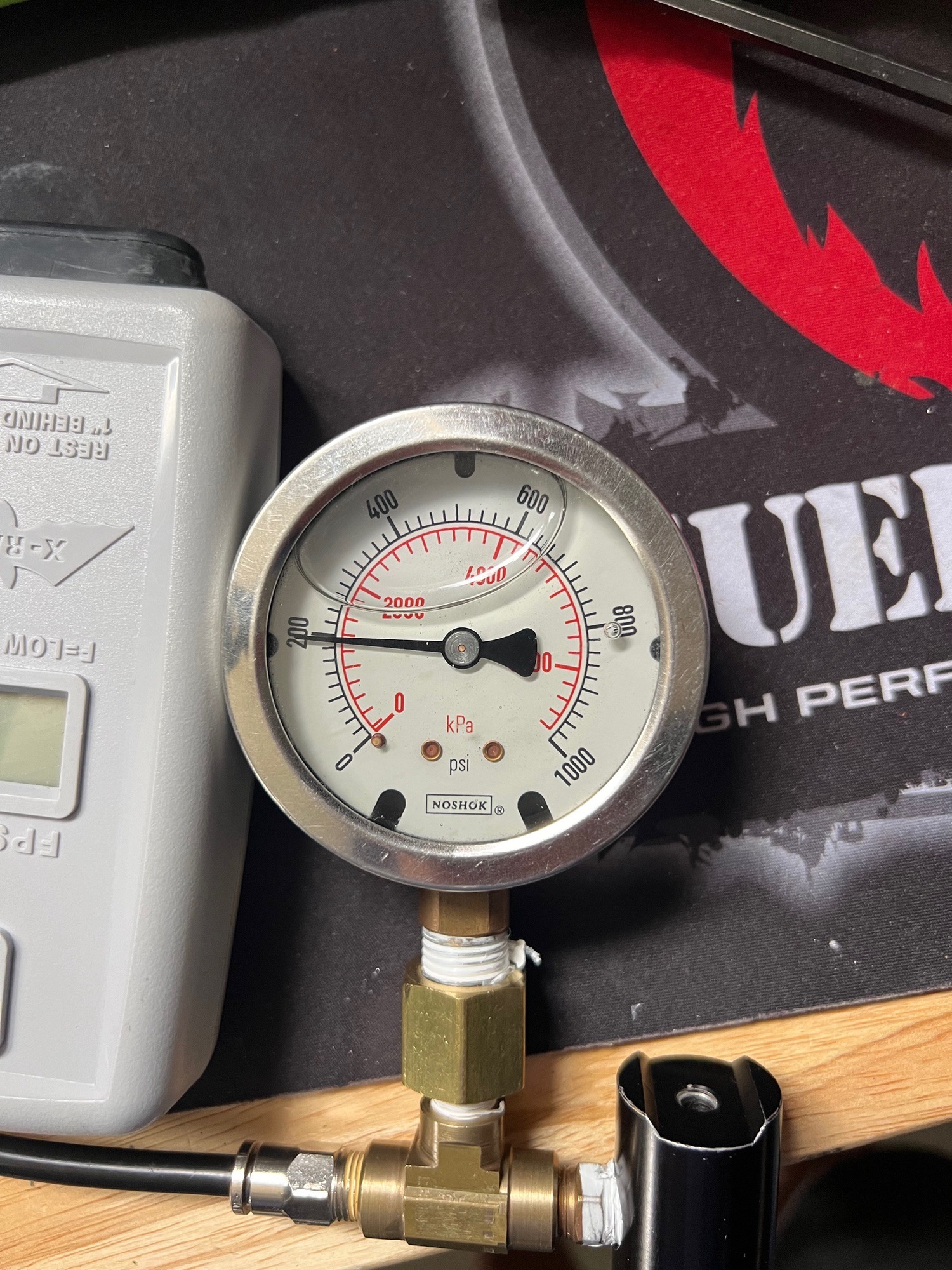

      HPR pressure
      Click image for larger version  Name:	IMG_0477.jpg Views:	0 Size:	904.9 KB ID:	601954

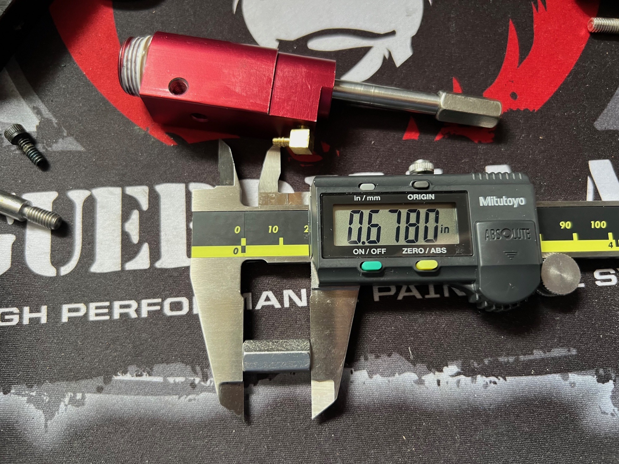

      dimensions
      Click image for larger version  Name:	IMG_0478.jpg Views:	0 Size:	1.03 MB ID:	601955
      Click image for larger version  Name:	IMG_0479.jpg Views:	0 Size:	653.6 KB ID:	601956
      Click image for larger version  Name:	IMG_0480.jpg Views:	0 Size:	1.07 MB ID:	601957
      Click image for larger version  Name:	IMG_0481.jpg Views:	0 Size:	731.2 KB ID:	601958

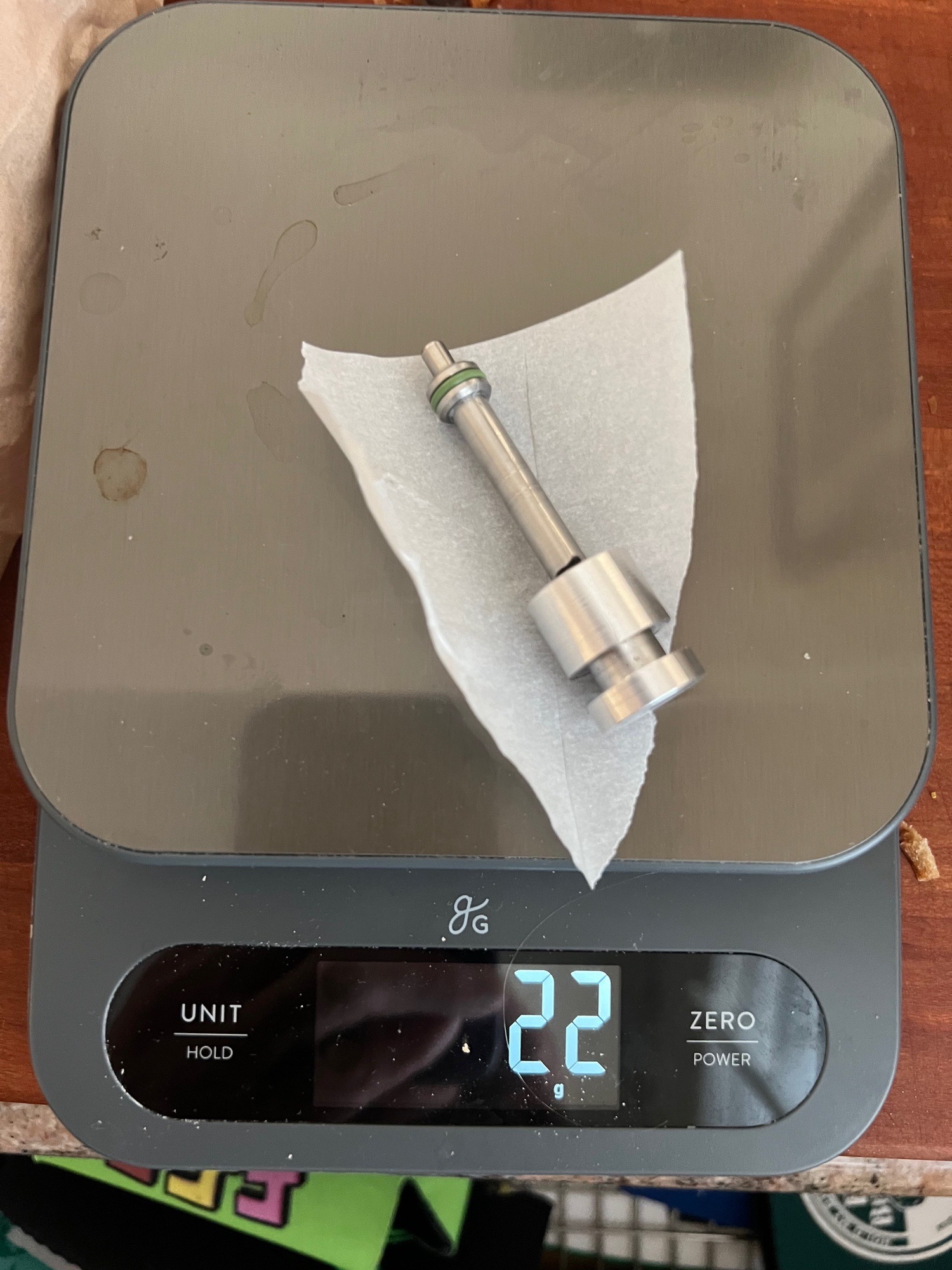

        Next I tested the aluminum hammer tyronejk sent me.
        This test I kept the HPR pressure the same and experimented how LPR pressure would affect the FPS. To get back to the 300PFS the LPR pressure increased to ~62psi. I forgot to weigh the bolt and pin. I'll change the HPR pressure tomorrow and test again.

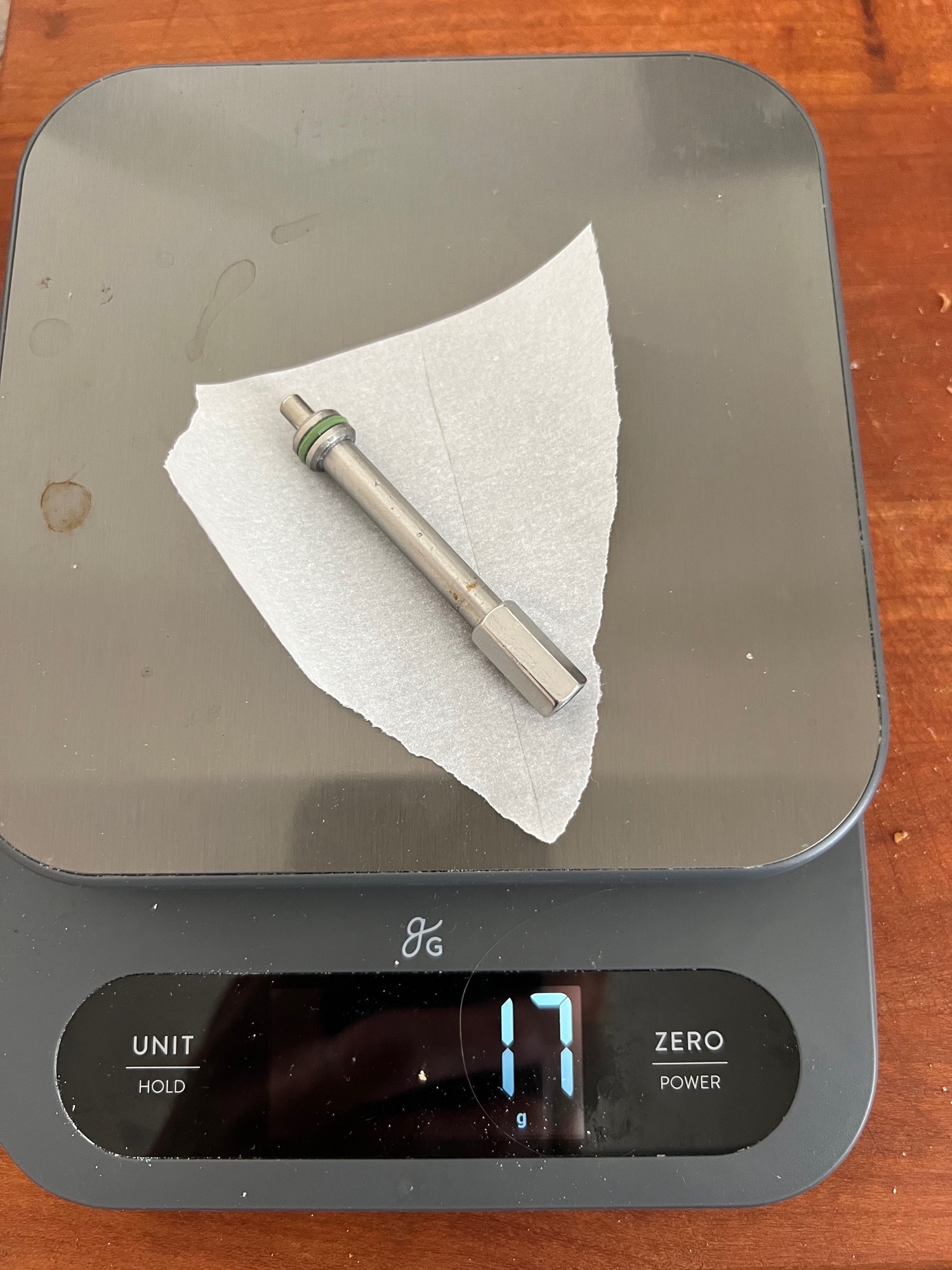

          all in all it felt really nice with the lighter 17g ram only test. zero kick and responsive to LPR pressure. I had thoughts of a fun electronic closed bolt, bolt action first strike build. I'll continue testing and add dwell into the equation later. If you are curious when the LPR pressure increased too much the FPS would drop. For example the pressure in the first test without a hammer the FPS was at 290FPS @55psi LPR pressure. yet 310 at ~45psi.
          you need 65psi to compress the ram spring. Definitely did not have a benefit. Making a ram housing with minimal air loss would be fun to test. We do not need a heavy rammer for the ICDU variant. I have an idea to connect the bolt to the cocking rod end and get a shooting video. I will at least take one with the aluminum ram and a stock ram side by side.

            Are those tests using the aluminum hammer with or without the ram spring? I'd be surprised if you needed more LPR pressure for the aluminum 22g hammer than with the 17g cocking rod.
            • latches109
              latches109 commented
              Without the spring. Probably won’t when the bolt and pin weight are considered.
            • tyronejk
              tyronejk commented
              Gotcha. So the aluminum hammer should work then as a drop-in solution. Maybe it could be made lighter, but I'm not sure how to calculate that.
            • latches109
              Look at the NDZ impulse hammer for Inspiration.

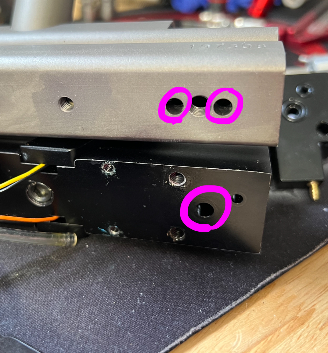

            The ICD valve chamber is larger than the autococker yet needs higher HPR pressure. I realized the vasa supply hole is only 5mm versus 2x 5mm ports on a 2k+ cocker body. So I drilled my body and vasa .5mm larger and sure enough my HPR pressure dropped 10psi.
            HPR - 190psi
            LPT - 60psi
            aluminum hammer
            305fps​
            I want to get to a similar 10mm supply, any ideas?
            • Frmrspec
              Frmrspec commented
              Custom VA? Or maybe an LPR extension to increase the valve chamber… similar to what SP did for the nerve
            • tyronejk
              tyronejk commented
              I considered an LPR extension but since it would require some air passage to supply air to the LPR, it would be either complex, limited increase in volume, or both. But considering this small change resulted in a 10psi drop, maybe just a little extra volume is all that's needed. It's something to consider for sure.

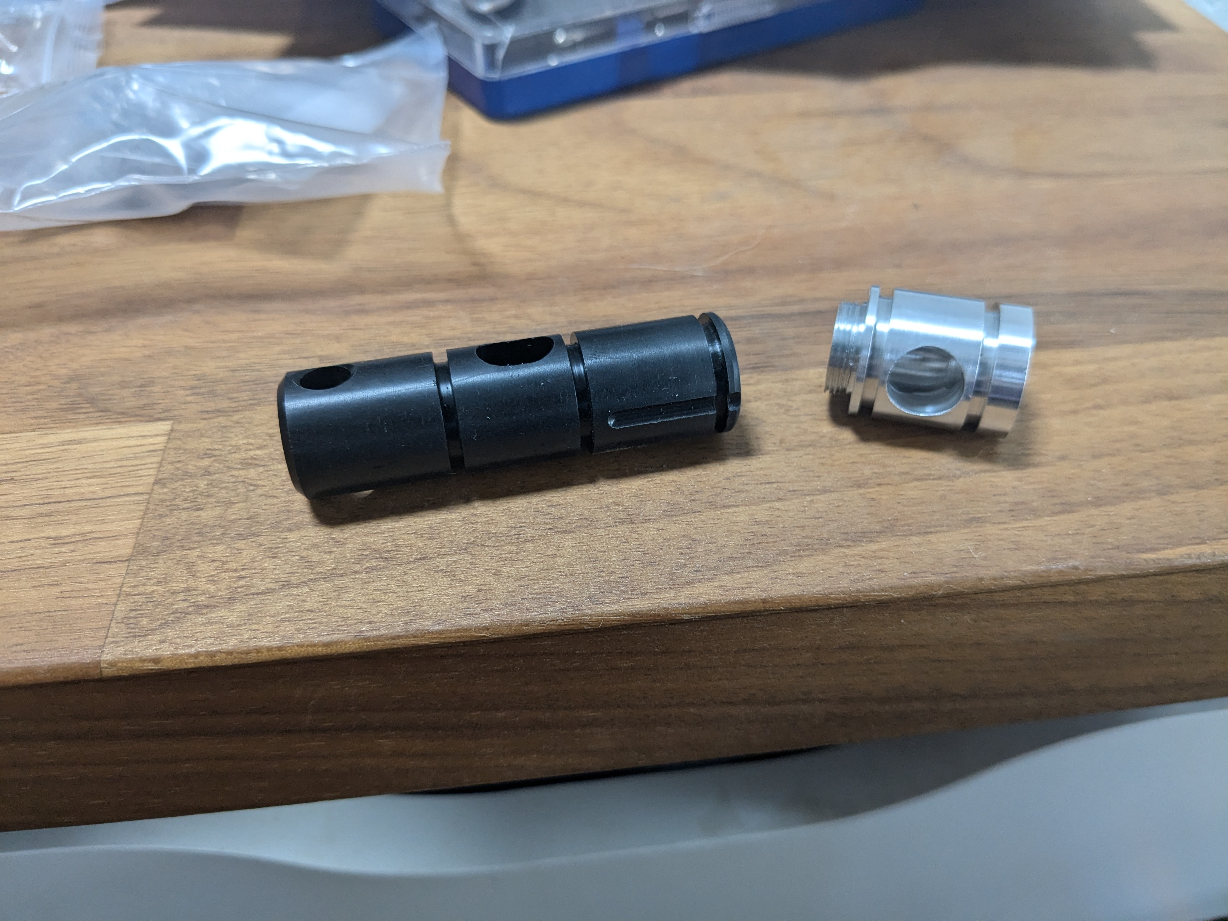

            I had some time to do some machining and got a couple parts done. The bolt is a modified (shortened) stock Ressy bolt. The valve is the same Laz valve body that latches109 is testing, but very slightly simplified. (Don't worry, Myrkul, I still remember you want some!) By the way, if anyone else wants these, let me know. It's a little time-consuming to make these, so I don't want to make too many manually. A small number (<10) would be fine. If there's more interest than that, I'd be happy to share CAD files if anyone can find a real machinist to do a small run of these.
            Click image for larger version  Name:	PXL_20241010_220425557.jpg Views:	0 Size:	2.69 MB ID:	603015
            • zinger565
              zinger565 commented
              I would love a bolt, no need for a valve body (at this moment)
            • tyronejk
              tyronejk commented
              I have to double-check but I don't think this bolt will work with the stock valve and hammer. The port is in a slightly different place than stock.
            You'd have to alter the body but you could go a similar route as the Autococker (and Spyder). Use the threaded hole to secure the VA. They make hex key headed bolts that are drilled through for air flow. You'll need a larger threaded hole in the body though for this. Or fit a VA with a standard bolt and drill holes to your heart's content in the body and VA.
            • latches109
              I was concerned how far I can go without clipping the LPR hole
