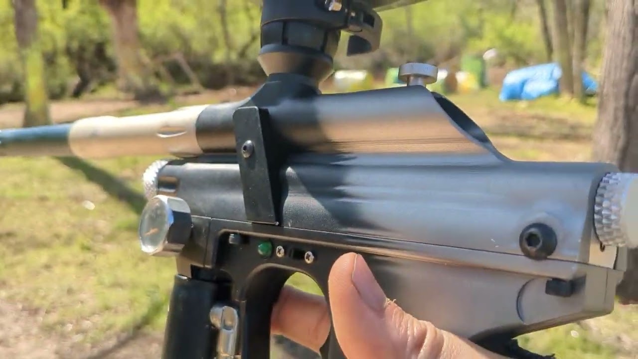

    I finally got out to a field and tested this thing and it actually works!
    Here's a short demo video. This field had no chrono so I wasn't able to fine-tune the pressures, but roughly tuned it by feel and it seems to currently be around 200-250 FPS. I have air and paint now and a chrono at home so I'll see where the pressures end up after tuning.

          The shots in that video turned out to be ~230 fps or so. After bumping up the pressures, I ran into an issue where a bumper or other oring kept getting dislodged and leaving the bolt protruding too far. After adding a stiffer bumper and then shortening the bolt to compensate, it starting chopping paint. I think I'll have to draw up a new bolt and ram to make this work. I originally used a modified Resurrection/Sniper bolt and worked around the port hole location there, but that compromised some other dimensions. It doesn't help that I tried to turn the ram from relatively large stock without relieving internal stresses and it came out slightly bent.
          Oh, also the HPR is overpressurizing and I plan to redesign those internals to use a standard schrader valve or oring seat. And the ASA macroline fitting started leaking and turns out to not be a standard spec, so swapping the internal oring doesn't seem to affect the leak.
