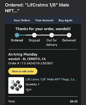

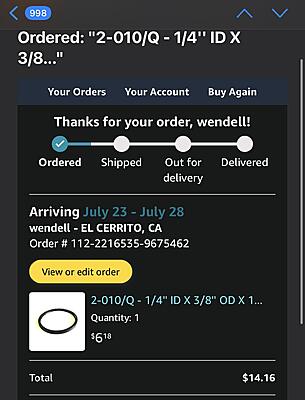

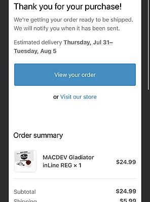

    Placed some orders for parts- Total spent so far is: $51.69. I have an old shocker O ring rebuild kit that has some of the sizes listed so I am gonna see tonight how well those work out!! Thanks for all the input Myrkul, this is awesome

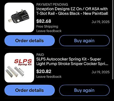

      Final pieces to the puzzle ordered- the inceptions ASA is gonna put me right at 156$ this project would've been completed in the $70 range if i didn't splurge here.

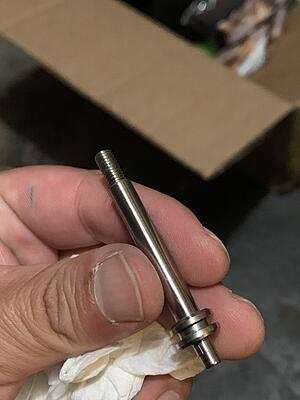

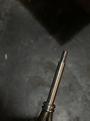

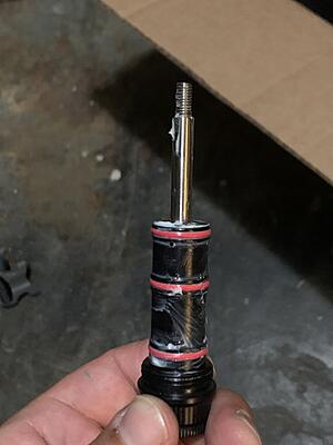

        Ram shaft before and after polishing- it wasn't bad to start with and I'm not sure if the photos will do it justice. Threw this bad boy on a drill and sent it through the gambit of sandpapers and compound 🤣
        • RustyShackleford
          Old Newb
          • Jul 2025
          • 238
          #19

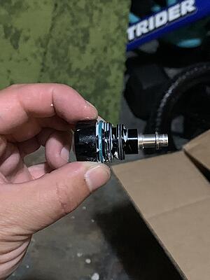

          New Orings on rammer and ram housing and the ram bumper

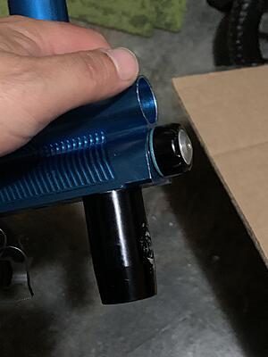

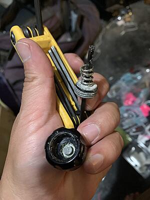

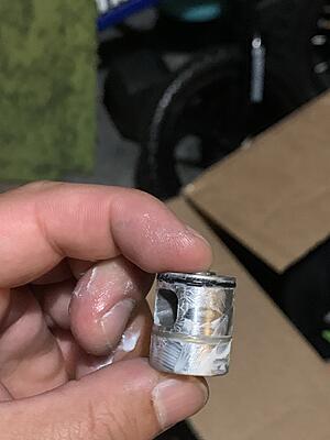

            Started to polish the hammer and realized I needed the rammer so I had to take the ram anssembly apart! DOH

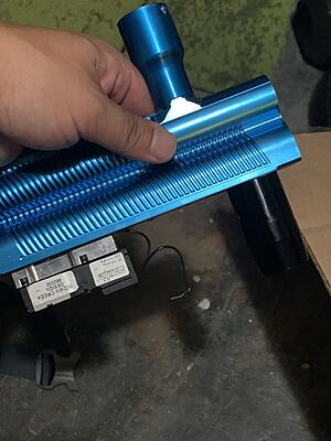

              #21
              Ram, valve, solenoid are going in!

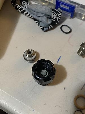

                  #23

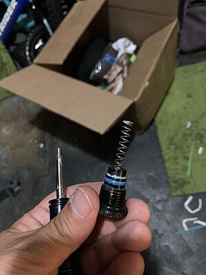

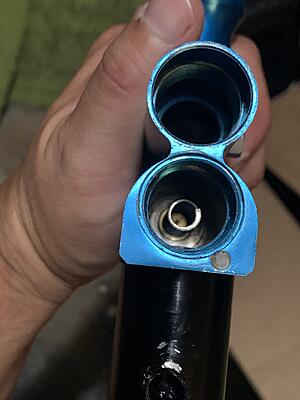

                  LPR looks beat on the front end! Simple pulled everything apart and cleaned it!
                  • RustyShackleford
                    Old Newb
                    • Jul 2025
                    • 238
                    #24
                    LPR has fresh rings and is rebuilt

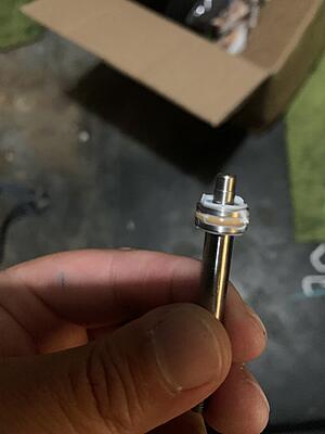

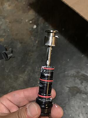

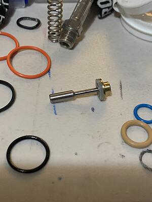

                      #25

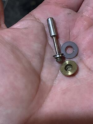

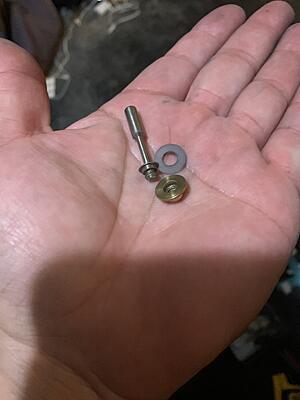

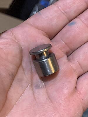

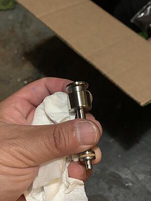

                      This part was in pieces- the brass part of this valve was barely threading on without the seal- I'm not sure if threads are stripped- I chased the threads and had to sand down the seal to get purchase on the brass threads. I might order another valve assembly for piece of mind- this one is hanging on by a thread and loctite. The ones on eBay look different - more brass- thinner seal-what do you guys think?
                      This gallery has 3 photos.
                      • Myrkul
                        Myrkul commented
                        That's a MacDev valve pin. All the MacDev Valves I've seen are anodized red, so I kinda think that it's just a stock valve body using the MacDev valve pin. Let me know if you need a stock valve pin & cup seal assembly, I have extra.

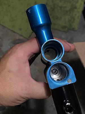

                      #26
                      LPR assembly is in, now to wait on the spring kit to finish this up

                        #27

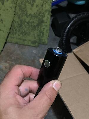

                        I tightened that LPR so that blue oring wasn't showing!

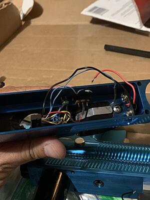

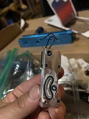

                          #28

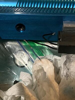

                          Now to sort out this wiring- I'll take better pictures tomorrow when I solder everything to where I think it goes LOL
